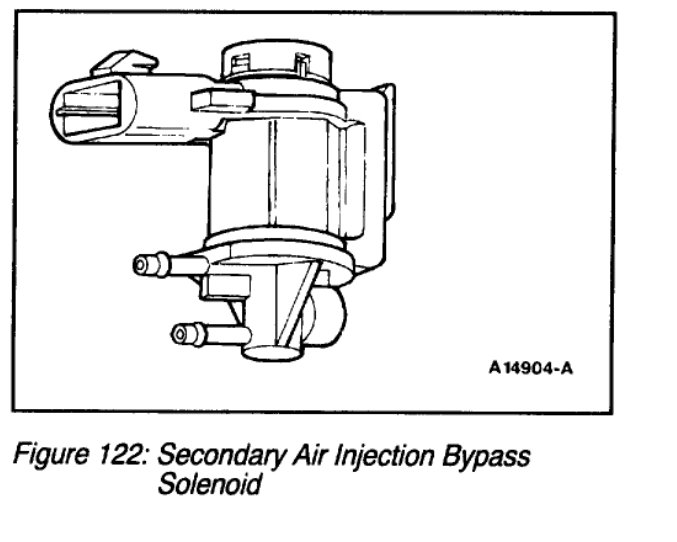

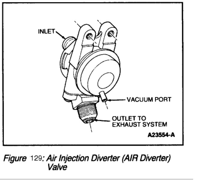

hello otisp23
Check to make sure the air diverter valve is not stuck open because it sounds like it is allowing extra air into the exhaust system causing the catalytic converter to glow red hot. Check to make sure the control valve is not stuck open as well.
Here are some guides to help you see what I am talking about
Cheers

OTISP23
per your suggestion, I have checked the fuel pressure and found the following: 65 PSI.
Looking in my Chilton Manual it shows that the PSI should be 39-55 PSI for the 2002 V6 engine. I may be thinking to hard but the sticker on the car door shows shows that it has a manufactured date of August 2001. Does that matter (manufacture date vs. model year?). If so, looking at my manual for a 2001 engine the PSI range is 35 - 65 PSI.
A little history...the car had been sitting over the summer (It had needed new spark plugs but didn't change). Battery died, didn't know for how long battery had been dead. Recharged battery car did not start, barely firing so then changed spark plugs replaced with NGK Laser Platinum plugs (PTR5f-=11 6579).
Car started with new plugs just fine (the wires are on the correct plug I changed one at a time so no chance of crossover).
Did test drive and that is when catalytic converter glowing red issue started. And barely ran. I then ran OBDII test on car computer despite no engine light being on and came up with two codes: P0172 - "System too rich (Bank I), which would explain the "glowing cat" but why is it too rich? The second code was a Tranny code P0720. Also before car was parked for summer there were no codes indicating a possible problem.
Even though the car seems like it is idling fine I checked the air diverter valve and sure enough the valve has stuck open so I replaced it and the problem is fixed.
Thanks 2carpros! you guys are great!
