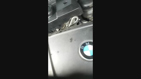

I have taken a video ken but not sure how to send it?
Sep 15, 2018 at 4:05 AM
CHRIS098
  • 17 POSTS
Think I have sent it ?
Sep 15, 2018 at 4:57 AM
CHRIS098
  • 17 POSTS

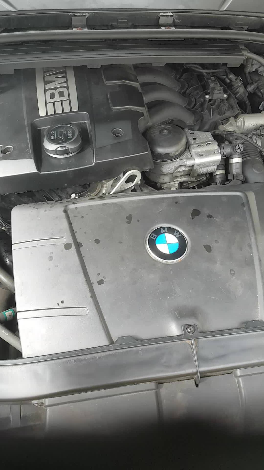

Smoking is a leaking rocker cover gasket. I think was like that before the noise was there.

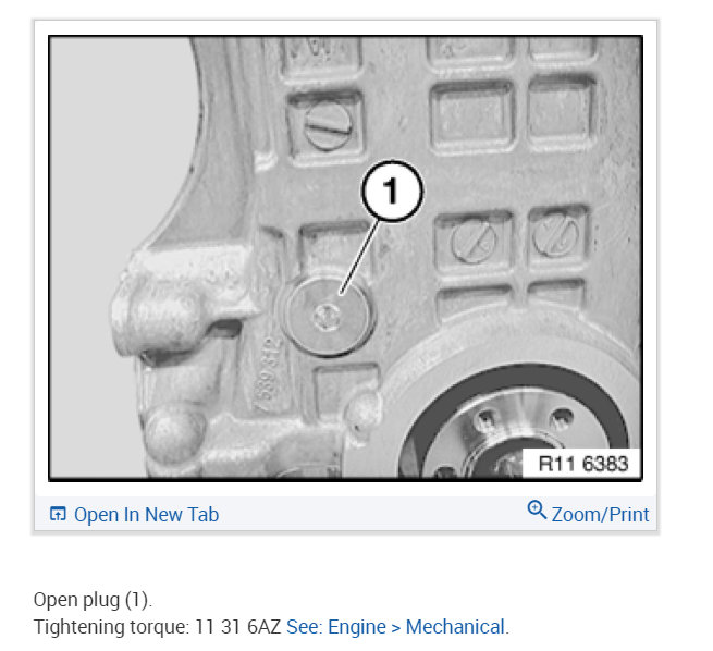

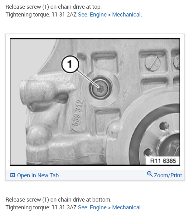

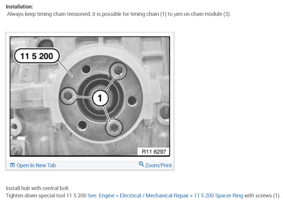

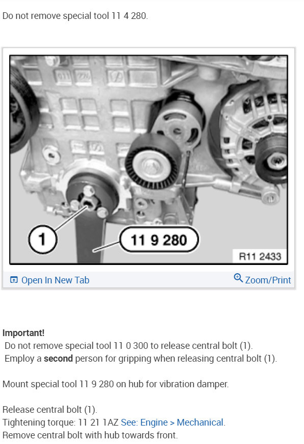

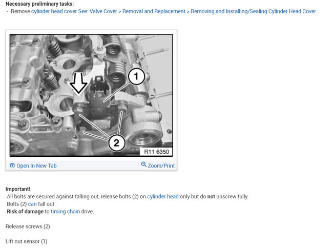

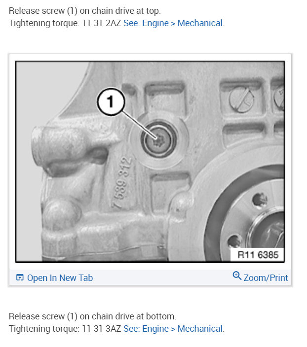

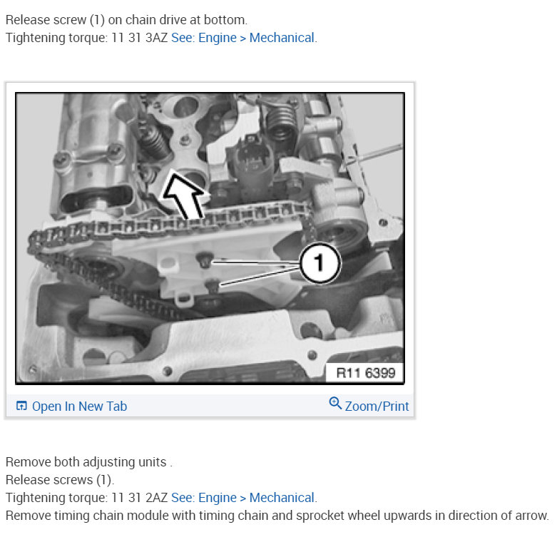

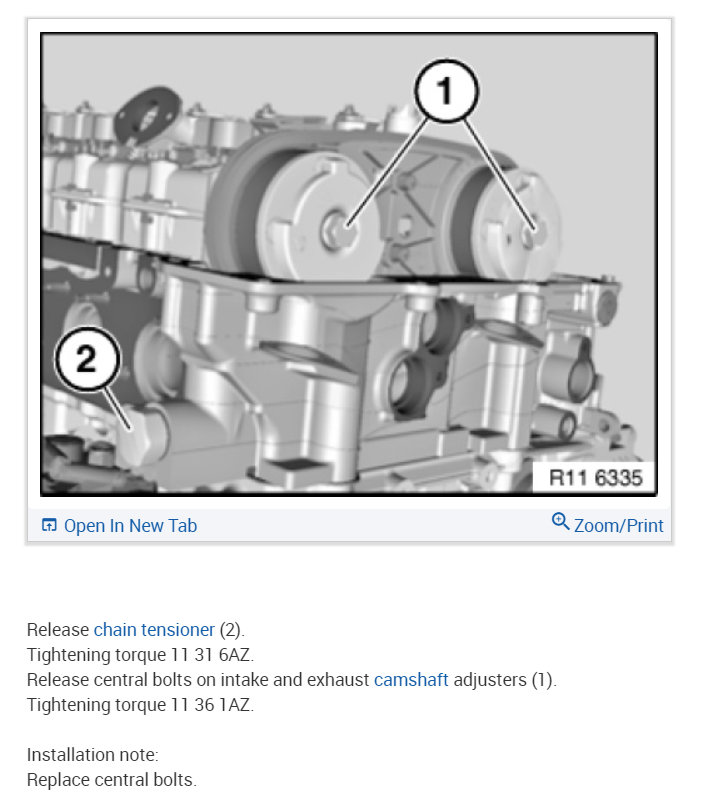

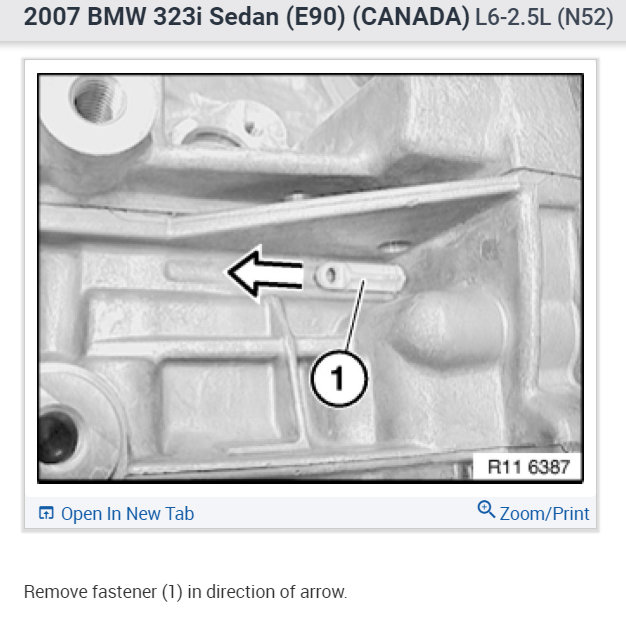

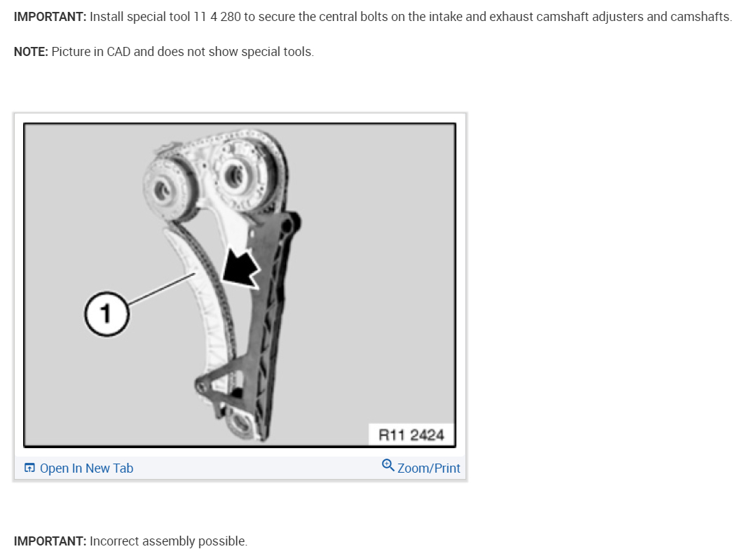

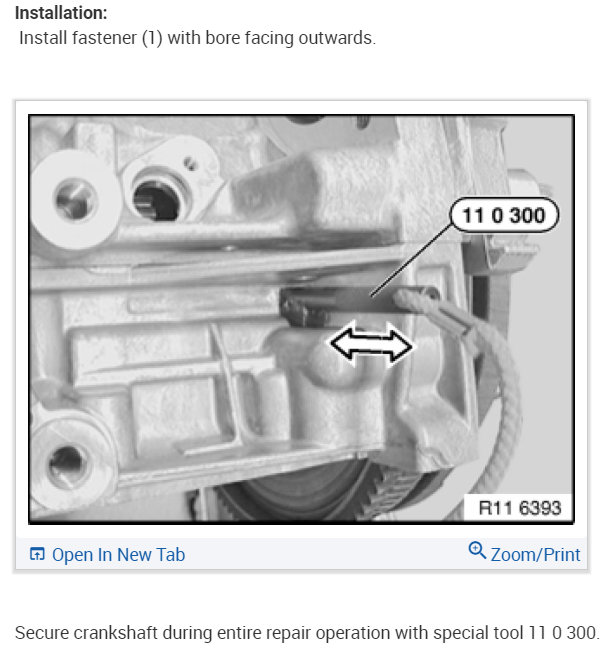

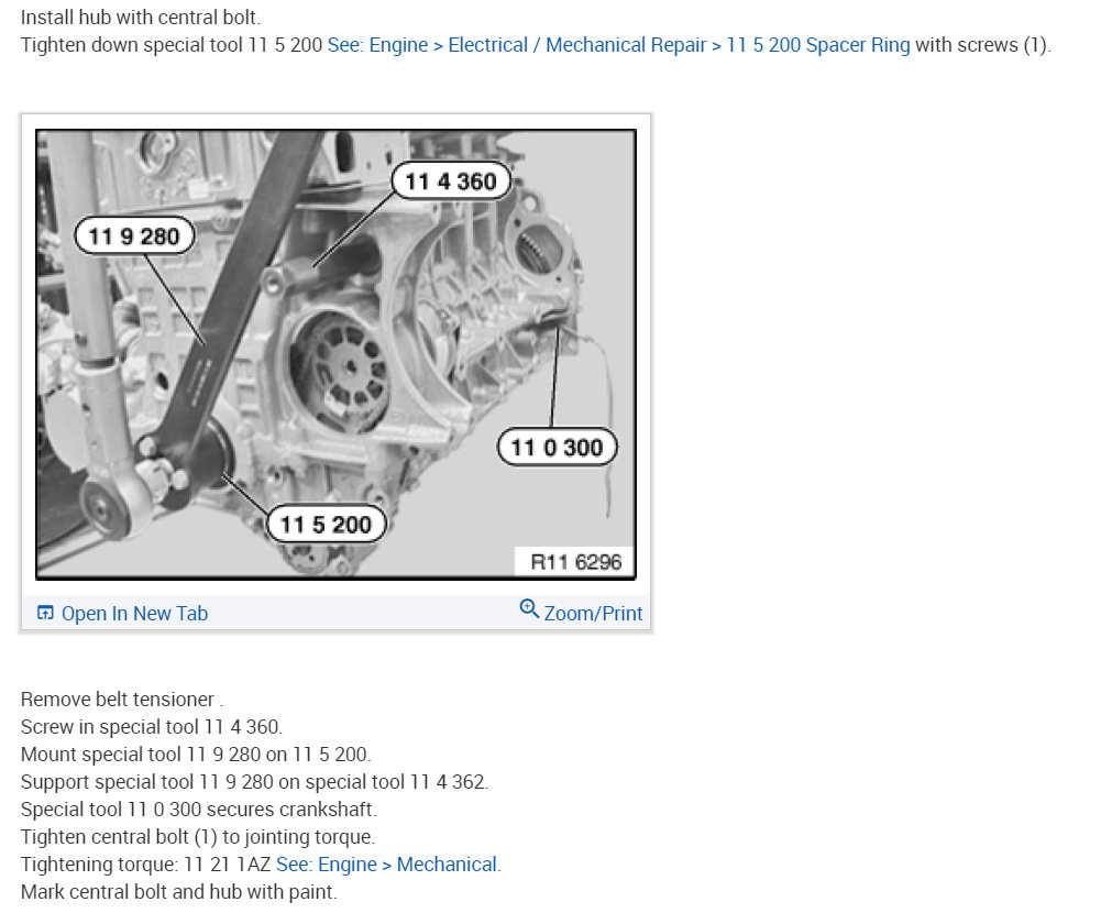

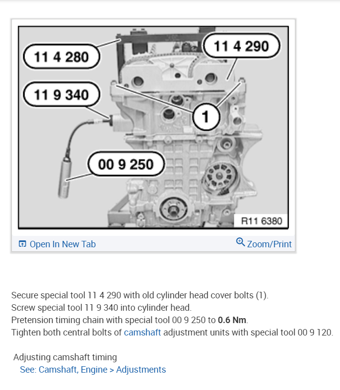

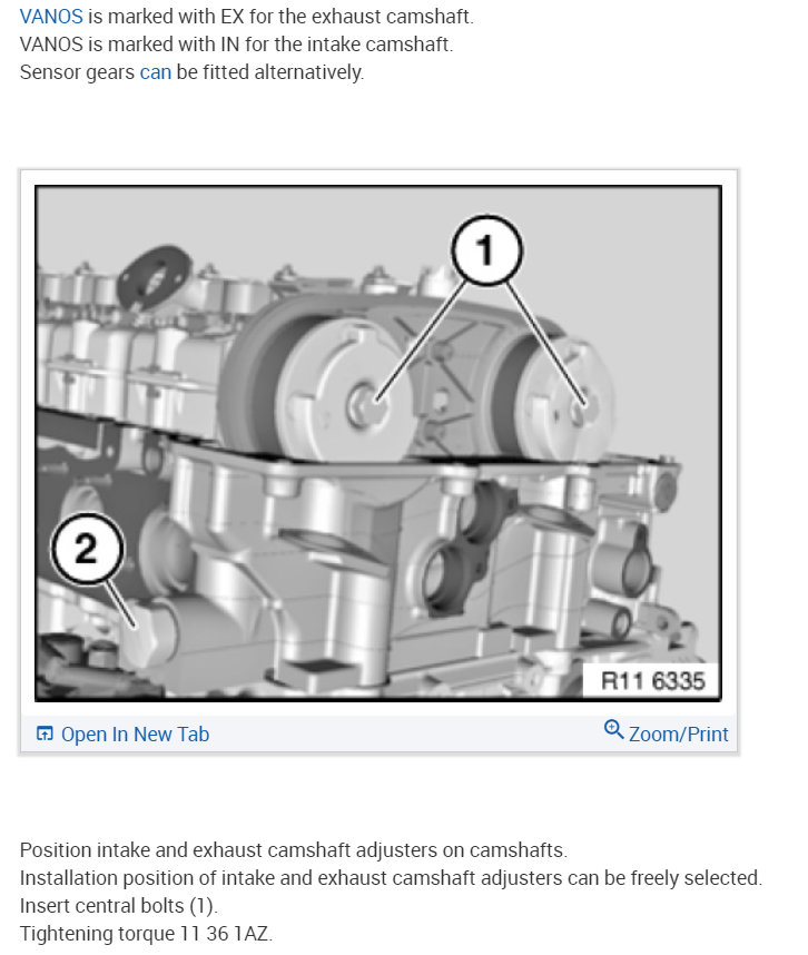

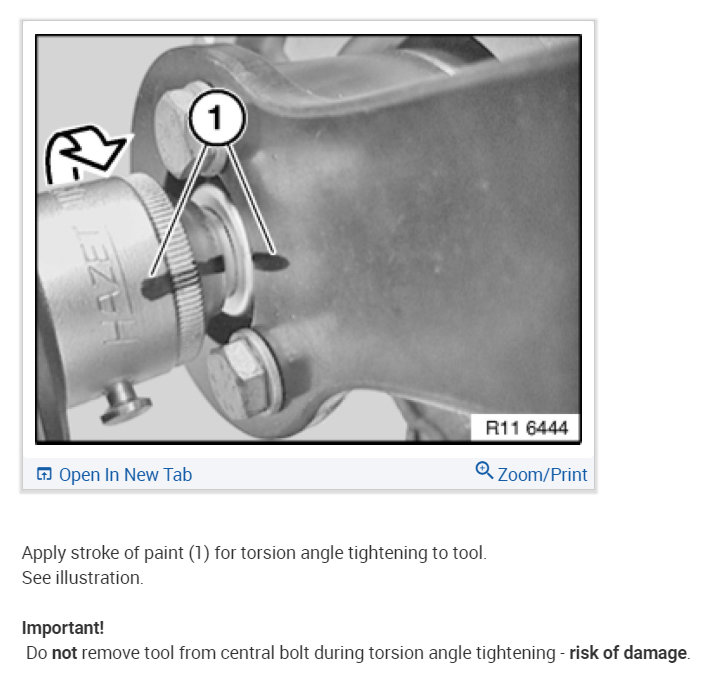

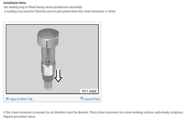

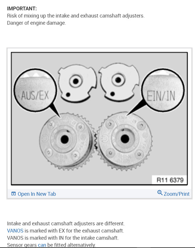

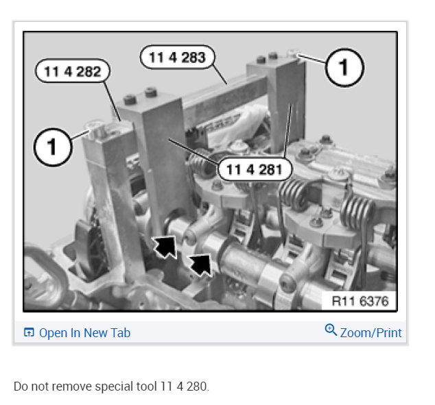

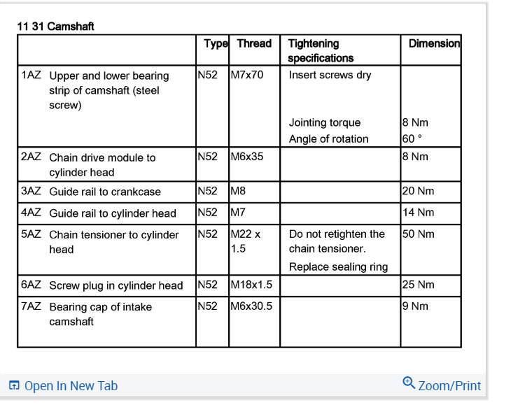

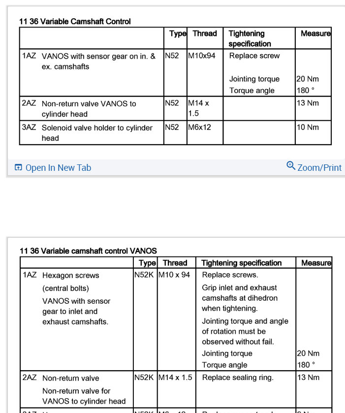

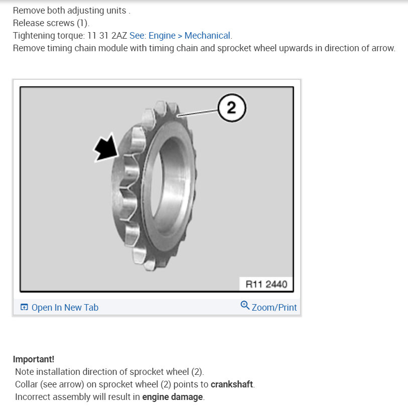

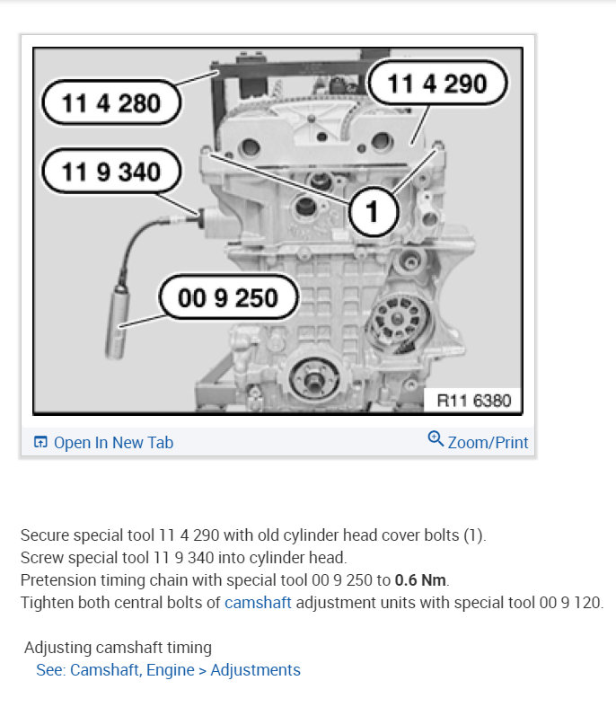

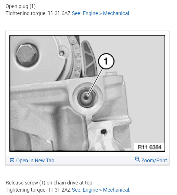

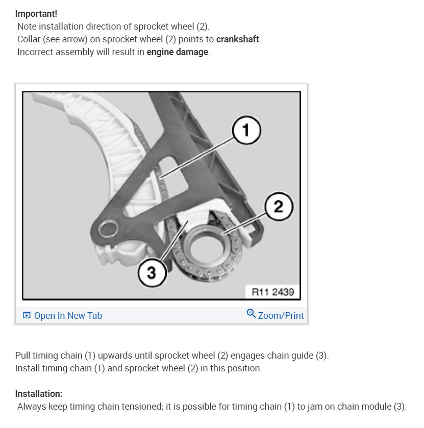

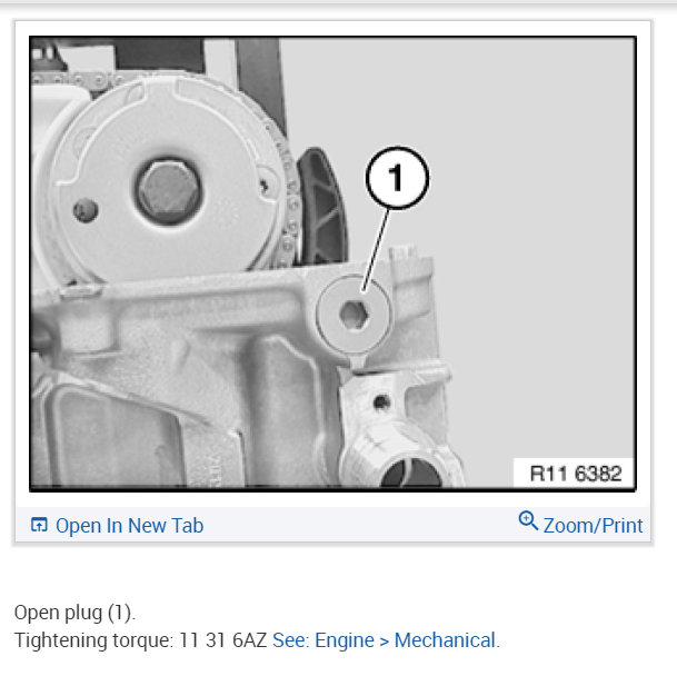

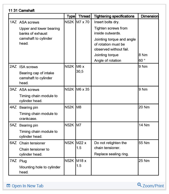

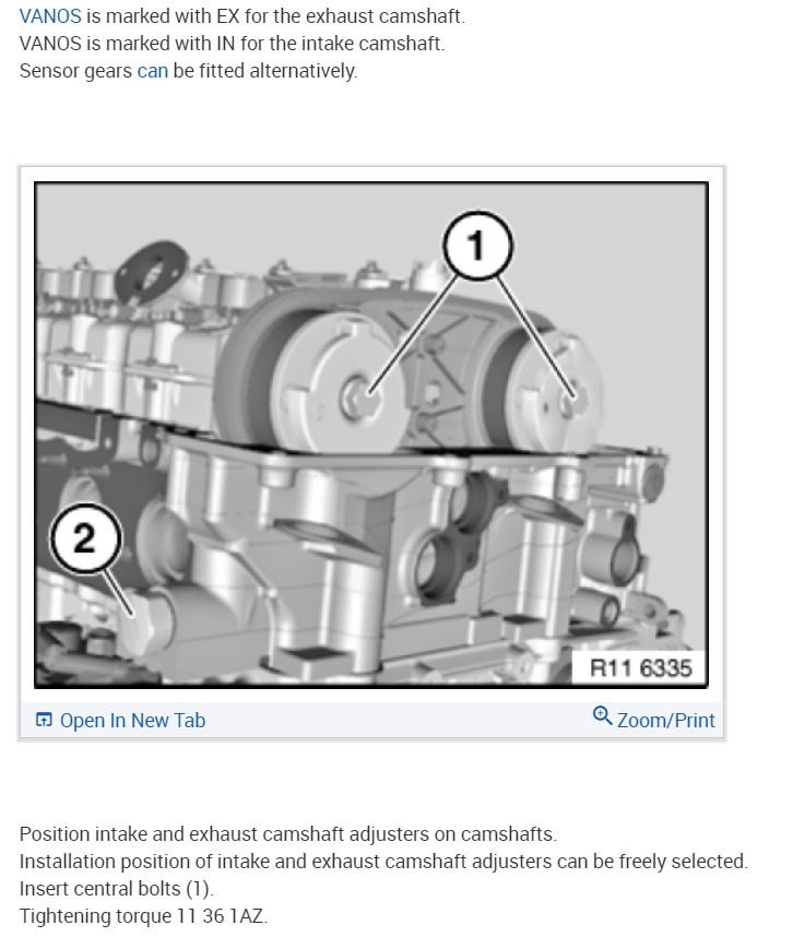

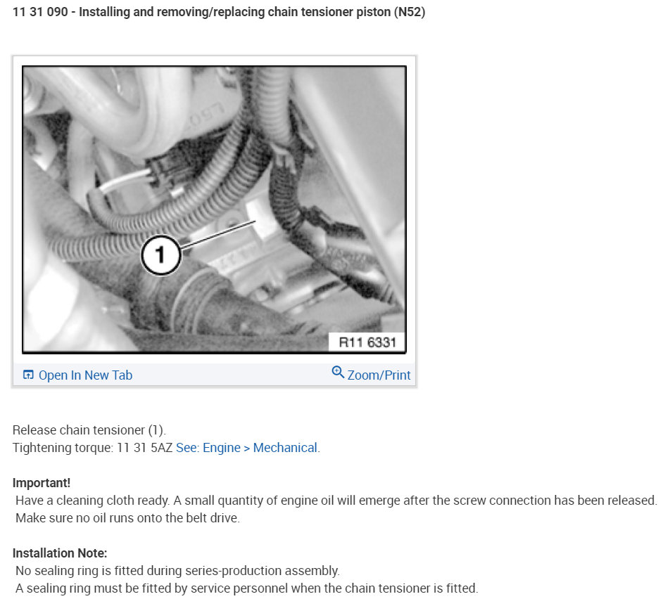

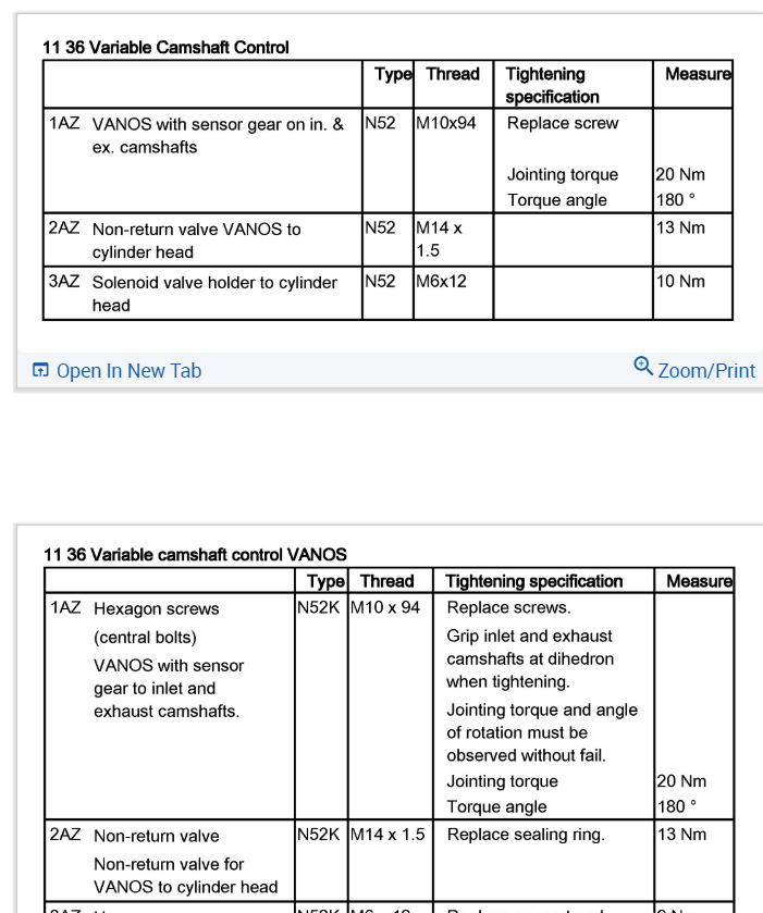

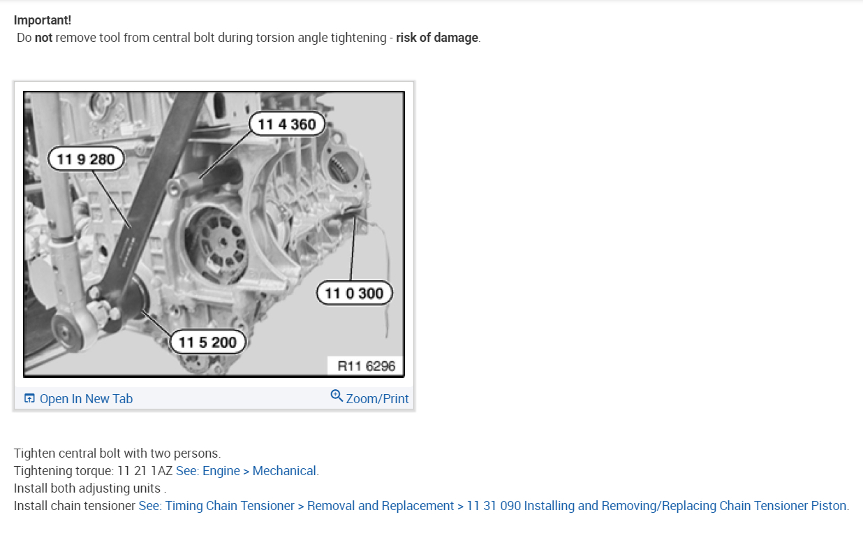

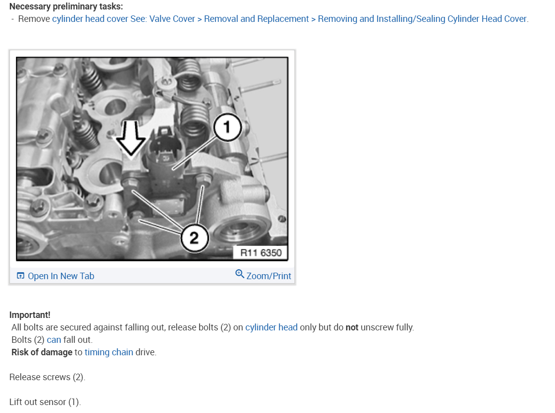

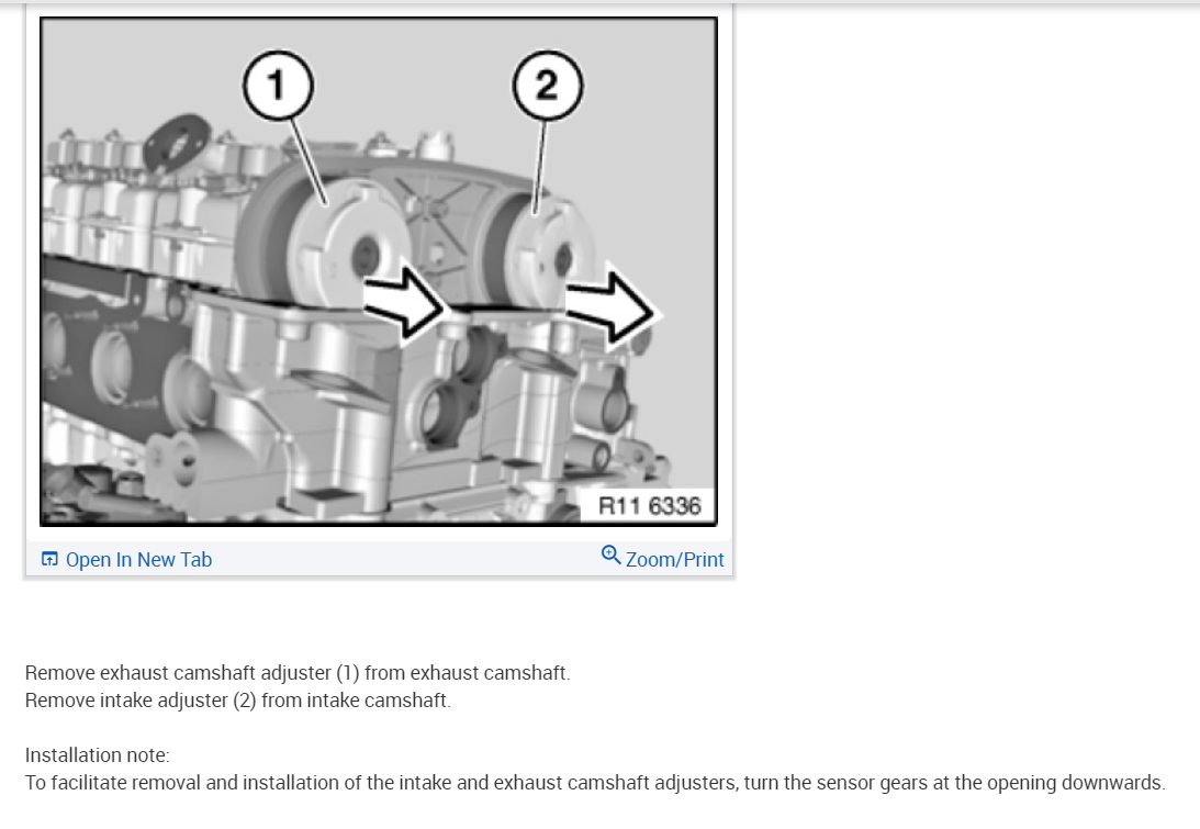

Thanks for the video. It sounds like the timing chain guide is broken or you have a vanos that is out either way the front of the engine needs to come apart to see what is going on. Here here the diagrams to help us do the job. I will walk you through the repair. You can get the parts and tools from Ebay. This will not cause low compression on one cylinder though so that is a concern. How low is it? Check out the diagrams (below). Please let us know what you find. We are interested to see what it is.

Only sometimes. Can you tell if the noise is coming from the front of the engine or the middle?
Sep 16, 2018 at 3:14 PM
CHRIS098
  • 17 POSTS
Front I would say but not 100% sure and that noise just sounds like the chain? The car still drives just in limp mode would it drive if piston was damaged?
I am thinking worst now not good car only has 65,000 on clock as well. :(
Sep 16, 2018 at 3:21 PM
  • 54,832 POSTS
Yep, that is the timing chain. With that many miles it is worth fixing if you can try to get pictures of the broken parts once you get it apart so people can see what goes wrong with them.
