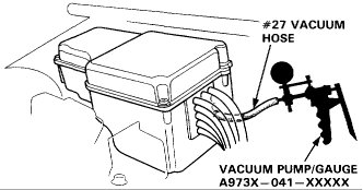

Hi and thanks for using 2CarPros. Com. Wow! That is a problem. First, make sure there are no vacuum leaks that could be helping cause the problem. Also, make sure nothing is causing the throttle to stick open such as a bad cable, miss-routed cable.

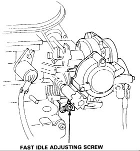

Next, make sure the choke fast idle is set correctly. Note: Fast idle speed is 2500 + or - 500 RPM'S. I have attached a picture (picture one) of the fast idle mechanism and here are the directions for adjusting it.
Fast Idle Inspection/Adjustment
HOT ENGINE
Start the engine and warm it up to normal operating temperature (the cooling fan comes on).
Stop the engine and connect a tachometer to it.
Disconnect and plug the inside vacuum hose of the fast idle unloader.
To engage the fast idle cam, open and close the throttle fully while holding the choke valve closed.
Restart the engine.
Fast idle should be 2500 ±500 rpm.
If not OK, reset the fast idle speed by turning the screw shown.

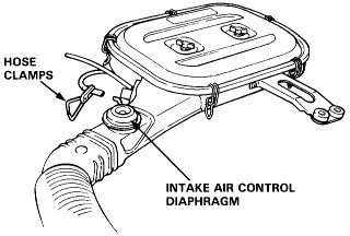

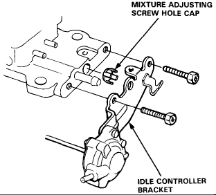

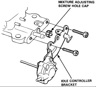

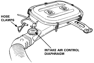

The directions I have for setting idle speed are from alldata and are know as a propane Enrichment Method. I will list the the directions here and add pictures for you to see where the adjustments are made. Keep in mind, these are very specific directions designed to set both idle speed as well as air fuel mixture. Additionally, they explain how to check for vacuum issues. See pics 2 - 9.

Remove the vacuum hose from the intake air control diaphragm and clamp the hose end.

Pull the throttle cable out of its bracket.
Remove the carburetor nuts and the bolt securing the steel vacuum manifold.
Lift the carburetor clear of its studs, then tilt it backwards so you can remove the idle controller bracket screws.
Remove the idle controller bracket.
Remove the mixture adjusting screw hole cap, then reinstall the idle controller bracket.

Remove the vacuum hose from intake air control diaphragm and clamp the hose end.

If the intake air temperature is above 65°C (149°F), go on to step 23 through 26.
Disconnect #5 vacuum hose from the air suction valve and plug the hose.
Disconnect the #27 vacuum hose from the pipe and plug the pipe. Attach vacuum pump/gauge to the #27 hose and apply vacuum.
The vacuum pump should hold vacuum.
If pump holds vacuum go to step 25.
If pump does not hold vacuum disconnect control box connector and then apply vacuum. If pump still does not hold vacuum, replace solenoid or #27 vacuum hose. If pump now holds vacuum go onto step 25.
