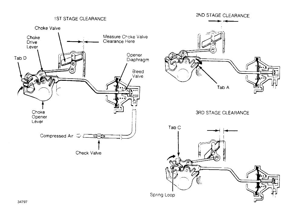

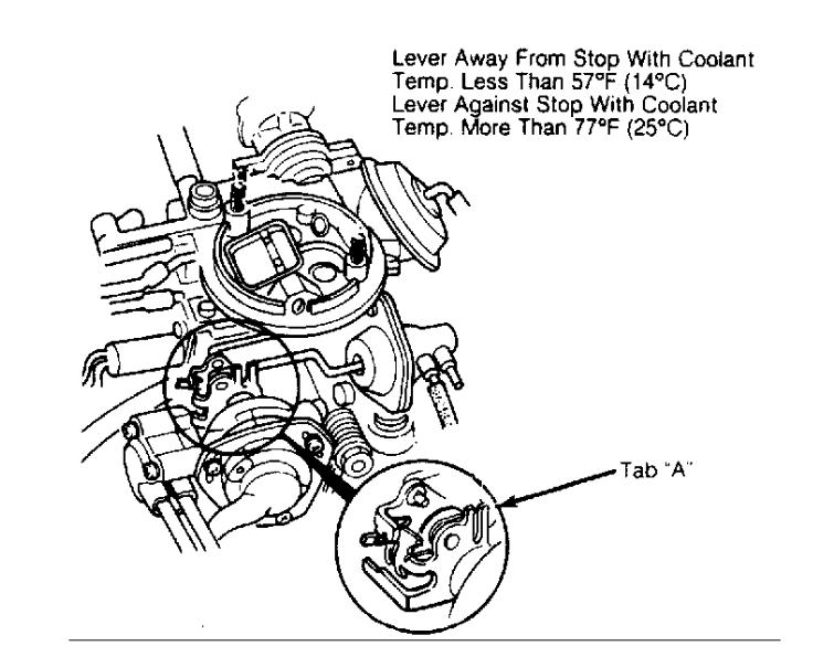

Here is a pic of the choke fast idle control. The unloader screw may be inside the diaphragm in previous pic.

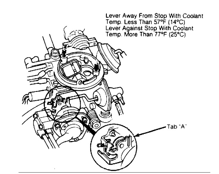

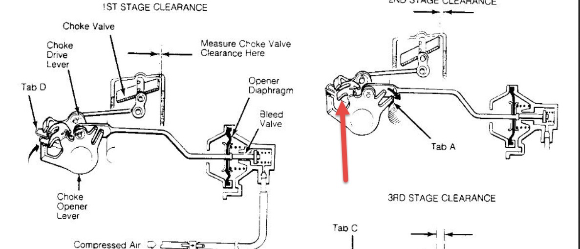

I went ahead and looked inside of the diaphram of the fast idle unloader
and no adjustment screw visible. Just a diaphram, spring and pin. So
question still remains. How to adjust cold start idle to 2000 rpms.
I understand all information given in previous responses and pictorials.
Just where is the adjustment screw.? Thanks
Sunday, January 25th, 2015 AT 2:07 PM
HMAC300
  • 48,601 POSTS
There is no screw you'll have to bend a tab in pic to get it to idle correctly like you want it.

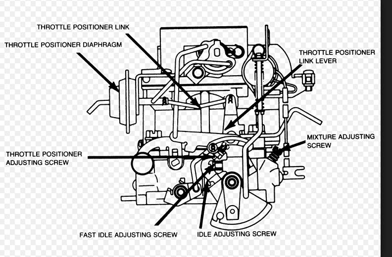

Looking the manual it shows a model EA not ED is for your car. That is the only model we have listed. I've even looked online and not found that carb. Adjusting screw is supposed to be behind fast idle unloader which you have said isn't there. I finally found a pic that may be your carb it shows the fast idle screw if this isn't it I have no idea what to tell you.

KEIHINCARB
  • 10 POSTS
Not the correct model/picture of my carburetor. That would be too easy.
U-tube had a video showing bending of tab as you've
suggested. It just seems by doing it that way is too mask the real problem.
