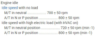

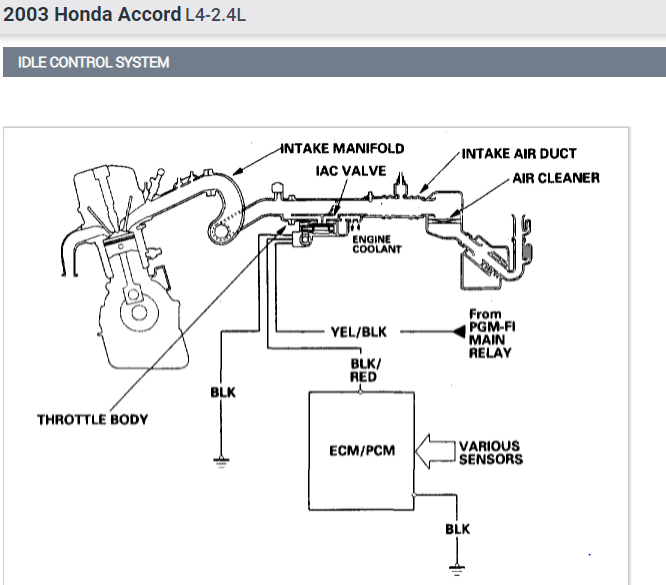

I bought this car used. Had 100,000. Now it has 160000KM. When I start in morning, it idles at 1500RPM and then gradually comes to normal i.e 600 RPM. But when I am struck in traffic stop n go situation, the idle starts to rise gradually ( As high 1500-2000 RPM) while the temperature remains constant. After driving when I put the cark in park, the idles jumps to 1500 RPM. If I have to restart the car soon after shutting it warm, it idles high.
Just did a recent tune up and cleaned throttle body.
Please advise, what can be done.
Jun 10, 2010 at 3:51 AM
SQM
  • 6,383 POSTS

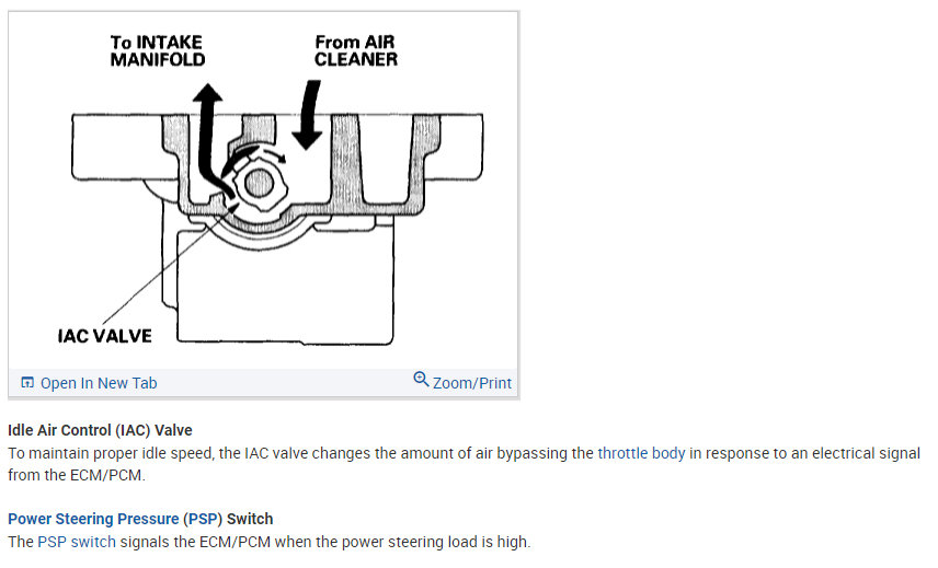

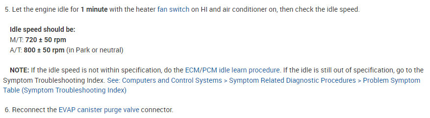

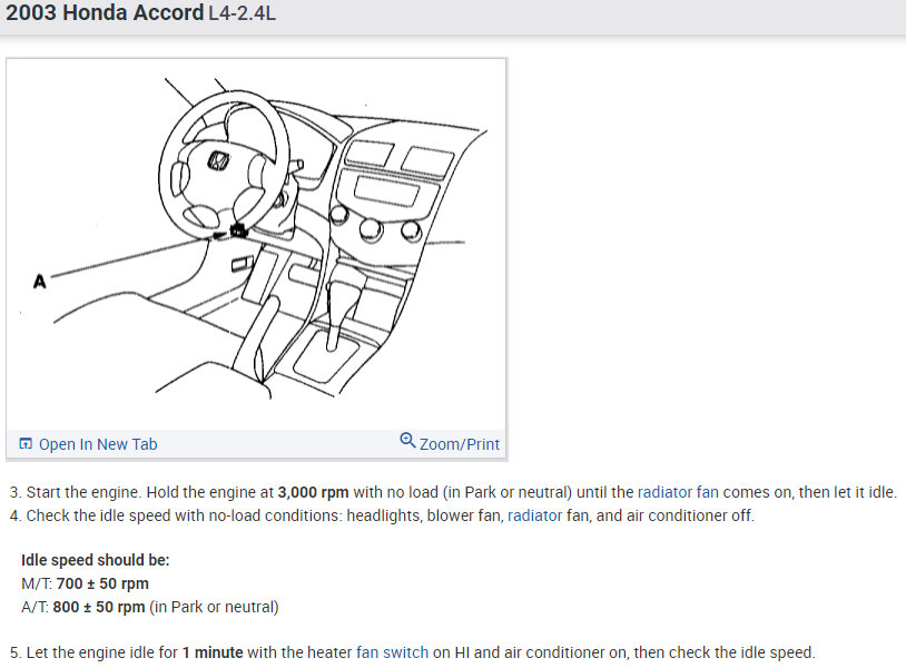

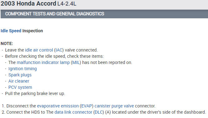

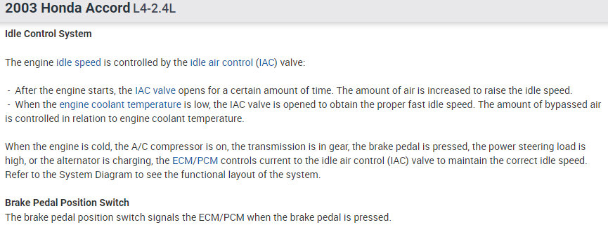

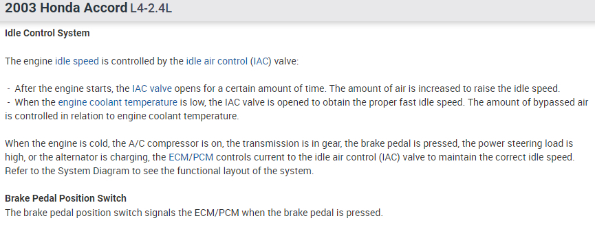

It sounds like a faulty idle air control motor. This will cause the car to have erratic engine speed. Have had the car scanned for codes?
https://youtu.be/dPOrNy-Y9Ng
You might find this article helpful:
https://www.2carpros.com/articles/how-to-replace-an-idle-speed-control-motor-iac
