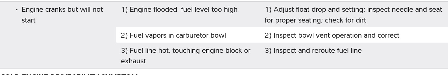

When I got the truck back it was able to idle much better. But I seem to be having the same problem with starting. The truck starts fine when it's a cold start. But when I've driven it for 20-30 minutes it get's harder and harder to start each time I stop somewhere and get back in the truck to go again. It turns over, but just doesn't fire up unless I really pump the gas. And once it does finally start after several tries it takes me revving it to keep it there and prevent it from dying. I'm super close to flooding it though when I'm doing this, so it's obviously not good.
Do you have any ideas?
FYI--the mechanic who worked on it said it was installed well. Although I did leave off a little cap on one of the unused vacuum ports that I didn't notice. So I drove it for 2 days with this open.
At the time I installed the carburetor I also changed the air filter, PCV valve, and fuel filter. FYI

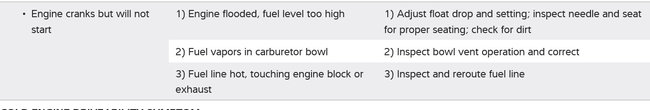

please when you have a new question re-post it instead of coming back like this . the problem could be what is in pic for hard starting hot. also check canister purge valve, it may be open at idle which it shouldn't be and letting to much fumes inside engine. finally check to see if choke plate on carb is closed when you try to start HOT. it should be wide open, it 's at very top of carb under air cleaner.
