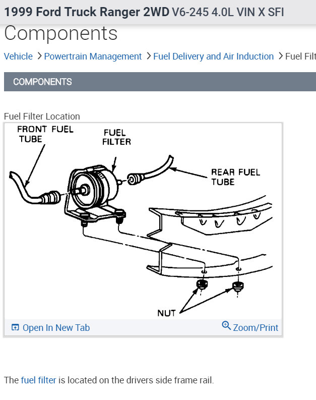

Fuel line where fuel filter connects under a 1999 Ford Ranger is boogered up, wont seat around fuel filter, sprays fuel out. Can you get a new connection kit. I was told not use rubber hose with clamps, because pressure is to great. Any suggestions.

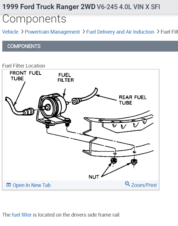

Auto parts stores make a spring seat kit to replace the damaged clip in the housing. Use a pick to remove the old one and then just install the new one. CHeck out the diagrams below.
This guide and video will help
https://www.2carpros.com/articles/how-to-change-a-fuel-filter
and
https://youtu.be/Boi0DPXVHbM
