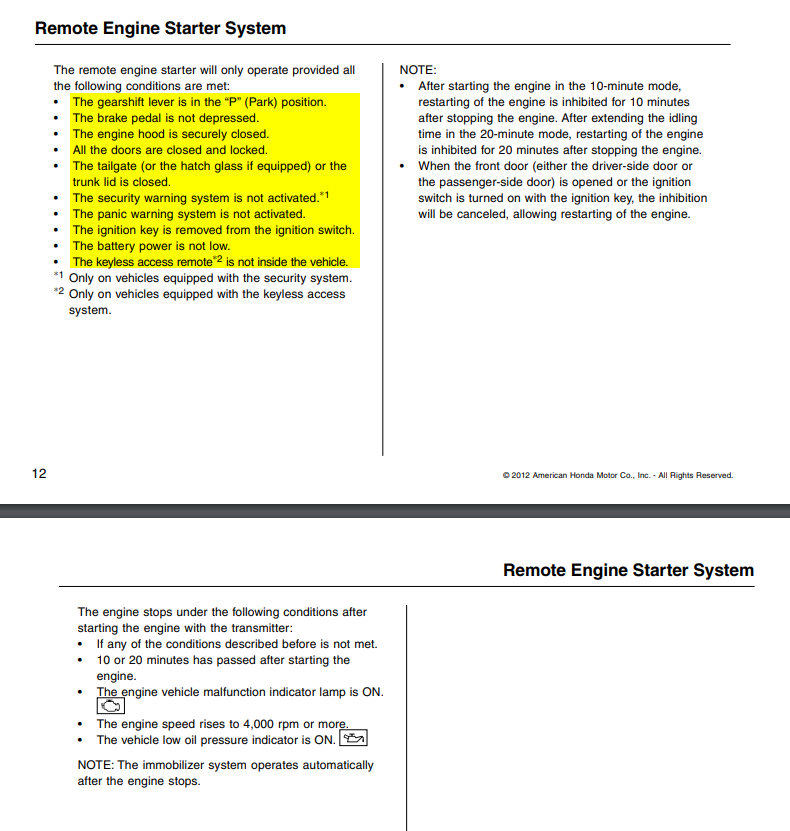

I replaced the fuse. Now I m getting a starter system problem. I am not sure if that has to do with the remote start. When I try to start the car from outside with remote start it does not work.The car was hit on the front left. I’m trying to salvage the car.
Also, when I lock my car my gas cap opens. I noticed too that the latch looks broken as well. Also when locking the car the cars lights don t flash. I have tried fixing them in the settings but still nothing.

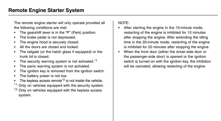

If the remote start doesn't work, what exactly does it do when you press the button? Does it crank or just not do anything? If it doesn't even try to start, then I suspect there is one of the inhibit functions that is preventing this. It could be the fuel door that opens when you press the lock button. Correct me if I am wrong but you have to press the lock button on the remote and then hold the start button?
Basically if there is a door open or other door including the fuel door it will prevent the remote start from operating.

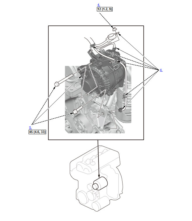

If you find the alternator is bad, here is a link that shows in general how one is replaced:
https://www.2carpros.com/articles/how-to-replace-an-alternator
Here are directions specific to your vehicle for replacement. The attached pics correlate with the directions.
___________________
See Pic 1
1. 12 Volt Battery Terminal - Disconnect (CLICK HERE).
2. Drive Belt - Remove (CLICK HERE).
3. Drive Belt Auto-Tensioner - Remove (CLICK HERE).
4. Connector and Positive Alternator Cable - Disconnect.
5. Alternator - Remove.
6. All Removed Parts - Install.

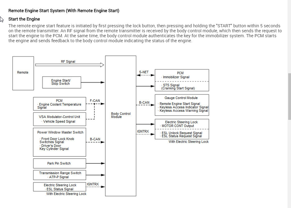

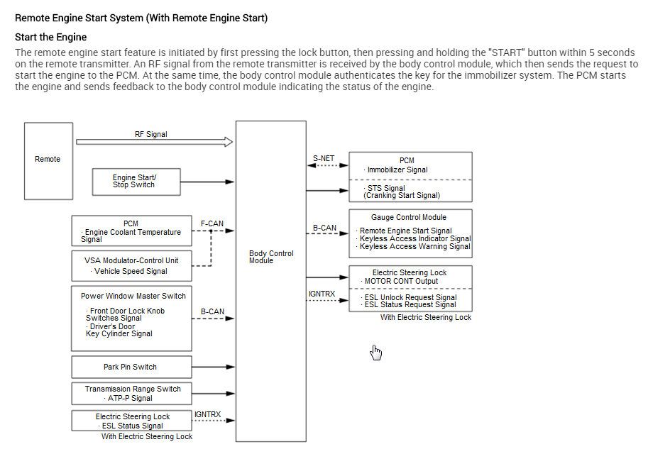

Okay. I suspect we have other issues like this that could be blocking the remote start function. These are called inhibitors. Take a look at the attachments that shows the detail on this system.
If we have a scan tool we can monitor the BCM and see if there is something that it thinks is an issue to prevent the remote start. This will save you from guessing at what it could be.
At the very least we need to check and see if there are any codes. I am sure there would have been one showing an open circuit for the hood latch so these are the things we need to see.

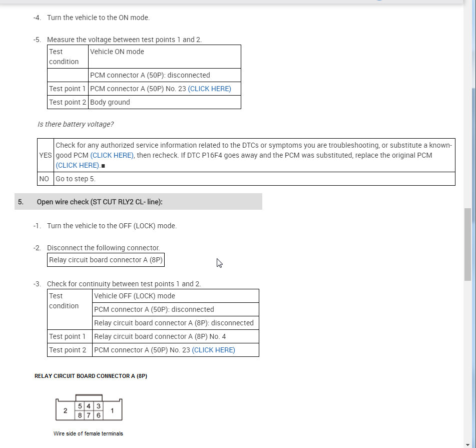

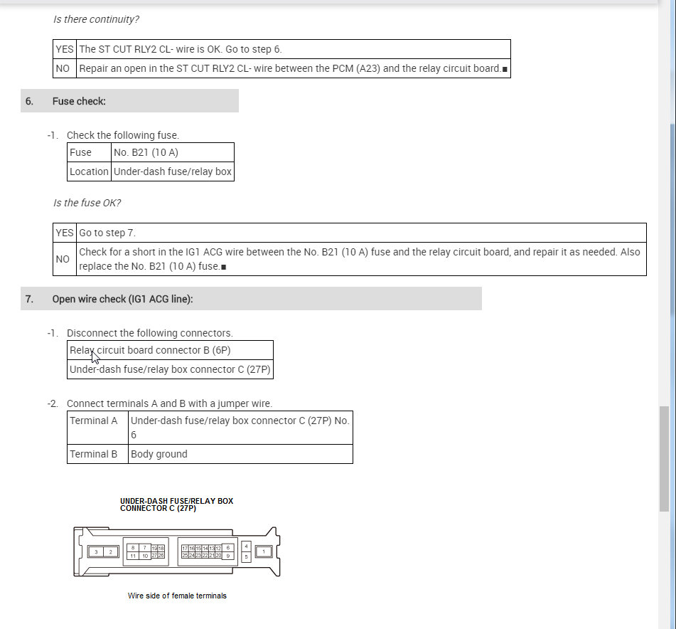

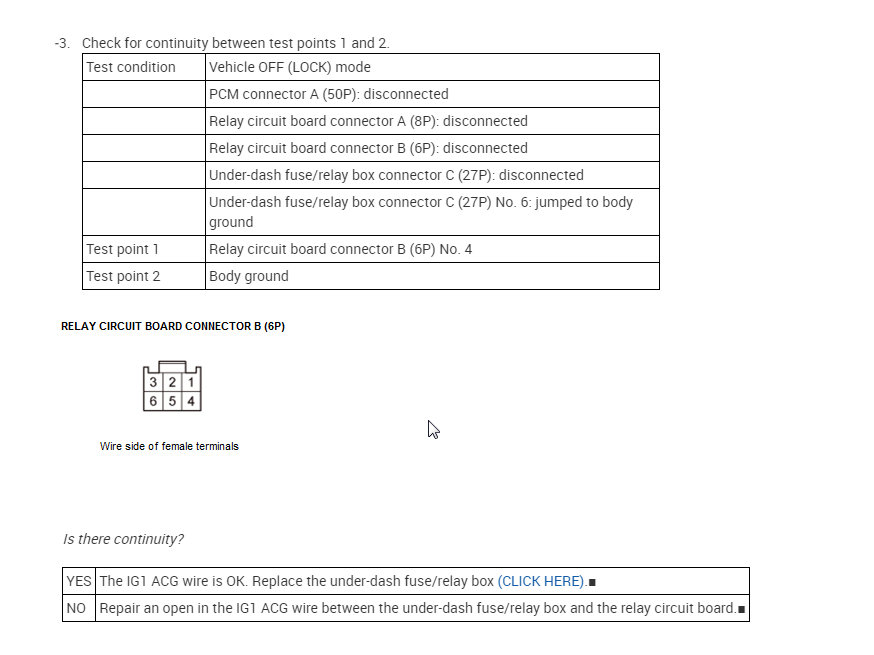

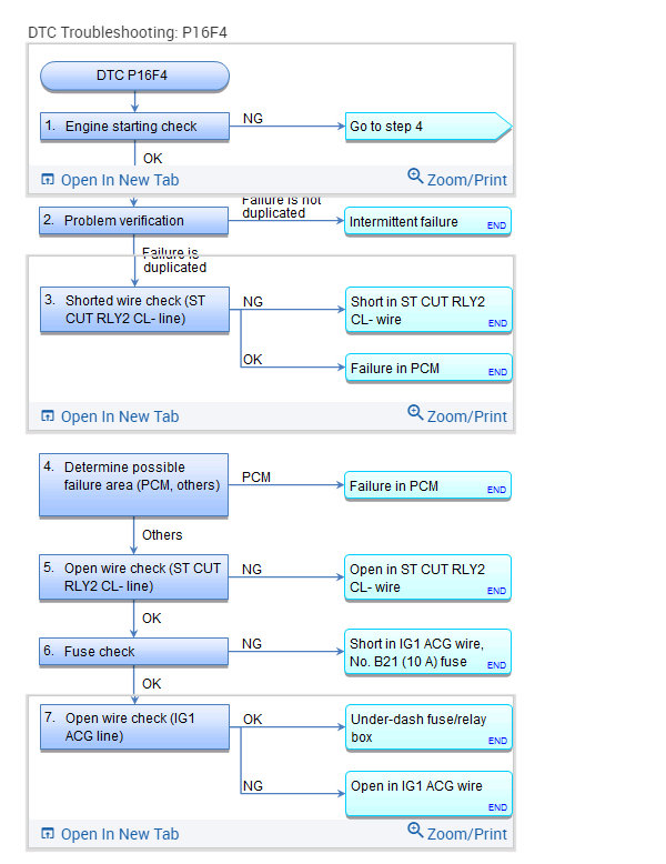

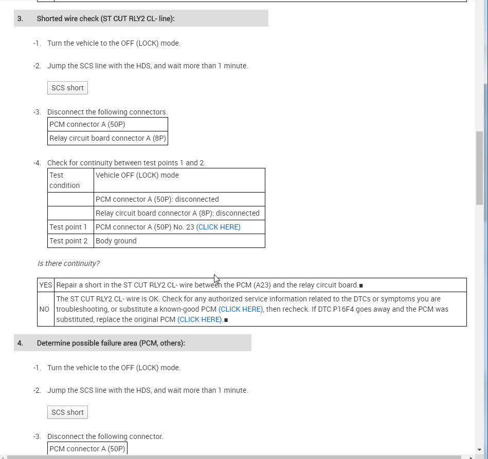

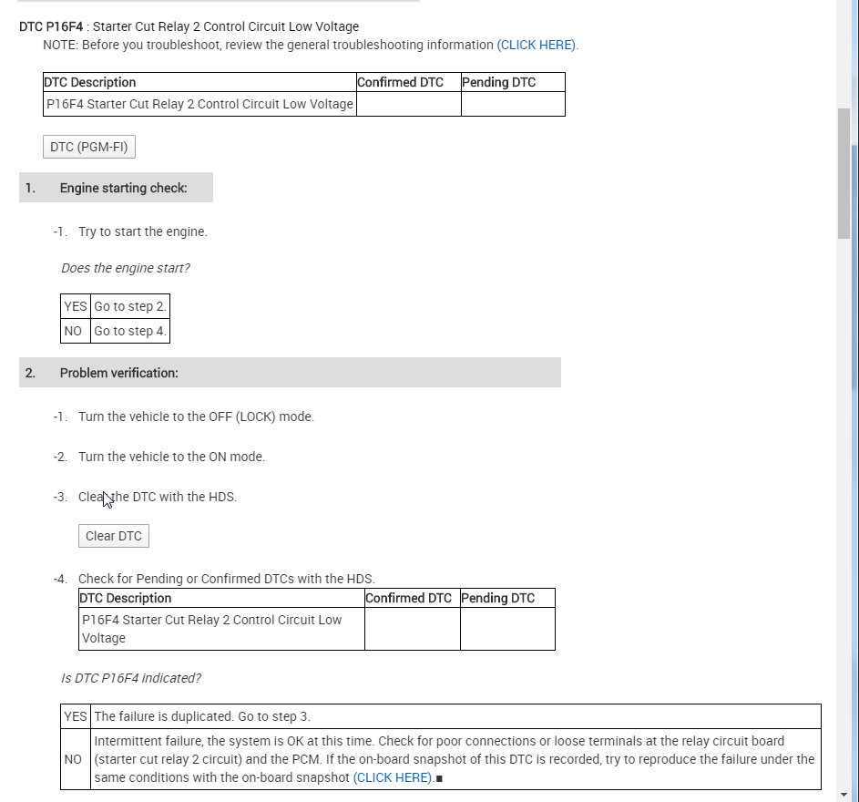

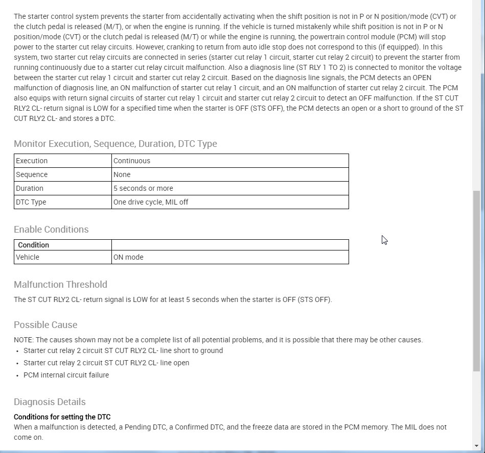

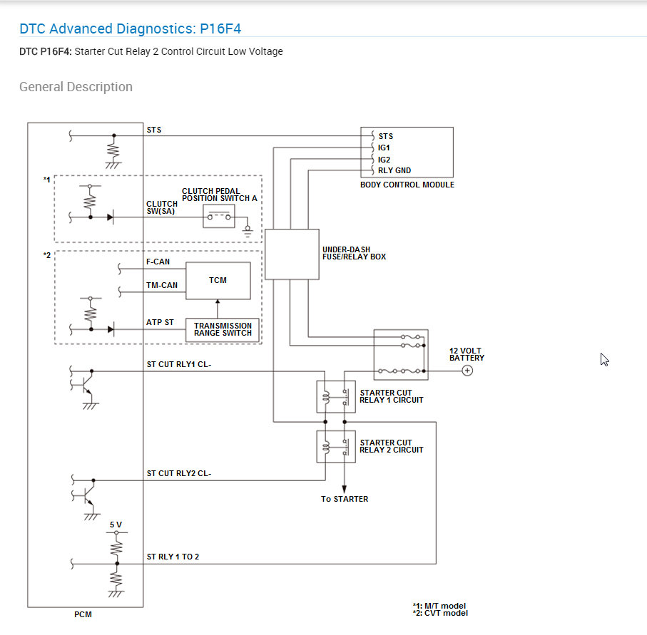

I took it to Honda and they pulled up DTC P16F4.
Jan 25, 2021 at 2:58 AM (Merged)
That can definitely cause your issue. However, do you know if the code was active or stored?
I attached the info about this code so we will need to run through this and see what we find. However, the remote start will be disabled by something like this so we need to dig into it and see what we turn up.

It was confirmed dtc. The car was sent to dealer and changed ECU harness. Still displaying starter issue. They noticed the current harness was spliced and naked.
JACOB GONZALEZ
  • 24 POSTS
Issue still not resolved.
Okay. Did they replace the harness to try and correct this concern or did they replace the harness per the code? Just clarifying because if you didn't actually tell them the remote start was not working then they would not have checked that operation prior to returning the vehicle to you.
Basically we need them to check the BCM to see if each of these systems is reporting properly because if something is "telling" the BCM that one of them is not operating then it will cause the remote start to be disabled.
Let me know if they looked at the vehicle for the remote start issue because if they did, why did they return it with it not operating? Thanks
JACOB GONZALEZ
  • 24 POSTS
They noticed one of the circuits for the BCM was not working. Specifically the starter circuit. So they are almost certain that they know the issue.

They replaced the engine power control module and everything works great. All problems solved.
