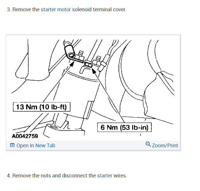

It sounds like the starter motor has gone bad again, but to be sure use a test light on the starter trigger wire when the key is in the crank position. If it lights up the starter is bad.
This guide can help you confirm the failure:

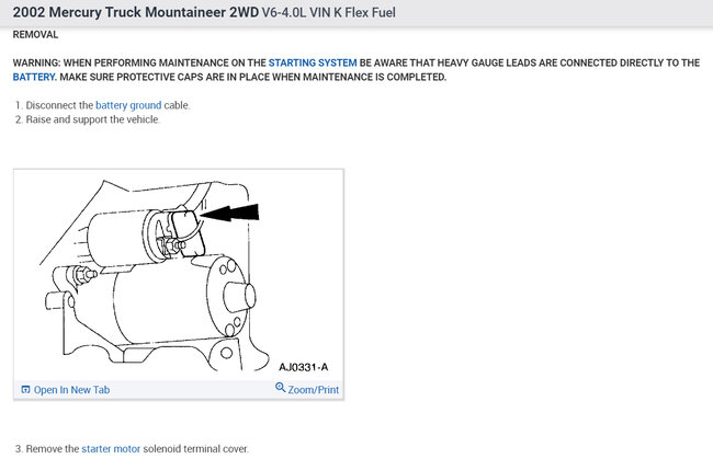

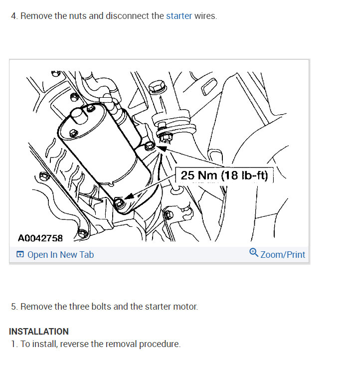

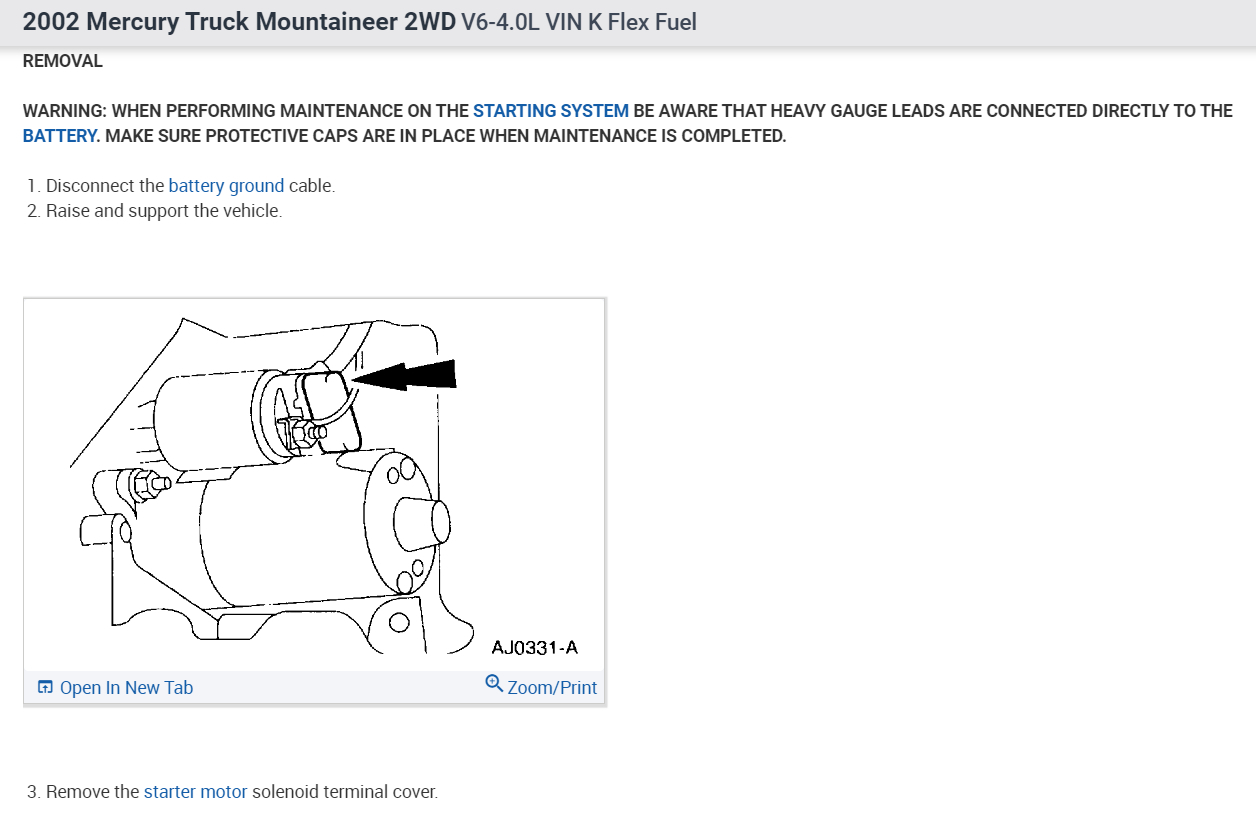

Here is how to change out the starter motor in the images below. Please let us know what happens.
Dec 31, 2022 at 3:51 AM

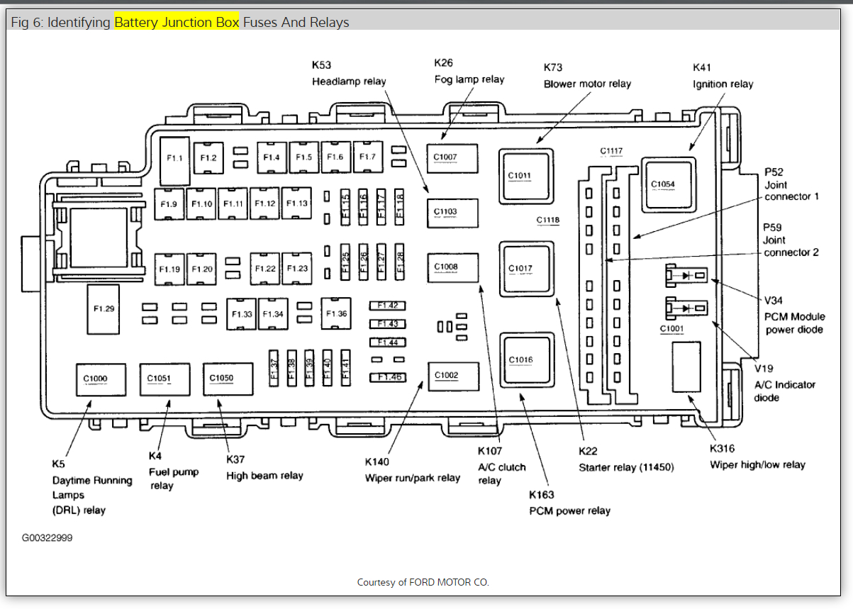

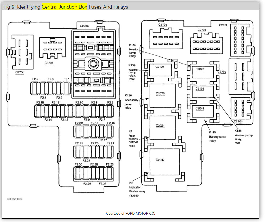

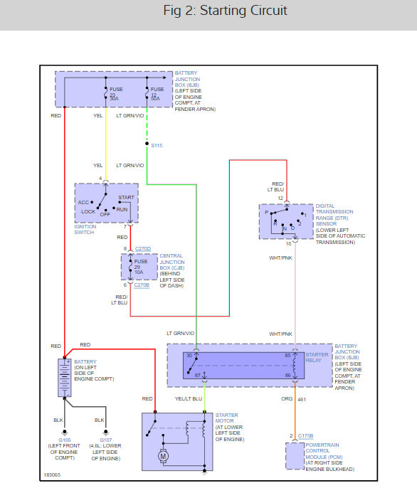

That is a safety procedure most cars have. The starter relay is controlled by the PCM which has a brake light switch input, here is the starter system wiring diagrams so you can see how it works, also please check fuse # 23 and 12 in the fuse panel under the hood, and fuse # 29 in the interior fuse panel.

The PCM controls when the engine can crank over which could be bad, as you can see by the starter circuit wiring diagrams. Other than that, I would check the wiring and then replace the PCM. Can i ask if the battery to body ground is in good shape?

Hi guys. I'm waiting to learn the solution. In the meantime, I haven't seen any reference to the neutral safety switch. Could a vehicle have a backup provision designed in where pressing the brake pedal bypasses or overcomes the defective neutral safety switch or transmission range sensor? Those commonly fail by being intermittent which would explain why the brake pedal isn't needed every time.
