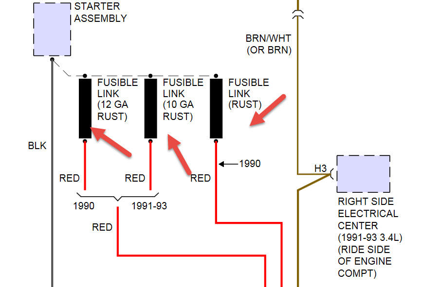

Car dies while I'm driving. I have replaced the battery and the altenator and it is still doing the same thing. I also checked fuses. I thought maybe I got a bad altenator so I took it back and it still dies as soon as the battery is ran out

Check items I pic probably one or all are burnt up auto parts has them
