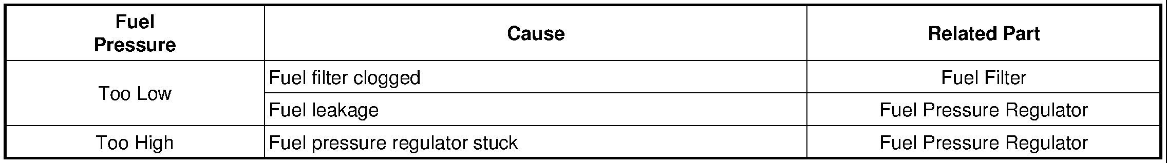

4. Measure Fuel Pressure.
(1)Start the engine and measure the fuel pressure at idle.
Fuel Pressure:
480 - 520 kPa (4.9 - 5.3 kgf/cm2, 69.6 - 75.4 psi)
NOTICE:
If the fuel pressure differs from the standard value, repair or replace the related part (Refer to the table below).

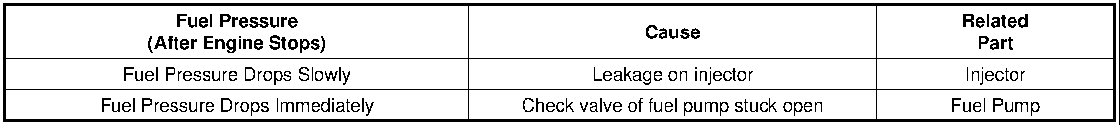

(2)Stop the engine, and then check for the change in the fuel pressure gauge reading.
Standard Value:
The gauge reading should hold for about 5 minutes after the engine stops
NOTICE:
If the gauge reading should not be held, repair or replace the related part (Refer to the table below).
picture 3

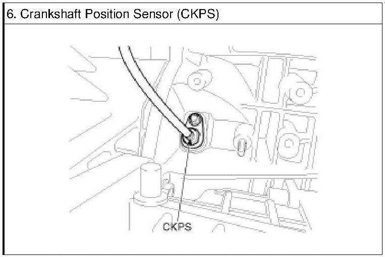

If fuel pressure is good, my next suspect is a faulty crankshaft position sensor. Take a look through this link and let me know if it mirrors what you are experiencing.
If it does, here is a link that shows in general how one is replaced.
If the description in the symptoms link fit your problem, follow step 4. Keep in mind, the best way to check the sensor is using a live data scanner to see if the engine's RPM signal is lost when it stalls. If it does, the sensor is most likely bad or there is a wiring problem
Here are the directions specific to your vehicle for sensor replacement. Again, the attached pictures correlate with these directions.

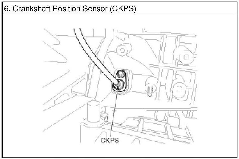

Note: The last two pictures show sensor location and the sensor.

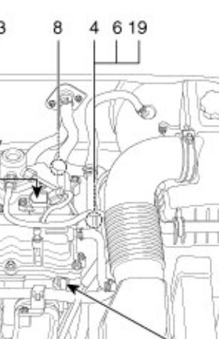

Pictures 14 and 15 indicate sensor location and sensor.
