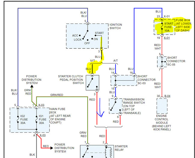

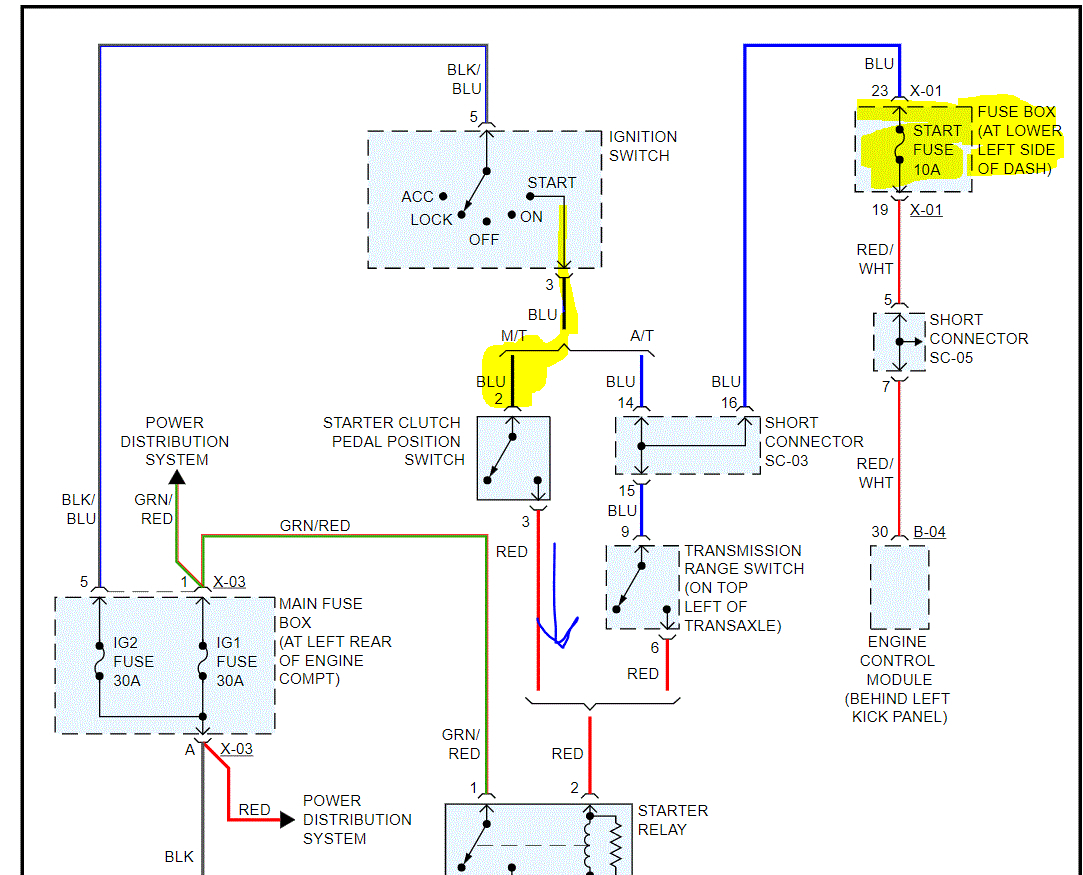

What we need to do is start checking a few things. First, I attached a pic from the wiring schematic below. I highlighted a fuse I need you to check. In addition to just checking the fuse, confirm there is power to and from it. Here is a link that helps explain how to do this:
Now, if the fuse is good and there is power, the next thing I need you to do is confirm there is power into and from the clutch safety switch. It is located at the top of the clutch pedal. I highlighted it and the arrow shows the direction of power out. Note that the key needs to be in the start position when testing and the clutch will need depressed to check for power out.
