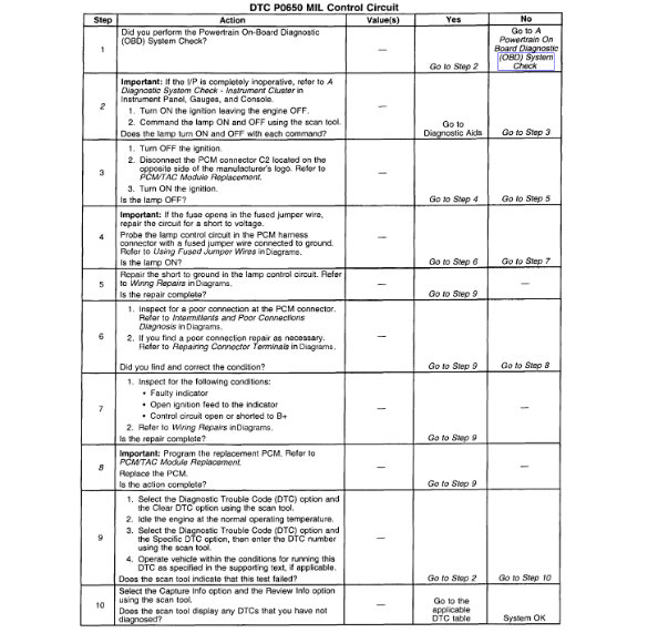

Good idea, even though I do not like the dealer for what they did. also if I disconnect the battery, wait an hour reconnect turn the key to acc and wait twenty seconds the car will start and run like normal. I checked the codes and p0650 comes up.

Good afternoon,
Just as Steve suggested, it sounds like a connection somewhere from the repair.
Below is an explanation of the code for you to view.
Circuit Description
A voltage is supplied directly to the Malfunction Indicator Lamp (MIL). The PCM controls the lamp by grounding the control circuit via an internal switch called a driver. The primary function of the driver is to supply the ground for the component being controlled. Each driver has a fault line which is monitored by the PCM. When the PCM is commanding a component ON, the voltage of the control circuit should be low (near 0 volts). When the PCM is commanding the control circuit to a component OFF, the voltage potential of the circuit should be high (near battery voltage). If the fault detection circuit senses a voltage other than what is expected, the fault line status will change causing the DTC to set.

Test Description
The numbers below refer to the step numbers on the diagnostic table.
2. Command both the ON and the OFF states. Repeat the commands as necessary.
8. If you do not find trouble in the control circuit or the connection at the PCM, the PCM may be faulty. However, this is an extremely unlikely failure.
