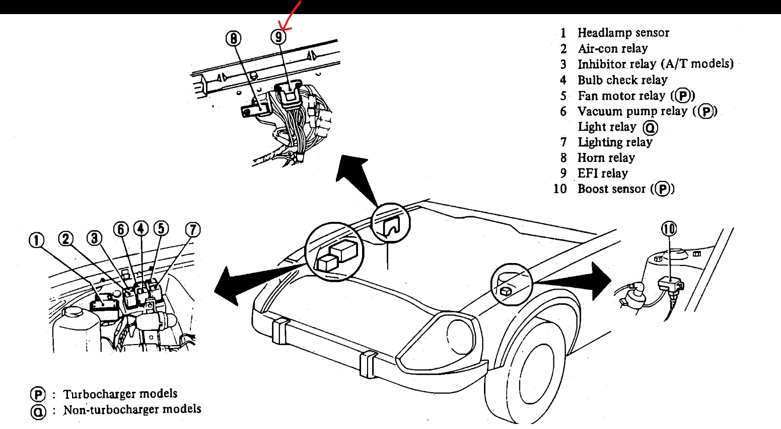

I have a 1982 Datsun 280zx that has developed some problems. It's an L28ET. It started having issues with idling, it will die if you don't press the gas and brake pedal. But it wouldn't restart. It has brand new alternator, starter, fuel pump, fuel filter, spark plugs, thermostat, rebuilt radiator, belts, and some hoses. Replaces all exhaust system as well as fuel lines. The check engine light also came on before. Any ideas what could be the problem? Would be greatly appreciated. Thanks.

scan for codes and check fuel pressure with a gauge auto parts rent it. check fuses and efi relay also see if it gets a good spark

I have seen the EFI relay go out in these cars and cause this problem. Here is the location so you can swap it out which should fix the problem. Check out the images (below). Please let us know what happens.
