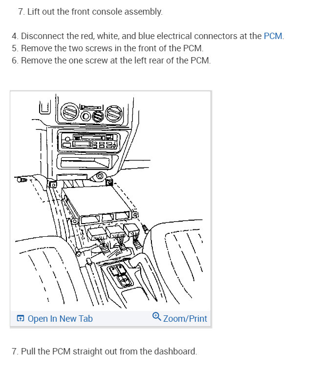

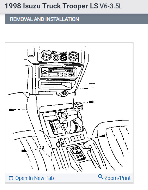

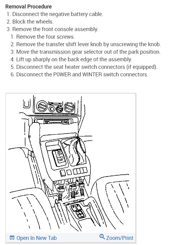

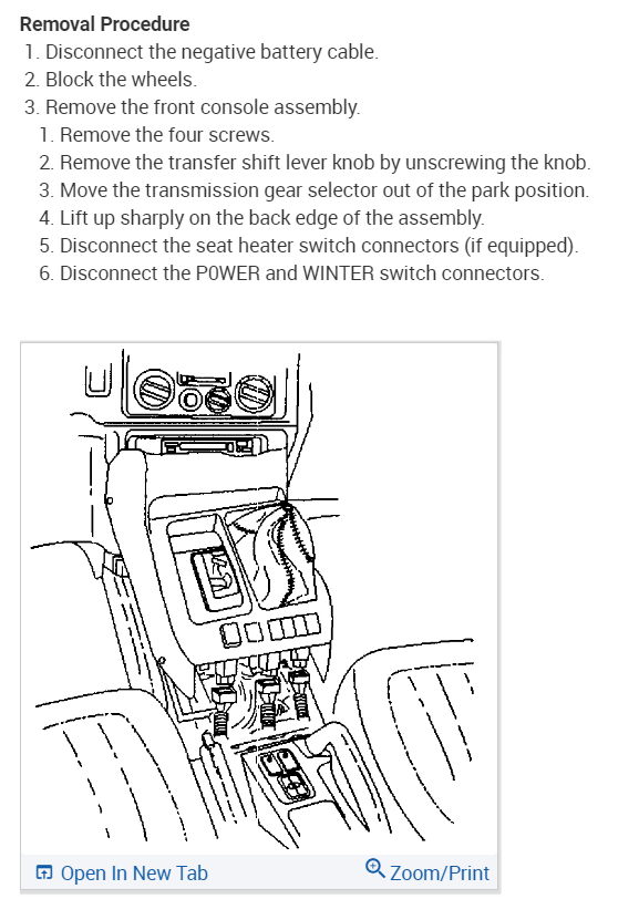

The ECU is plug and play so no programming is needed. But I have seen if a fuel injector, oxygen sensor or ignition coil is shorted it will cause the ECU to put out low voltage. I would unplug these items to see if the voltage returns. Also, can you run the codes to see if any are stored?
Here is how to replace the ECU in case you need it. Check out the images (below). Please let us know what you find.
