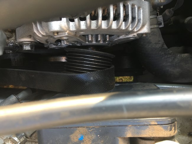

The alternator pulley seems to have damaged tracks and when attempting to start the car once I replaced the belt, the pulley bent. I’ll see about the audio tomorrow. My guess is after running on the minor deformation as the alternator was recently replaced the belt eventually slipped and snapped.

Wow! That thing just snapped off! I hope they parts warranty it for you if you just had it recently installed. Alternator looks pretty fresh. After you remove the alternator you should inspect all the other pulleys and the tensioner.

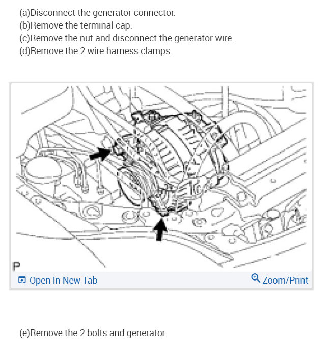

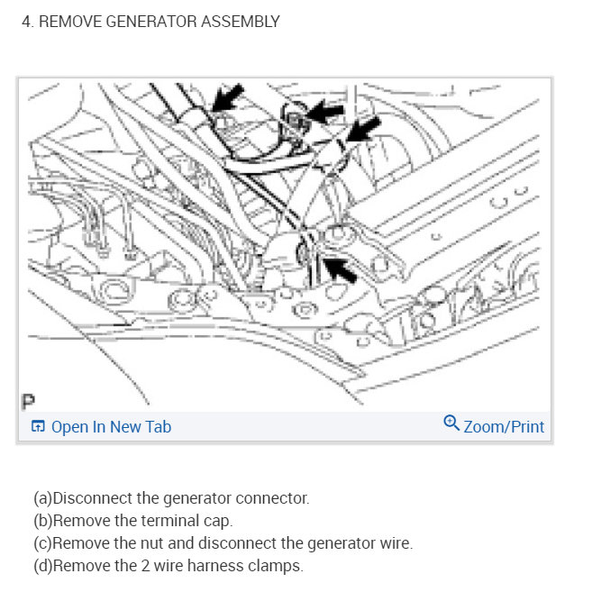

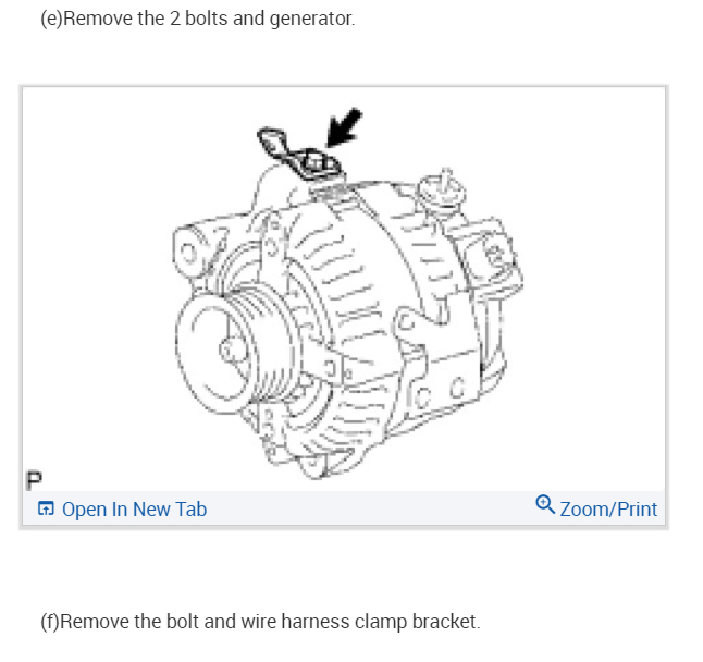

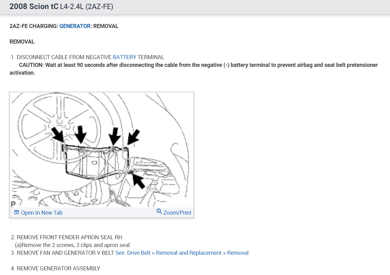

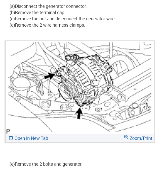

Here is a guide that will walk you through the alternator replacement with diagrams below to show you how on your car:
https://www.2carpros.com/articles/how-to-replace-an-alternator
