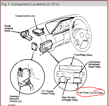

So I recently sold my car to a guy offline. The car was running very well before I sold it, it just needed a new battery. It always started right up when I jumped it and never had a issue not starting. Well the guy who bought the car replaced the battery, well after driving the car for a little while he turned it off and when he came back out to restart it, the car would not start. Relay switch is clicking over. But not getting power to fuel pump. What do we need to look at and or replace?
Dec 14, 2018 at 8:49 AM
DANNY L
  • 5,648 POSTS
Hello, I'm Danny,
I would check the fuel pump cut off relay. I've attached a tutorial showing how to test.
This guide can help as well
I've also attached a picture of where it's located. Hope this helps and thanks for using 2CarPros.
