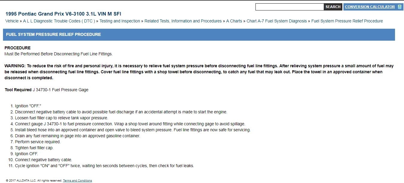

The fuel pump can be working, but not putting out quite enough pressure. Go to AutoZone, Advance Auto, or O'reilly's and borrow a fuel pressure tester gauge. This will let you know exactly how much pressure you are getting. In particular, test it when it will not start. With the engine off, and key on, you should get between 40.5 and 47 psi. At idle speed, it will be a little lower than that, but ALLData does not give an exact number.
The attached image is a how-to on relieving fuel pressure.
And this is our how-to guide on testing fuel pressure: https://www.2carpros.com/articles/how-to-check-fuel-system-pressure-and-regulator
Do that and get back to us.

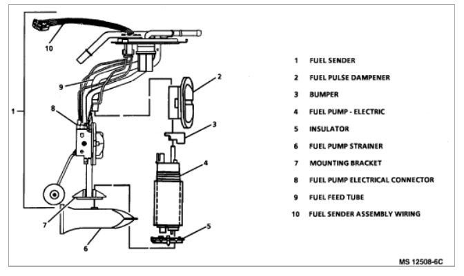

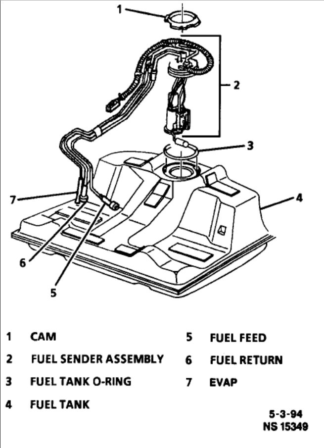

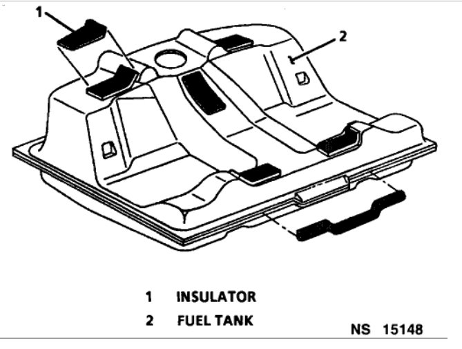

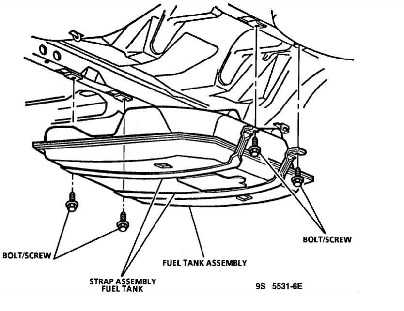

Have you run the codes? it might give us a clue such as crankshaft angle sensor problem. Here is a guide to help us see what's going on.
It does sound like the fuel pump is getting weak though. Here is a guide that will help you see what you are in for when replacing the fuel pump.
https://www.2carpros.com/articles/how-to-replace-an-electric-fuel-pump
Here is what it will be like on your car (below)
