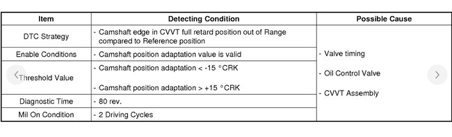

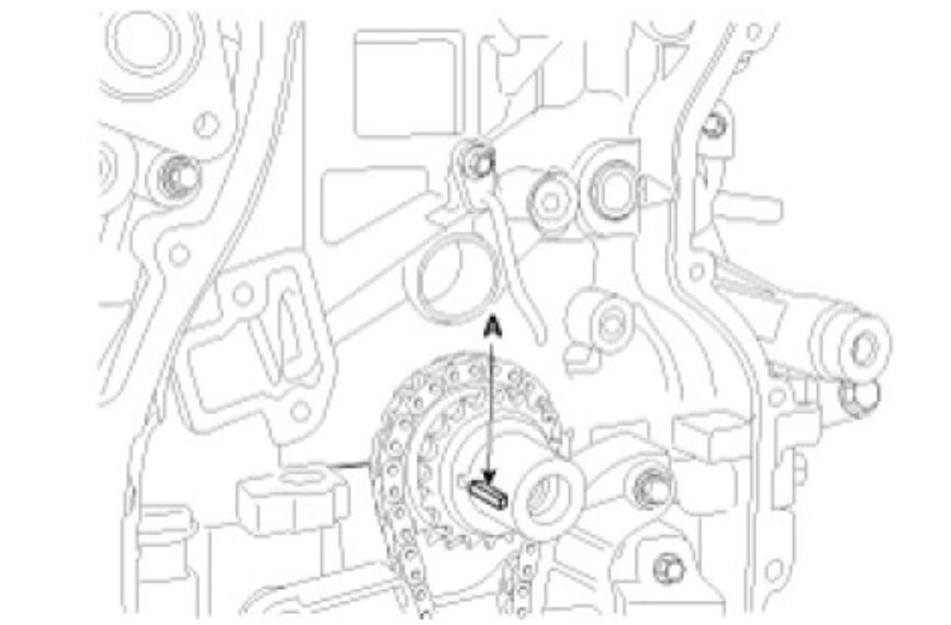

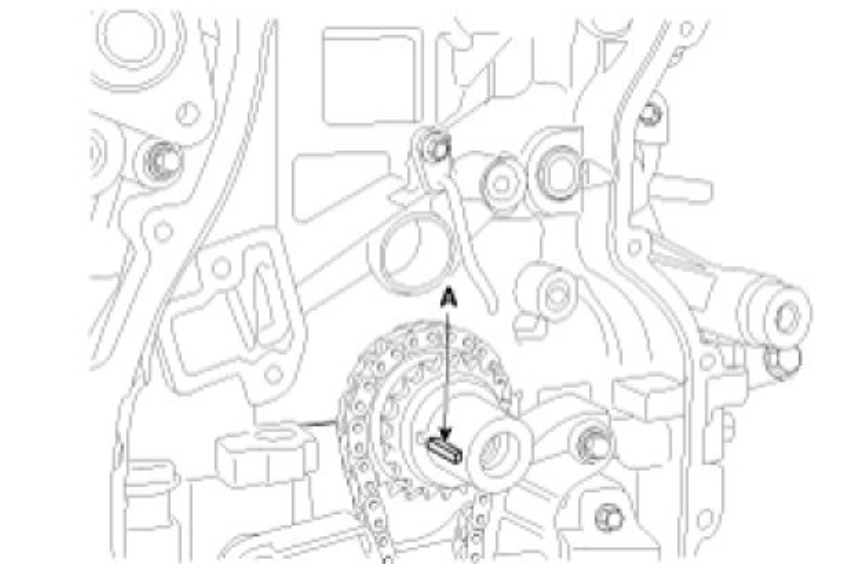

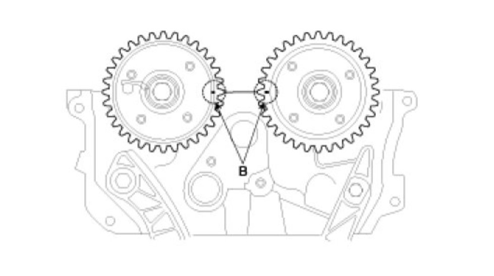

Okay, the 16 code is not for the crank sensor. It is a correlation code between the cam and crank sensor. What this means is the timing may be out between the cam and crank.
The front cover should be removed and timing marks verified to be accurate.
I would start there.
General Description
The CVVT (Continuously Variable Valve Timing) system is installed to the chain sprocket of the camshafts. This system controls the camshaft to provide optimal valve timing. The PCM controls the Oil Control Valve (OCV), based on the signals output from air flow, throttle position and engine coolant temperature. The CVVT controller regulates the camshaft angle using oil pressure through the OCV. As result, the relative position between the camshaft and the crankshaft becomes optimal, and the engine torque improves, fuel economy improves, exhaust emissions decrease under overall driving conditions.

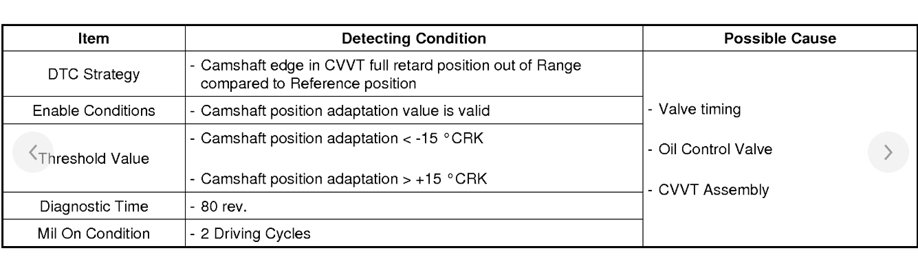

DTC Description
DTC P0016 is set when the actual camshaft position is retarded beyond the reference value. This condition may be caused by incorrect mechanical timing.
DTC Detecting Condition
Signal Waveform & Data

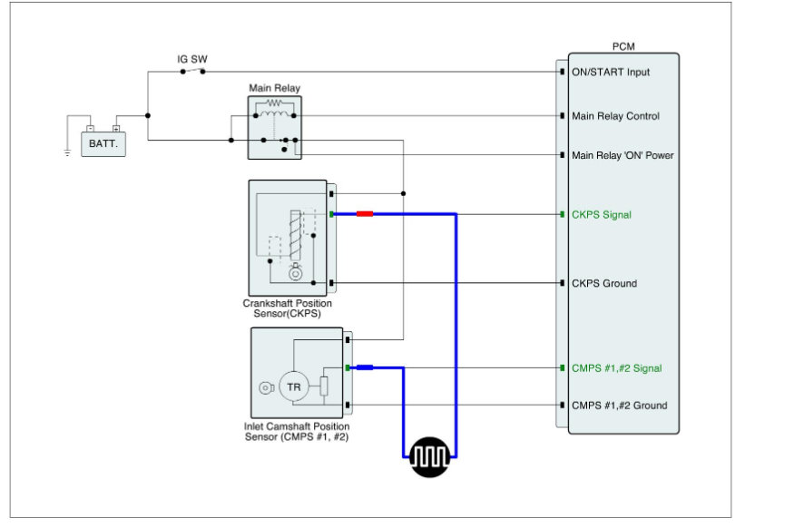

The automotive place that diagnosed the problem going by what their scanner said, that it could be P0335.
Jan 3, 2020 at 7:09 AM
Okay, where did the 16 code you gave me come from?
If they went by the code number, very rarely does a code identify a failed part, just a failed system. Diagnostics need to be done to verify the failure before throwing any parts to it.
I posted below a description and flow chart for you.

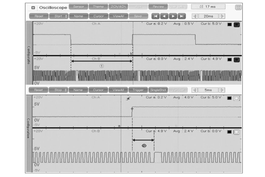

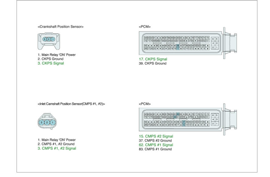

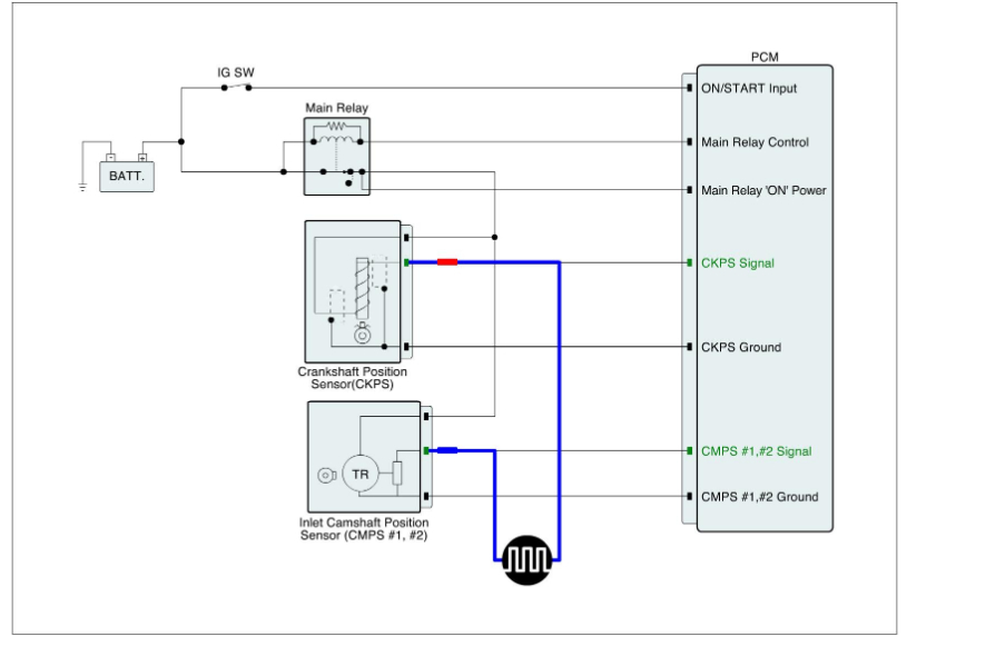

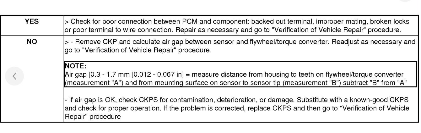

P0335 Crankshaft Position Sensor 'A' Circuit
Inspection/Repair - Component Inspection
1. Set up an oscilloscope as follows :
(1)Channel A (+): Signal terminal of the CMPS #1 (back probe), (-): ground
(2)Channel B (+): Signal terminal of the CKPS (back probe), (-): ground
2. Start the engine and check for signal waveform compared with reference waveform as below.
1 There are 60 signals of CKPS (Including missing tooth) during the semi-cycle of CMPS #1.
2 There are 3 - 5 signals of CKPS between the switching point of CMPS #1 and the missing tooth of CKPS.
3. Is the signal waveform normal?
