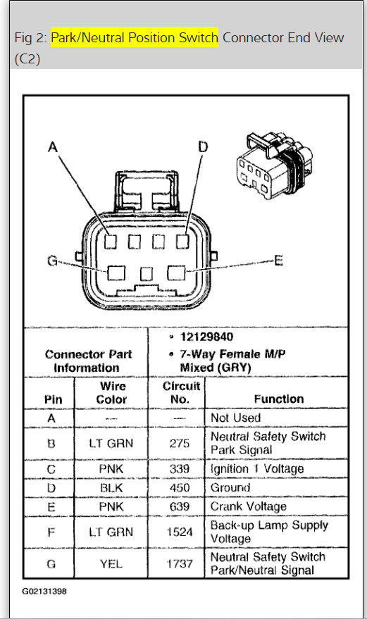

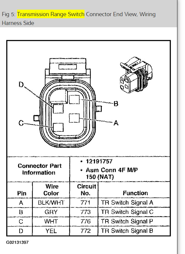

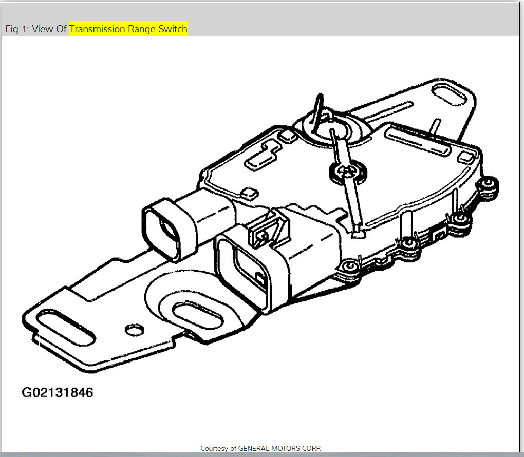

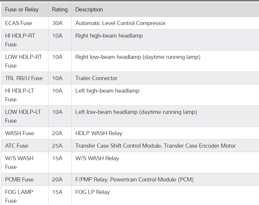

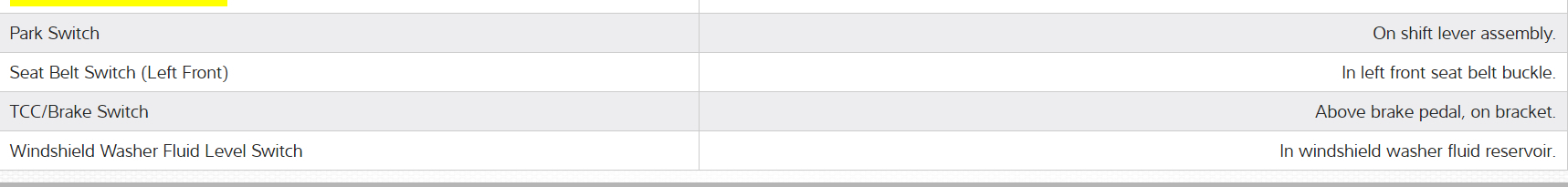

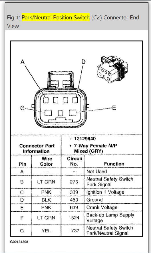

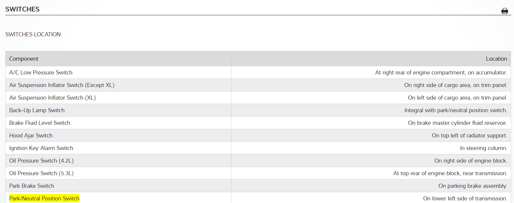

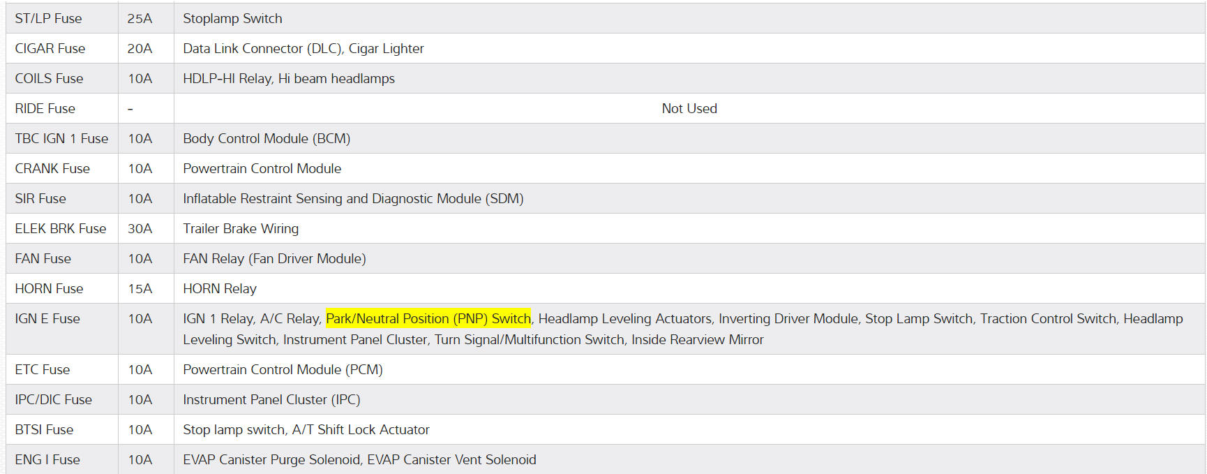

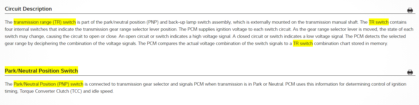

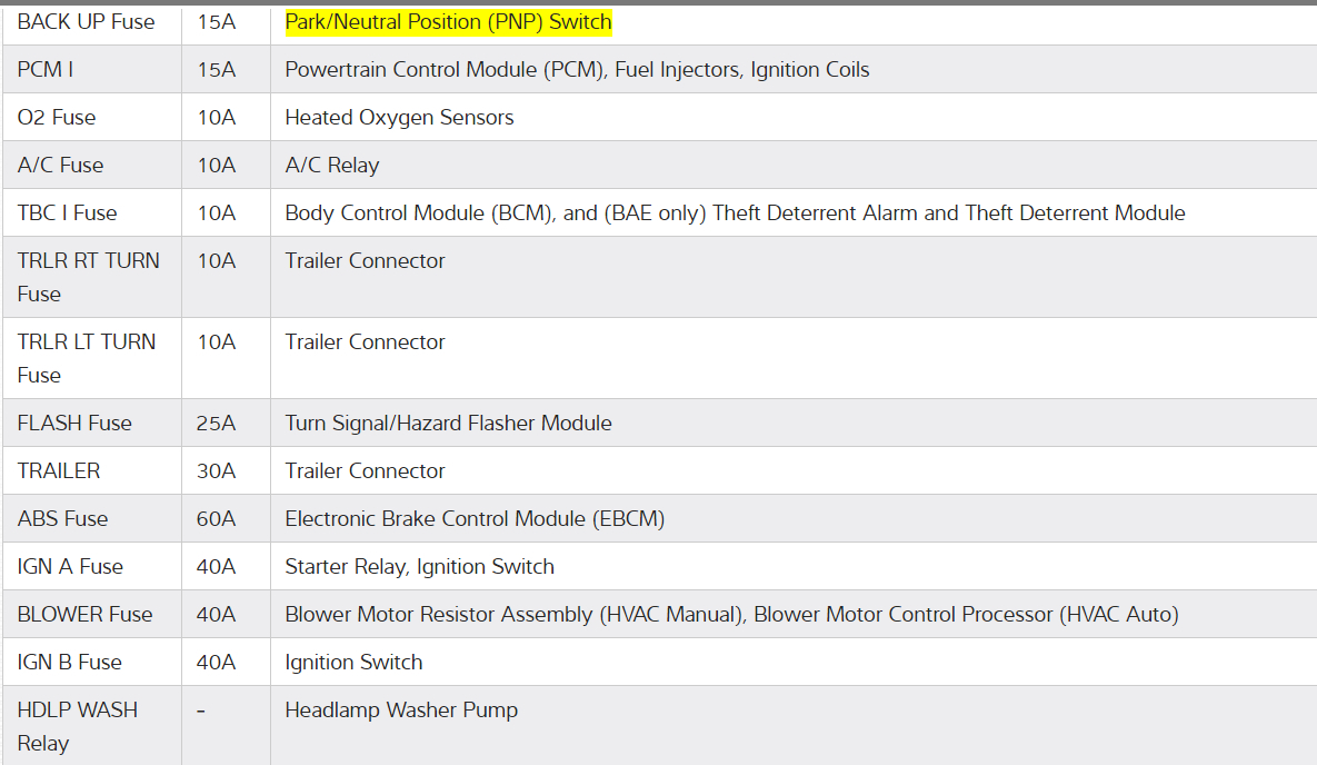

I had to get a replacement lever box and shift cable, once these had been replaced I am unable to get the starter to work?
Feb 22, 2019 at 9:27 PM
SCGRANTURISMO
  • 4,897 POSTS

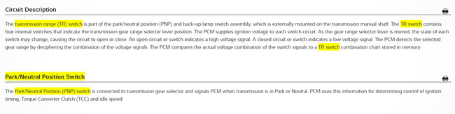

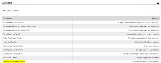

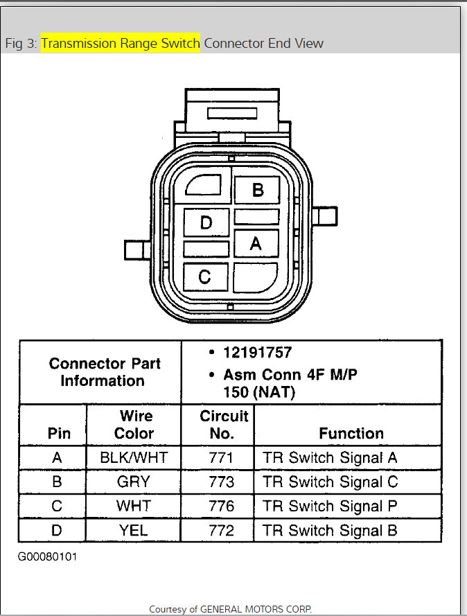

This could be a problem with your neutral safety switch. I have included in the diagrams down below. Troubleshooting, adjustment, location, and wiring diagrams for this system on your vehicle.
This guide can help us fix it or see whats wrong.
and
Please go through this information and let us know what you find out. Check out the diagrams (Below). Please run this test and get back to us.

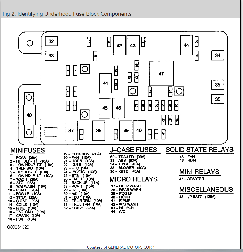

Car who driving fine, started the car after it sitting for 45 mins to put down the window. While the car was running, heard a pop and the car died.
I have all interior and das lights, headlights but no power to the engine. It was turning over yesterday out instantly blows a fuse. Now it won't turn over but blows a fuse instantly without starting.
Oct 28, 2020 at 6:19 AM (Merged)
CARADIODOC
  • 34,383 POSTS
Without knowing what that fuse feeds it's impossible to know where to start looking or what to suspect first.
A simple trick to finding a short is to replace the blown fuse with a pair of spade terminals, then use small jumper wires to connect them to a 12 volt light bulb. A brake light bulb works well. When the circuit is live and the short is present, the bulb will be full brightness and hot so be sure it's not laying on the carpet or against a plastic door panel. Now you can unplug electrical connectors and move things around to see what makes the short go away. When it does, the bulb will get dim or go out.
