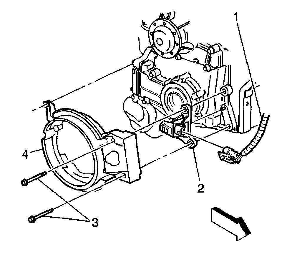

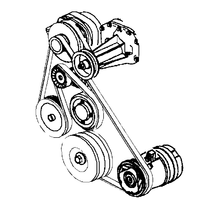

Just changed the fuel pump, check engine light started flashing, now car will not start.
Sep 2, 2018 at 12:27 AM
  • 110,240 POSTS
If the check engine light was flashing, that indicates a misfire. First, scan the computer to determine what codes are stored in the computer.
https://youtu.be/YV3TRZwer8k
Next, confirm the new fuel pump is producing the proper amount of fuel pressure. Here is a link showing how it is done:
With the key on and engine off, the pressure should be 48-55 psi
If that checks okay, next you need to check if there is spark to the spark plugs. Here is a link that shows how:

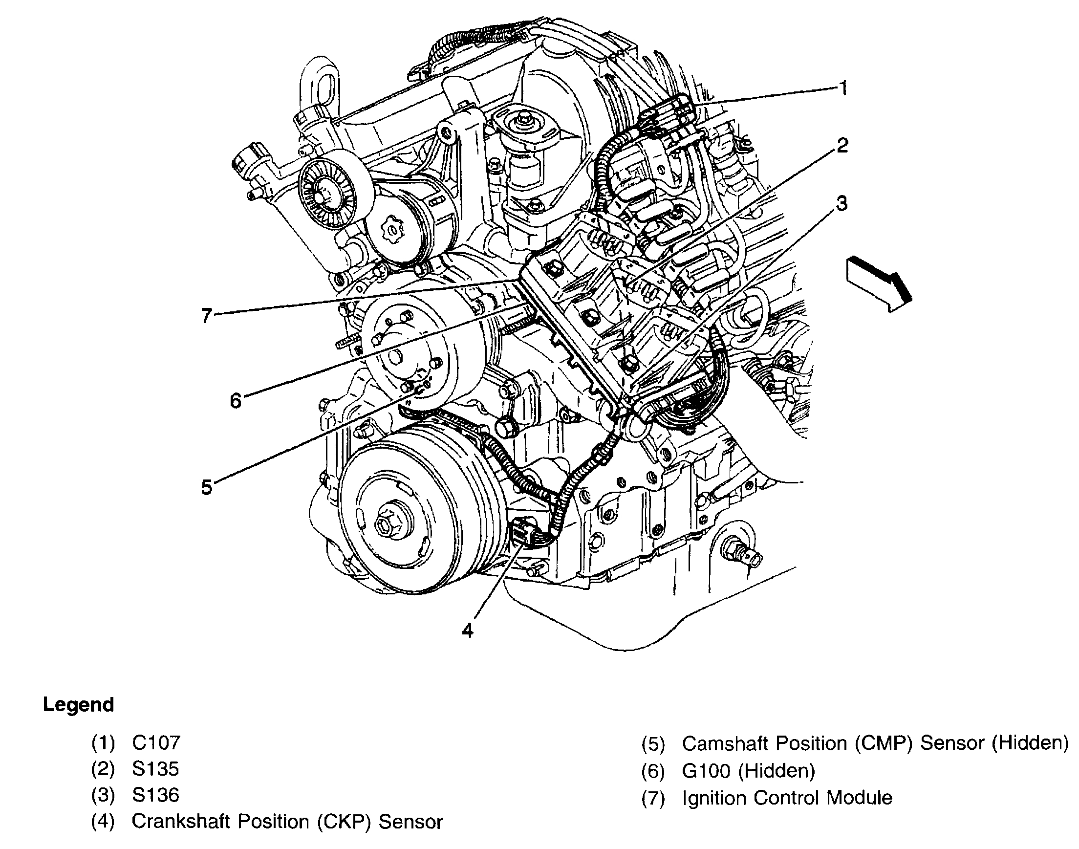

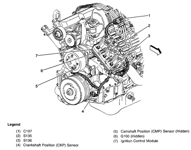

If there is no spark, suspect a bad crankshaft position sensor. Picture 1 indicates its location.

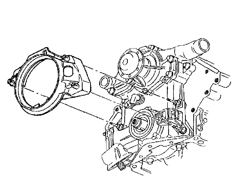

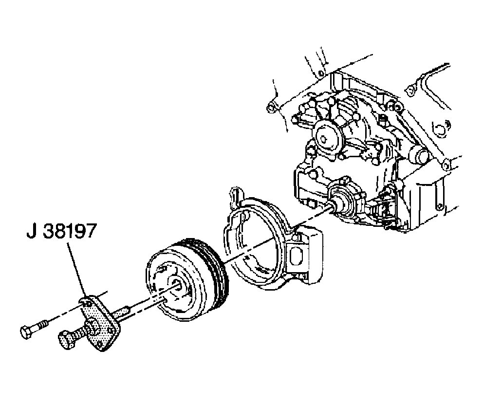

I realize you indicated little knowledge, but here are the directions for sensor replacement if you decide you would like to do it. Starting with picture 2, all pictures correlate with these directions.
______________________________________
REMOVAL PROCEDURE
TOOLS REQUIRED
^ J 36660 Torque/Angle Meter
^ J 37096 Flywheel Holding Tool
^ J 38197 Balancer Remover
CAUTION: Refer to Battery Disconnect Caution in Service Precautions.
1. Disconnect the negative battery cable.

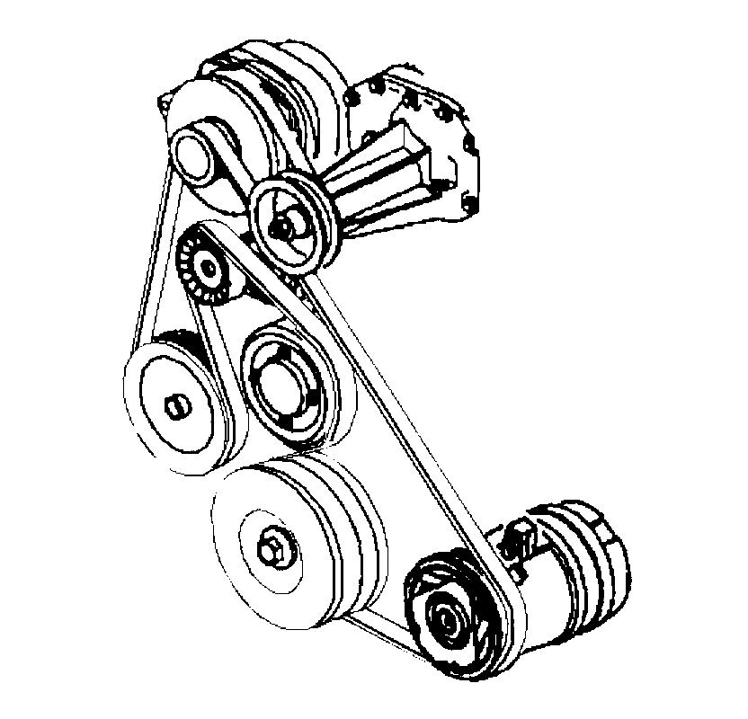

2. Remove the serpentine belt(s) from the crankshaft pulley.
CAUTION: Refer to Hoist Caution in Service Precautions.
3. Raise the vehicle on a hoist.
4. Remove the right front wheel and tire assembly.
5. Remove the right inner fender splash shield.
6. Remove the flywheel inspection cover.
7. Hold the flywheel with J 37096 Flywheel Holding Tool.
8. Using 28 mm socket, remove the crankshaft harmonic balancer retaining bolt.
9. Remove the crankshaft harmonic balancer using special tool J 38197 Balancer Remover.

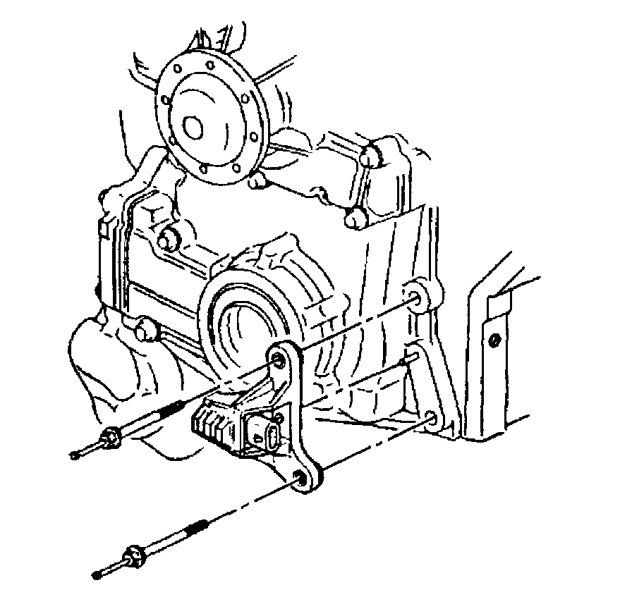

10. Disconnect the sensor electrical connector (1).
11. Remove the crankshaft position sensor shield. (Do Not use a pry bar).

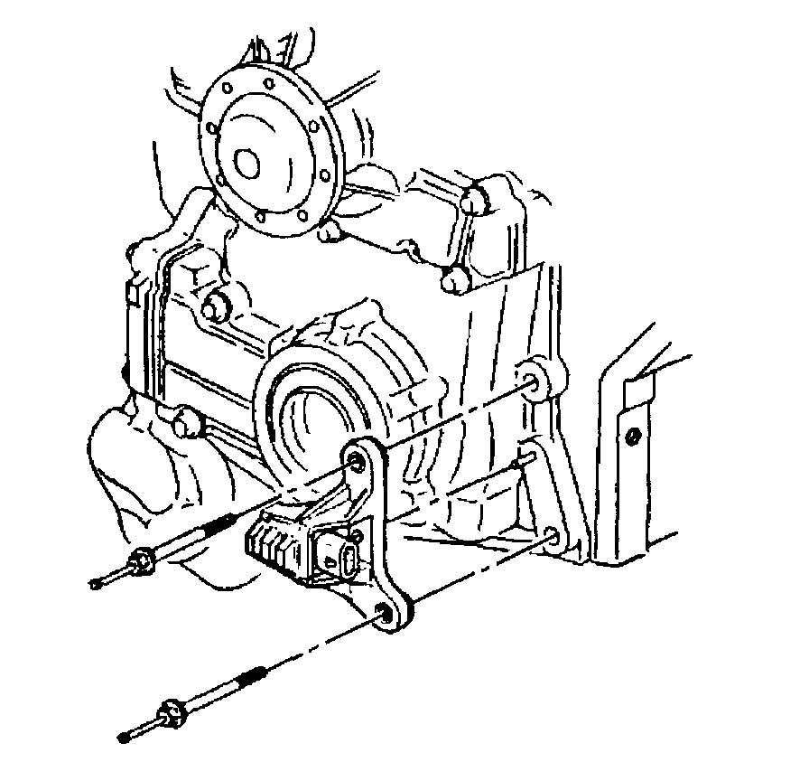

12. Remove the 2 attaching bolts from the crankshaft position sensor (3).
13. Remove the Crankshaft Position (CKP) sensor from block face.
INSTALLATION PROCEDURE
1. Position the crankshaft position (CKP) sensor to the block.
NOTE: Refer to Fastener Notice in Service Precautions.
2. Install the bolts to hold the CKP sensor to the block face.
Tighten
Tighten the bolts to 30 N.m (22 lb ft).

10. Install the serpentine belt(s) from the crankshaft pulley.
