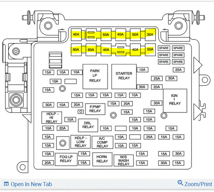

BEN KRAMER
I am not sure if these two issues are related, but lets see what we can find out.While driving the SUV home I noticed that the blinker would work. No dash light. Nothing. Then the next time I tried to start the SUV it wouldn't turn. Full battery charge, etc.
May 19, 2021 at 2:36 PM (Merged)
  • 110,194 POSTS
If I understand, nothing is working now. Do things like the headlamps, horn, radio, or anything at all work? Although the battery is fully charged, are the terminals clean and tight? Take a look through this link:
Next, I attached a picture of the under hood fuse box. I want you to check what are called the mega fuses. These are heavy duty fuses the power many of the smaller fuses and accessories.
Here are a few links to help when checking the fuses. Do me a favor. In addition to just checking the condition of the fuse, confirm there is power to it.
_______________________
Please let me know if this helps. Also, let me know if anything is working at this time.

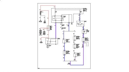

Tahoe will not crank. battery has power, connections are tight when key goes to start position, all the gages go blank and no power, but there is power in the other key positions. The gear selector dose not show what gear it is in on the dash. when I unplugged the ignition switch, the car acted exactly the same. The OBDII scan tool will not communicate with the car it turns on, but when it goes to communicate it says error, check connection. the yellow wire from the ignition switch and the fuse dose not have continuity (fuse i tested was the fuse box on the left side of dash-ignition fuses). tried adjusting the neutral safety switch, no change.
any suggestions?
JDL
  • 16,098 POSTS
Welcome to the forum. I looked at the starter circuit for 5.3, all the fuses for that circuit appear to be in the underhood fuse box. The yellow wire goes from the ign switch to the crank fuse underhood. I'd check the circuits at the starter relay, underhood fuse box. Voltage for the coil side of relay is hot all the time. Voltage for coil side of relay goes hot with the key in the crank position. Any testing you do at the relay, make sure the tranny is in park or neutral and the e-brake is set.
https://images.2carpros.com/forum/automotive_pictures/170934_obd11_7.jpg
As far as communicating with the computer, check for voltage at pin 16 of datalink connector, that terminal should be hot all the time, if it isn't hot, check the cigar fuse circuit. This guide will help https://www.2carpros.com/articles/starter-not-working-repair and https://www.2carpros.com/articles/checking-a-service-engine-soon-or-check-engine-light-on-or-flashing Please run down these guides and report back.

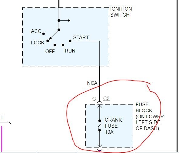

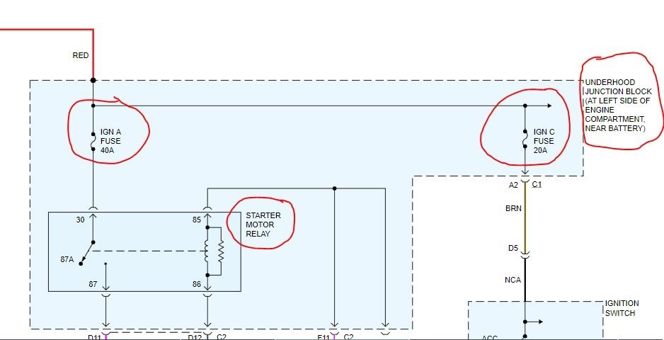

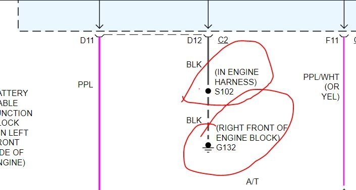

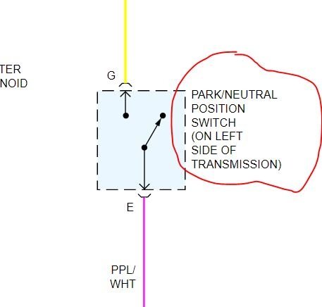

TIFFANY LEE
the starter went out so I replaced it. I have broke my ignition because I lost the keys and it was dead when I tried to start it. so I got to jump and it wouldn't roll over or make a sound, but all the lights and everything are working.
May 19, 2021 at 3:08 PM (Merged)
  • 110,194 POSTS
Welcome back:
Have you replaced the ignition switch lock? If you have, are you certain it is properly installed and actually turning the ignition switch (electrical portion) to the start position?
Let me know. Also, if you have replaced the key, was it programmed to recognize the new key?
TIFFANY LEE
No, I did not program it to recognize the new key. I am not exactly sure how to do that and yeah when I was turning the key it would turn the power on and then it would like I could feel it going to like the turn on position just it didn't do anything.
  • 110,194 POSTS
Welcome back:
I suspect the immobilizer has it shut down because it doesn't recognize the new key. Try this. Turn the key to the run position (engine off) for about 10 minutes. If the security light is on, it should turn off after that amount of time. If it does, see if it starts.
If the security light is not on, let me know.
If that doesn't do it, you will need specialized tooling to reprogram the system to accept the new key.
TIFFANY LEE
but before I replaced the new ignition the after I replace the starter is when it started doing it before I even touch the new ignition or put the new key or anything in
  • 110,194 POSTS
Welcome back:
Okay if it happened before switch replacement and before the starter replacement, the old starter may have blown a fuse, you may have lost ground, or the neutral/park switch may have failed.
First, the first two pics below show fuses that need checked as well as the starter relay. Check those first.
Second, pic 3 shows the neutral/park switch. See if the engine starts in neutral or any other gear.
Third, pic 4 shows the ground for the starter relay. You need to confirm both the ground and the splice (both circled) are good and there is a ground path for the starter relay.
Here are a few links you may find helpful:
and
Check out the diagrams (Below). Let us know what happens and please upload pictures or videos of the problem.
TIFFANY LEE
It started doing it after I change the starter but before I did the ignition. so I changed the ignition thinking that was what it was. but I'm going to go ahead and check out and do whatever you said to do and I will get back to you.
