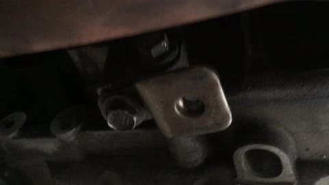

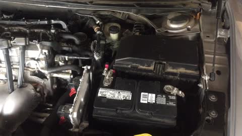

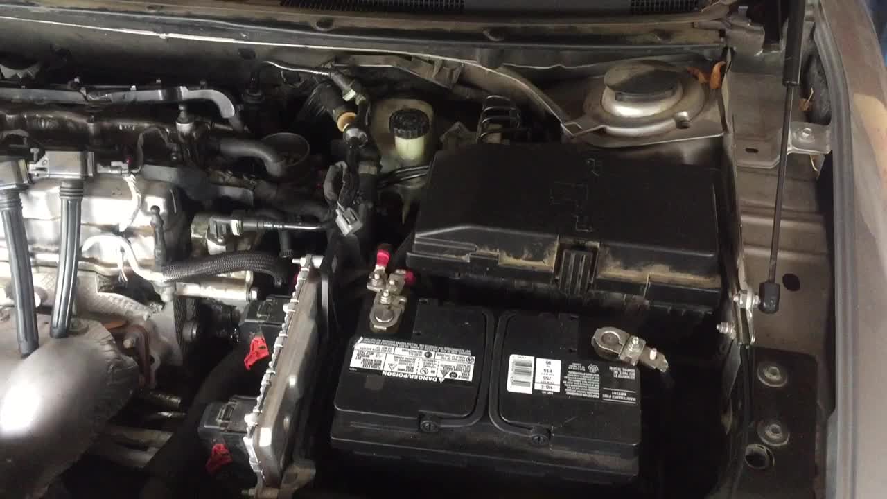

Okay, we just tried again with the second new starter. I am sending video. This is with the spark plugs out. And after trying it again the starter got extremely hot.
Jan 5, 2019 at 4:27 AM
  • 110,240 POSTS
Welcome back:
That's isn't good. The starter can't turn the engine and I think that's why it's smoking. Are you able to turn the engine from the crankshaft with a ratchet or breaker bar?
Also, since it was in that much water, did you check the oil to make sure it isn't full of water? It should turn really easy with the plugs out because you eliminate the engine's compression. I think I heard someone say they were going to remove the starter. Do that, send me a picture of the gear in the Bendix, and take a flash light and inspect the flywheel teeth that the gear engages with for damage.
If you can turn the motor by hand at the crankshaft and the teeth on the flywheel are in good shape, try a different brand starter. Also, please let me know if this is a 4 cylinder or a v6.

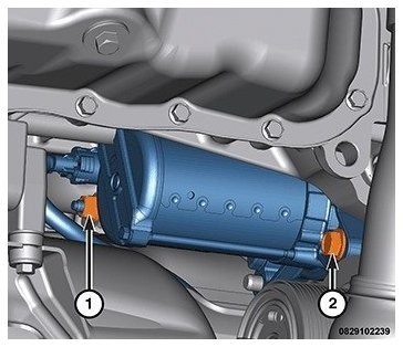

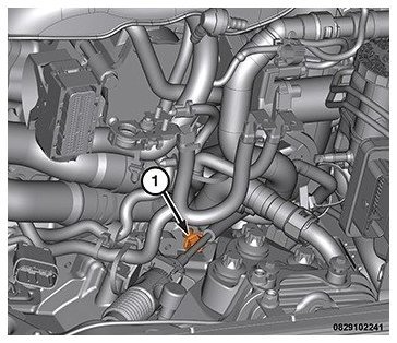

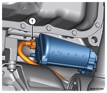

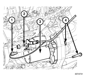

Here are the specific directions for starter install for the 4 cylinder. Read through them to make sure you are getting it together correctly. The first three pics are for this set of directions.
___________________________________________
STARTER - INSTALLATION
2.4L
1. Position the starter to the vehicle.
2. Connect the solenoid wiring harness connector (1) to the starter.
3. Tighten the lower starter mounting bolt (2) to the proper torque specificationsSee: Starting System > Mechanical > Torque Specifications.
4. Connect the B+ wiring harness connector (1) to the starter.
1. Install the half shaft. See: Axle Shaft Assembly > Removal and Replacement.
2. Install the tighten the upper starter mounting bolt (1) to the proper torque specificationsSee: Starting System > Mechanical > Torque Specifications.
1. Position and secure the B+ PDC cable harness.
2. Install the battery tray. See: Battery Tray > Removal and Replacement > Battery Tray - Installation.
3. Install the PDC. See: Fuse Block > Removal and Replacement.
4. Connect the negative battery cable. If equipped with an Intelligent Battery Sensor (IBS), connect the IBS connector to the negative battery cable.
_______________________________________________________

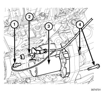

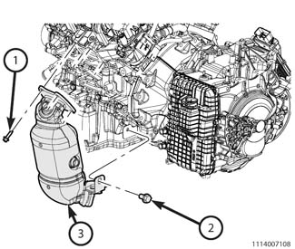

Here are the directions for replacing the starter on the V6. The last two pics correlate with these directions.
3.6L
1. Position the starter (3) inside the transmission.
2. Install the starter mounting bolts (4) and tighten to the proper torque specificationsSee: Starting System > Mechanical > Torque Specifications
3. Connect the starter solenoid electrical connector (1) to starter solenoid terminal.
4. Install the battery cable and nut to the solenoid stud (2). Tighten the nut to the proper torque specificationsSee: Starting System > Mechanical > Torque Specifications
5. Install the catalytic converter (3) See: Catalytic Converter > Removal and Replacement > Catalytic Converter - Installation.
6. Lower the vehicle.
7. Connect the negative battery cable and tighten nut to the proper torque specifications
Make sure the wiring is correctly installed.
Let me know what you find.
