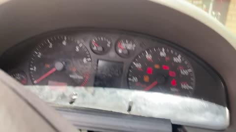

Sorry. Have been afk for a day. I’m going to record that for you Joe. Should be up in about an hour.
Jul 17, 2020 at 10:03 PM
MJPHILLIPS1411
  • 6 POSTS
The battery is a bit drained after the last guy spent an hour trying to turn it over and it sounded like it might have darn near started. But the battery is new and keeping charge. Pretty well for not having run for a month.

  • 110,240 POSTS
Thanks for getting that to me. It honestly doesn't sound like a timing issue. I did hear it fire a couple times. I read back through all the posts and am wondering if you have removed the plugs since installing them to make sure they are okay? If you remove them, see if they are wet. Also, you mentioned they were performance plugs. What kind of plugs were in it before and what was installed? Something isn't adding up.

4DRTOM
  • 467 POSTS
The more I go though this and I watched the short video you posted your starter is on a timer isn't it? Meaning you can't have the crank time be longer than shown on the video. Is that correct? I am convinced everything is operating properly right up the the spark plug itself and I don't thing the spark plug is faulty. I think the rings are washed out and the plugs are wet. So your getting some spark and some compression and the timer on the starter is preventing it to crank long enough to generate oil pressure to get the rings to lubricated. The combination of these three things is why isn't giving us such a challenge. If this is the case then try the following:
Pull all the plugs make sure there clean, spray each one with starting fluid and let them dry in the sun use a Q tip to get it dry down the side of the porcelain. Then pour about a teaspoon of oil in each cylinder. When you know the plugs are dry. put them back in and crank it over be ready right when the starter timer stops back the key off and try it again quickly. if there is not timer let it crank for 8-10 seconds. try this a couple of times. if you start to get action slowly press the gas pedal and feather up the rpm's if you can.
I hope it works, I do agree something doesn't make sense.
