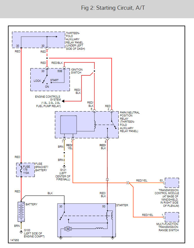

started car and drove into the garage to change headlights. When I was finished the car now will not start. Lights and blinkers work. There is no power getting to the starter solenoid. I tested the ignition and I seem to have power coming out of the back of the starter. When I put the key in the start position it transferred power to a red with black striped wire. What can it be?

I don't have power at all to the solenoid power wire.

Have you checked your fuses and relays? A blown fuse or burnt relay could be the problem.

Here is a guide and a starter wiring diagram to help you see where you are losing power.
Also is the security light flashing when you try and crank it over?
