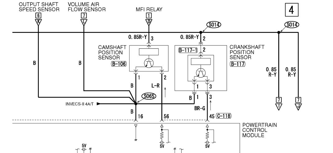

Alternate method (Test harness not available)
1. Connect the oscilloscope probe to ECM terminal No. 88. (Check the camshaft position sensor signal wave pattern.)
2. Connect the oscilloscope probe to ECM terminal No. 89. (Check the crankshaft position sensor signal wave pattern.)
1. Connect the oscilloscope probe to PCM terminal No. 56. (Check the camshaft position sensor signal wave pattern.)
2. Connect the oscilloscope probe to PCM terminal No. 45. (Check the crankshaft position sensor signal wave pattern.)

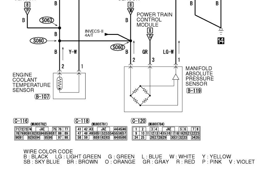

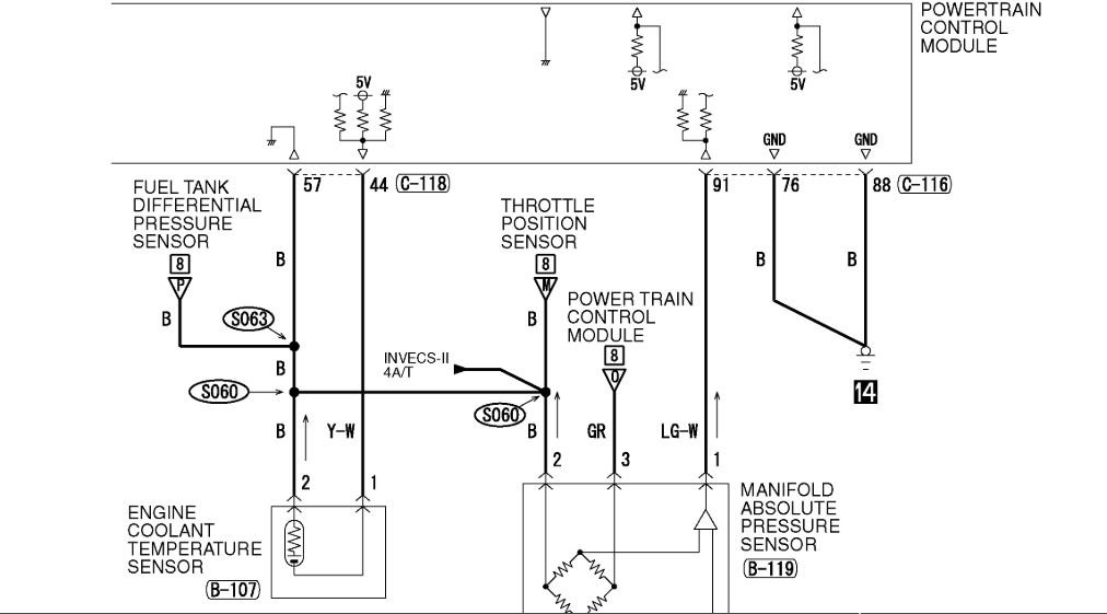

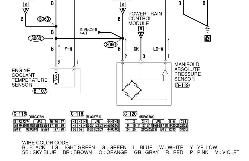

I attached 3 pics below. They are of the ignition / fuel systems. I had to break it into 3 pics so you could read them. I did overlap them so you could follow.
Let me know if that helps.
