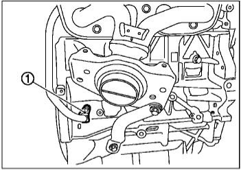

In the other codes that are present the P0335 is of concern to me. This code is the crank position sensor not sending a signal to the PCM. If that sensor is in fact bad the car will not start. After you've done the relearning of the accelerator pedal and the information in the throttle actuator article reset the codes with the scanner your using to get them or disconnect the battery and short the positive and negative battery cables to each other for 30 seconds, this will also erase the memory. Then try to start the car if it doesn't start scan it again to see if what codes are present. If P0335 comes back your problem is with this sensor, The sensor is located under the exhaust manifold on the block see the diagram below. Follow its wire up towards the top of the motor to its plug and make sure the connector good, not corroded and its wire hasn't melted touching the exhaust pipe. If all that checks out I believe your issue will the the crank position sensor.
Let us know,
Tom
