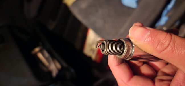

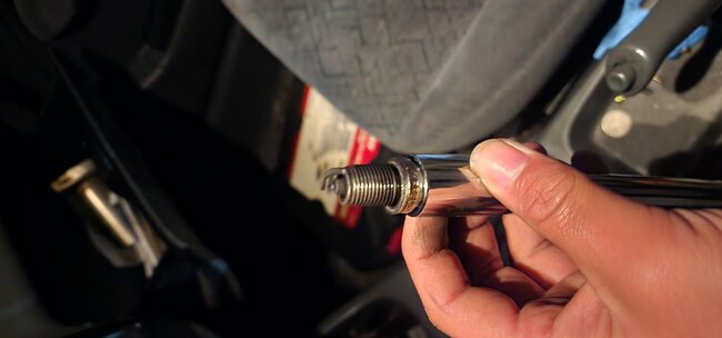

I forgot to mention that I have fuel pressure, I'm getting fuel to the injectors, I'm also getting spark to all cylinders, and my air filter is clean. One thing to know is that I recently changed my spark plugs, and after cranking the car a bit the spark plugs were covered in combustion. The whole spark plug was covered in all black. It looked like they had been in there for a while even though i just put them in.

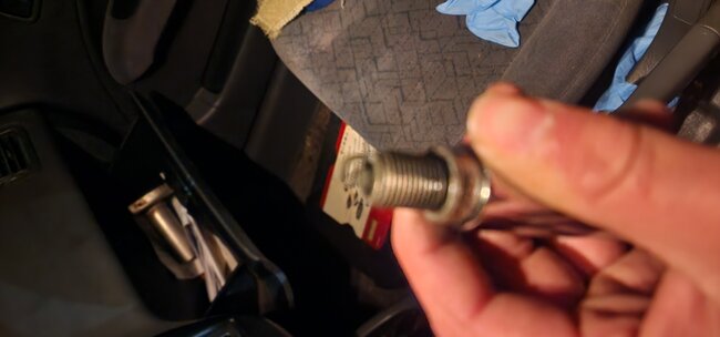

Could you take a pic of the spark plugs and upload them for me to see? Also, if they were instantly covered in something black, it may be you have too much fuel pressure. Were all cylinders like this when you checked them?

The plugs look like new, but they never should have turned black after such a short period. Have you checked the fuel pressure? It may be too high.

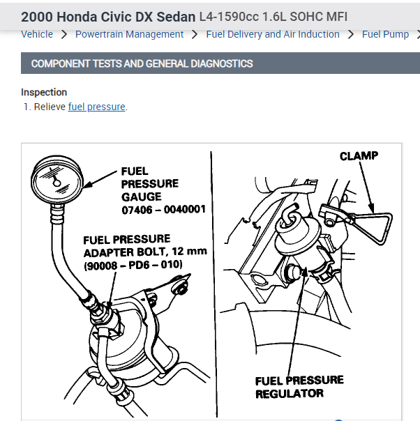

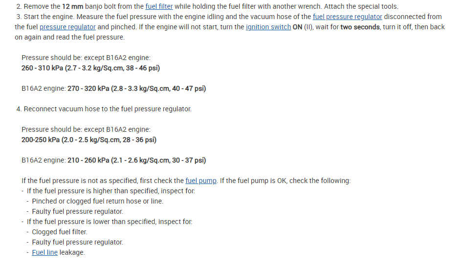

As far as the fuel pressure is concerned, it is checked at the fuel filter. I attached the directions below for you.

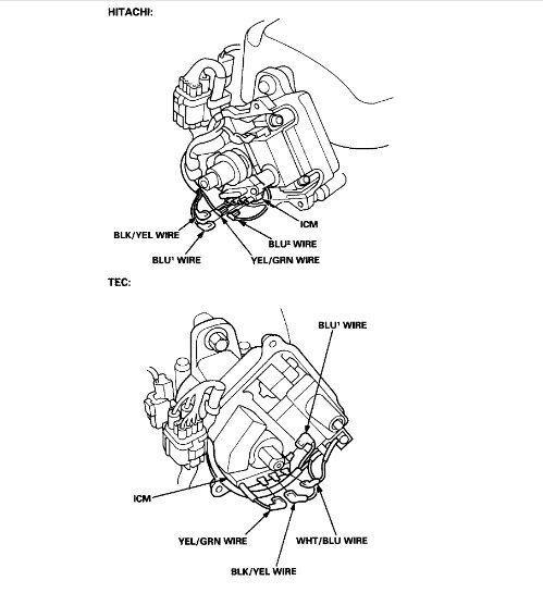

That is odd. If you have spark, you should have an RPM signal. The tachometer gets a signal from the ignition control module in the distributor. I attached directions below for testing it. Take a look at them and let me know if you feel comfortable performing them.
Next, I need you to record it cranking and upload it for me to hear.

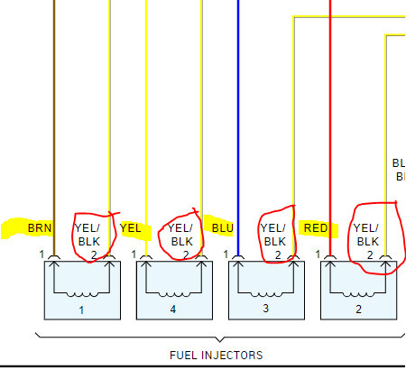

  • 110,244 POSTS

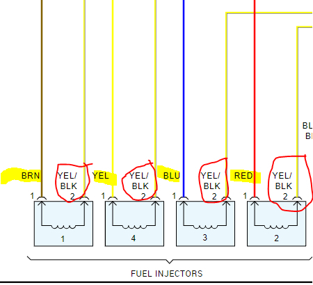

If that is the case, it isn't getting fuel. You mentioned the pump was replaced and you have fuel pressure. So, that leaves a problem with the injectors.
I attached a pic below. Note that each fuel injector has a yellow wire with a black tracer. That is the power supply to the injector. Once you turn the key to the run position, each of those wires should have power. Using a test light, connect the alligator clip to the battery negative then probe the yellow/black wires to confirm the test lamp lights up, indicating power.
If they have power, we need to check if the ECM is providing a ground path to complete the circuit. The ground wires are brown, yellow, blue, and red. To check if there is a ground path, connect the alligator clip of a test light to the battery positive. and probe those wires one at a time while you have a helper crank the engine. When it is cranking, the test lamp should strobe on and off.
Try this and let me know what you find.
See pic below. I highlighted the ground path wires and circled the power wires.
Feb 3, 2024 at 8:11 AM

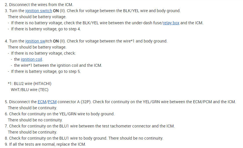

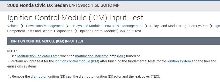

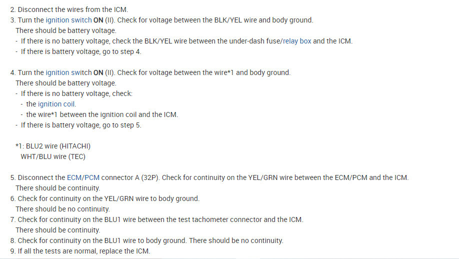

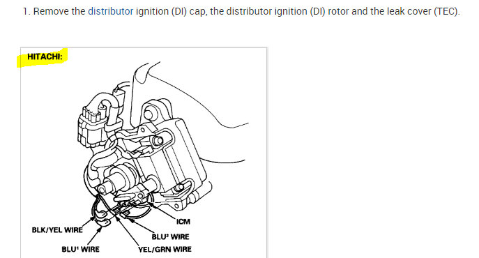

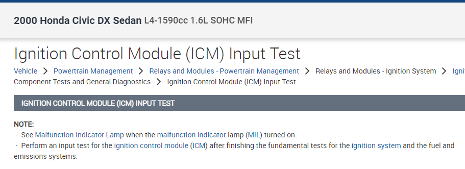

  • 110,244 POSTS

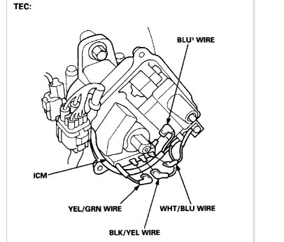

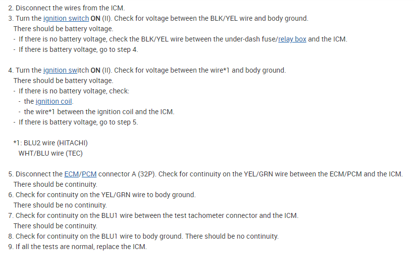

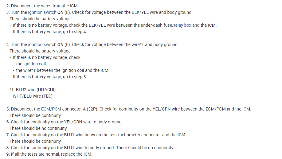

I attached the diagnostics for the ignition control module. Take a look through them and let me know if you are comfortable performing them.
Mar 15, 2024 at 11:50 AM

  • 110,244 POSTS
I attached diagnostics related to the ignition control module (ICM). Take a look through them and let me know if you are comfortable performing them.

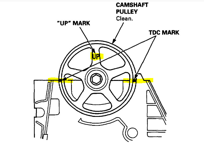

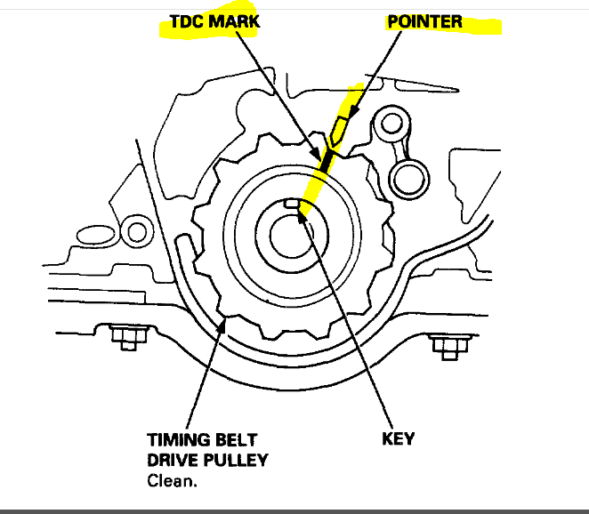

I noticed the timing belt cover is off. Have you checked to make sure the timing is correct?
Mar 19, 2024 at 12:12 PM
BIGBLACKBOI9
  • 33 POSTS
I tried searching up how but i can't seem to find the notches that are being shown in the video or any markings on the belt.
Mar 19, 2024 at 2:05 PM
  • 110,244 POSTS
I attached two pics below. One shows the marks for the crankshaft and the other shows the camshaft.

I checked the timing it looks all lined up. I haven't checked the Catalytic converter but before the car stopped running i did have a faulty catalytic converter code.
