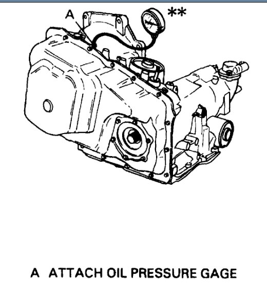

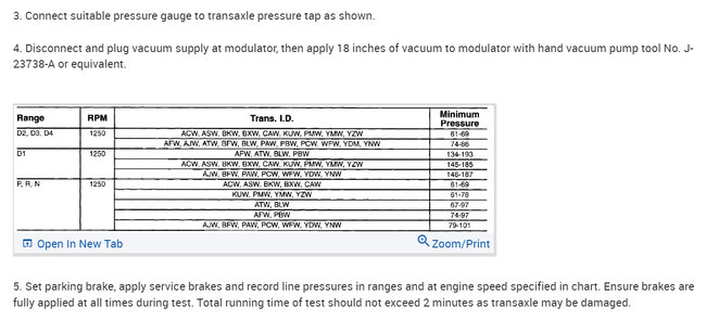

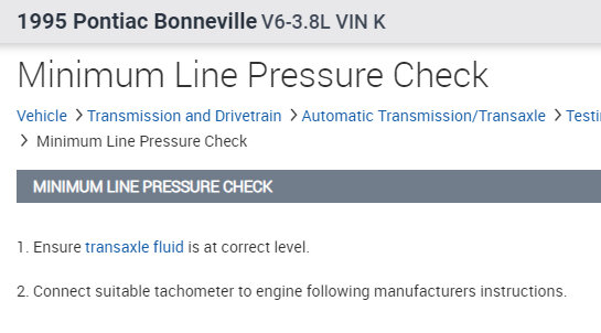

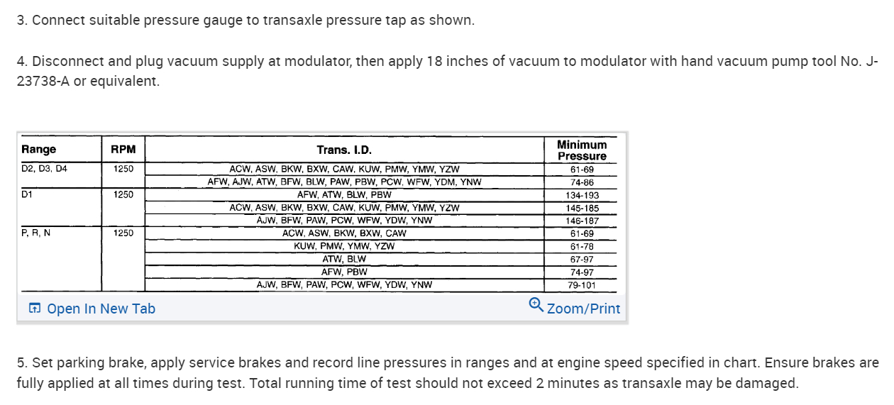

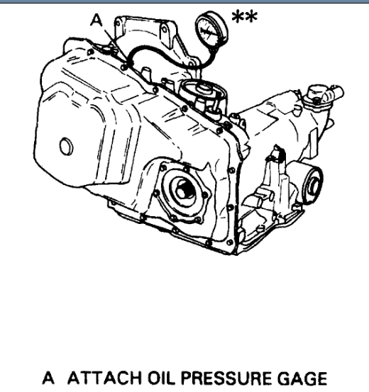

The next thing I would check is transmission line pressure. This requires connecting a transmission pressure gauge and inspecting the pressure under specific conditions.
If you look below, I attached the procedure. Take a look through it and let me know if it is something you are comfortable performing.
