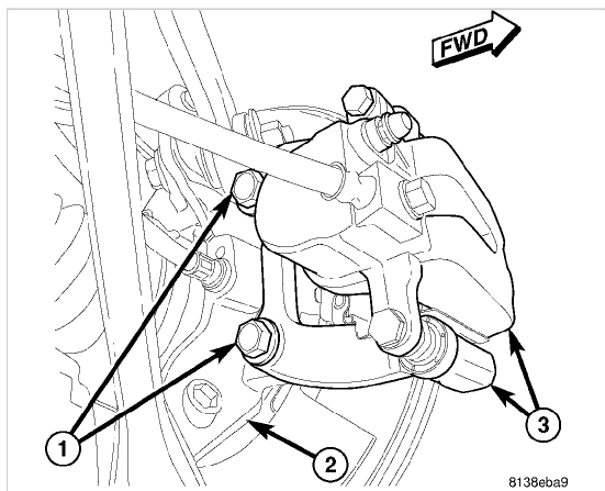

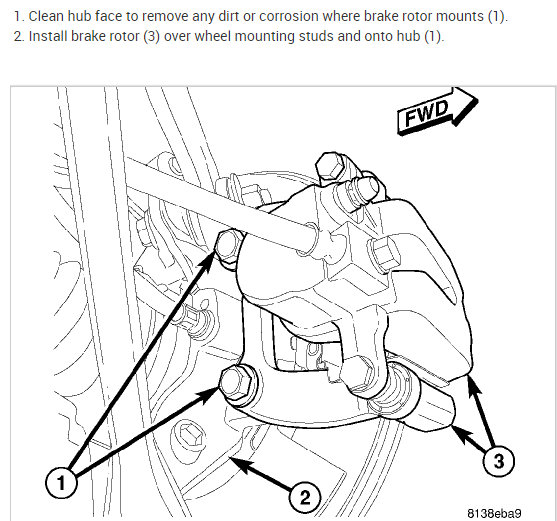

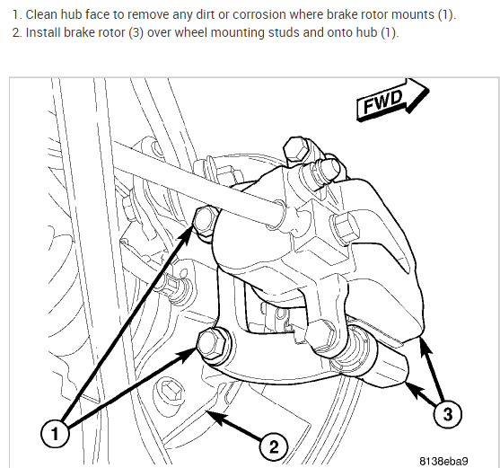

I got in my car, started it up, released the parking brake, and put the car into reverse. It is grinding from the rear I need new brake can you help me please?

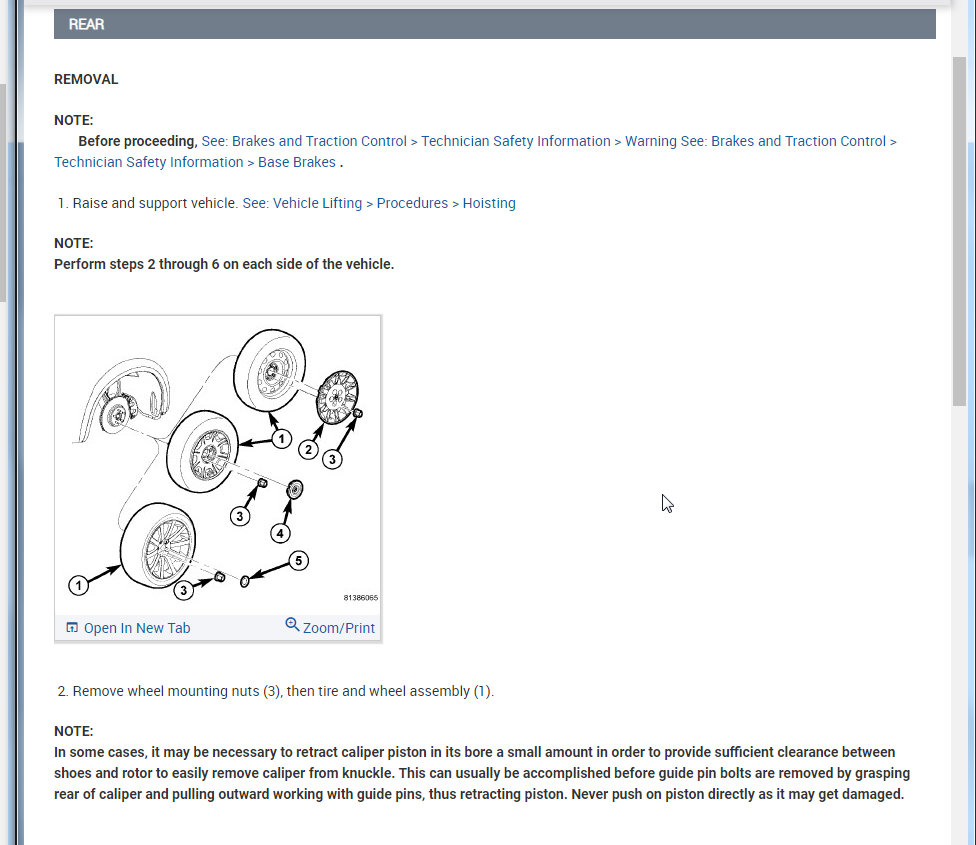

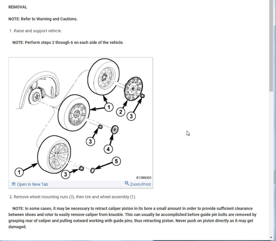

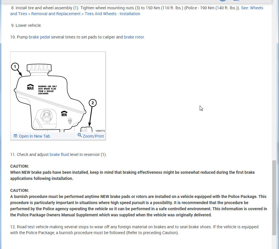

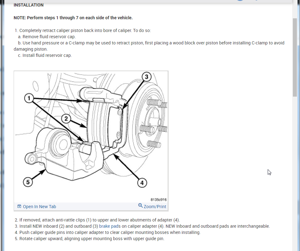

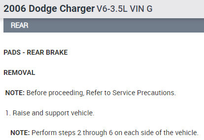

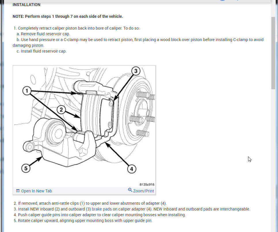

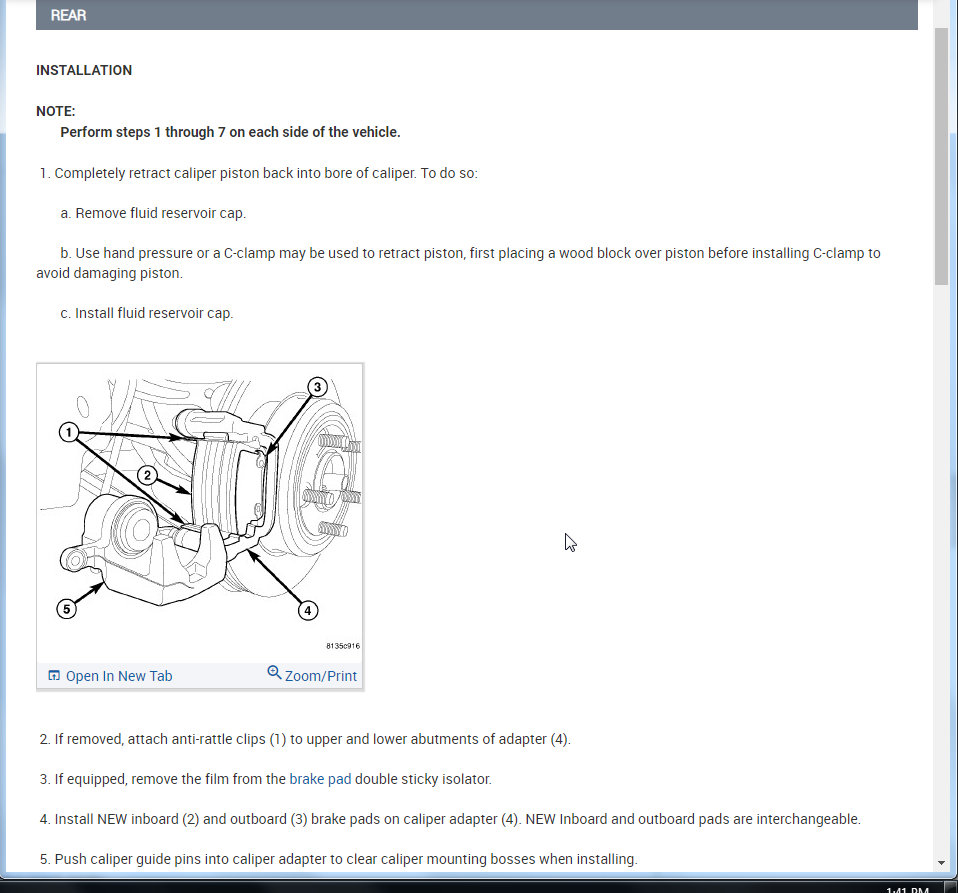

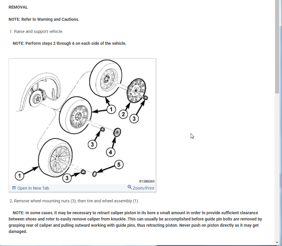

Please let us know what questions you have but below is the process from the manual on how to replace the rear brakes. Thanks

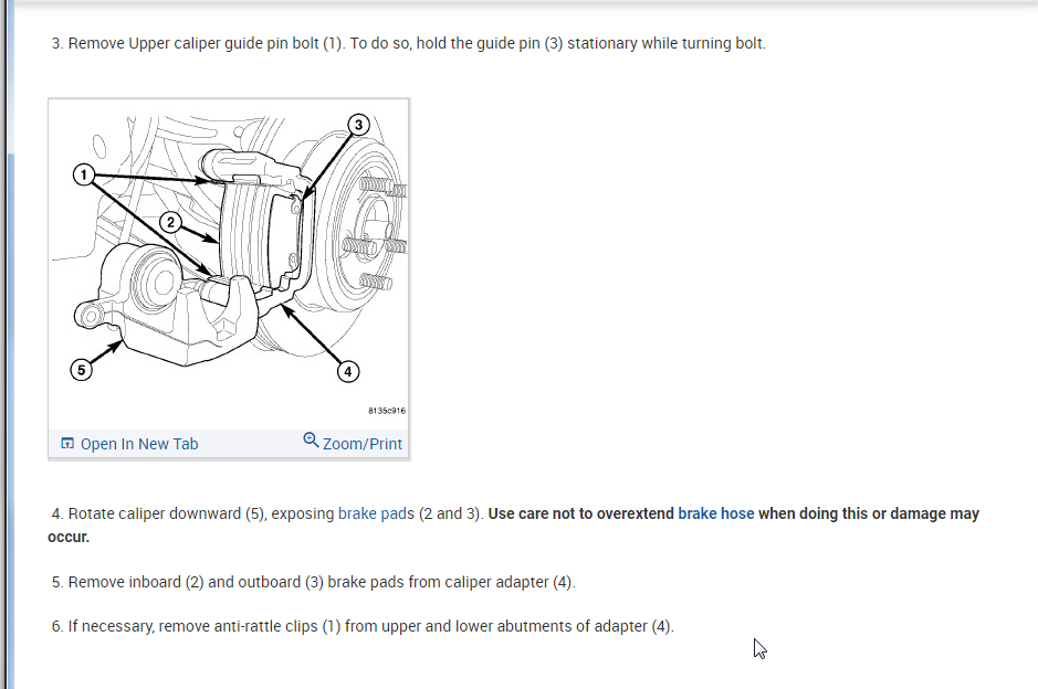

Ive changed brakes before, but not on this car. I see they come with a hardware kit, but seems old hardware is hard to get out. Any Suggestions?
May 11, 2021 at 6:24 AM (Merged)
KHLOW2008
  • 41,814 POSTS
Should not be any different with others.
What hardware kit are you refering to?

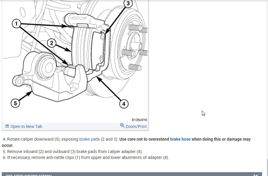

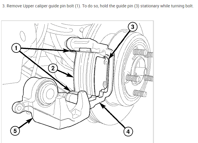

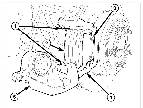

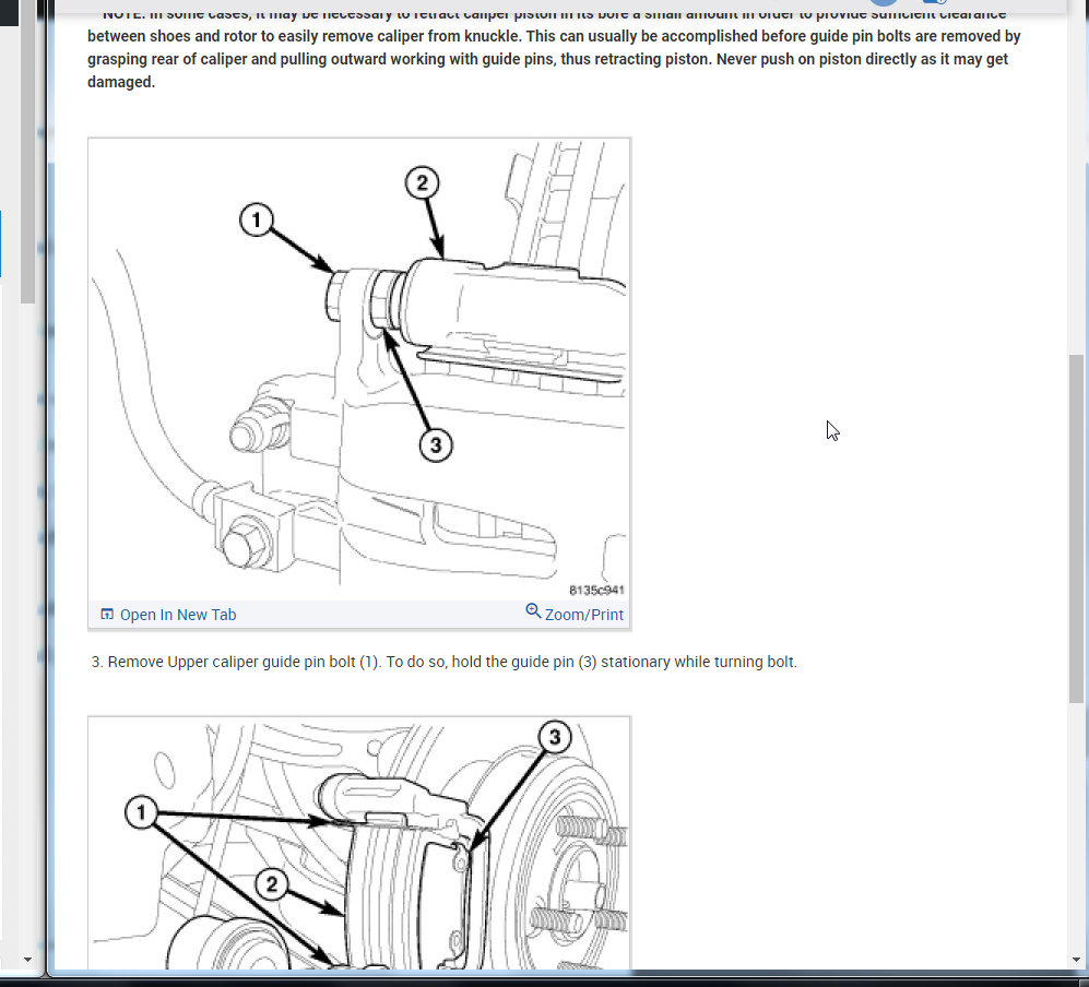

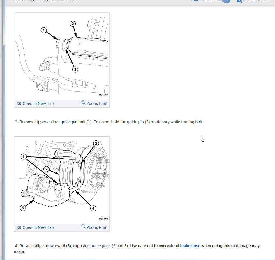

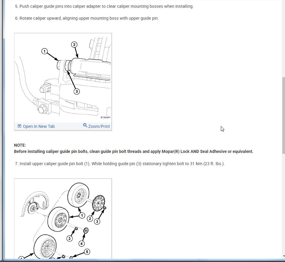

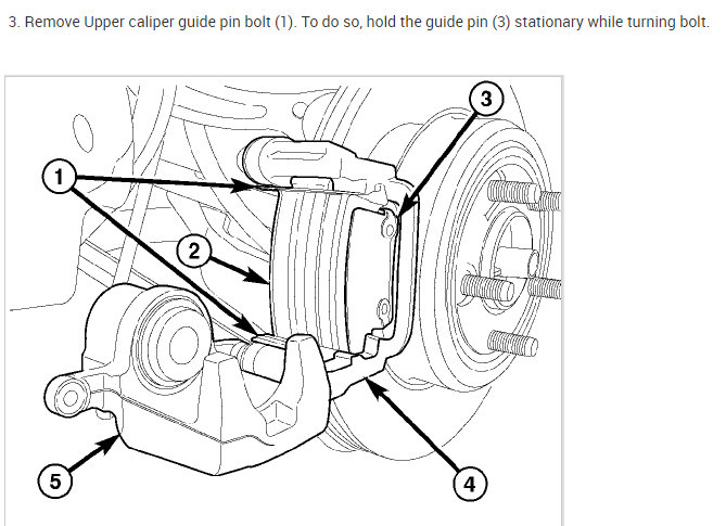

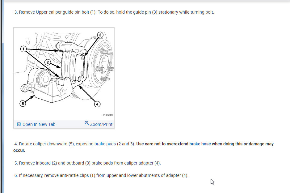

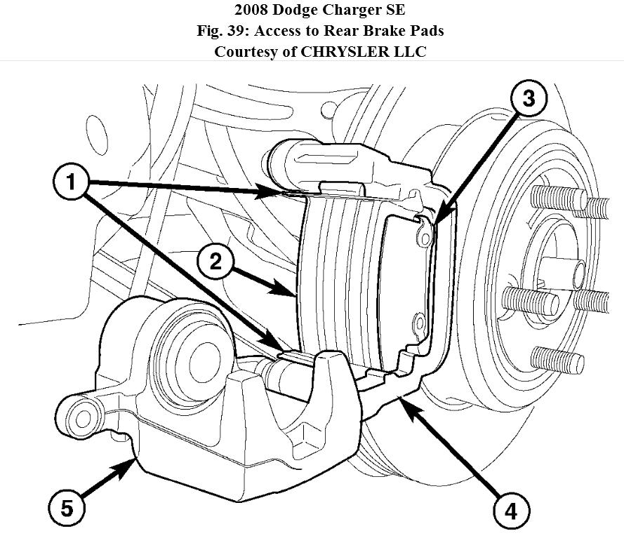

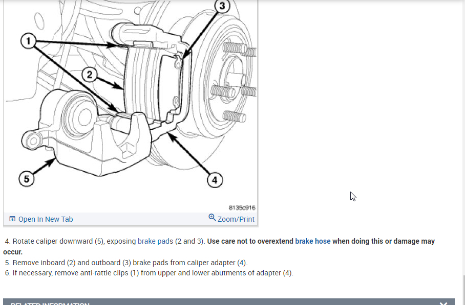

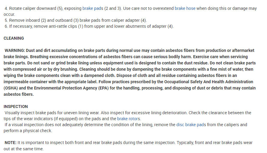

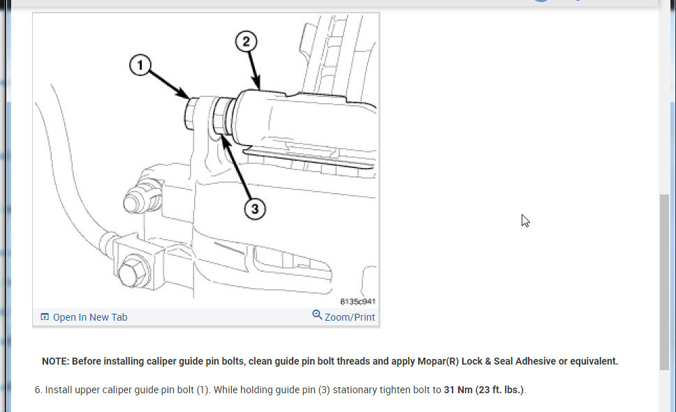

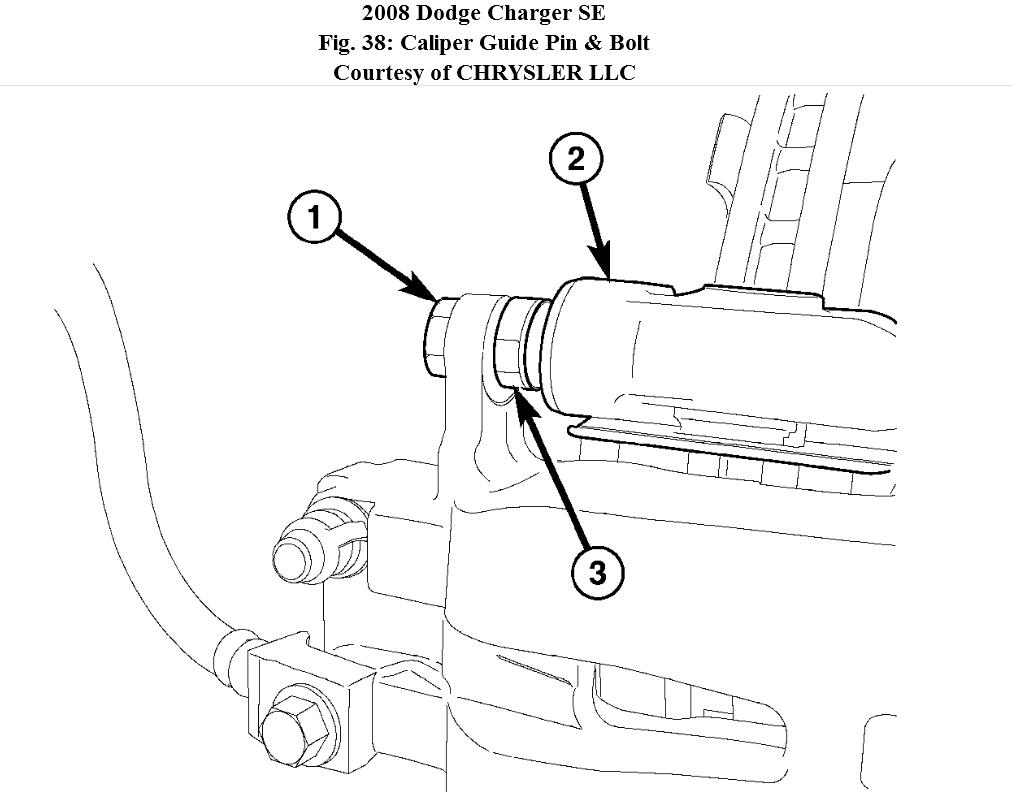

1. Remove Upper caliper guide pin bolt (1). To do so, hold the guide pin (3) stationary while turning bolt.
2. Rotate caliper downward (5), exposing brake pads (2 and 3).
Use care not to overextend brake hose when doing this or damage may occur.
3. Remove inboard (2) and outboard (3) brake pads from caliper adapter (4).

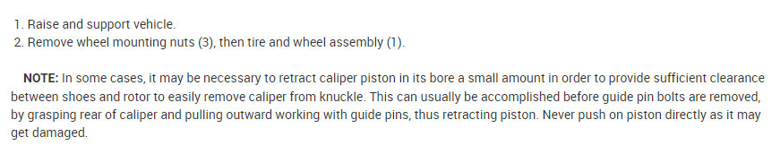

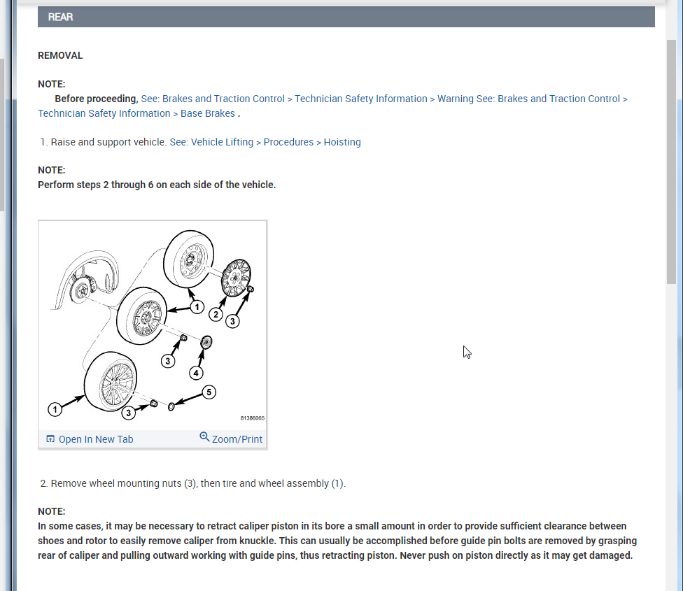

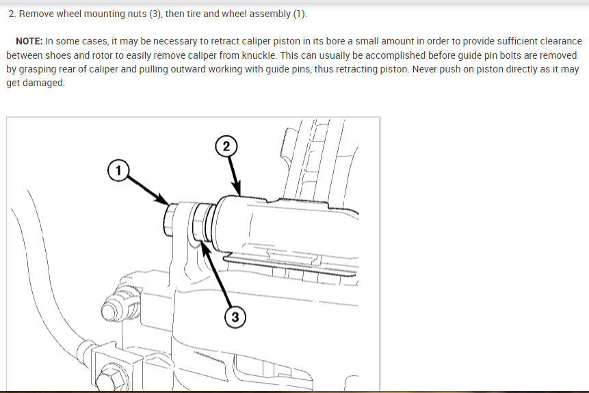

Note : In some cases, it may be necessary to retract caliper piston in its bore a small amount in order to provide sufficient clearance between shoes and rotor to easily remove caliper from knuckle. This can usually be accomplished before guide pin bolts are removed by
grasping rear of caliper and pulling outward working with guide pins, thus retracting piston. Never push on piston directly as it may get damaged.

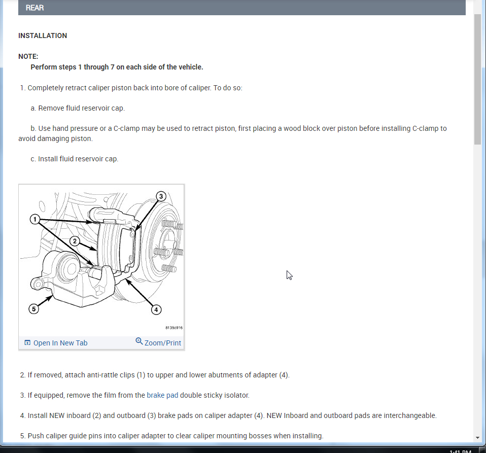

Below is the info from the manual that will help with this. Please run through this material and let us know if you have other questions. Thanks

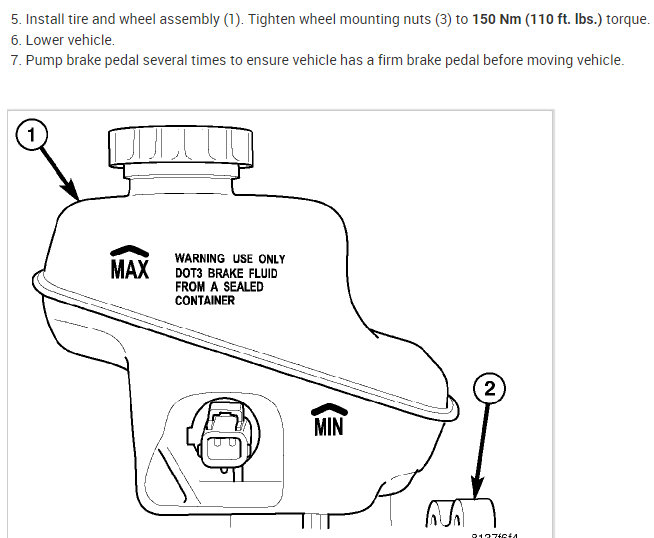

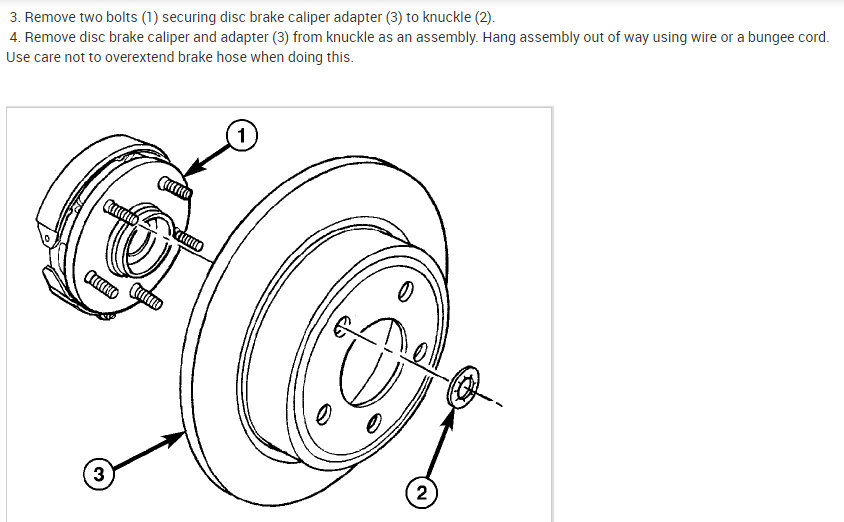

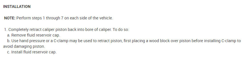

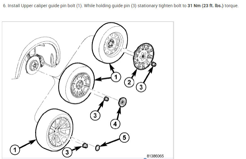

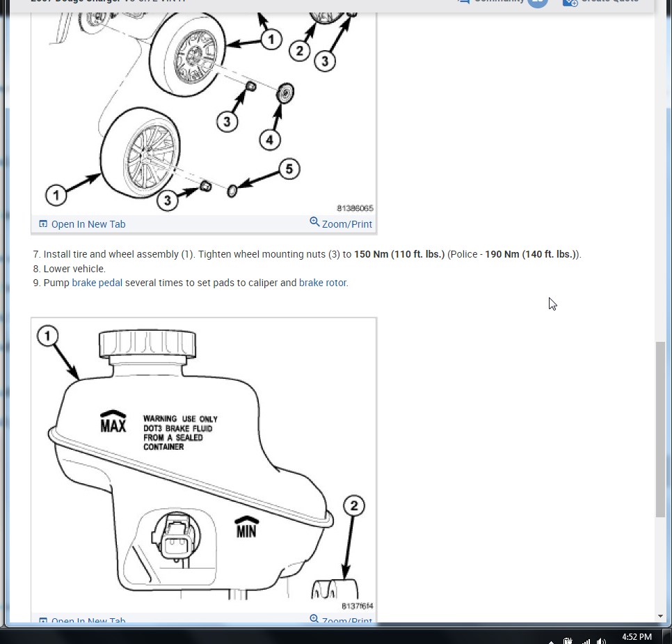

Here is the information you requested. Here is a tutorial showing how to replace rear rear brake pads and rotors:
https://www.2carpros.com/articles/how-to-replace-rear-brake-pads-and-rotors
Here is a YouTube video from our site showing how to retract the rear caliper piston when replacing rear brake pads:
https://youtu.be/j8YwfSKEzZo

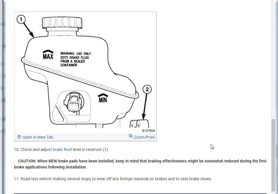

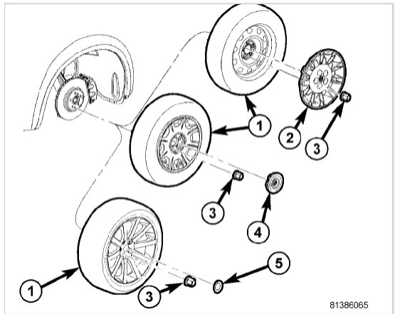

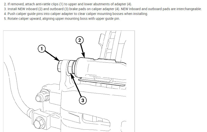

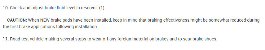

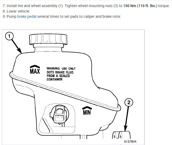

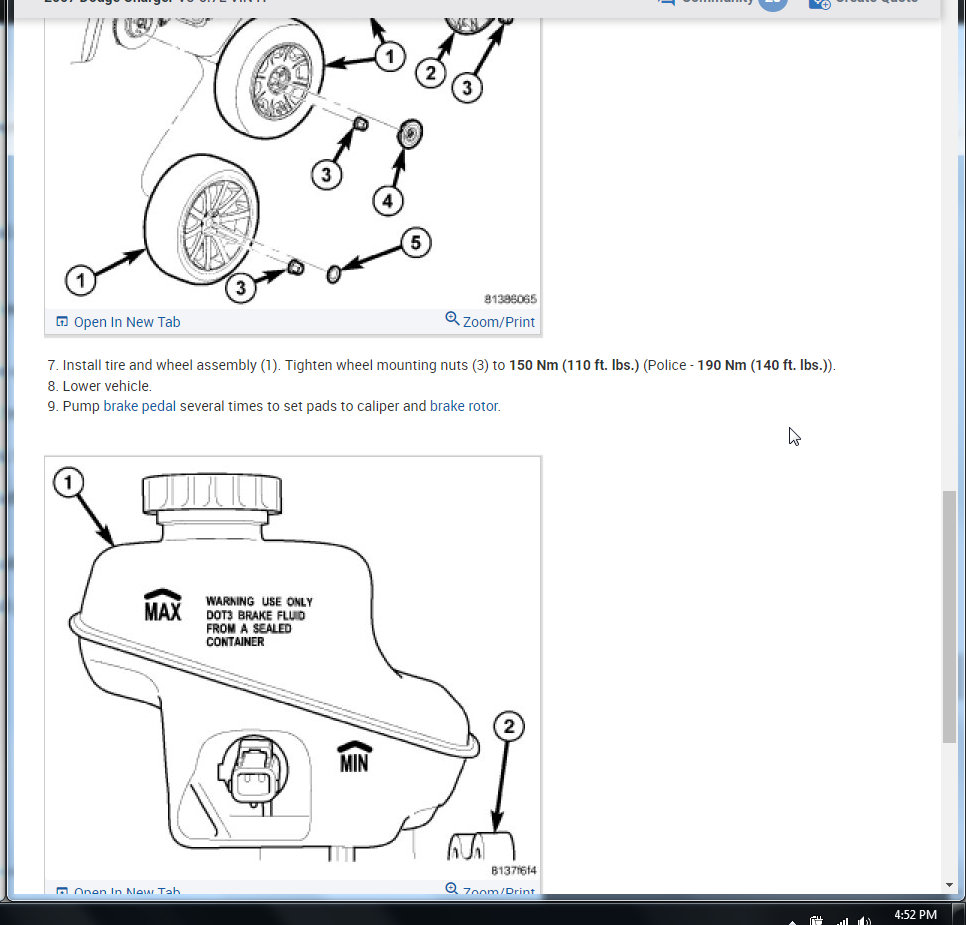

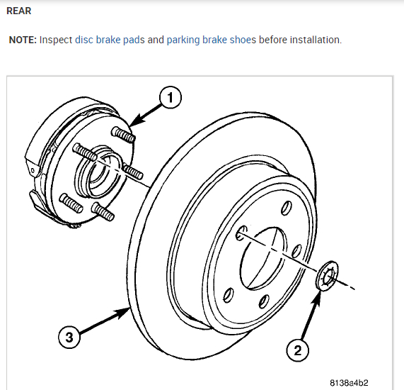

I've attached picture steps below on how to change the rear brake pads and rotors on your car. Hope this helps and thanks for using 2CarPros.
