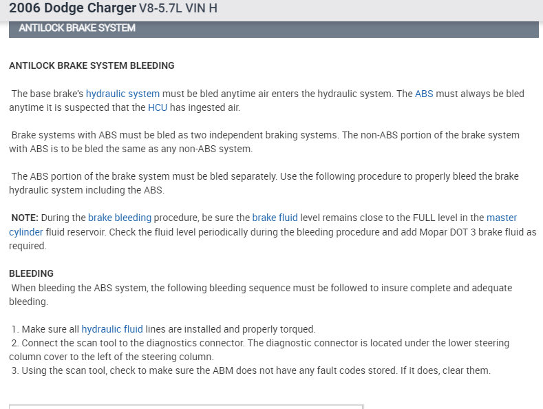

I replace the flex hose I need to bleed the system
2006 DODGE CHARGER
33,100 MILES • V8 • 2WD • AUTOMATIC
GATA
could it be brake fluid? i found drippings it was a light color so I replace the flex hose I need to bleed the system now.
Nov 1, 2010 at 1:58 AM
SQM
  • 6,383 POSTS

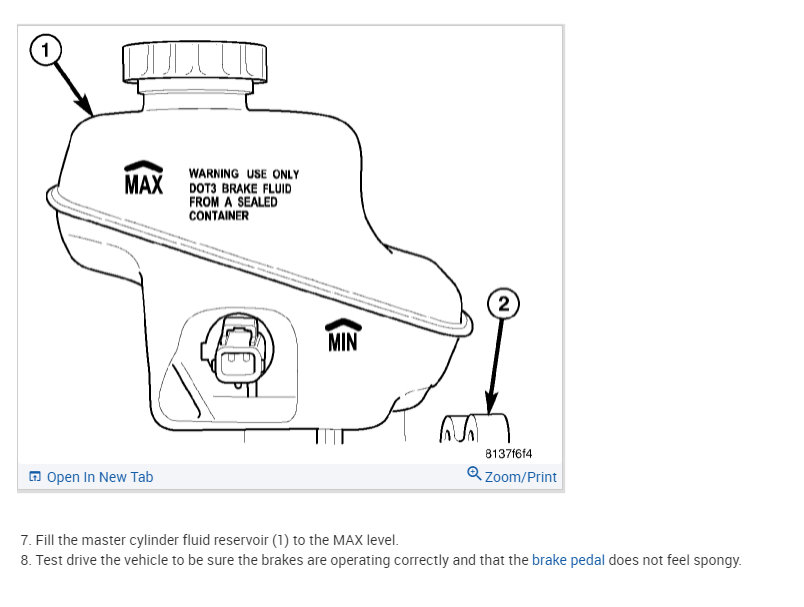

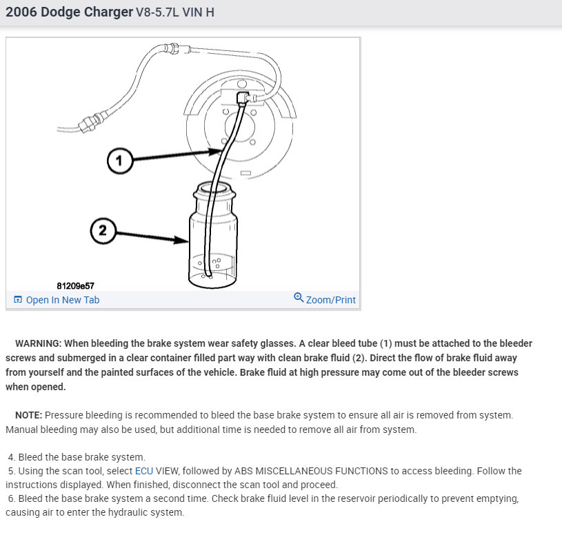

Any time the brake system gets opened (i.e. changing caliper, master cylinder, brake hose/line), air will get into the system and will require bleeding the brakes to purge the air out.
Here is a helpful video of brake bleeding procedure:
https://youtu.be/w7gUsj2us0U
https://www.2carpros.com/articles/how-to-bleed-or-flush-a-car-brake-system
I have attached the instructions below.
