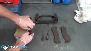

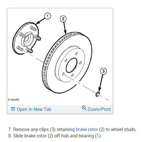

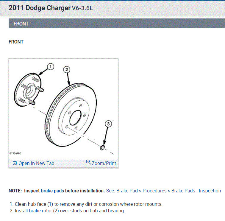

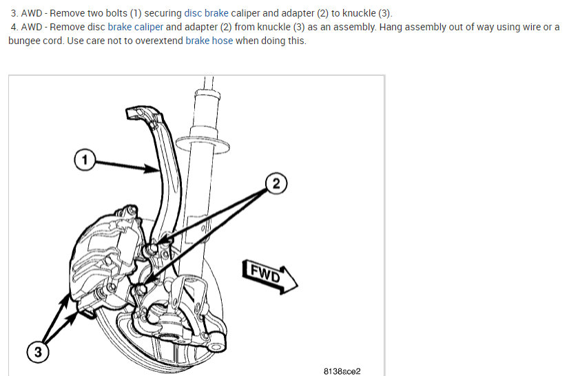

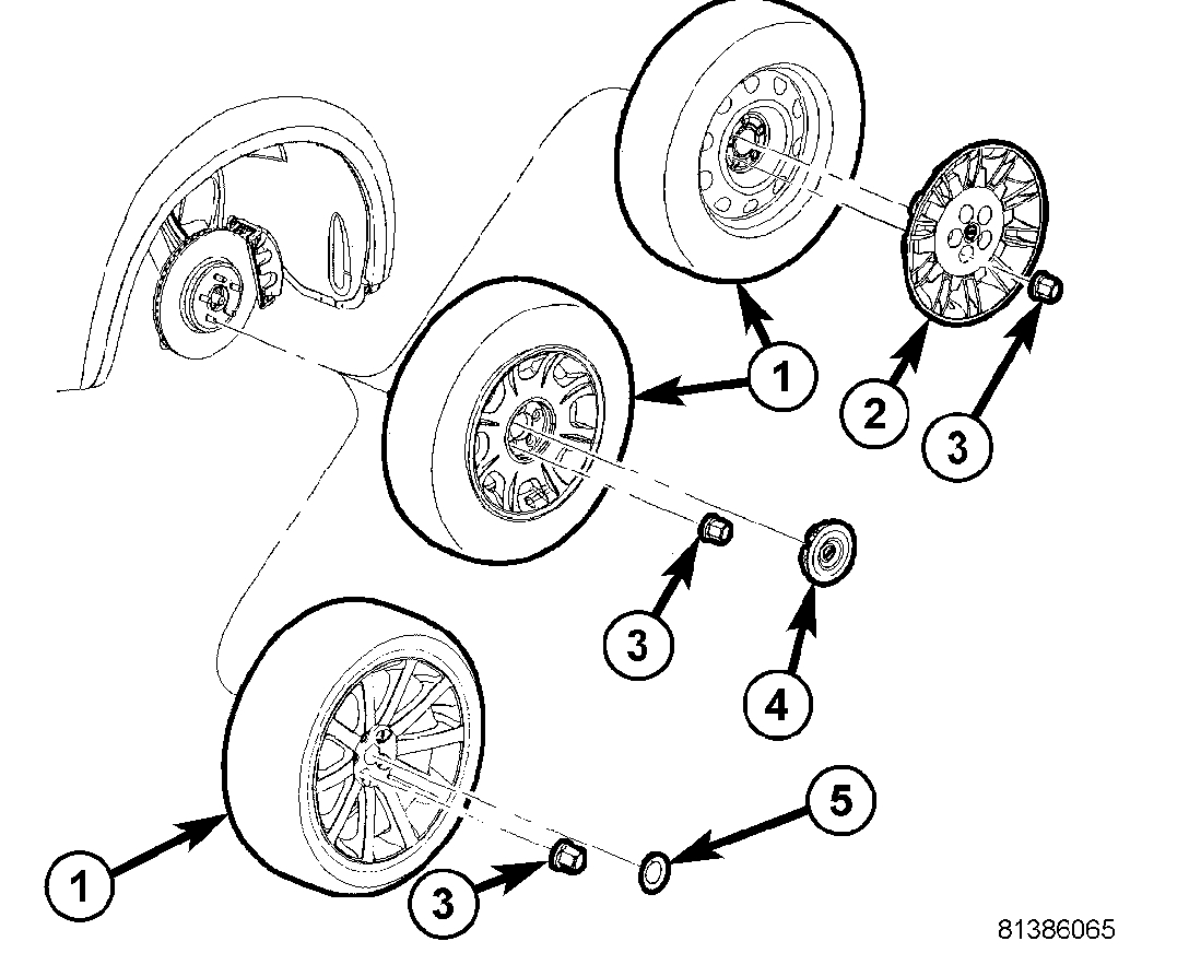

Here is the information you requested. This is a tutorial showing what is involved on how to change front brake pads and brake rotors:
I've attached picture steps below on how to change the front brake pads and rotors on your car. Hope this helps and thanks for using 2CarPros.

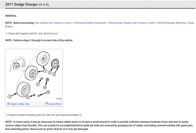

Replacing front brakes and rotors really isn't too hard to do. Make sure to get lifetime pads so you will never have to pay for them again.
You can expect front brakes to last approximately 25,000 miles. However, that can change based on driving habits and terrain.
To get you started, here is a link that explains in general how the job is done. You can use this as a guide.
If you look at the attachments below, they include the directions specific to your vehicle for brake pad and rotor replacement.

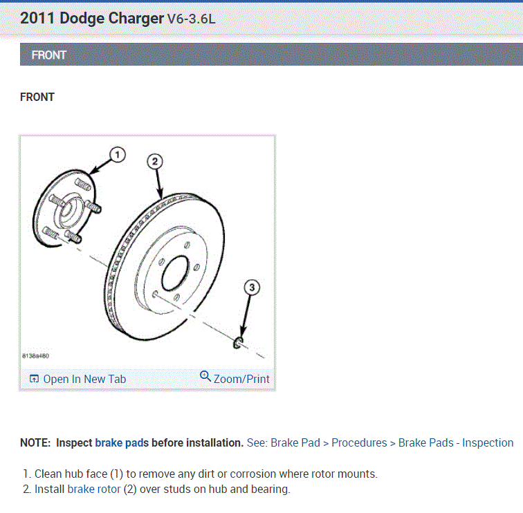

Here is a guide that will help with step by step instructions for this:
Below you will find the process from the manual that will help with performing this. Please run through this material and let us know if you have other questions. Thanks

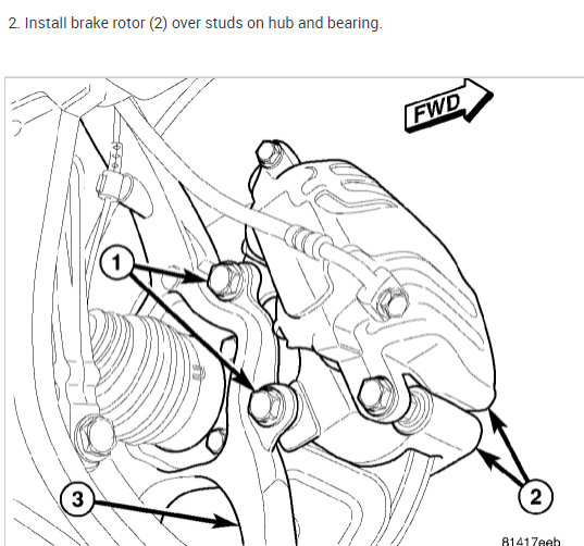

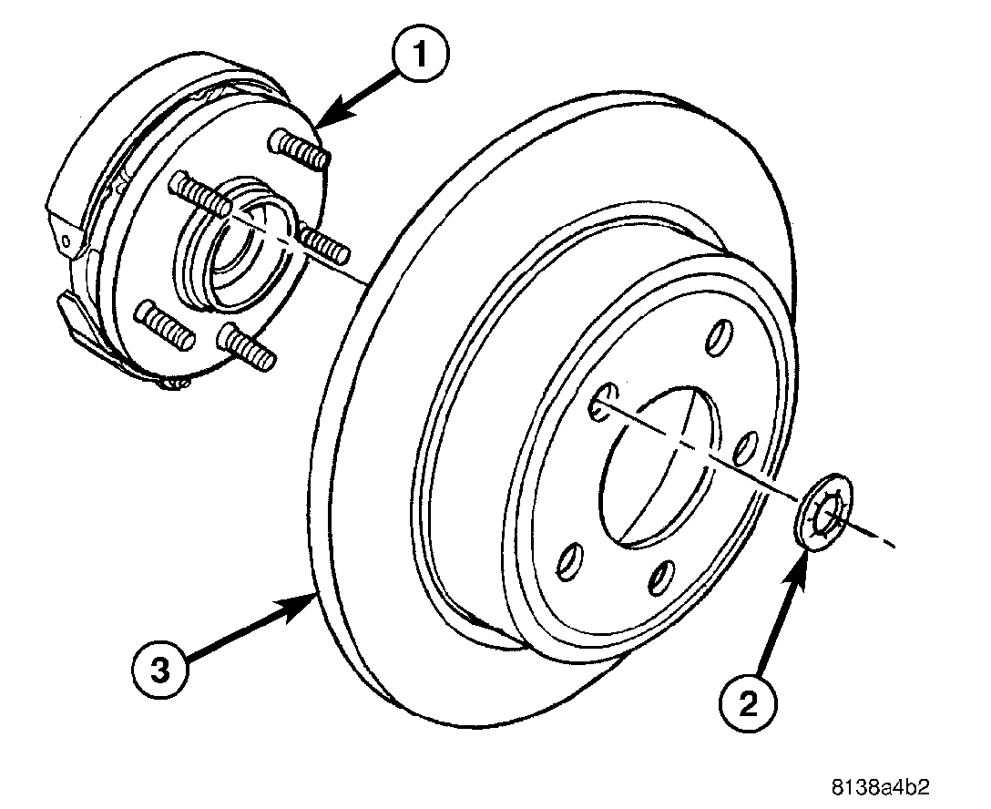

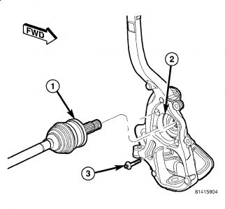

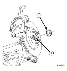

PORTANTE

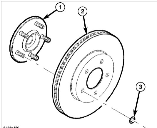

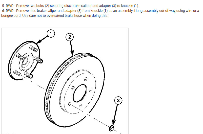

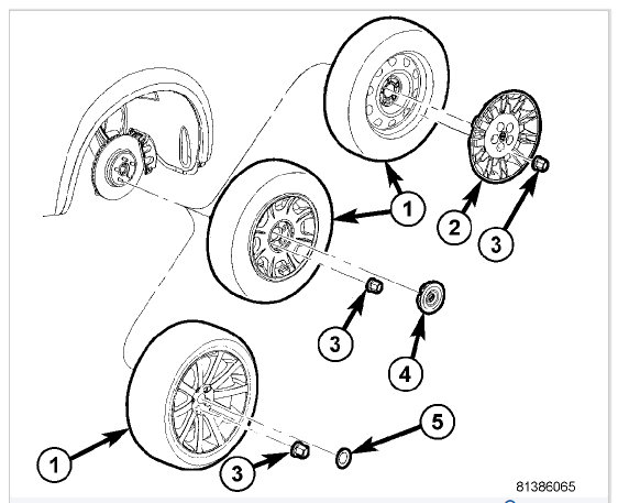

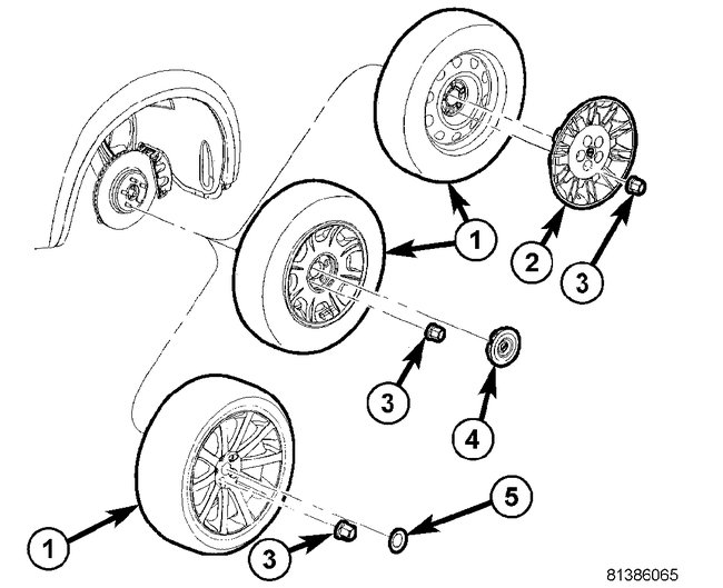

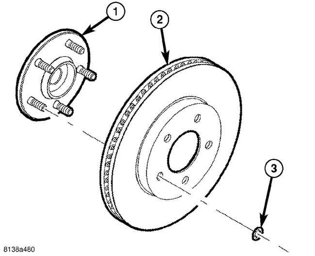

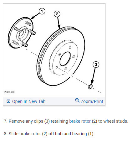

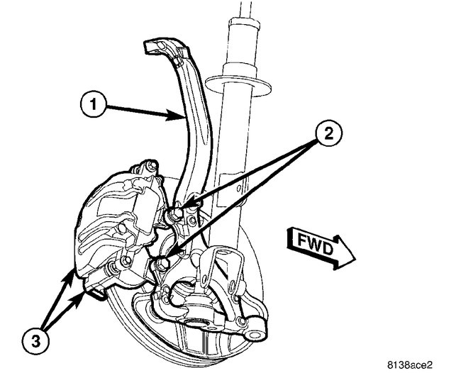

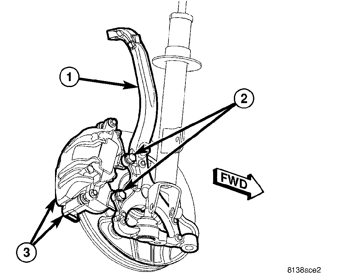

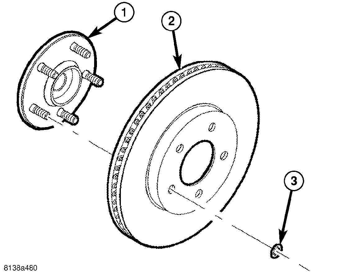

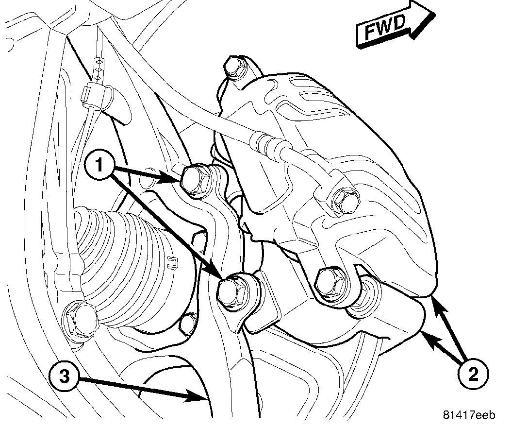

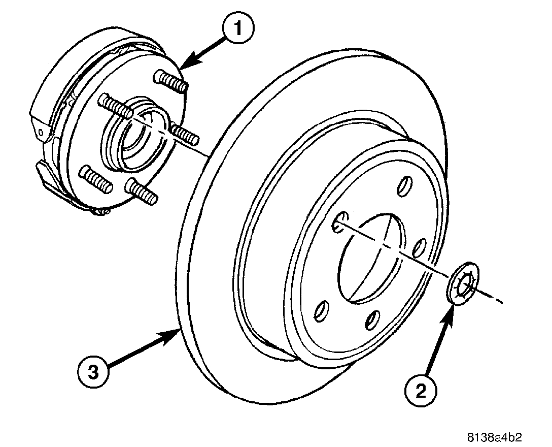

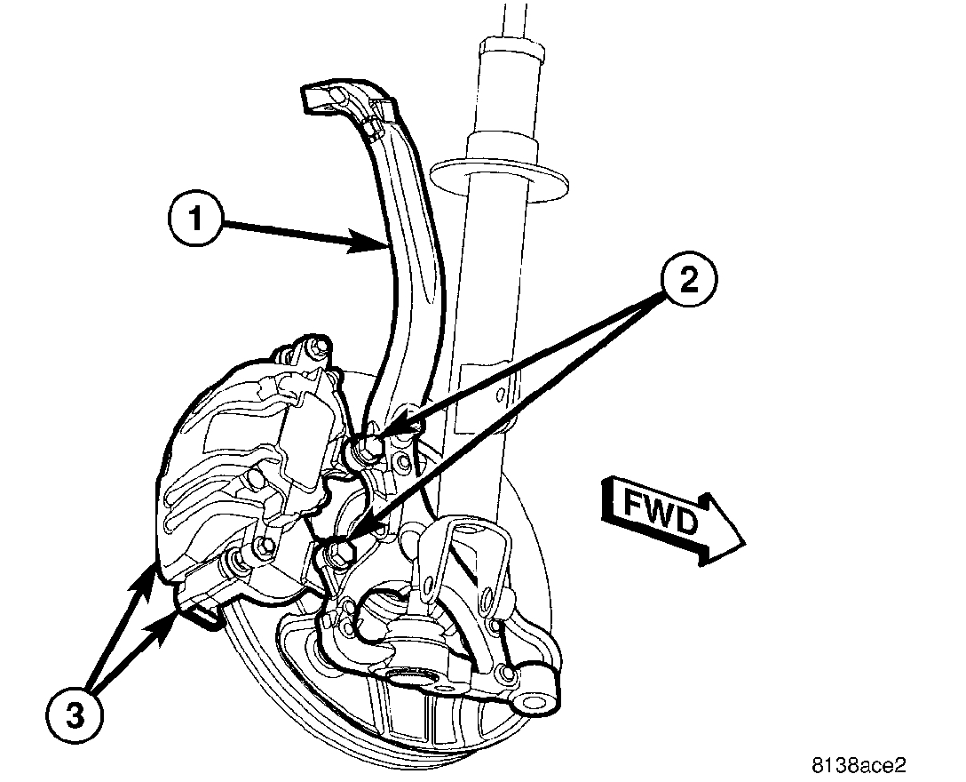

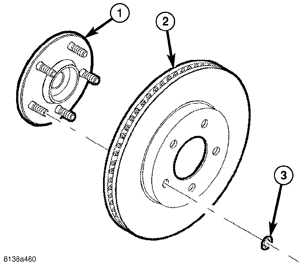

I can not remove the hub to take off the rotors so I can replace them with new ones. More information: It's a Charger SXT with rear wheel drive, anti-lock 4 wheel disc brakes.
Jun 28, 2021 at 7:40 PM (Merged)
BLUELIGHTNIN6
  • 16,542 POSTS

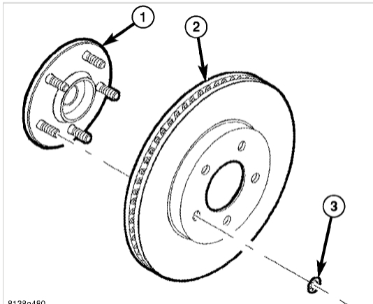

Hello to remove the hub, need to have an assistant for this. while a helper applies brakes to keep hub from rotating, remove the hub nut from the axle half shaft. this will allow you to access and remove the rotor.
https://images.2carpros.com/forum/automotive_pictures/261618_Graphic_131.jpg
https://images.2carpros.com/forum/automotive_pictures/261618_Graphic2_15.jpg
BLUELIGHTNIN6
  • 16,542 POSTS
no......applying the torque to the nut will cause the vehicle to shift, allowing the nut to roll with the vehicle and preventing you from loosening it...........this is not a suggestion, it is the proper removal procedures for your vehicle's hub and rotor
PORTANTE
My husband finally removed the rotors but not using your method.Thanks.

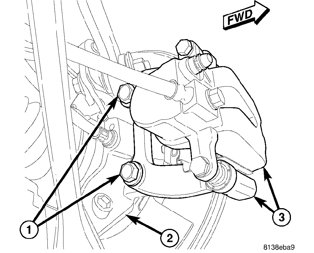

My son is interested in the car listed about with a R/T 5.7 liter (150,000 miles) which we test drove this morning. Everything was smooth when accelerating and decelerating until the engine was reaching idle. It ran fine but I hear a squeaking sound do I need brakes?
  • 110,194 POSTS

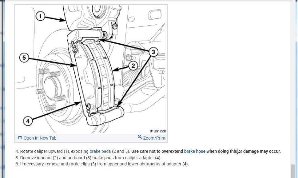

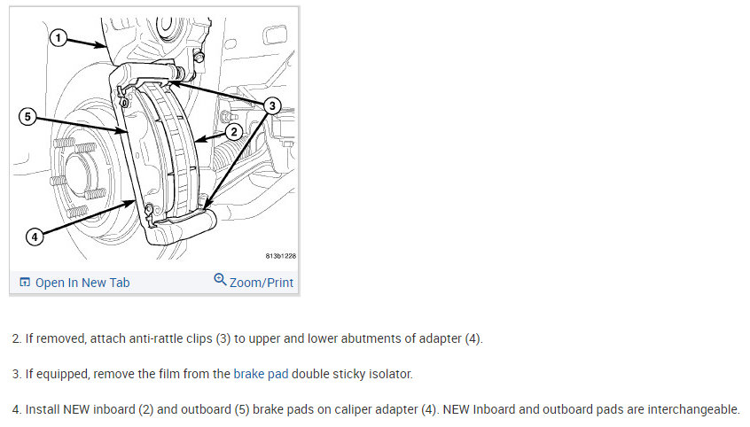

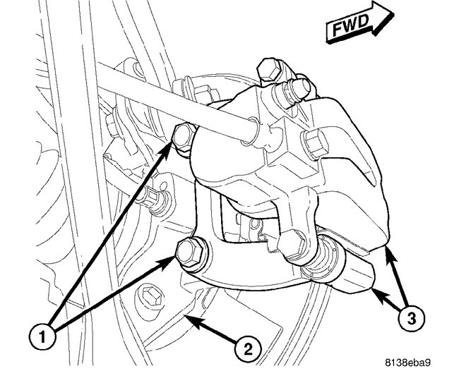

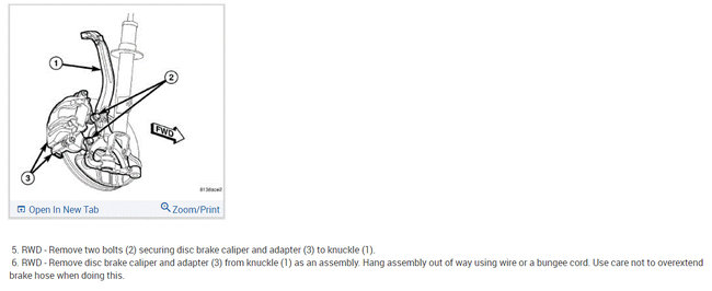

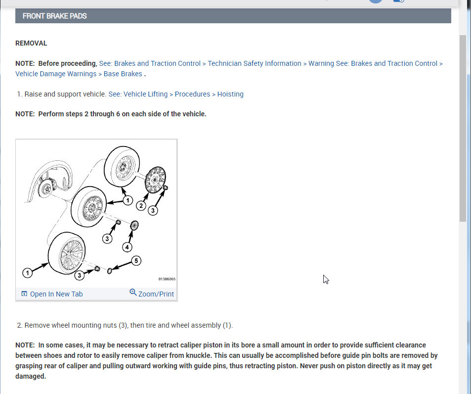

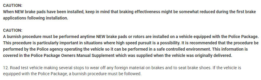

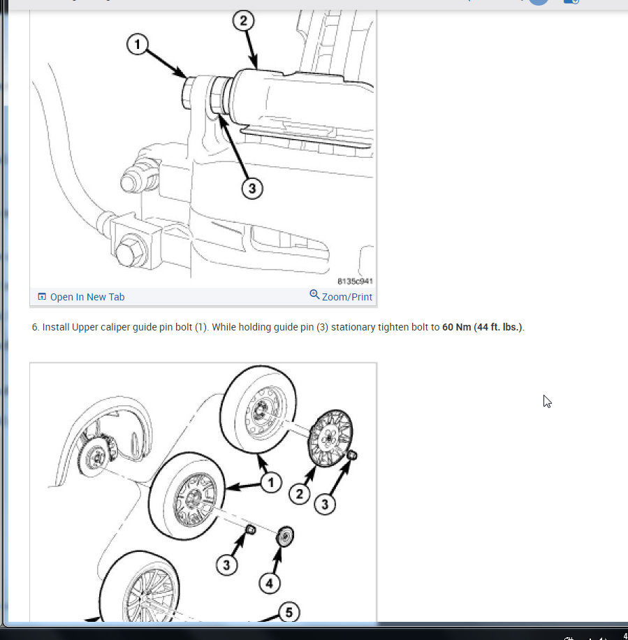

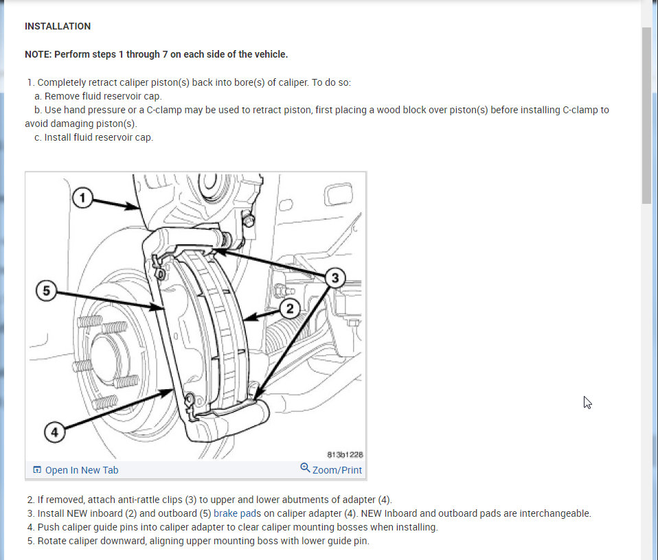

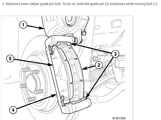

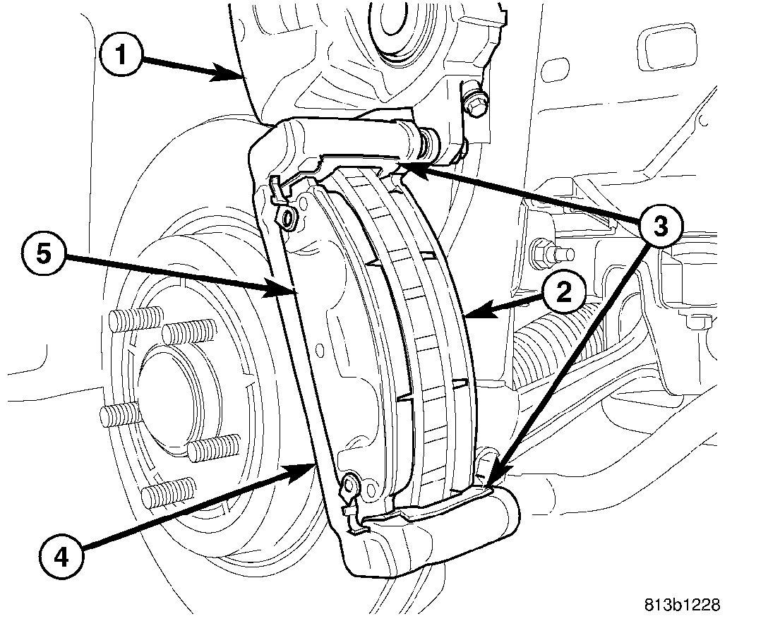

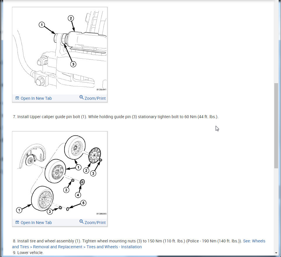

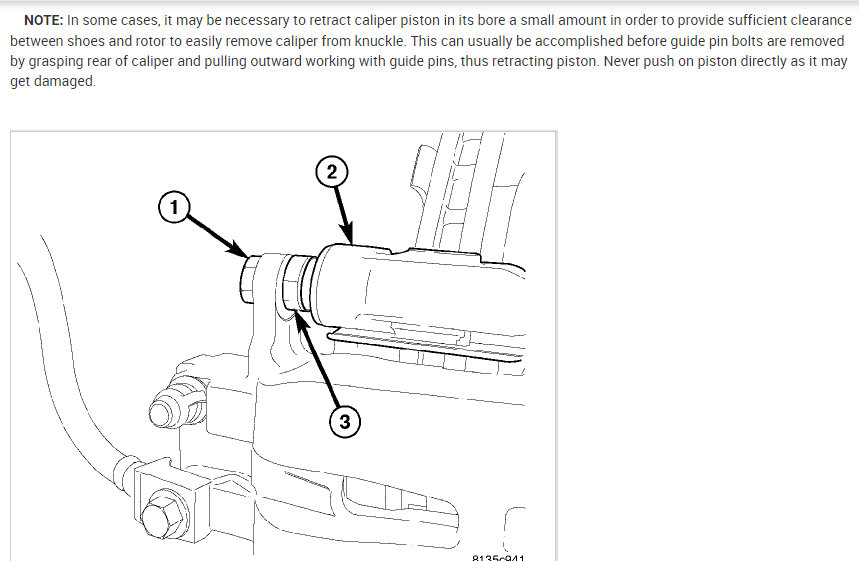

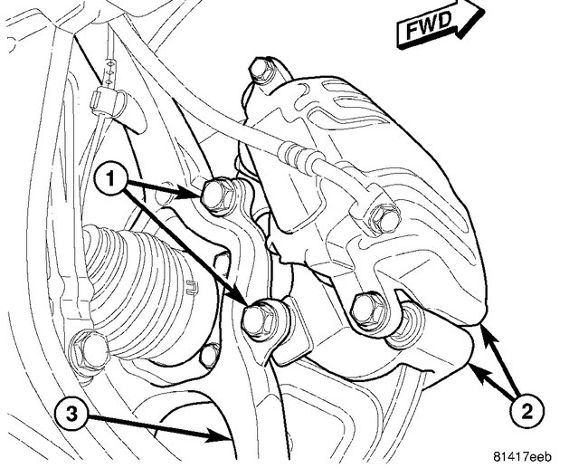

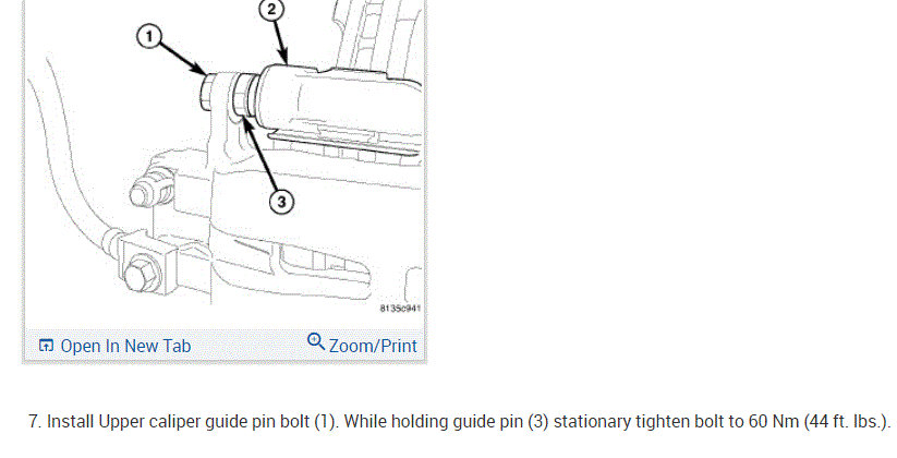

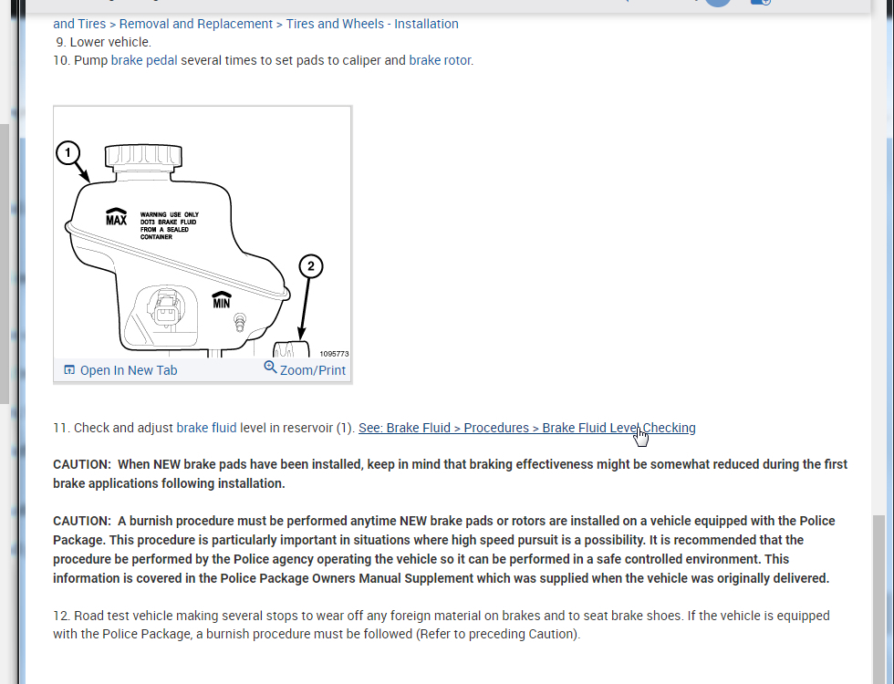

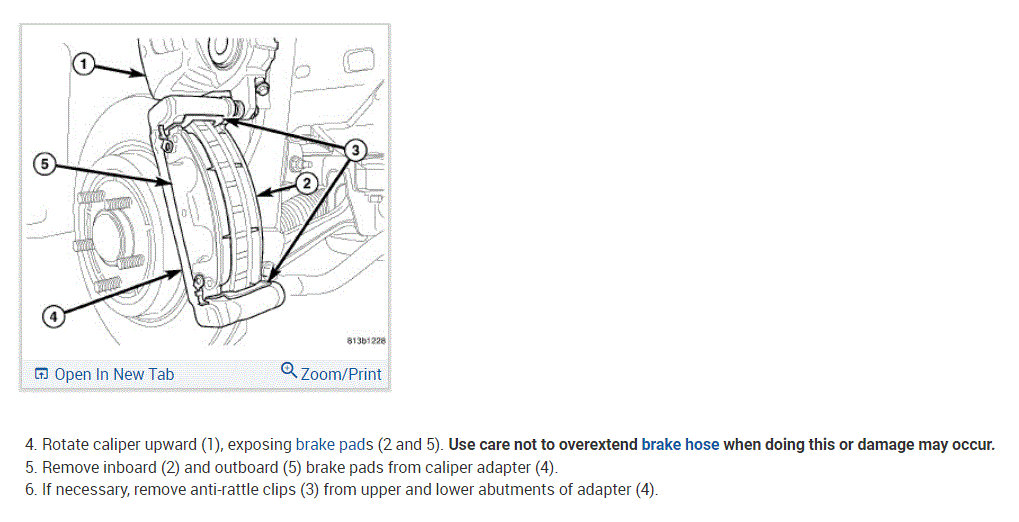

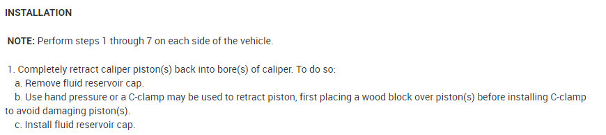

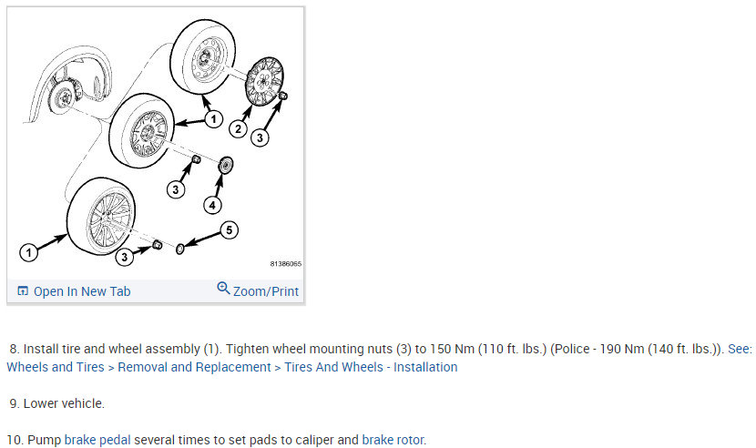

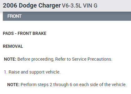

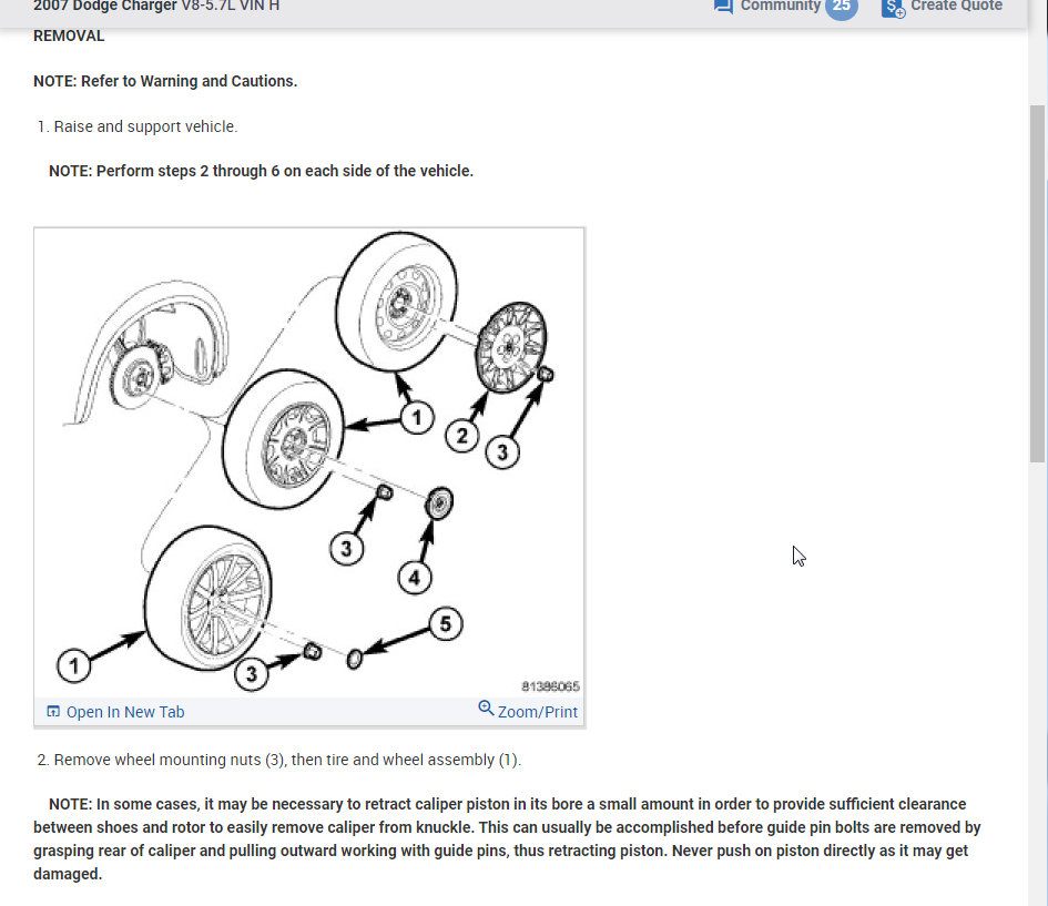

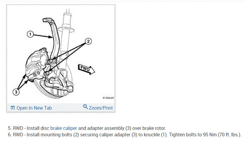

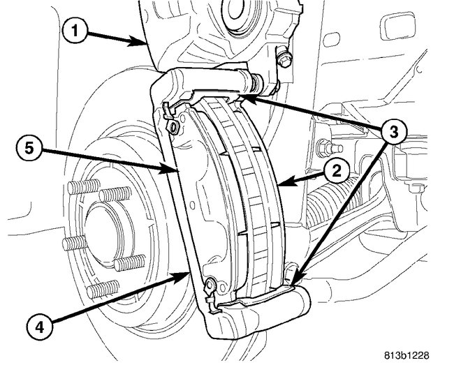

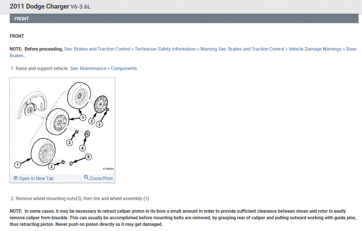

Replacing brakes and rotors isn't too big of a job. First, take a look through this link. It shows in general how it's done. You can use it as a guide. Check out the diagrams (Below). Please let us know what happens.

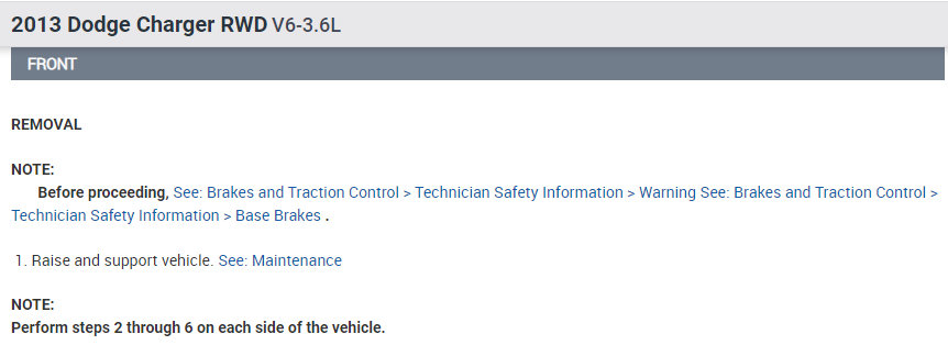

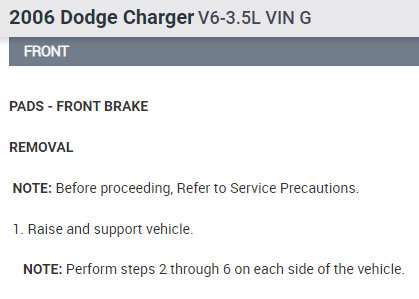

Here are directions specific to your vehicle. The attached pic correlates with the directions.

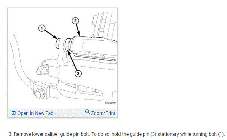

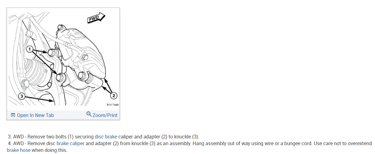

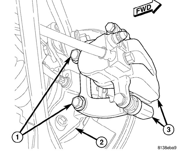

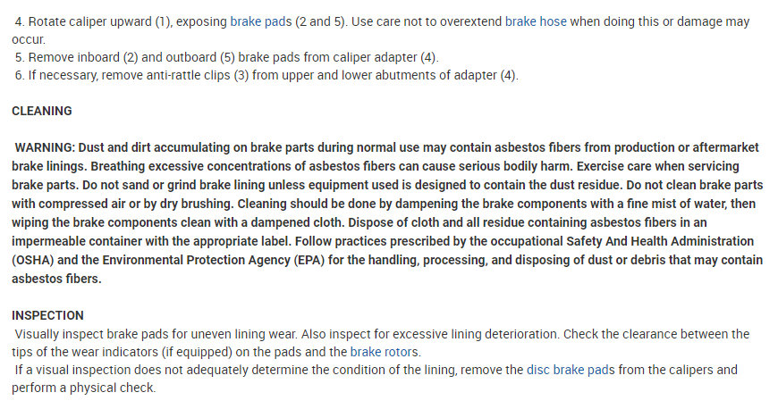

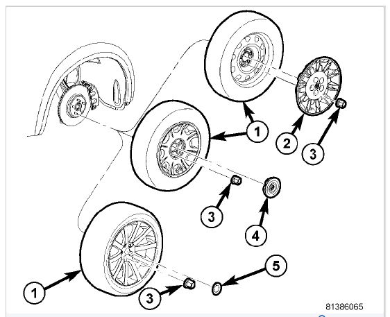

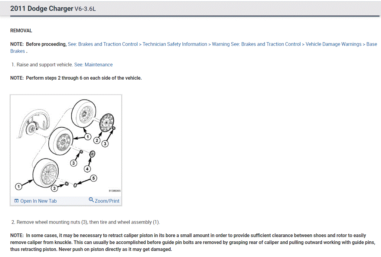

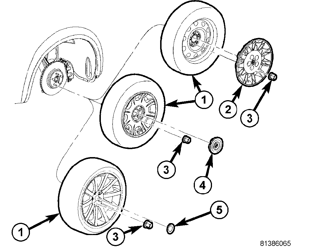

REMOVAL
NOTE: Before proceeding, Refer to Service Precautions.

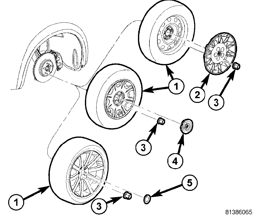

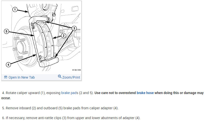

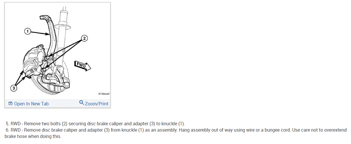

1. Raise and support vehicle.
NOTE: Perform steps 2 through 6 on each side of the vehicle.

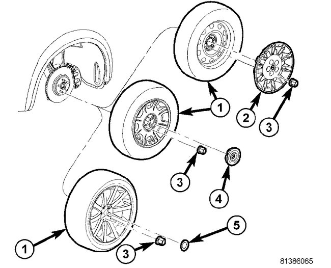

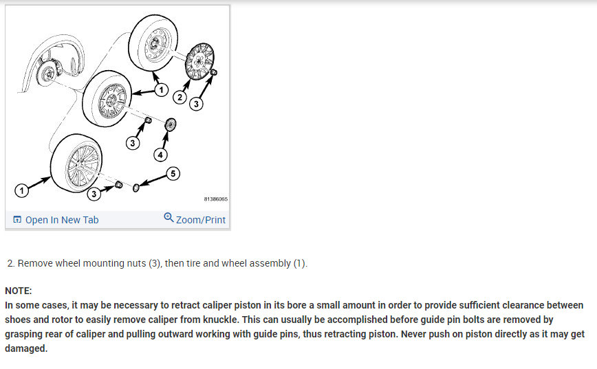

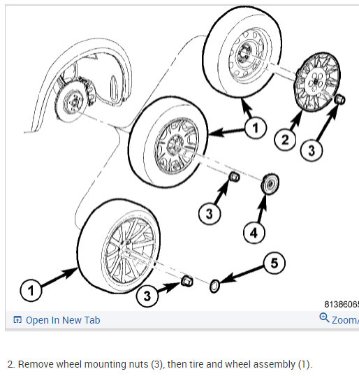

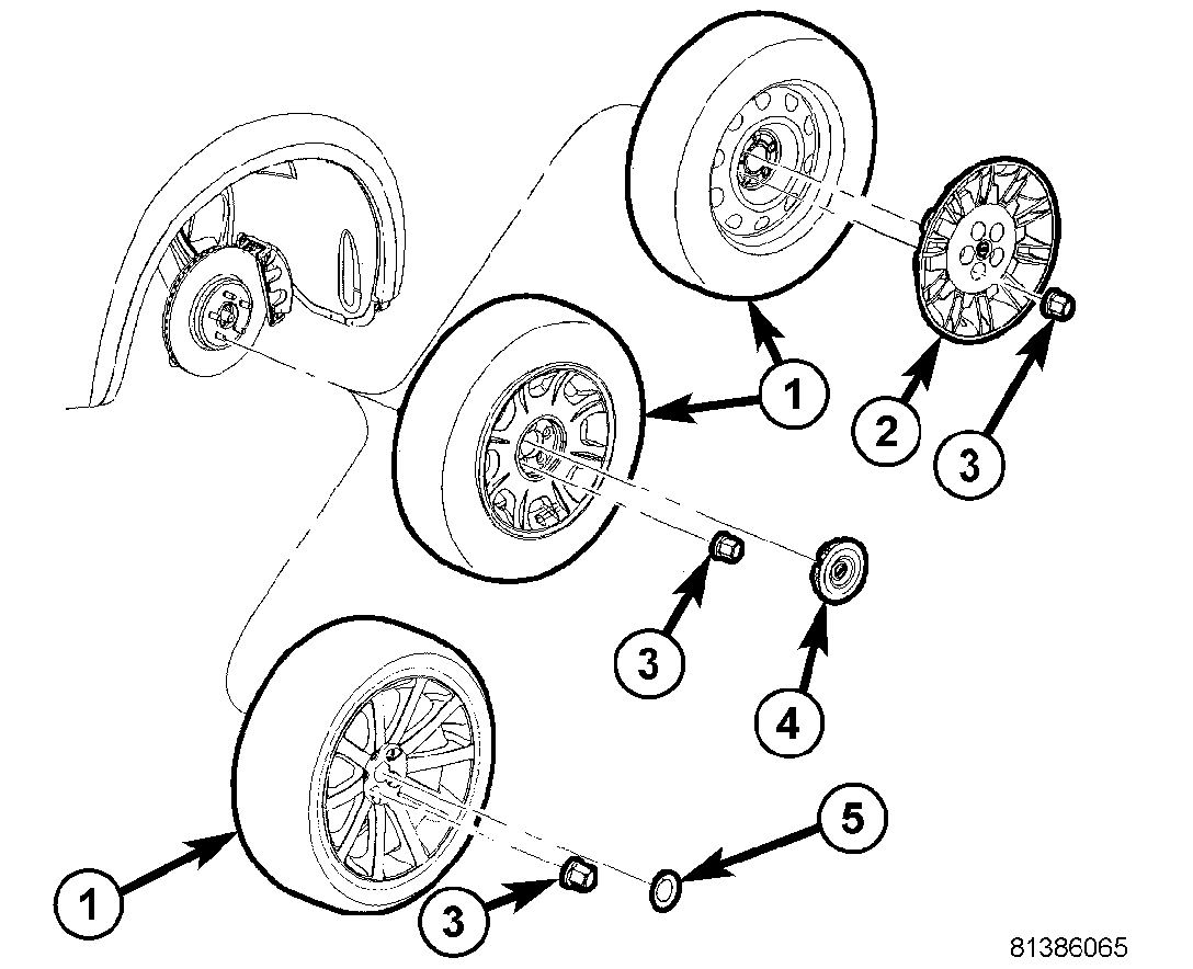

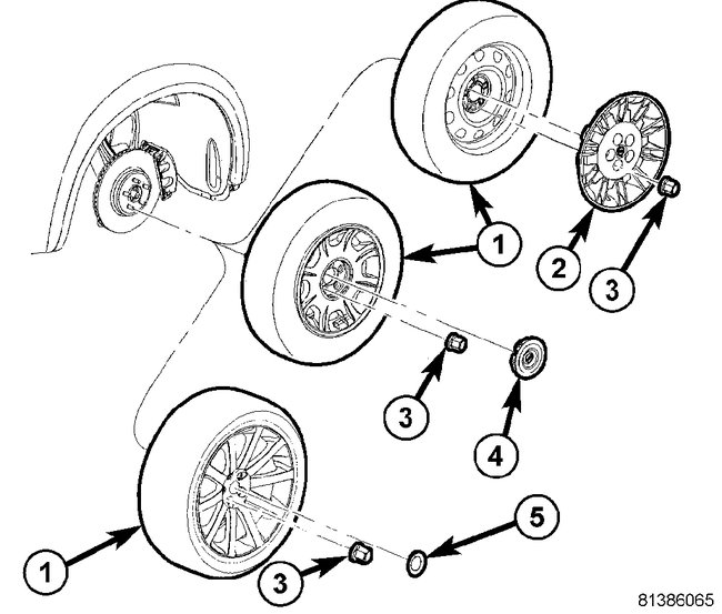

2. Remove wheel mounting nuts (3), then tire and wheel assembly (1).

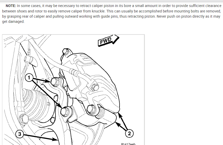

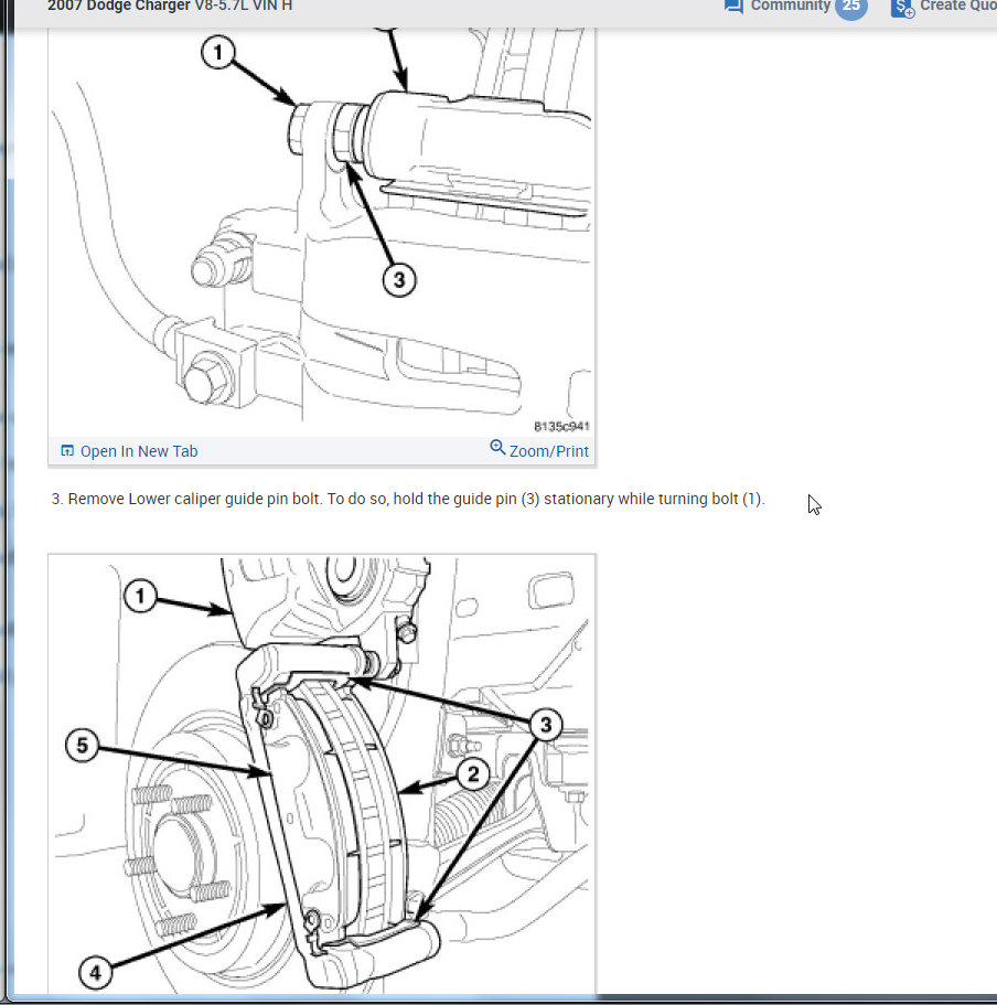

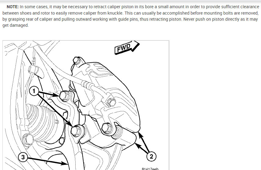

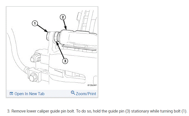

NOTE: In some cases, it may be necessary to retract caliper piston in its bore a small amount in order to provide sufficient clearance between shoes and rotor to easily remove caliper from knuckle. This can usually be accomplished before guide pin bolts are removed by grasping rear of caliper and pulling outward working with guide pins, thus retracting piston. Never push on piston directly as it may get damaged.

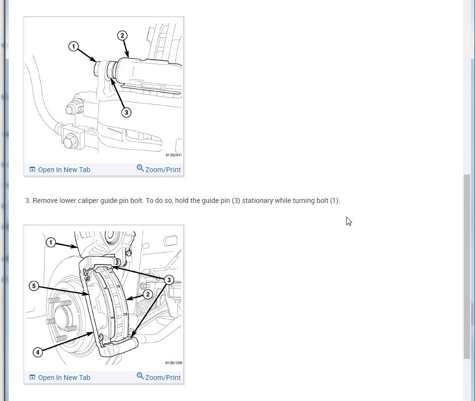

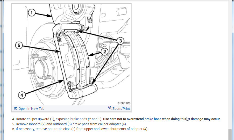

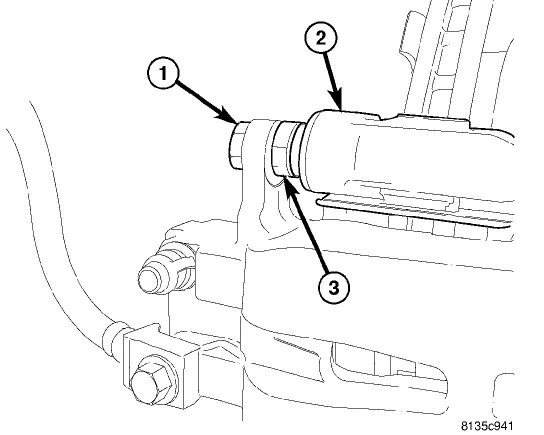

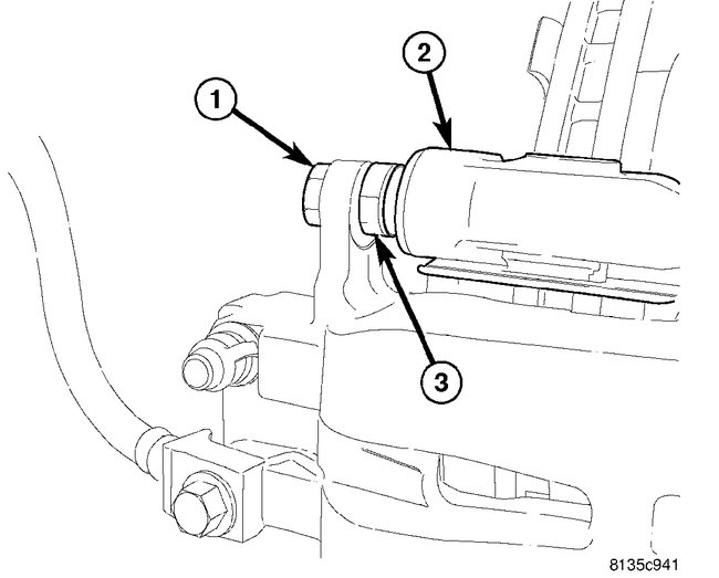

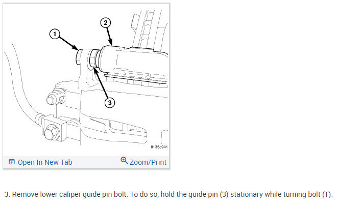

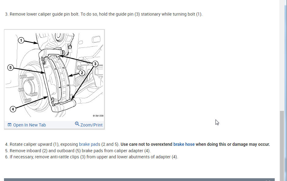

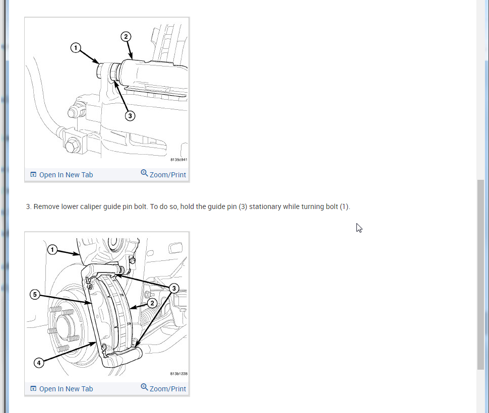

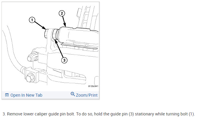

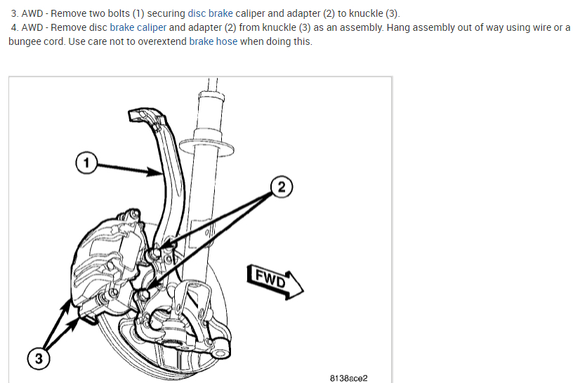

3. Remove Lower caliper guide pin bolt. To do so, hold the guide pin (3) stationary while turning bolt (1) -

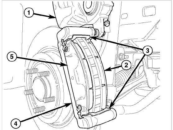

4. Rotate caliper upward (1), exposing brake pads (2 and 5). Use care not to overextend brake hose when doing this or damage may occur.
5. Remove inboard (2) and outboard (5) brake pads from caliper adapter (4).
6. If necessary, remove anti-rattle clips (3) from upper and lower abutments of adapter (4).
CLEANING
WARNING: Dust and dirt accumulating on brake parts during normal use may contain asbestos fibers from production or aftermarket brake linings. Breathing excessive concentrations of asbestos fibers can cause serious bodily harm. Exercise care when servicing brake parts. Do not sand or grind brake lining unless equipment used is designed to contain the dust residue. Do not clean brake parts with compressed air or by dry brushing. Cleaning should be done by dampening the brake components with a fine mist of water, then wiping the brake components clean with a dampened cloth. Dispose of cloth and all residue containing asbestos fibers in an impermeable container with the appropriate label. Follow practices prescribed by the occupational Safety And Health Administration (OSHA) and the Environmental Protection Agency (EPA) for the handling, processing, and disposing of dust or debris that may contain asbestos fibers.
INSPECTION

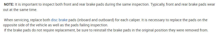

Visually inspect brake pads for uneven lining wear. Also inspect for excessive lining deterioration. Check the clearance between the tips of the wear indicators (if equipped) on the pads and the brake rotors.
If a visual inspection does not adequately determine the condition of the lining, remove the disc brake pads from the calipers and perform a physical check.
NOTE: It is important to inspect both front and rear brake pads during the same inspection. Typically, front and rear brake pads wear out at the same time.
When servicing, replace both disc brake pads (inboard and outboard) for each caliper. It is necessary to replace the pads on the opposite side of the vehicle as well as the pads failing inspection.
If the brake pads do not require replacement, be sure to reinstall the brake pads in the original position they were removed from.

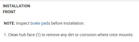

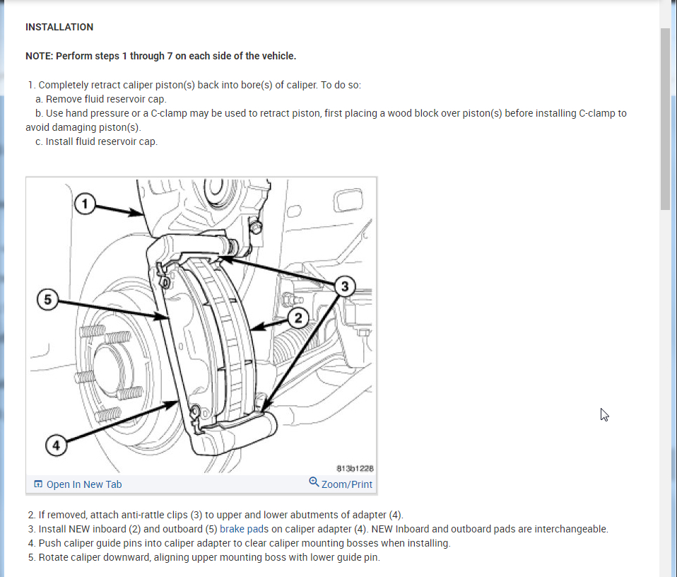

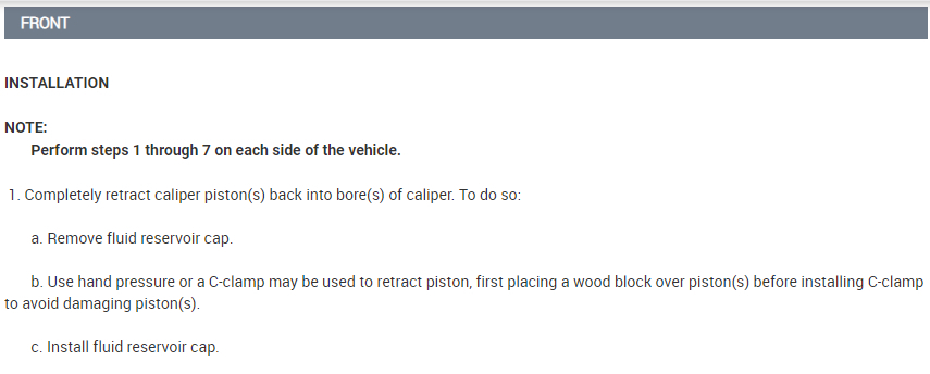

INSTALLATION
NOTE: Perform steps 1 through 7 on each side of the vehicle.

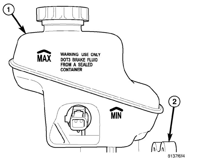

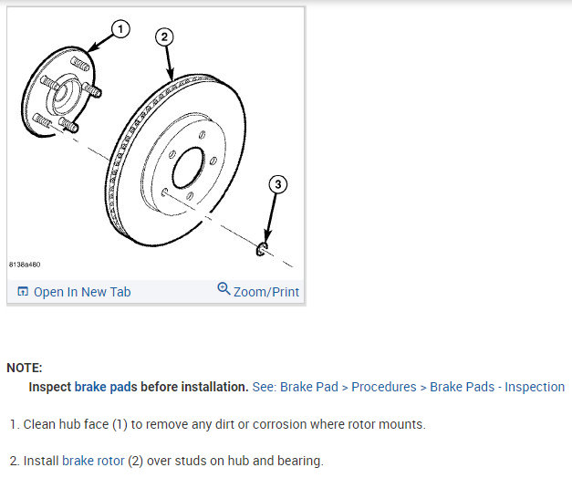

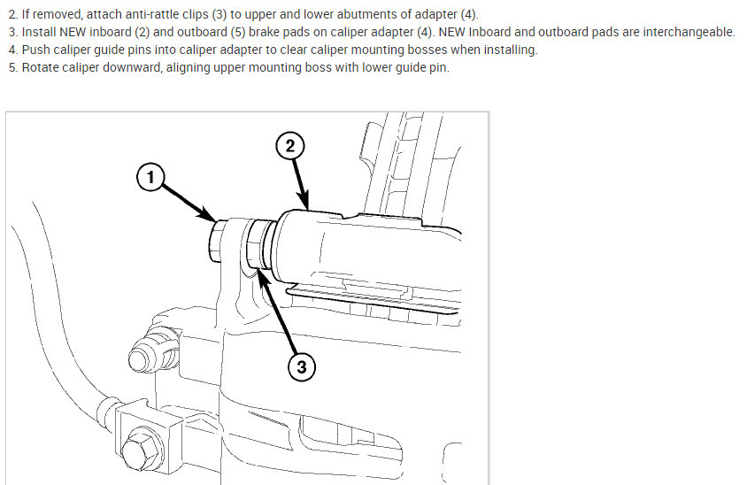

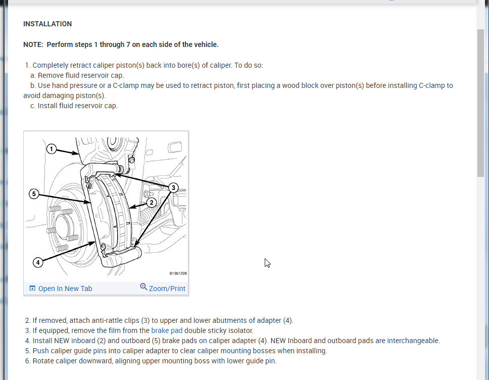

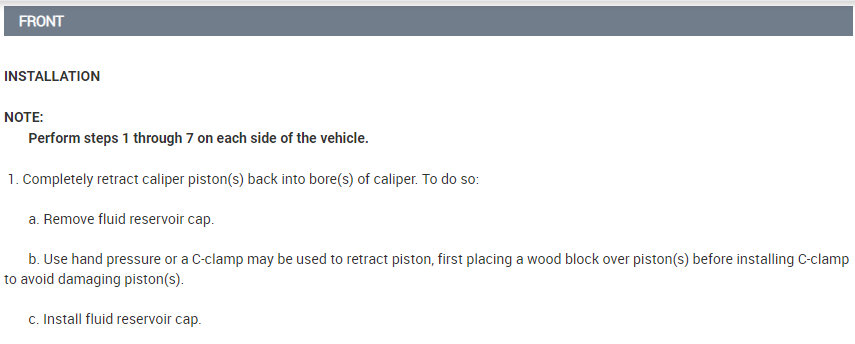

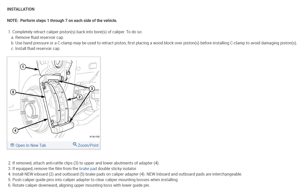

1. Completely retract caliper piston(s) back into bore(s) of caliper. To do so:
a. Remove fluid reservoir cap.
b. Use hand pressure or a C-clamp may be used to retract piston, first placing a wood block over piston(s) before installing C-clamp to avoid damaging piston(s).
c. Install fluid reservoir cap.

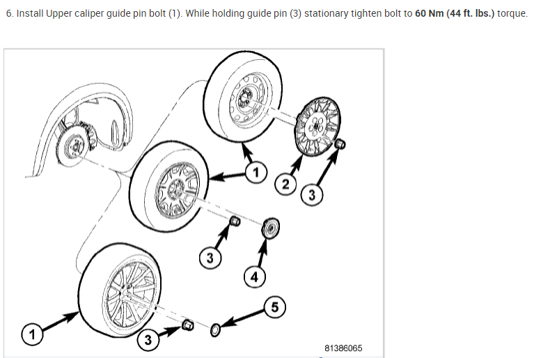

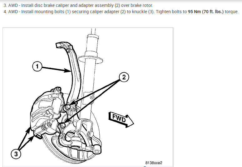

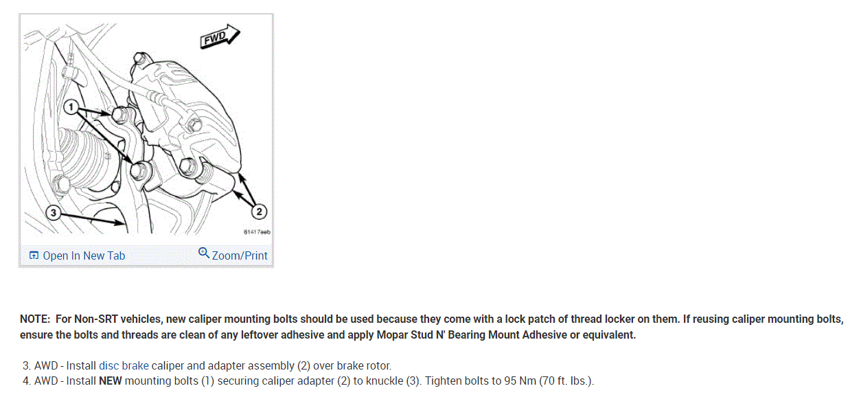

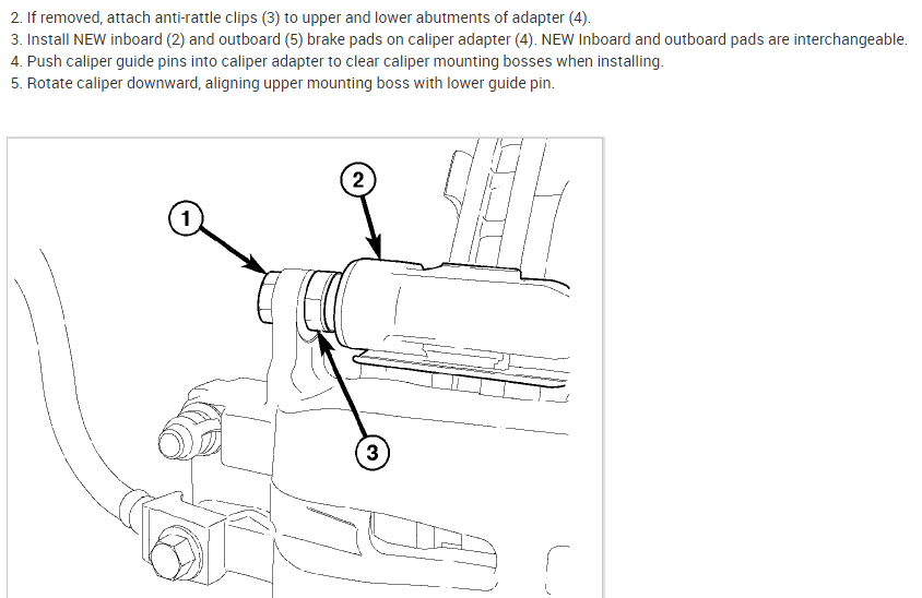

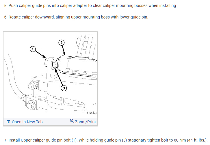

2. If removed, attach anti-rattle clips (3) to upper and lower abutments of adapter (4).
3. Install NEW inboard (2) and outboard (5) brake pads on caliper adapter (4). NEW Inboard and outboard pads are interchangeable.

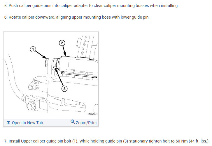

4. Push caliper guide pins into caliper adapter to clear caliper mounting bosses when installing.
5. Rotate caliper downward, aligning upper mounting boss with lower guide pin.

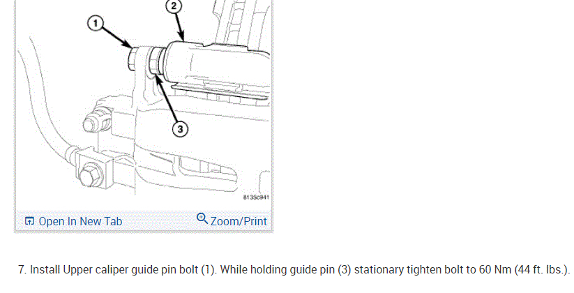

6. Install Upper caliper guide pin bolt (1). While holding guide pin (3) stationary tighten bolt to 60 Nm (44 ft. lbs.) torque.

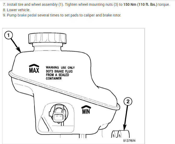

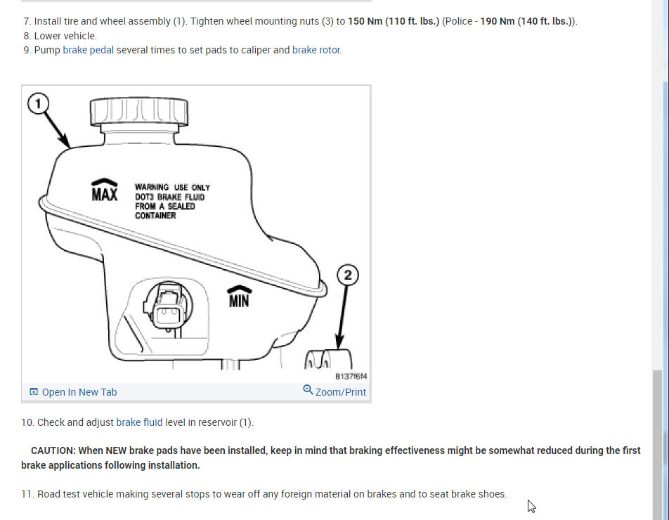

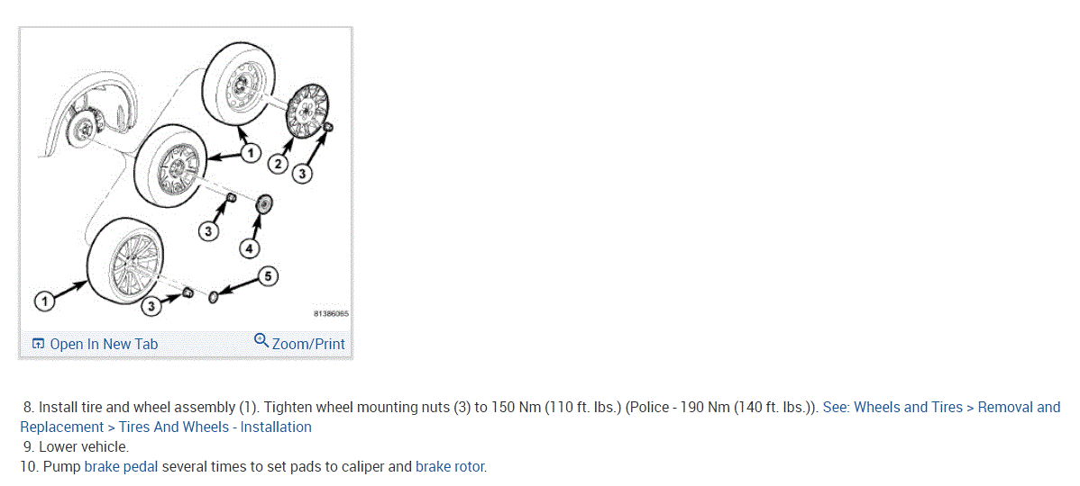

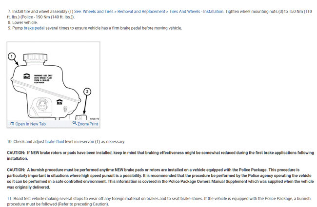

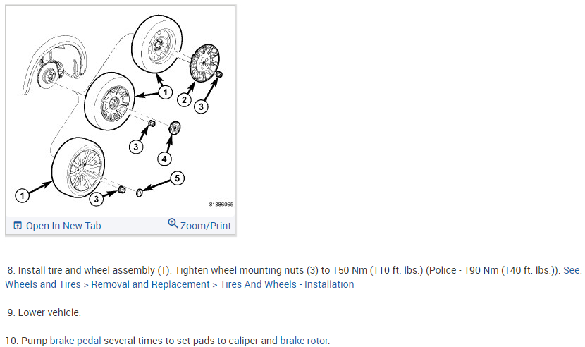

7. Install tire and wheel assembly (1). Tighten wheel mounting nuts (3) to 150 Nm (110 ft. lbs.) torque.
8. Lower vehicle.

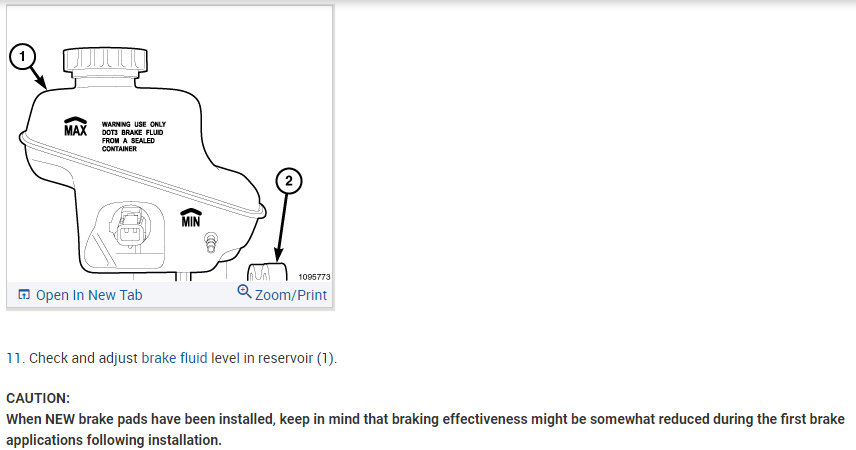

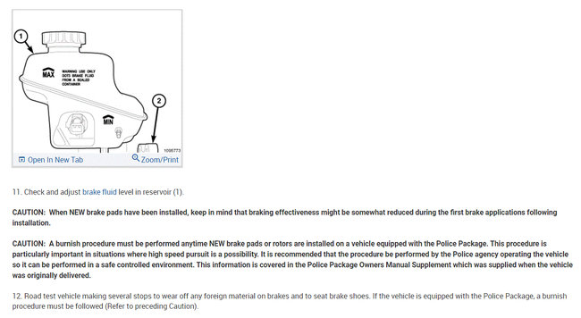

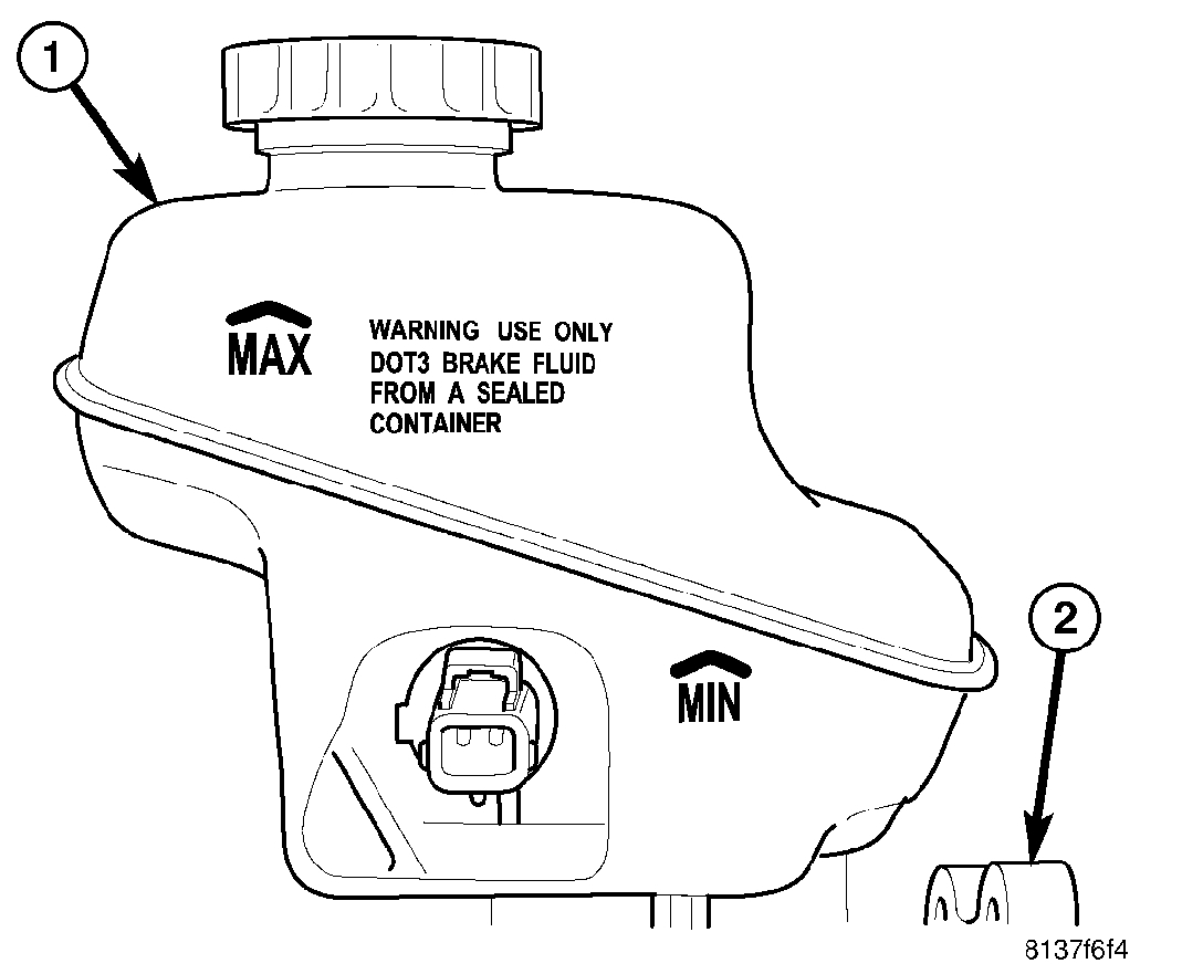

9. Pump brake pedal several times to set pads to caliper and brake rotor.

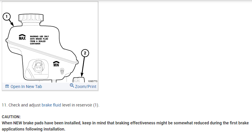

10. Check and adjust brake fluid level in reservoir (1).

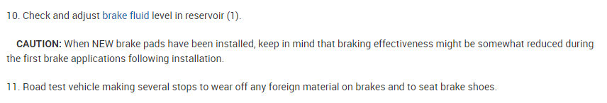

CAUTION: When NEW brake pads have been installed, keep in mind that braking effectiveness might be somewhat reduced during the first brake applications following installation.
11. Road test vehicle making several stops to wear off any foreign material on brakes and to seat brake shoes.
