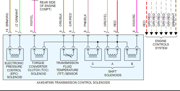

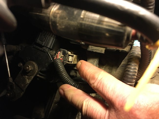

Update: We borrowed a code reader, a really nice Snap On one, and it didn’t pick up anything. Then, when my dad was messing around with it, he unplugged a piece on the top of the transmission, and the transmission engages in all the gears. When he plugged it back in same problem as before. Picture is of piece he unplugged. The piece with the wires coming from it.
Jan 19, 2020 at 9:30 PM
  • 110,194 POSTS
I see the range sensor. The connection near it is for the transmission control circuits. I think that is what was unplugged. Take a look at the pic below. Are those the color wires which you are seeing in the harness? I can't tell from the pic. If they are, my first suspect is a problem with the EPC solenoid on the valve body. EPC stands for electronic pressure control. It may be stuck closed when power is applied.

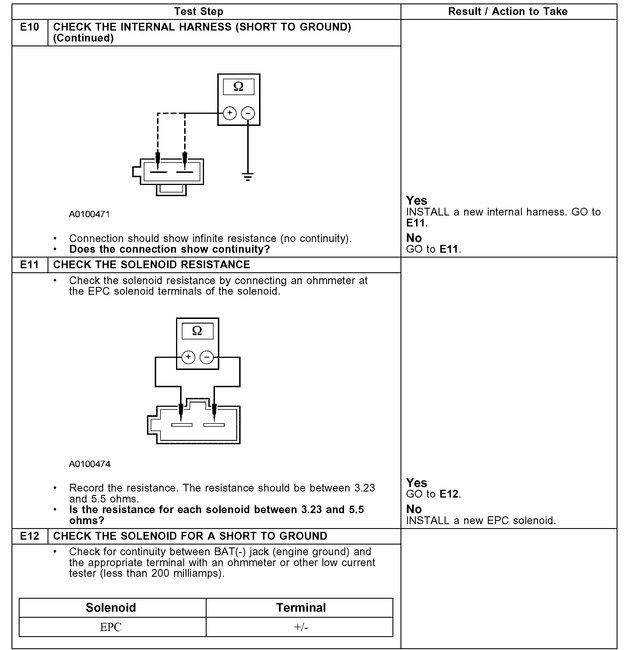

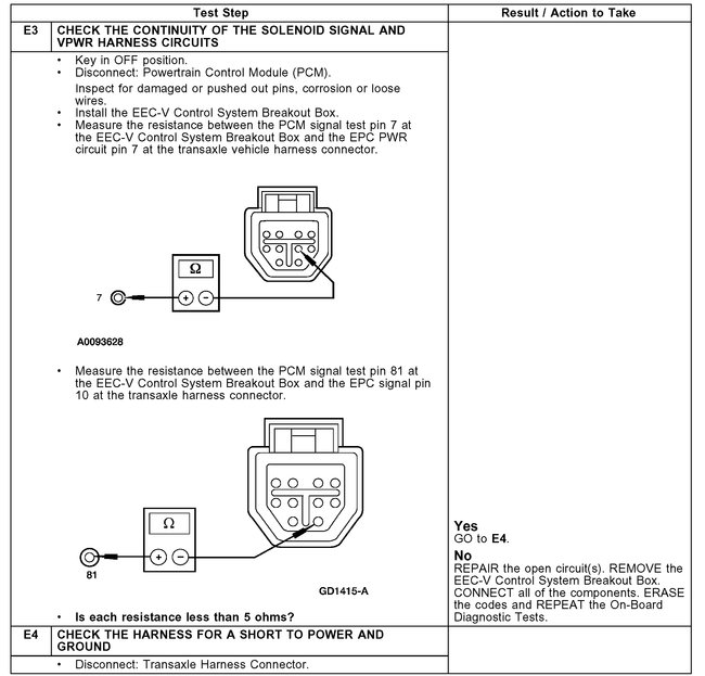

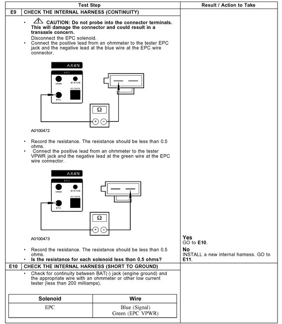

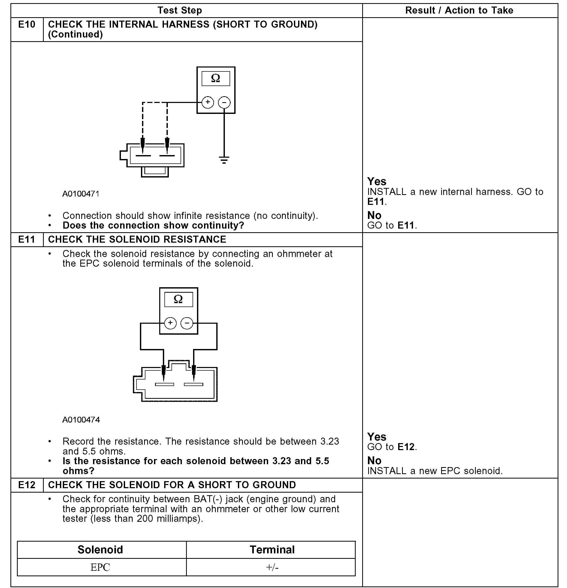

Okay, this sounds like we are heading in the right direction. He says he is only getting any noise from one of the shifter solenoids when he is shifting gears, and it’s in D1. He’s not getting anything from the other solenoids. How would one go about testing your theory?
Jan 26, 2020 at 2:04 AM
  • 110,194 POSTS

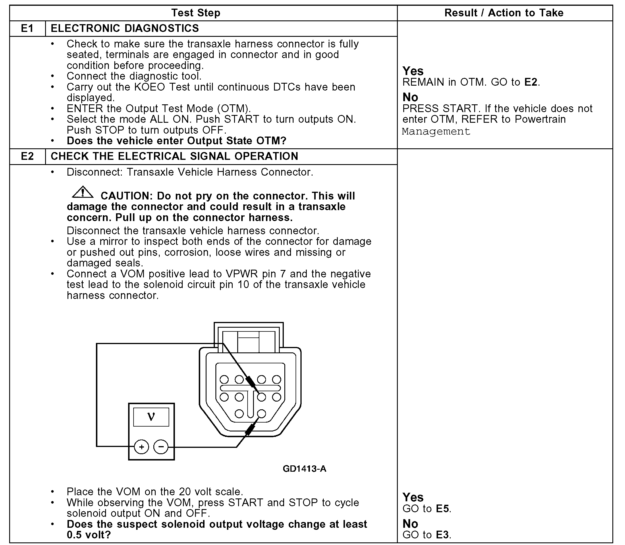

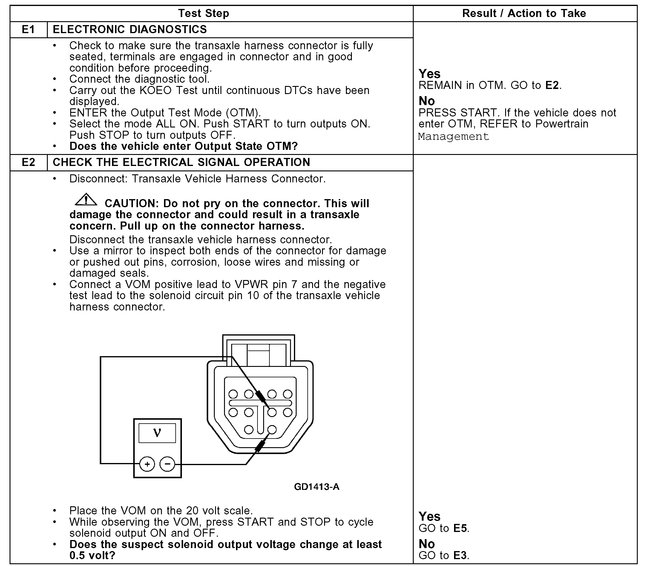

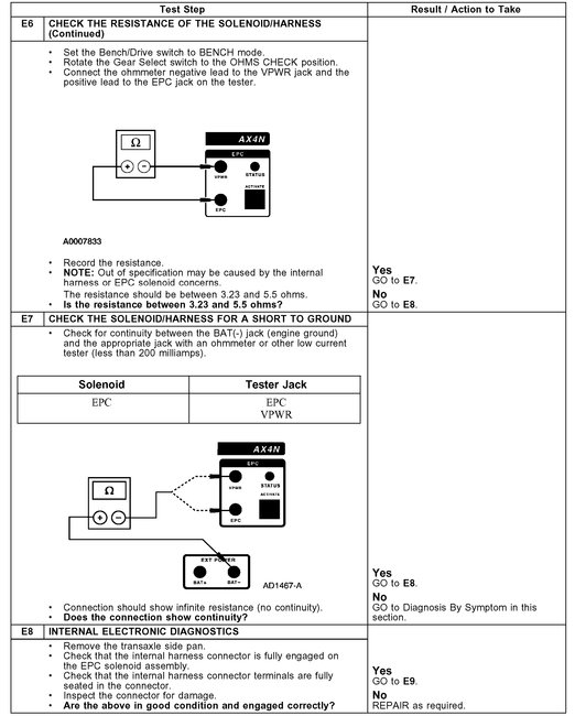

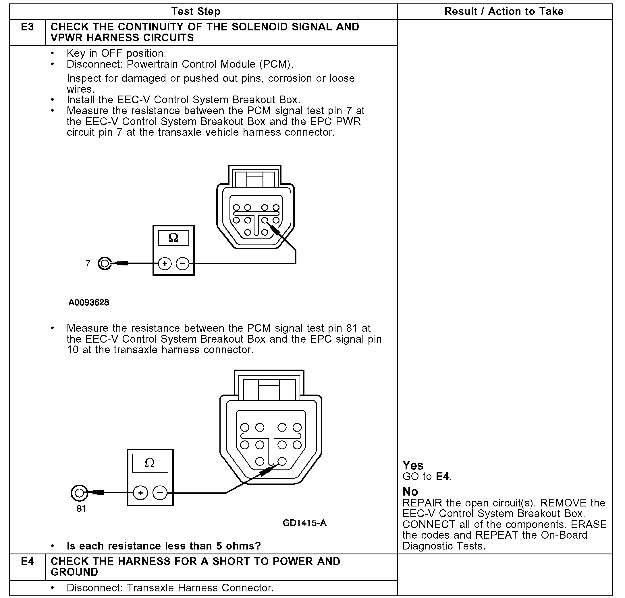

The diagnostics for testing the EPC is listed in the attached pictures. This is somewhat involved. If you run into trouble or have questions, please feel free to let me know and I'll try my best to help from here.
Let me know what you find.

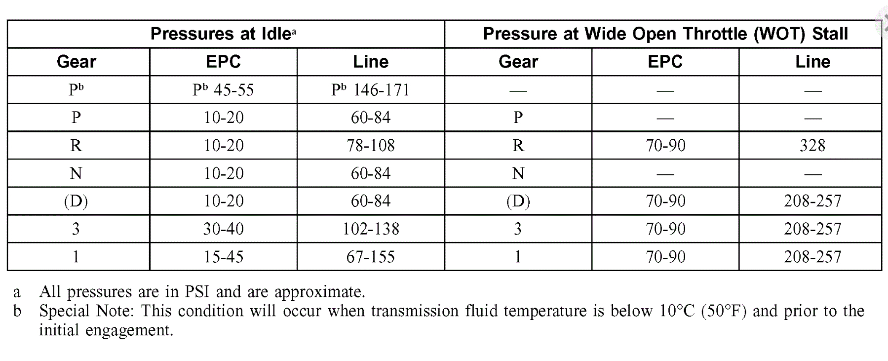

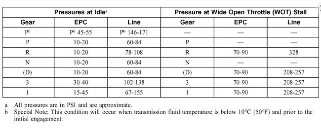

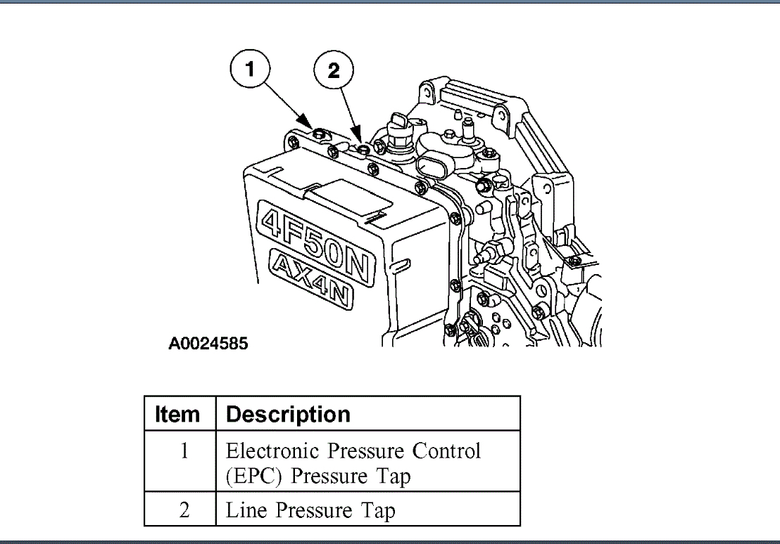

The only other thing I can say to check is if transmission line pressure is within spec. There could be an issue with the epc, electronic pressure control solenoid
If you look at pic 1, it shows where to connect on the trans to check pressure. Pic 2 shows the values / pressure specifications.
Do this and lets see if there is any pressure.
Mar 2, 2020 at 7:37 PM
