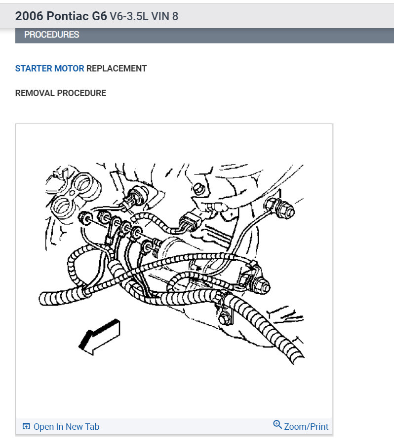

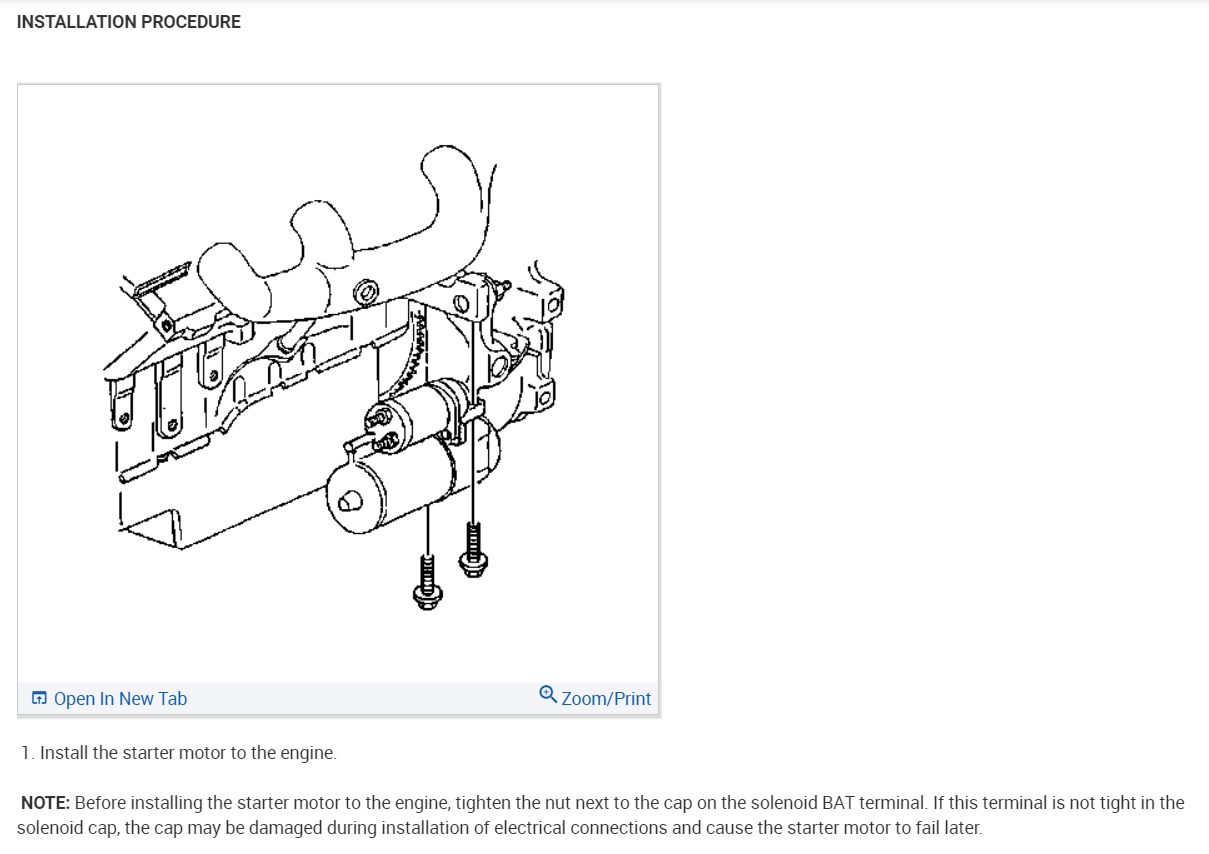

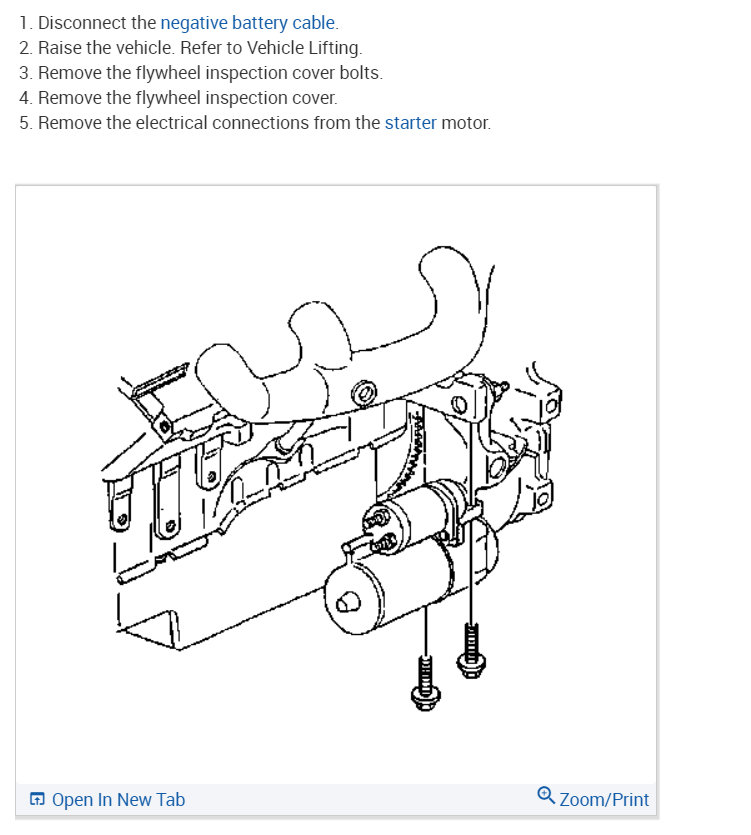

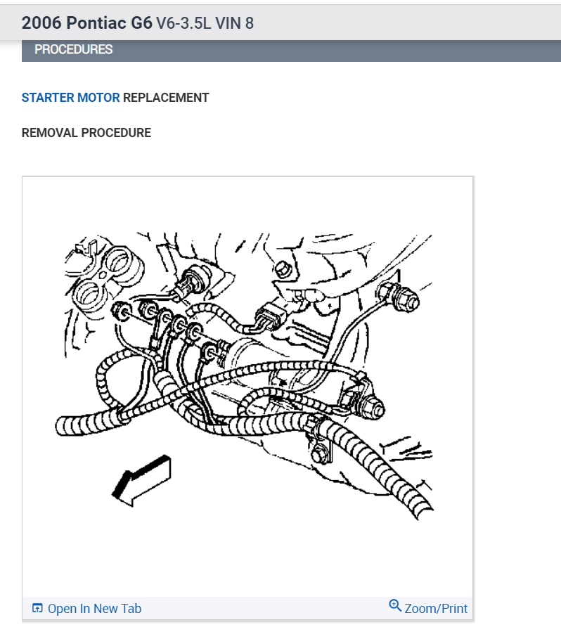

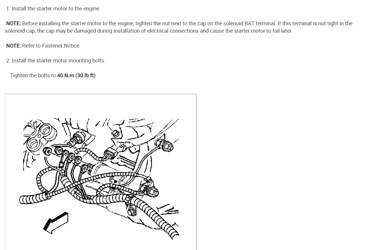

Most likely it is the starter but to be sure we need to test the starter trigger wire for power when the key is in the crank position. This guide will help, and I have included the starter location and replacement instructions in case you need it.
