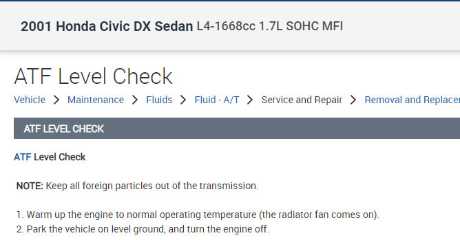

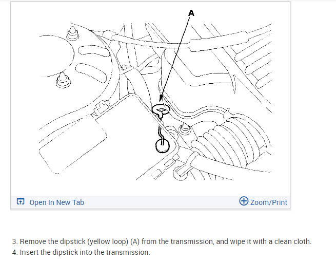

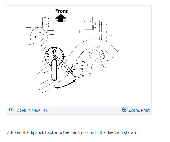

Have you checked the transmission fluid level and condition? If not, check it to see if it is low. Also, the vehicle does have a CVT transmission. They are certainly not the most durable on the market. When they fail, it usually requires a replacement and not a repair.
I attached the directions below for checking the ATF. I'm basing this on when you place it in gear and press the accelerator, the engine just revs and the car doesn't move. Take a look and let me know what you find.

I checked the transmission fluid, and it’s both clean and at the right level.

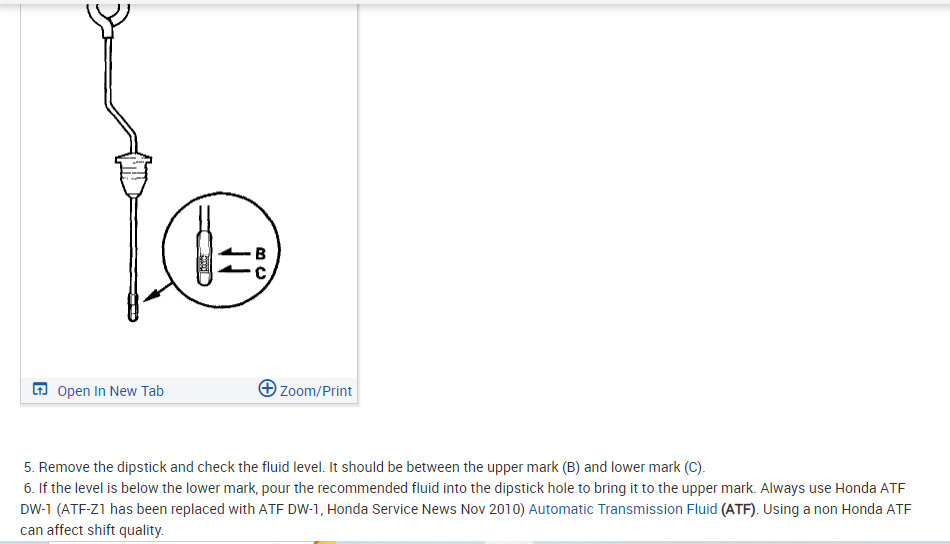

That is very possible. If you allow it to sit overnight and drain it the next day, you may get a lot of it out of the trans. Do that a couple of times (flushing), may clean it.
What I would try is to drain it, refill it and start the engine for a few minutes and shift through the gears and then drain it again to see if more dirt comes out. You aren't seeing the dirt at the bottom of the transmission, so it may help.
Whatever you do, make sure to use the correct type of transmission fluid. See pic below.

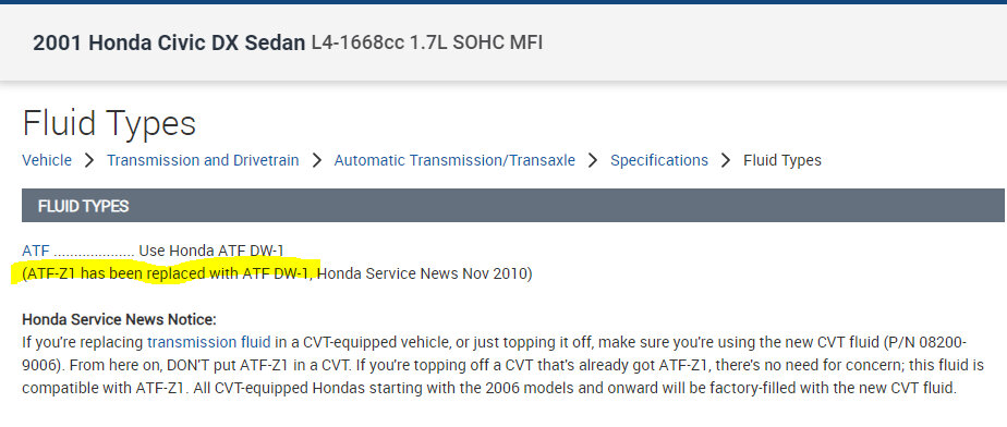

Since it is not a CVT, I think I cannot use Genuine Honda Fluid 08200-9006 but I can still use the Valvoline Import Multi-Vehicle (ATF) Full Synthetic Automatic Transmission Fluid to flush (The picture you sent shows ATF-Z1 is till good to use )
Sep 26, 2024 at 5:04 AM
  • 110,251 POSTS
The ATF-Z1 is for a CVT, and not a traditional type fluid. DW-1 is for a non-CVT Honda transmission.

Okay. Then probably I cannot use Valvoline since the package did not show DW-1. Another product shows DW-1 on the back and I will use it:

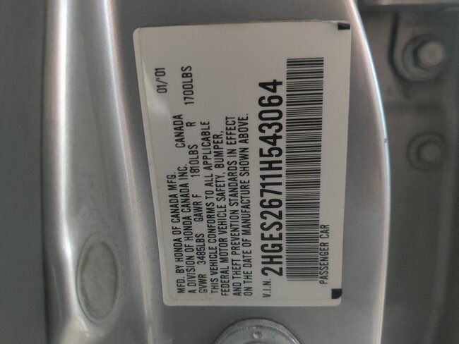

Yes. It's confusing. The VIN is: 2HGES26711H543064
You said The ATF-Z1 is for a CVT and DW-1 is for a non-CVT Honda transmission. The dealer said it's not a CVT and it use DW-1 but the user manual coming with the car says the following:
"Always use genuine Honda ATF-Z1 If it is not available, you can use a DEXRON III Automatic transmission fluid as a temp replacement"
That's the reason I think maybe the Castrol brand is a safe choice because it works with both types --- CVT and non-CVT.

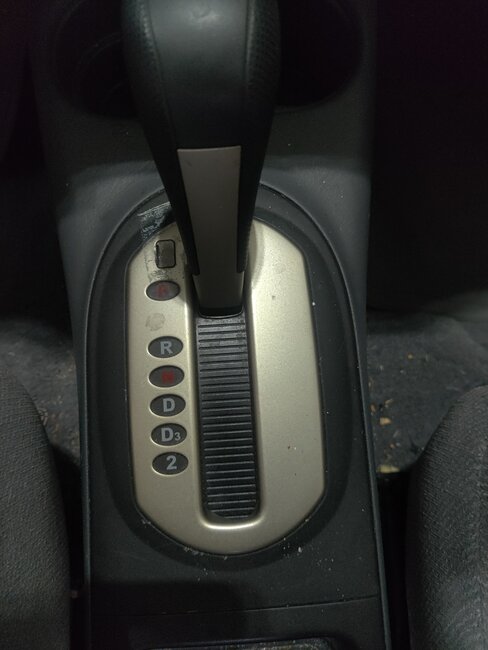

Someone says the transmission type could be on the driver's side door. Mine does not have the info:
Sep 26, 2024 at 6:59 AM
MING FENG
  • 82 POSTS
Pictures:
Sep 26, 2024 at 7:11 AM
MING FENG
  • 82 POSTS
Gear Shifter
Sep 26, 2024 at 7:25 AM
MING FENG
  • 82 POSTS
and front panel
  • 110,251 POSTS
You're not going to believe this. Your vin number takes me to a manual transmission vehicle. Ugh! Have you owned the vehicle since it was new?

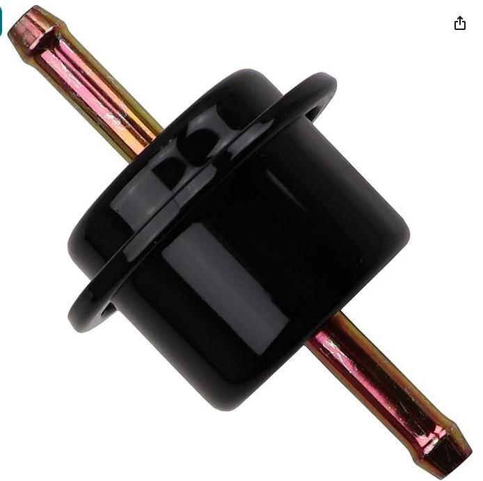

I also watched a YouTube video that showed an external transmission filter located under the air filter box (see picture), but it was for a 2006 Honda Civic. I plan to remove the air filter box to check if my car has one as well.

I checked and there is no external filter for the 2001 model.
