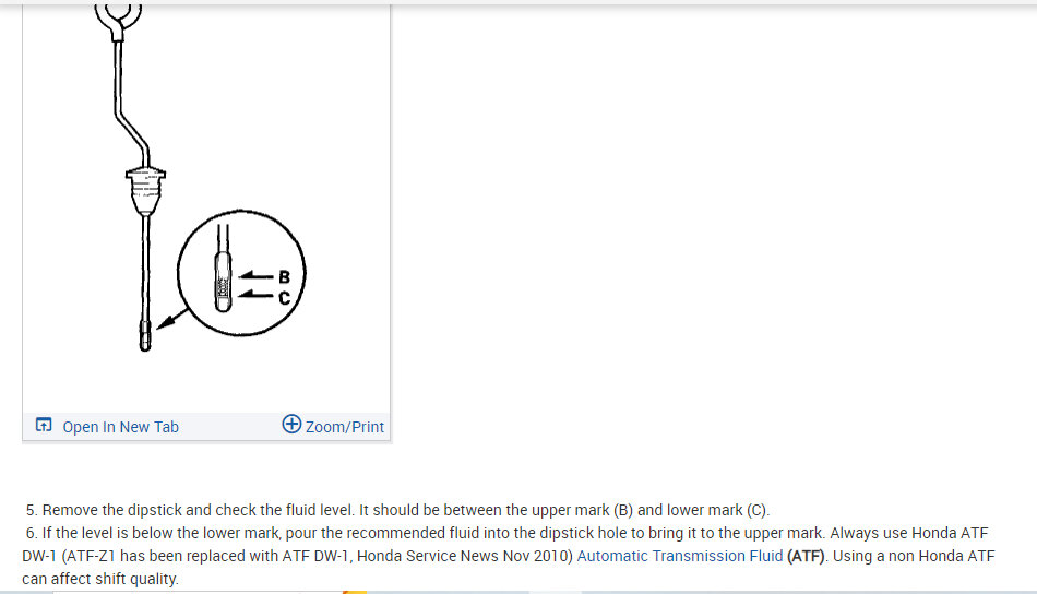

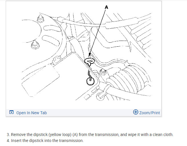

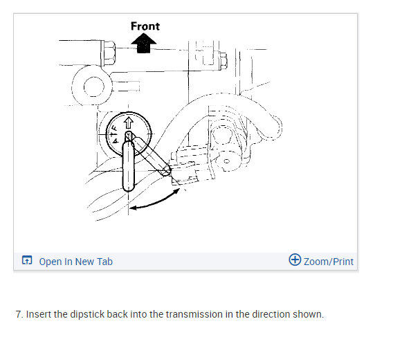

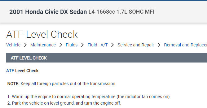

Have you checked the transmission fluid level and condition? If not, check it to see if it is low. Also, the vehicle does have a CVT transmission. They are certainly not the most durable on the market. When they fail, it usually requires a replacement and not a repair.
I attached the directions below for checking the ATF. I'm basing this on when you place it in gear and press the accelerator, the engine just revs and the car doesn't move. Take a look and let me know what you find.

I checked the transmission fluid, and it’s both clean and at the right level.

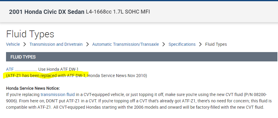

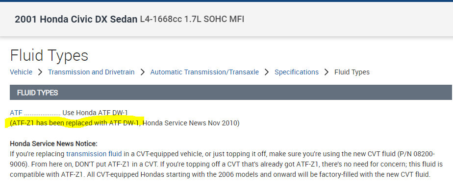

Whatever you do, make sure to use the correct type of transmission fluid. See pic below.
See pic below.

We need to confirm what transmission it is before flushing. I say that because the correct fluid is needed, and at this point, we aren't sure which that will be.
Do me a favor. Let me know the VIN number and I'll try digging deeper into what we need to do. DW-1 is a transmission fluid for a non-CVT transmission. It isn't a transmission type, so I'm confused as well. My manual only indicates a CVT for this vehicle, but I'm not a dealer. They would have more info on the vehicle.

The ATF-Z1 is for a CVT, and not a traditional type fluid. DW-1 is for a non-CVT Honda transmission.
Sep 26, 2024 at 5:06 AM

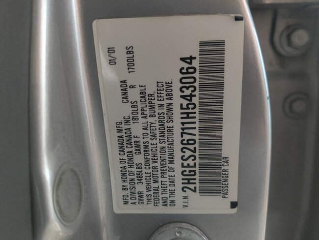

Yes. It's confusing. The VIN is: 2HGES26711H543064
You said The ATF-Z1 is for a CVT and DW-1 is for a non-CVT Honda transmission. The dealer said it's not a CVT and it use DW-1 but the user manual coming with the car says the following:
"Always use genuine Honda ATF-Z1 If it is not available, you can use a DEXRON III Automatic transmission fluid as a temp replacement"
That's the reason I think maybe the Castrol brand is a safe choice because it works with both types --- CVT and non-CVT.

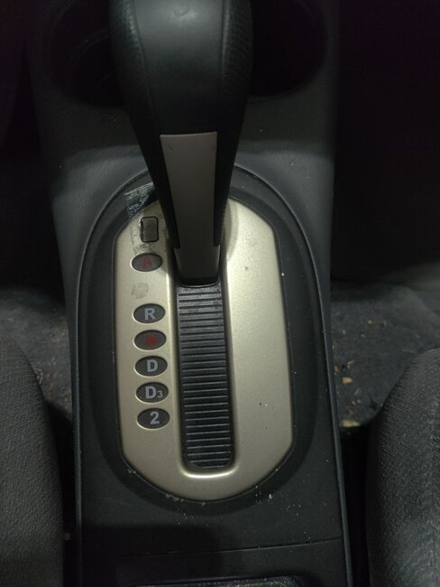

Someone says the transmission type could be on the driver's side door. Mine does not have the info:

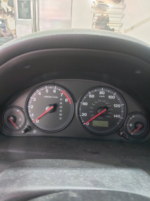

Pictures:
Sep 26, 2024 at 7:11 AM
MING FENG
  • 82 POSTS
Gear Shifter

and front panel

You're not going to believe this. Your vin number takes me to a manual transmission vehicle. Ugh! Have you owned the vehicle since it was new?

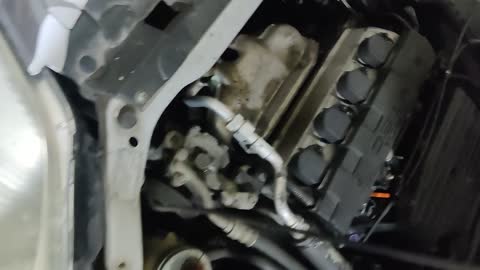

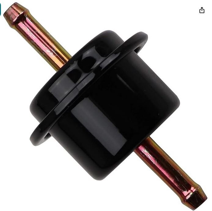

I also watched a YouTube video that showed an external transmission filter located under the air filter box (see picture), but it was for a 2006 Honda Civic. I plan to remove the air filter box to check if my car has one as well.
Thank you very much,
Ming
Sep 28, 2024 at 12:10 PM
MING FENG
  • 82 POSTS
I checked and there is no external filter for the 2001 model.

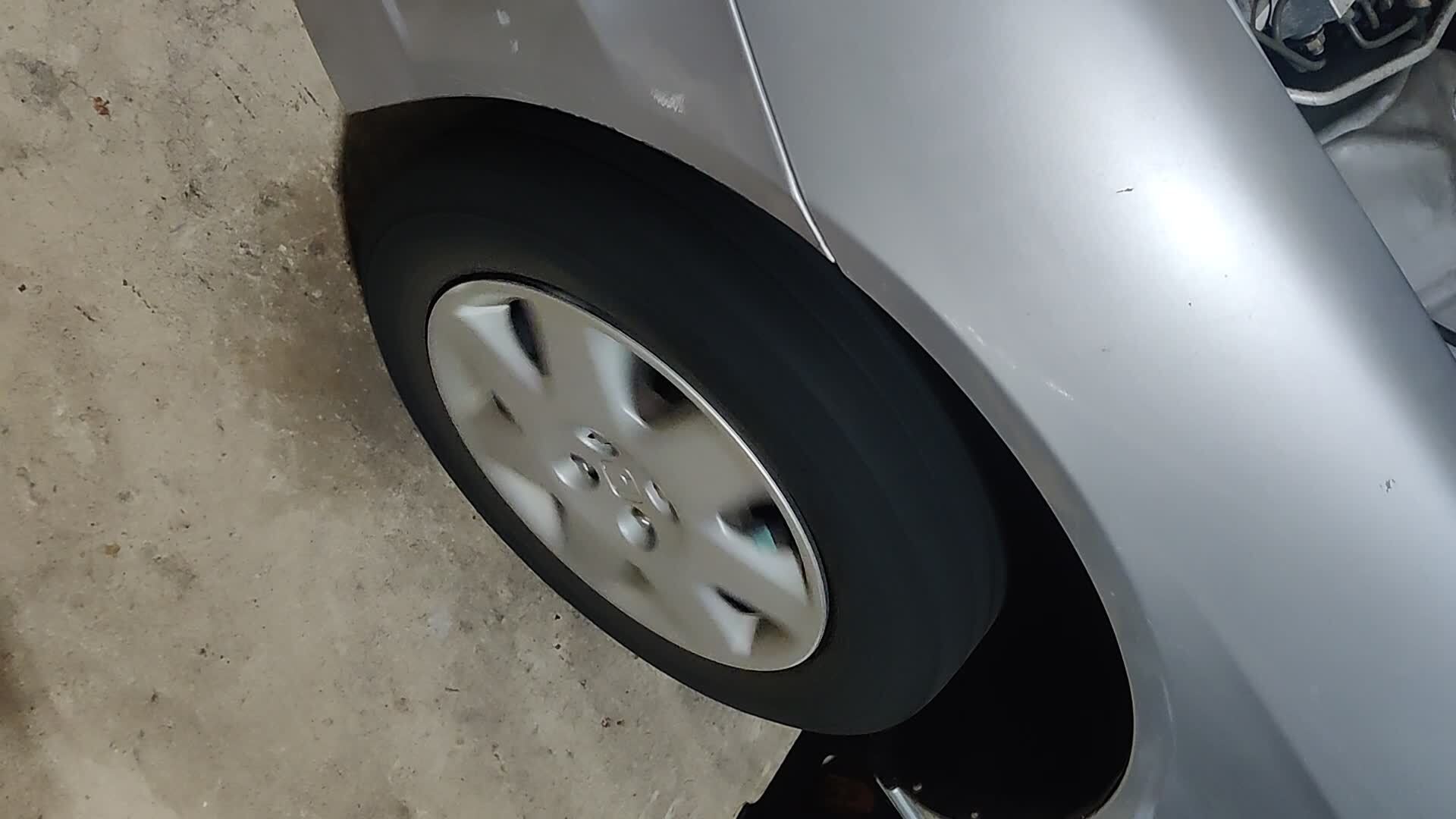

The video shows what the setup looks like. After the driver's side wheel stopped, I pressed the accelerator, and it started spinning again. Additionally, when I put the gear in Neutral and revved the engine, the driver's side wheel is also spinning. (not sure if the video can play)
Sep 28, 2024 at 1:00 PM
MING FENG
  • 82 POSTS
Is it possible that the passenger side wheel is disengaged somehow, and with only one wheel receiving power, there's not enough force for the car to move?
Sep 28, 2024 at 1:22 PM
  • 110,244 POSTS
If you have one wheel/axle disconnected from the transmission, the car won't move. Power is distributed to the wheel of least resistance. That would be the one not connected in this case.
Here is an easy test. If you question a broken axle or CV joint, place the vehicle in park with the parking brake off and see if it holds. If you can move the vehicle like it's in neutral, we need to check the axles.
Sep 29, 2024 at 11:12 AM
