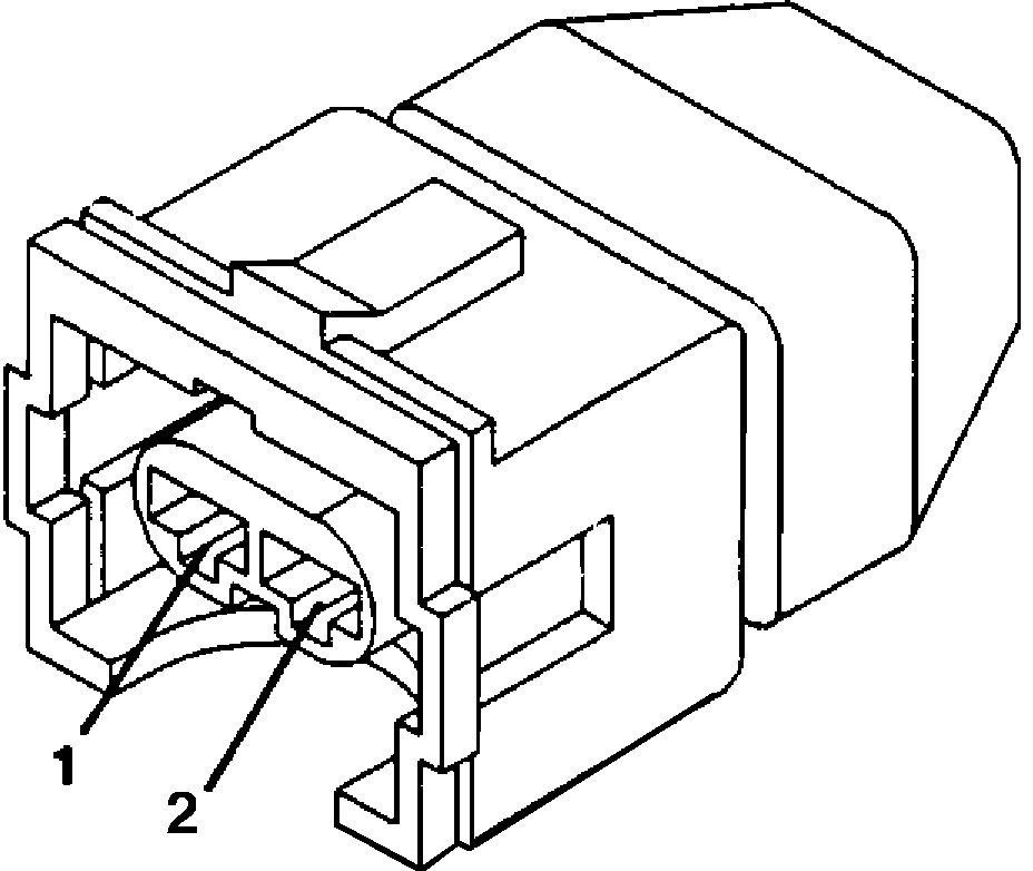

Fuel Injector Connector
pic 1

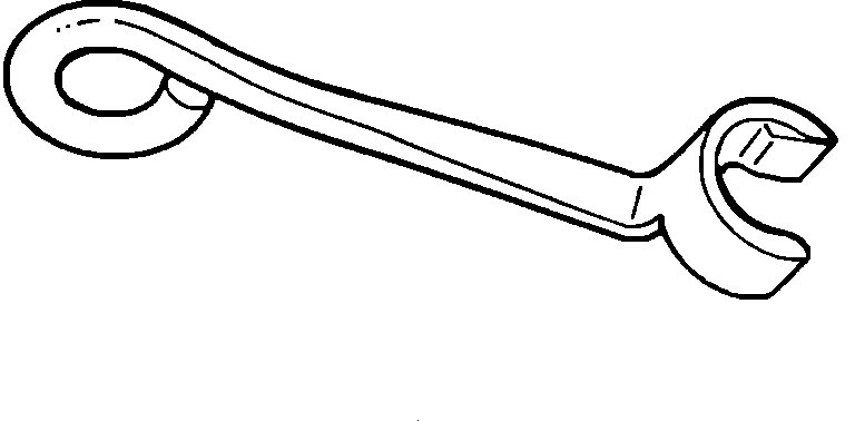

1. Release fuel system pressure.
2. Disconnect the fuel supply hose from the fuel rail, and install fuel line adaptor, tool number C-4799 or equivalent.
Fuel Line Disconnect Tool 6182

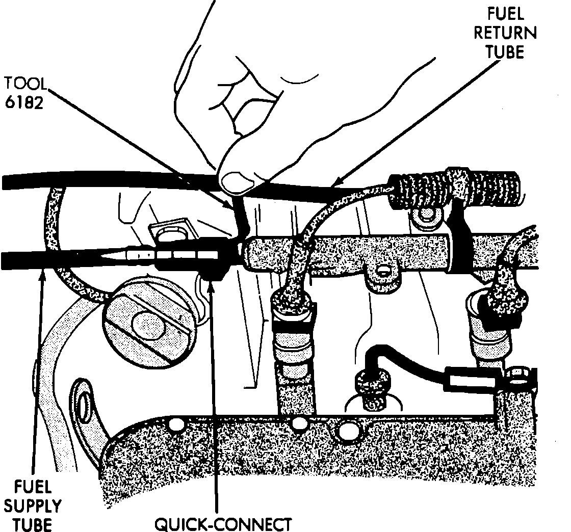

pic 2
Using Fuel Tube Disconnect Tool No. 6182
pic 3
