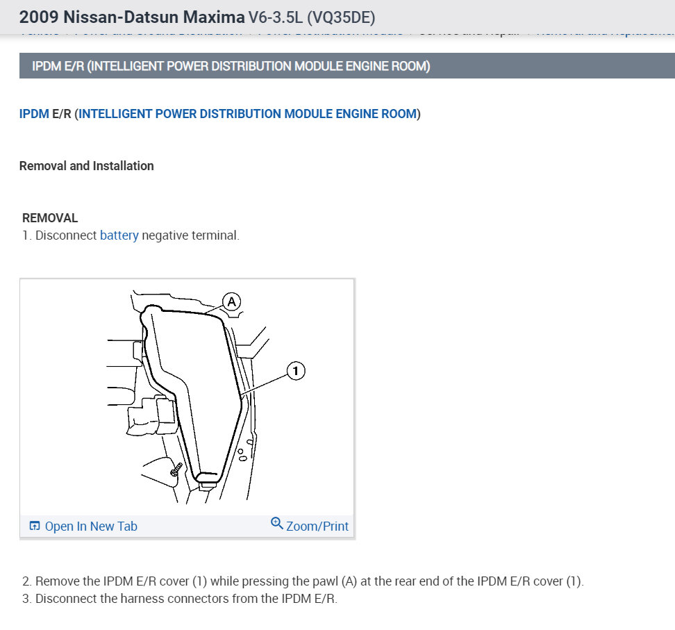

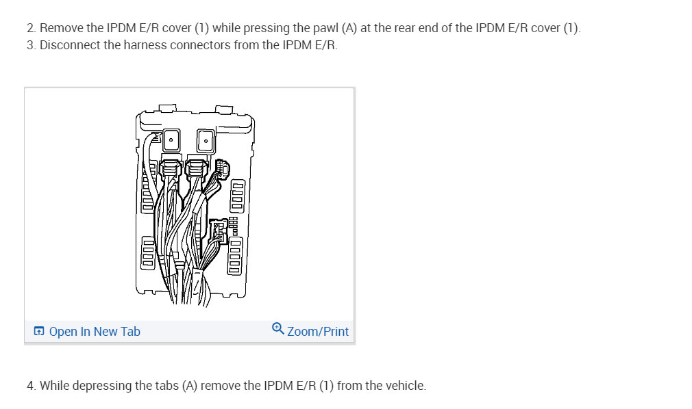

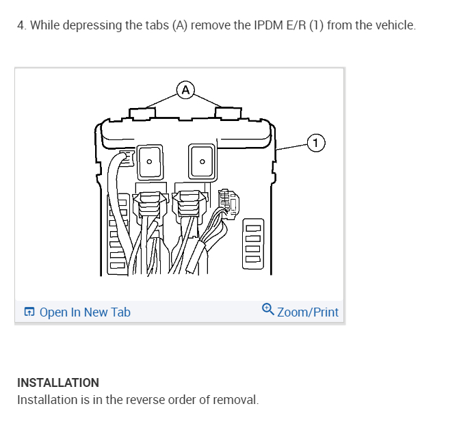

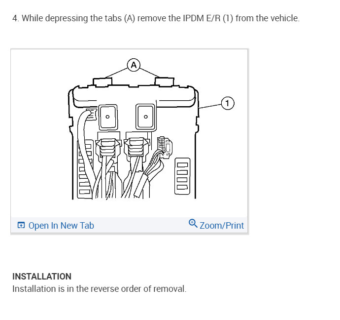

It sounds like you had a voltage surge which happens, you can try to disconnect the battery overnight to see if it resets the system. If not, it sounds like the IPDM got shorted out which happens, but it is easy to replace because it-self learns. Check out the images (below). Let us know what happens and please upload pictures or videos of the problem.
