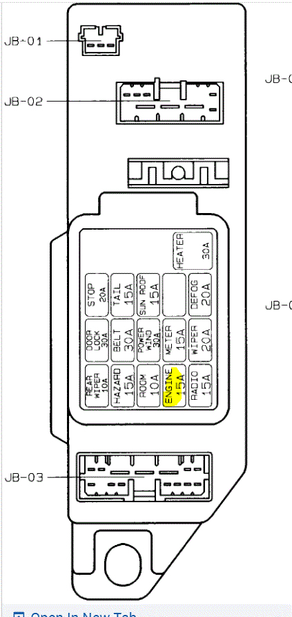

If that is the case, I need you to check the fuel injectors for power and ground. Each injector has a white wire with a red tracer. That is the power supply that should be present when the key is in the run or start positions.
If they all have power, the PCM is what provides the ground path for them to energize, so that could be an issue. If there is no power when this happens, check the main relay and the fuel injection fuse in the under-hood fuse box. Also, check the engine fuse in the joint box.
When checking the fuses, make sure there is power to them and make sure they are tight and not corroded. Note: These tests need to be done when the vehicle refuses to start.
Here are two links you may find helpful:
The pic below shows the fuse box in the vehicle (left side under dash). I have no pic for the under-hood box.
See pic below.
