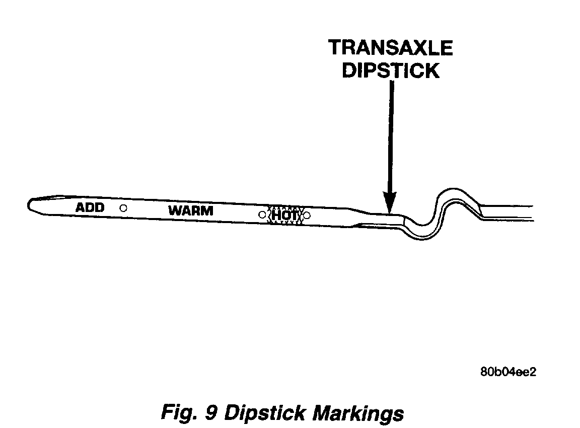

Fig. 9
pic 1
The transmission sump has a dipstick to check oil similar to most automatic transmissions. It is located on the left side of the engine. Be sure to wipe all dirt from dipstick handle before removing.
The torque converter fills in both the P Park and N Neutral positions. Place the selector lever in P Park to be sure that the fluid level check is accurate. The engine should be running at idle speed for at least one minute, with the vehicle on level ground. At normal operating temperature (approximately 82 C or 180 F), the fluid level is correct if it is in the HOT region (cross-hatched area) on the oil level indicator (Fig. 9). The fluid level will be approximately one-quarter inch above the lower hole of the dipstick at 70° F fluid temperature.

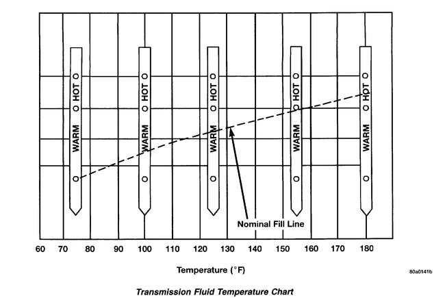

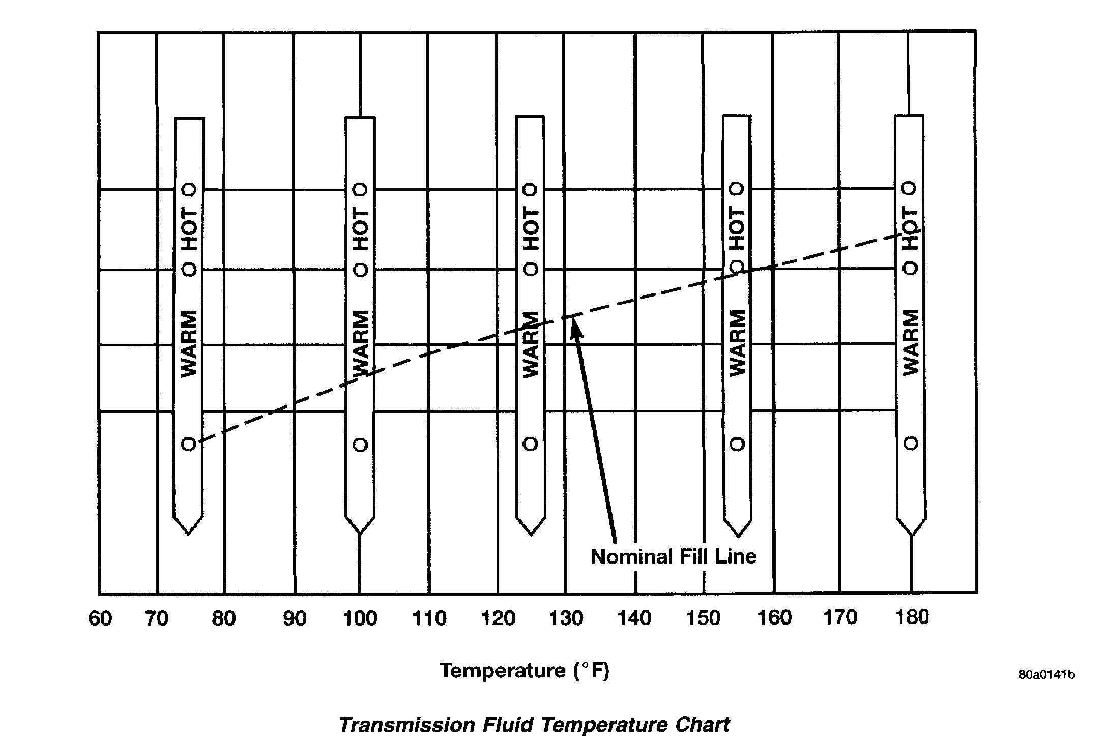

Transmission Fluid Temperature Chart
pic 2
5. Compare the fluid temperature value with the chart.
6. Adjust transmission fluid level shown on the dipstick according to the chart.
