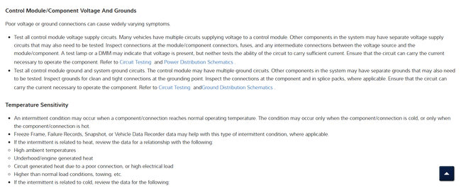

I replaced/tested (and checked for resistance) all relays and fuses last night (especially crank/start/pwr trn) and got the lighting back online after an ordeal of erratic and flickering instrument cluster and dashboard lights, symbols, check engine light, ABS etc. Car remained normal while driving home and interior and headlights perfectly strong. Turned off the car and checked fluids (all normal and no leaks). tried to start car 3 hours later, but car remained unresponsive (no cranking and no instrument lighting). Instrument panel normalized and battery recharged holding at 13.1V-12.87V after replacing and testing relays and fuses, but will not click or crank. OBDII No codes. Anti Theft/Starter/Alternator was told unlikely suspect since car was in drive mode already and battery remained strong. Nevertheless I am testing these components but can't find an issue. What is going on?

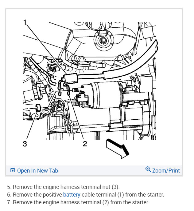

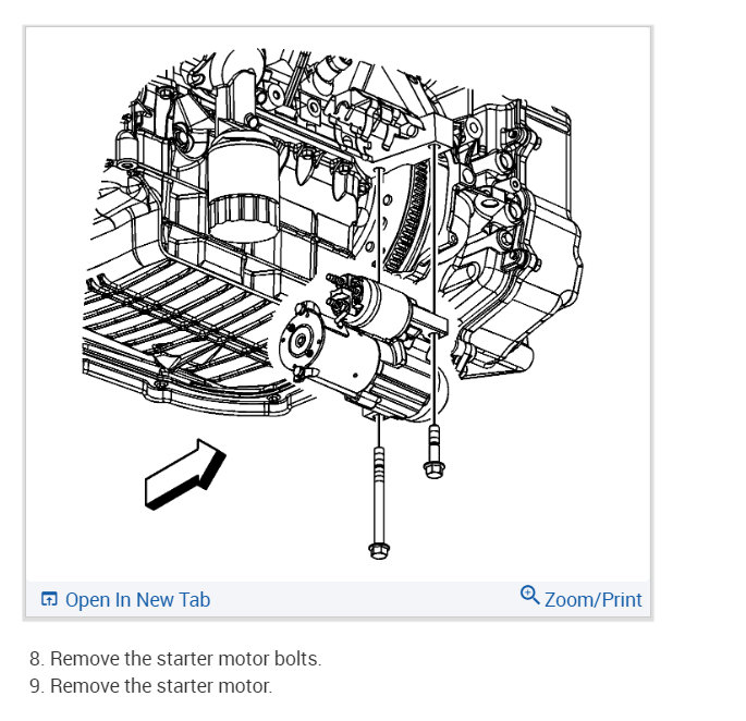

  • 55,785 POSTS

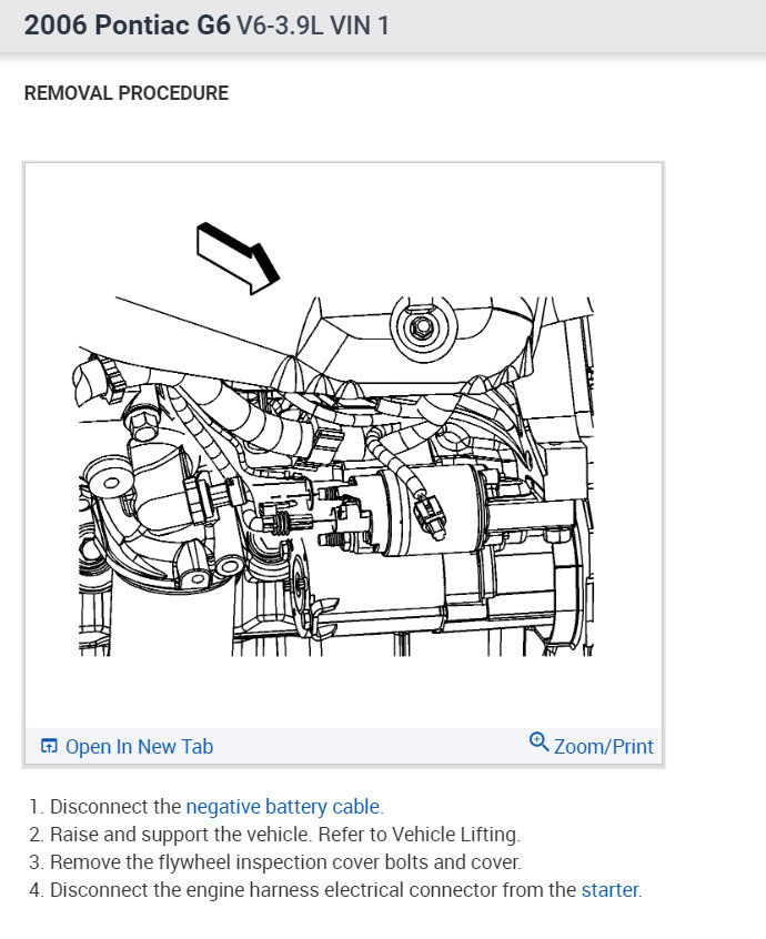

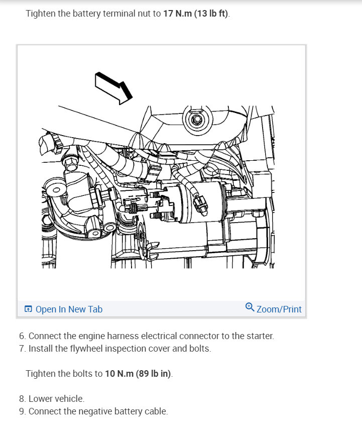

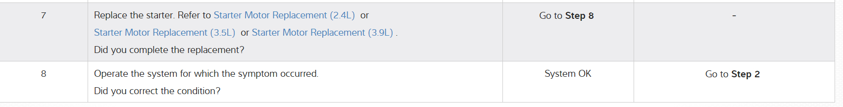

It sounds like the starter has gone out. To be sure we need to check the power to the starter solenoid.
if the starter is bad this guide will help you step by step on how to change it out with diagrams below to show you on your car:
Feb 1, 2020 at 6:03 AM

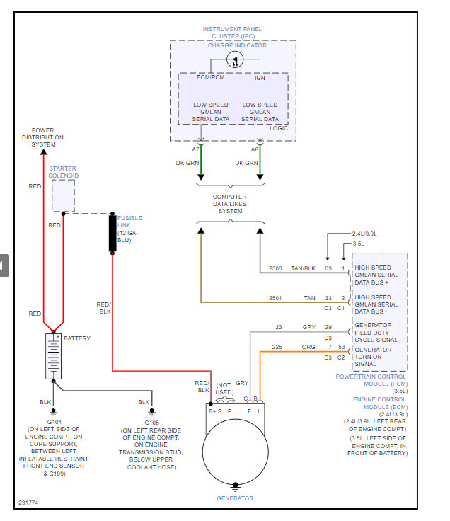

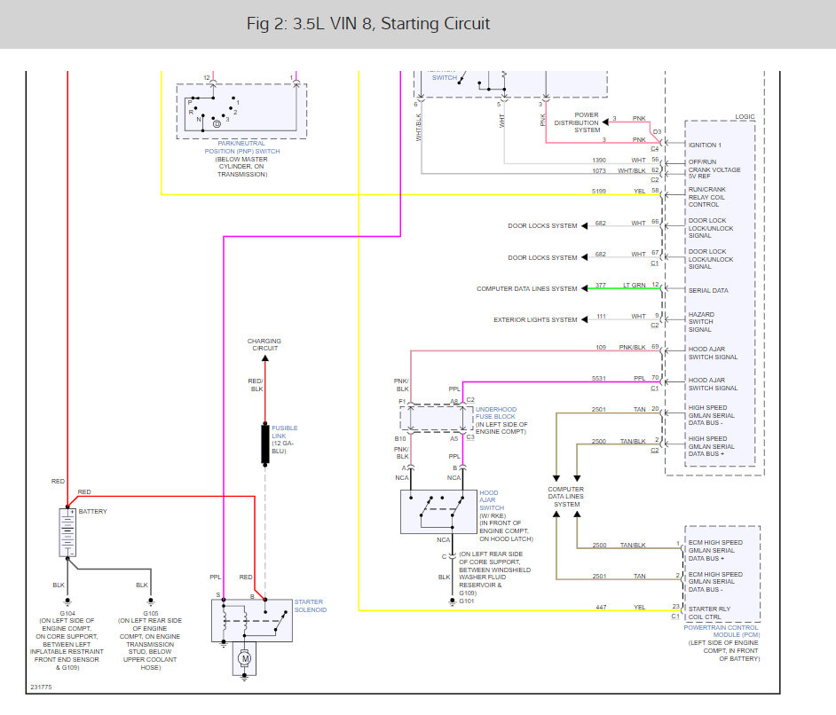

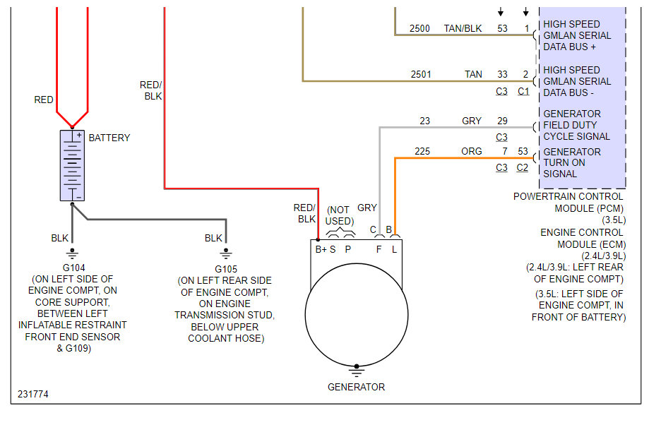

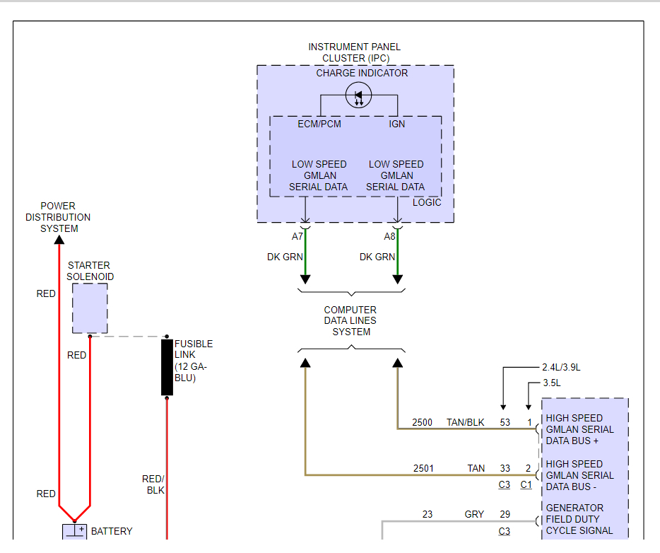

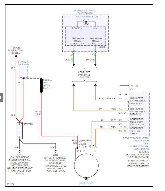

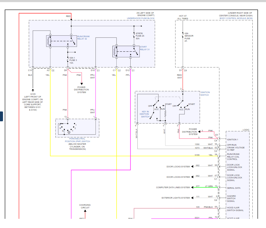

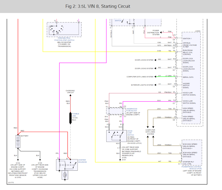

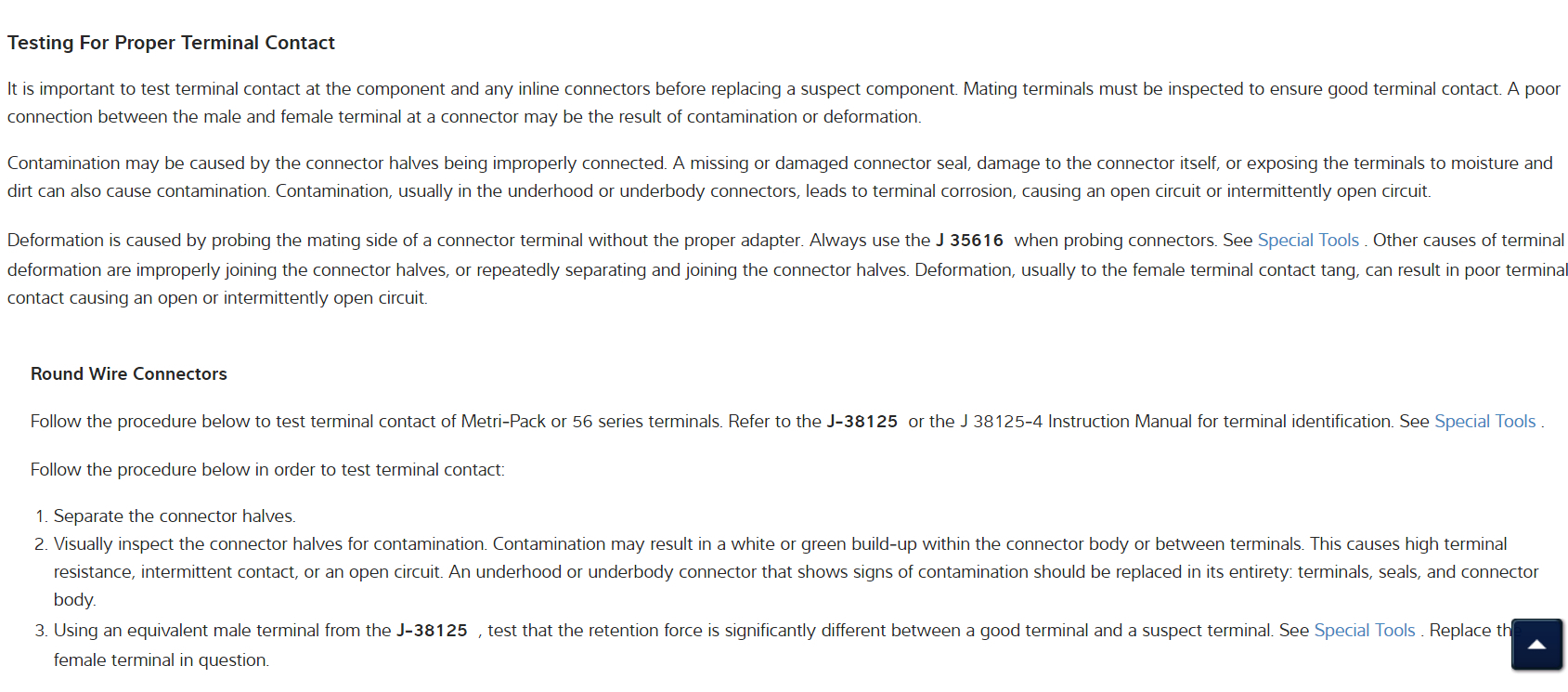

Hello Ken,

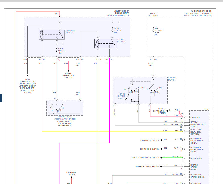

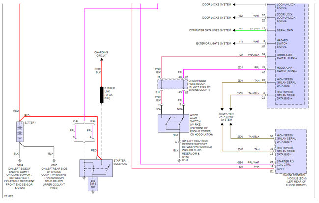

Thanks for the reply. Your experts have helped tremendously. I received 2 diagrams from Joe showing the wiring of the alternator to the starter. I cannot read either one (too small and blurry). They maybe what I need now or not. What I need is a sketch or guiding instruction as to how to trace the alternator wiring from the B post on the solenoid of the starter. Where does this wire go? How do I replace it? I tried to test for continuity between it and the terminal on the alternator (the one with the nut and washer and a wire) (not the one with the connector). I did not get any continuity.....
Feb 12, 2020 at 5:24 PM
  • 55,785 POSTS
Here is a guide to help you test the connection and the alternator and starter wiring diagrams:
Feb 13, 2020 at 2:02 AM
JIMB2020
  • 106 POSTS
To all of you (Ken, Alex, Joe and the rest of your experts).
I want to express my appreciation for your help. I was able to replace the fuse/relay junction block, learn all about the engine and body harnesses, replace the battery cable, remove clean and reinstall the starter, test and replace the alternator-generator and wiring and correct the connection of the starter ignition trigger switch. I also learned a great deal about the role of the BCM and ECM in the charging and starting-ignition phases. So, with your help i finally restored power to the system and the car is back to service. My sister is driving it to/from her office and is very happy with the results. You expressed interest to know what the problem(s) was/were. So, here are the results: 1. Relays- starter, run/crank relays weren't making reliable contacts inside the junction block. Starter j-fuse 26 was blowing repeatedly. J-fuse 21's blade was not getting power except intermittently. The block as a whole was compromised by previous testing. 2. The scanner initially was registering an f-generator code 0622 due to wiring disconnect: there was no continuity in the wire and no voltage. 3. The alternator was giving 11.38 volts only (but inconsistently since the battery wasn't losing charge). 4. The starter tested consistently good, but its trigger switch was registering 12.4 volts off and on. Finally, the car was starting every time after i reached the conclusion that this trigger switch-connector was being separated and the starter not getting the ignition switch starting command (the first hint came after i started the car and went for a test drive. When i turned off and on the ignition in the driveway, the car didn't restart. The starter switch-connector wiring came loose inside its housing due to vibration- broken clip... I did not think it would do that. Once i fixated the connector inside its switch , the car started every time (but not until today when i finished doing all i described above and went for a final test drive, the car did not want to restart after i shut the engine off . It was clear at that point that something was coming off during driving! I made sure it was not going to come off again and gave my sister the car this afternoon, and i am ready to go on restoring my 3.8 Grand Prix (everything- complete overhaul and lots of body work and paint) and a family Ford 1.3 b (this one has primitive relay box- which was melted like molten lava! I replaced it and its primitive harness altogether using the cut and splice method Joe talked about) has oil leaks, blown head or intake/exhaust manifold and requires major engine restoration work.

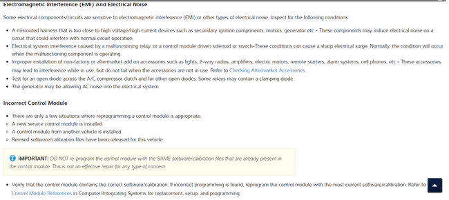

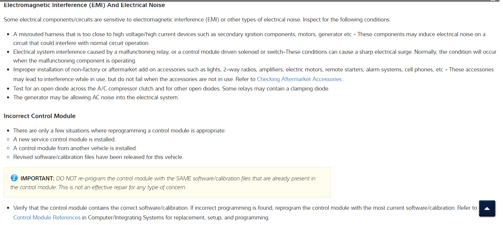

Ken and Joe, absolutely, I will be sure to recommend your experts to friends. I do have one last concern out of curiosity. When the trigger switch on the solenoid was being disconnected from its purple wire connector, what was causing the IPC (instrument panel) to flicker later after other lights were displayed one by one (the tire pressure followed by the traction control symbol followed by the ABS and then the Theft Deterrent Symbol) almost always in that order? When the car is shut off, the trigger switch reconnected, and the car restarted, everything is back to normal. I just need to understand this part (the IPC part/how it relates to the trigger switch being disconnected while the car is in motion and the switch isn't being triggered-its circuit is open- right?) And could this disconnect have caused damage to the alternator or other parts or components? I know the circuitry involves the switch, solenoid, the ECM, the BCM, the battery, the F and L connectors of the generator on the alternator and the instrument panel, fuses/relays, but while the vehicle already in motion? Thanks again.
Feb 18, 2020 at 9:48 AM
  • 55,785 POSTS
When an IC starts to go bad when you remove power it resets it kind of like a PC reboot but shorter. Then it heats up and fails again.

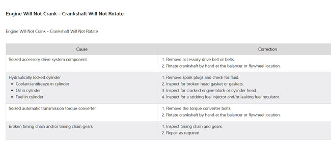

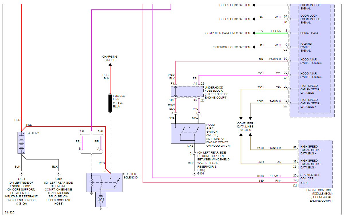

I replaced the crankshaft position sensor. I replaced the starter. It still only makes a single "click" noise when I go to turn the key over. What could be the issue? Maybe the camshaft sensor needs replaced as well as the crankshaft position sensor?? Please help.
Jan 4, 2021 at 12:49 AM (Merged)

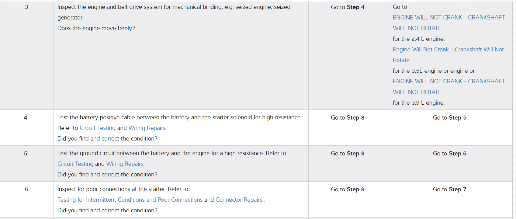

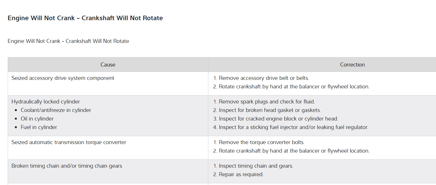

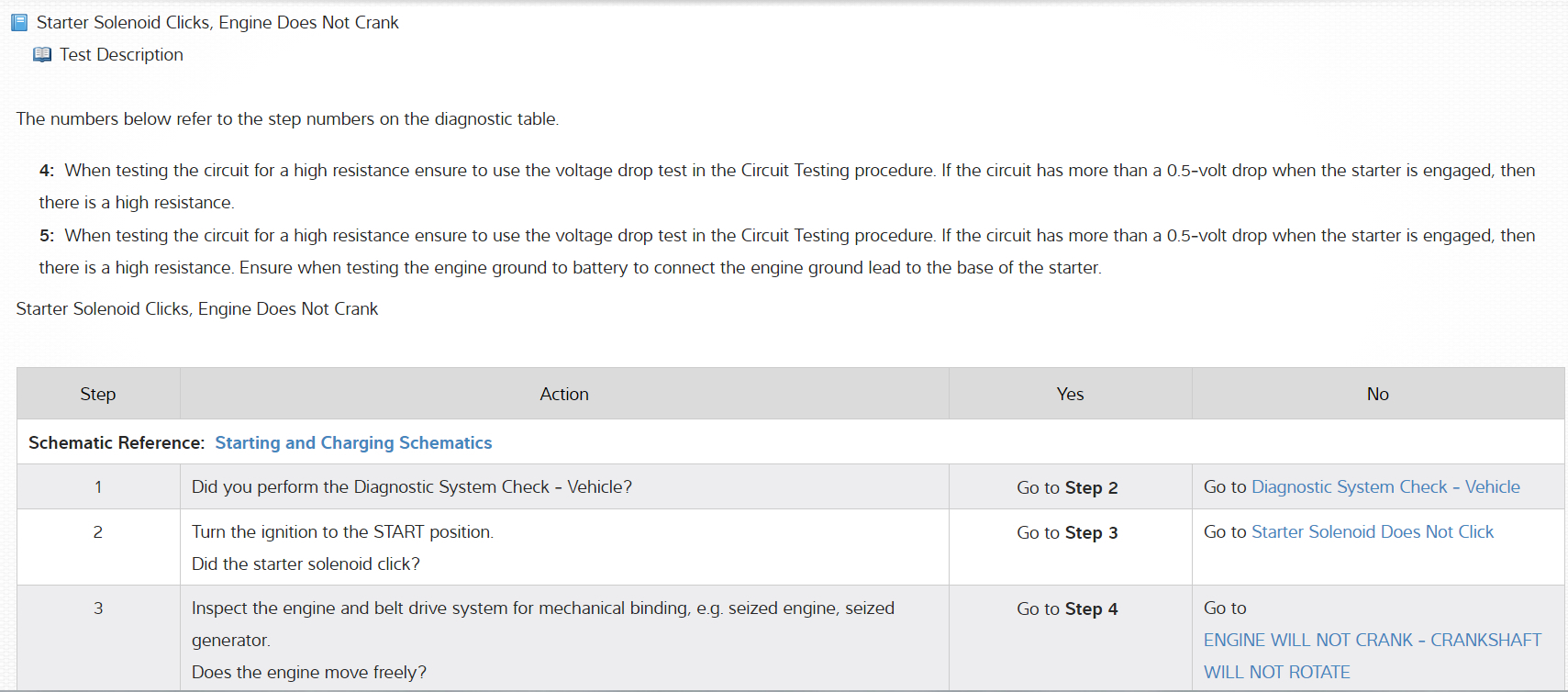

SCGRANTURISMO
  • 4,897 POSTS

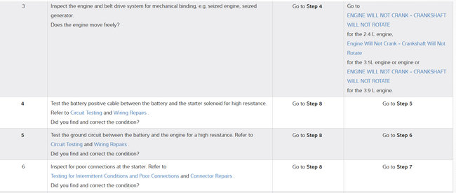

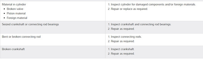

This could be a problem with the starter relay. In the diagrams down below I have included a comprehensive factory troubleshooting flowchart for your vehicle's condition. Please go through it and get back to us with what you find out.

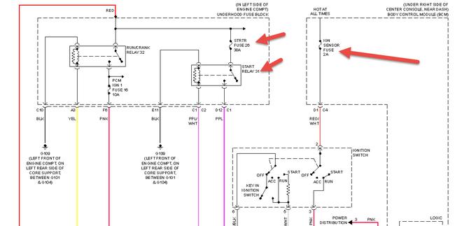

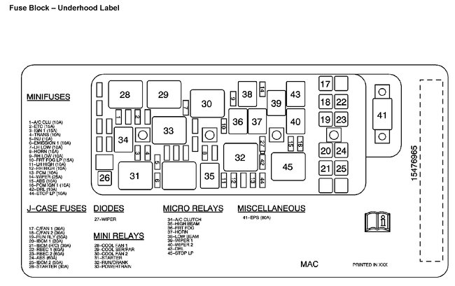

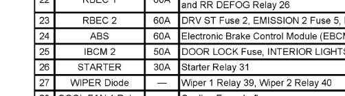

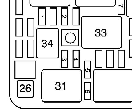

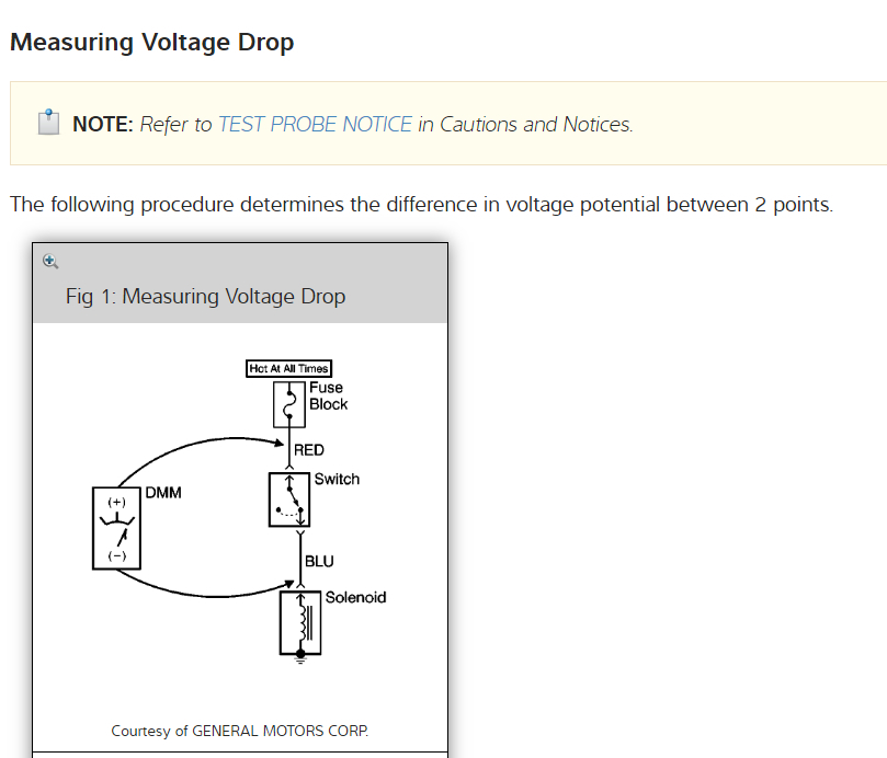

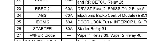

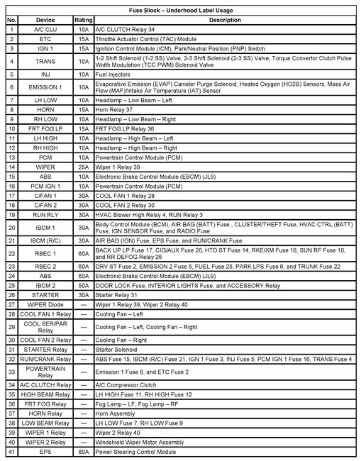

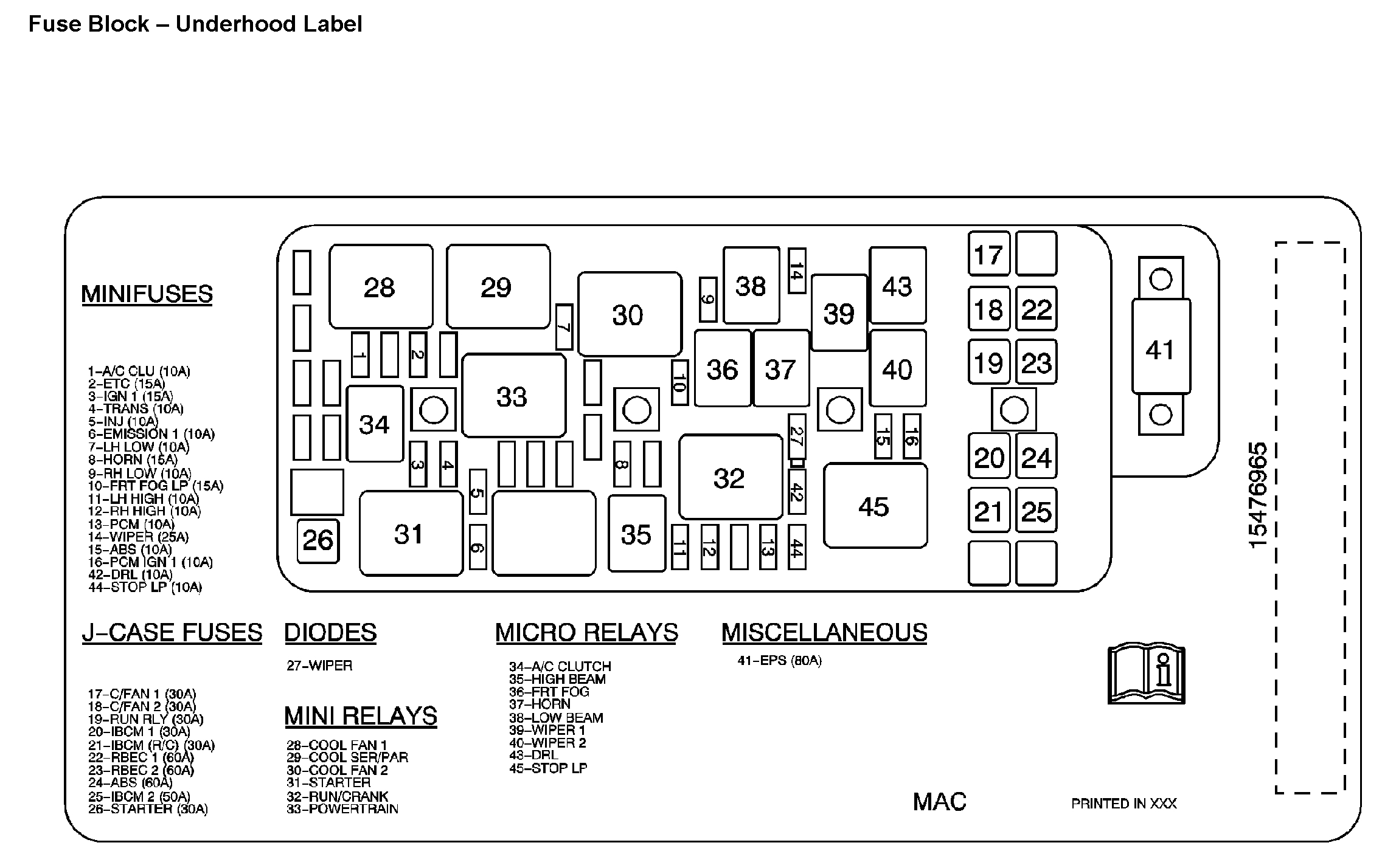

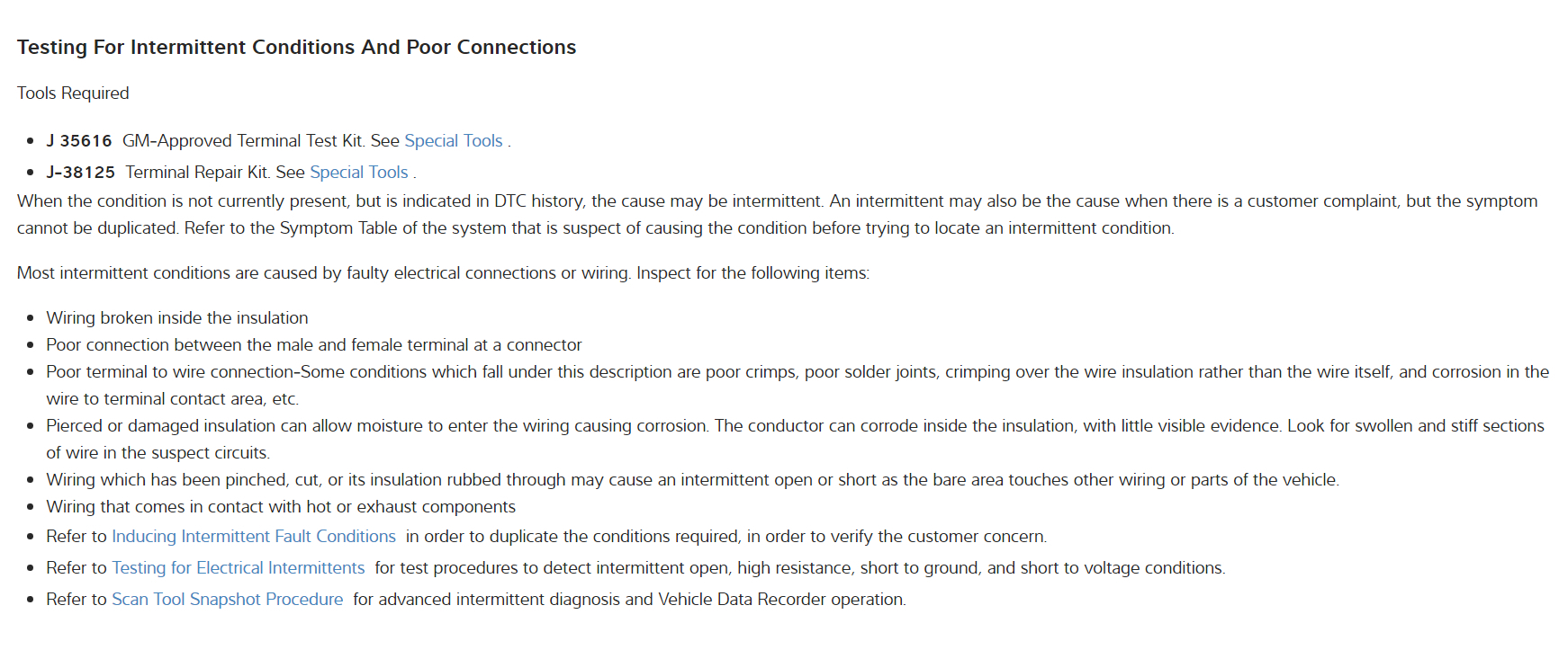

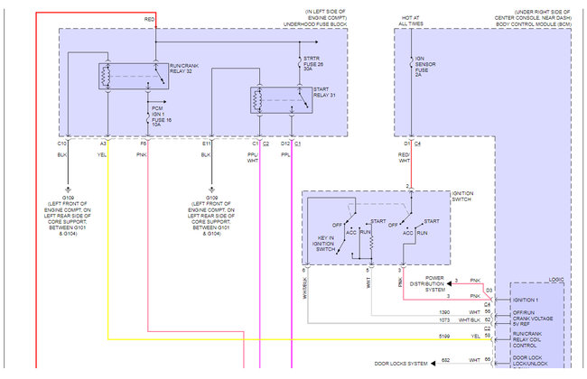

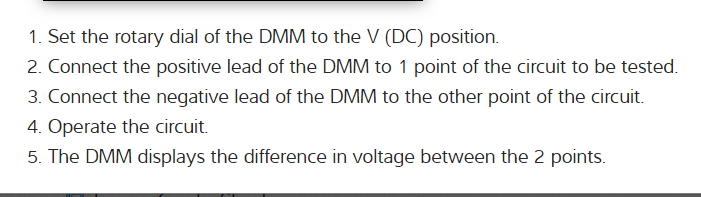

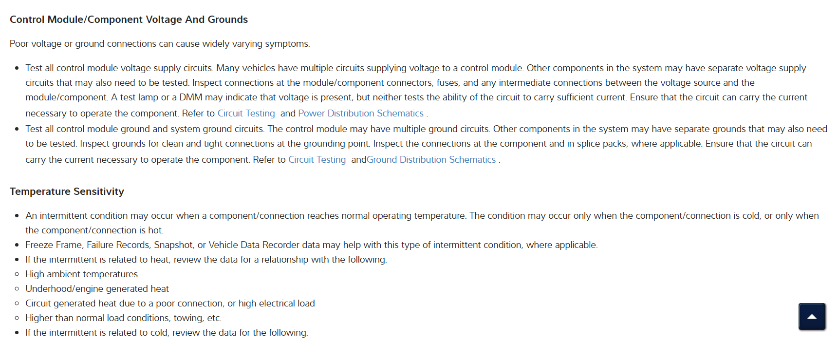

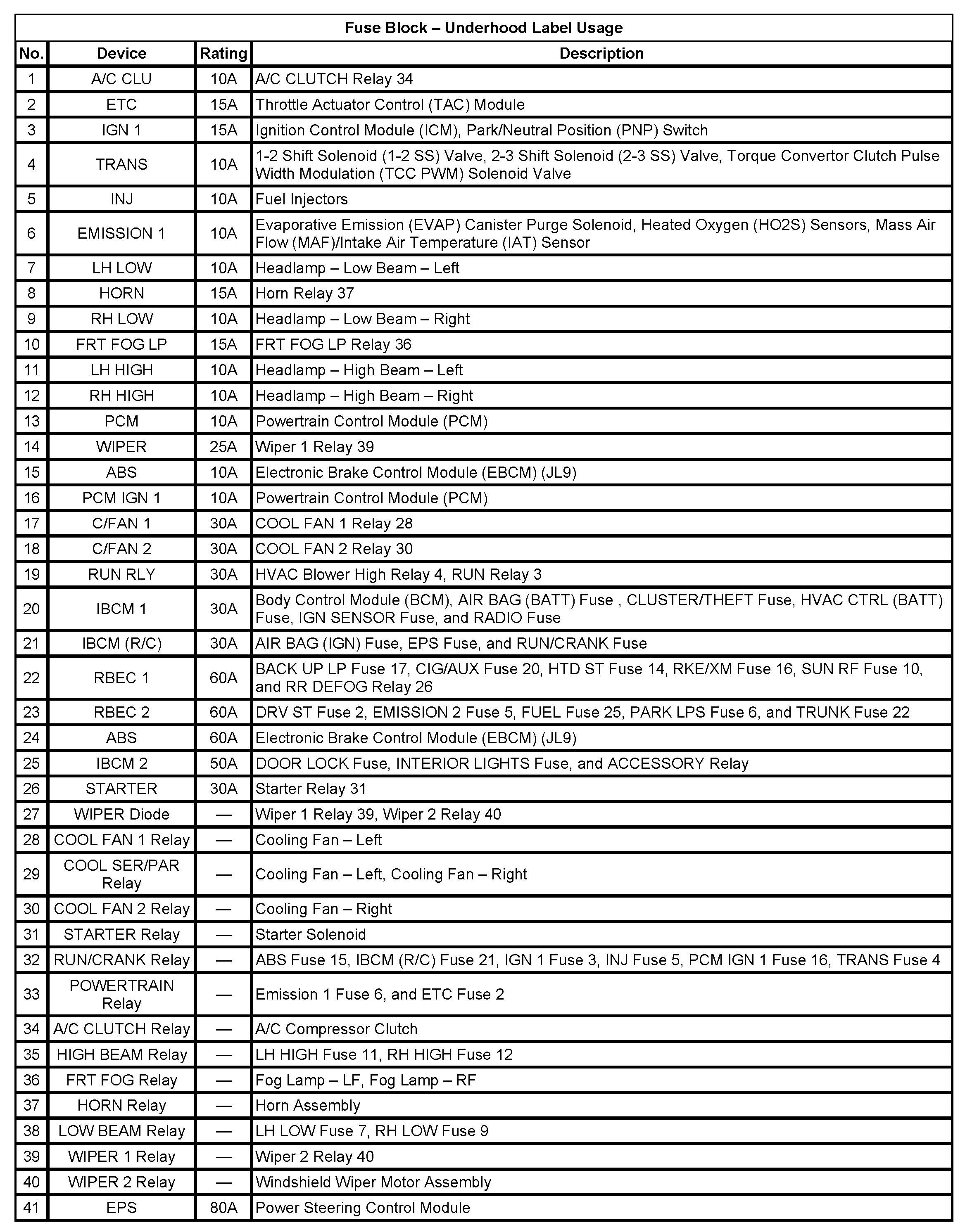

  • 110,251 POSTS

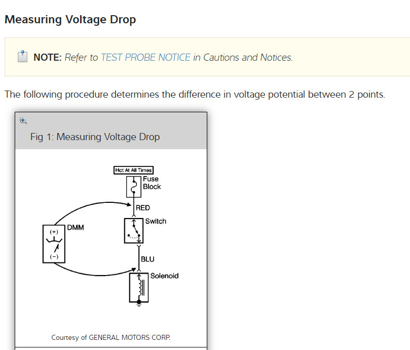

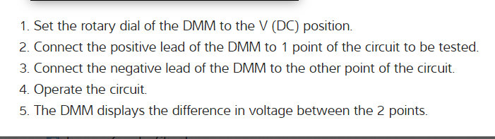

The crankshaft or camshaft sensors will not affect the starter. Either you have a bad connection at the battery, the starter relay is bad, the new starter is also bad, or you have a weak battery. To help diagnose the possible problem, I need you to follow these links in the order I attached them. Do this and let me know the results.

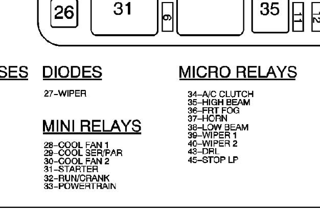

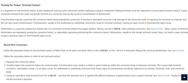

Next, I need you to check the starter relay. It is located in the under hood fuse box. It is relay 31. I attached pictures to help you locate it. At this point, you have two choices. First, switch the relay with a different one from the relay box that has the same part number and see if it makes a difference. Or, you can actually test the relay itself. Also, check to make sure fuse 26 which is right next to the relay is good. See picture 5. It supplies power to the relay.
If that is good, then you need to test the starter for proper power. Here is a link that shows how that is done. You will need a helper to do this.
Here are a few links that may help you with testing:
This seems like a lot, but most of it will only take a few minutes. I have to be honest, my first suspect is a weak battery or dirty connection at the battery, so pay attention to the first two links I attached.

HMAC300
  • 48,601 POSTS
is this a g6 or g8? G6 doesn't have a 5.3 init. pic i'm sending is for a 3.9L check the items in pic there is also a fusible link off of starter but that is for alternator
