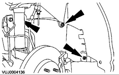

Remove the right-hand front road wheel.
Remove the wheel arch liner access cover.

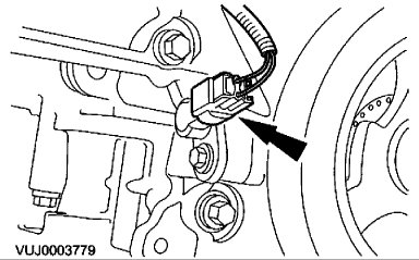

Disconnect the CKP sensor electrical connector.

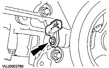

Remove the CKP sensor.
Remove and discard the O-ring seal.
Installation
NOTE: Install a new O-ring seal.
To install, reverse the removal procedure.
Tighten to 10 Nm.
