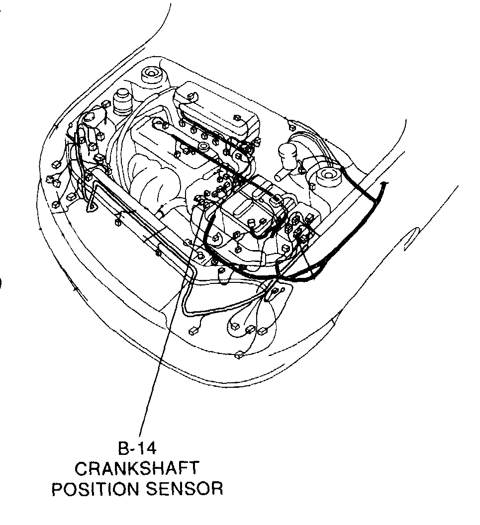

My car starts first time but when put in first gear it misfire and same in second gear . When change to third fourth not too, bad but when climbing up hill I lose power. press acceleration but nothing struggling to climb. I have change the coil pack and fuel filter and the other filter but still the same . Been on the computer and sensor computer nothing came up. All the wires look fine. We don’t know where to turn next. Can you help me? Thank you

A few different things can cause this. Components such as a plugged catalytic converter, bad crankshaft position sensor, low fuel pressure, and so on can all have an affect on performance.
Here is what I suggest: Lets start with the basics. Make sure fuel pressure is within the manufacturer's specs.
Here are the manufacturer's specs for pressure:
Fuel Line Pressure .................... 46-51 psi (320-350 kPa)
___________________________________________-
Also, a bad crankshaft position sensor can cause a misfire.
https://www.2carpros.com/articles/how-a-crank-shaft-angle-sensor-works
Picture 1 shows the location of the sensor.
