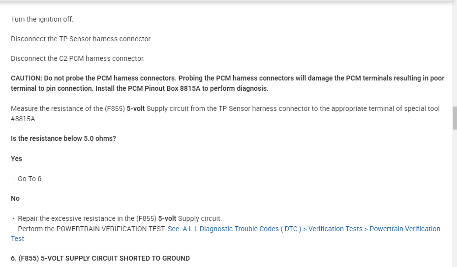

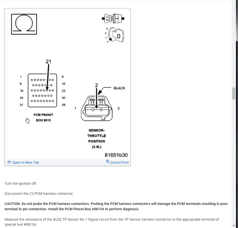

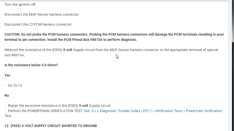

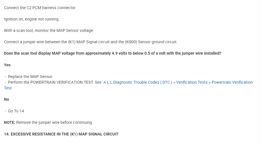

Car throws p2074 code
2007 CHRYSLER PT CRUISER
104,182 MILES • 2.4L • 4 CYL • TURBO • 2WD • AUTOMATIC
EDWARDSVILLE13

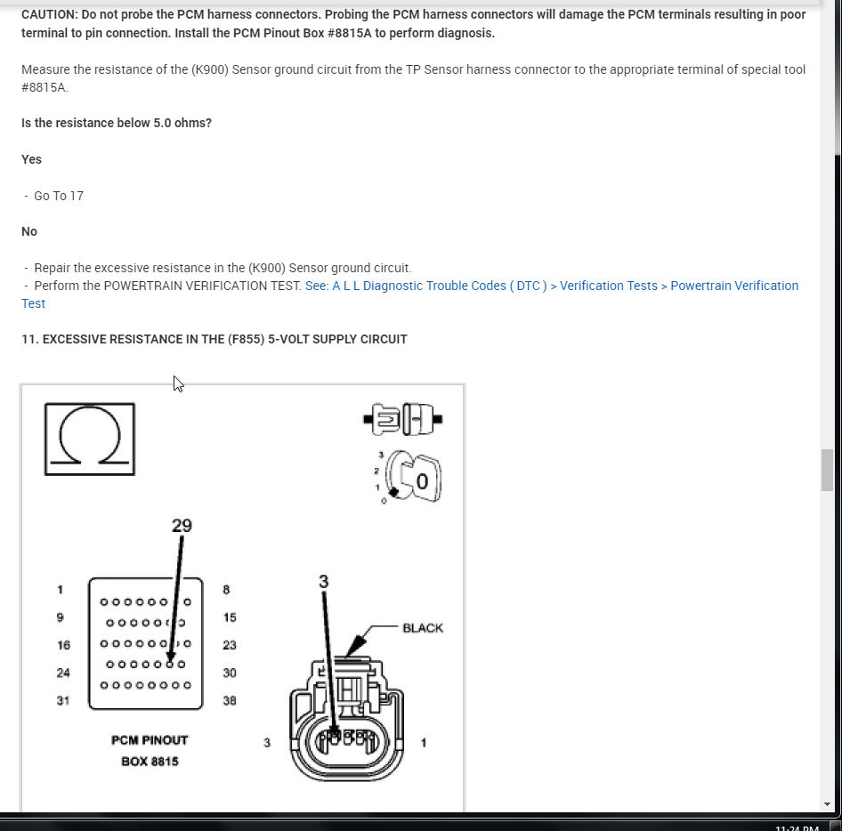

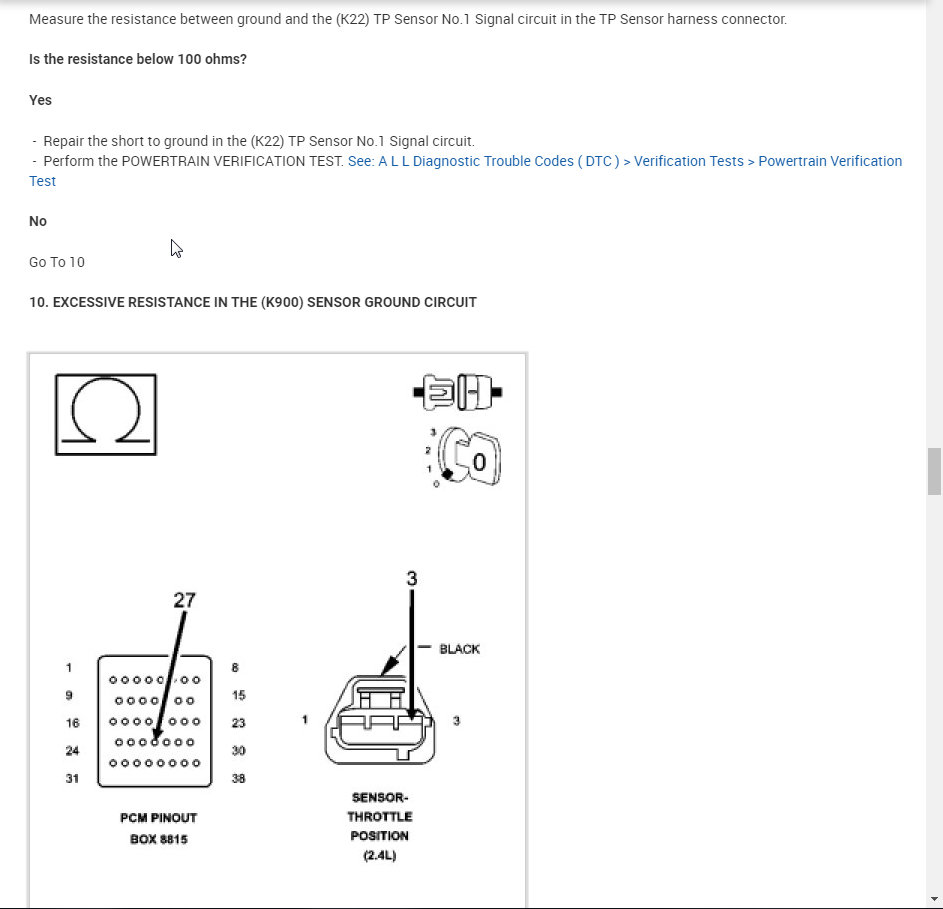

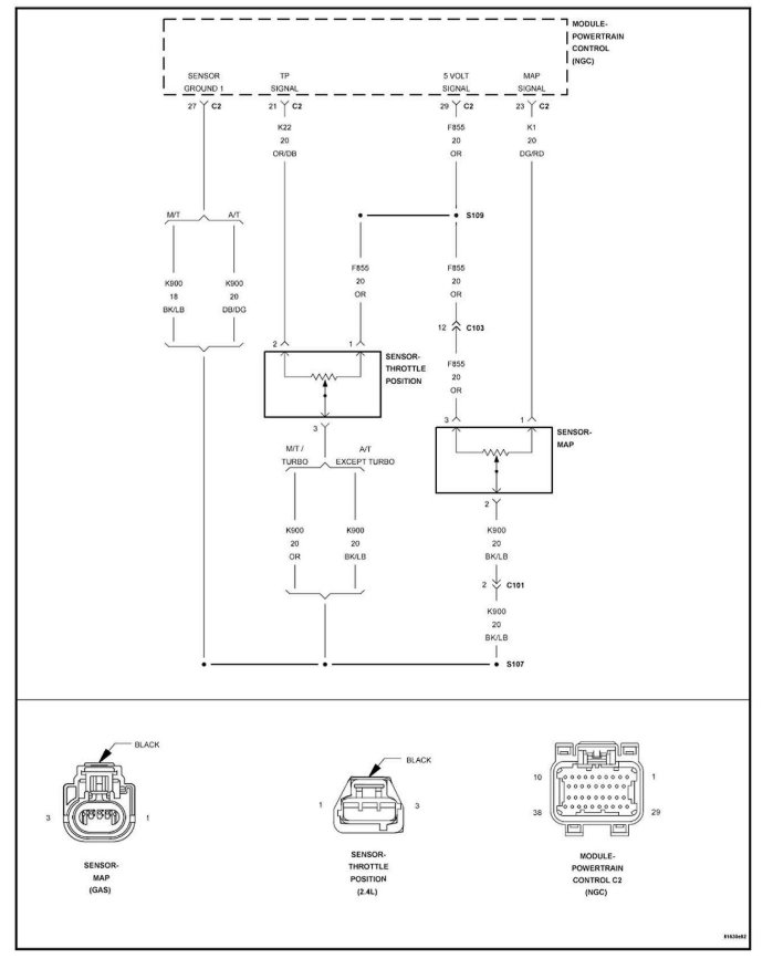

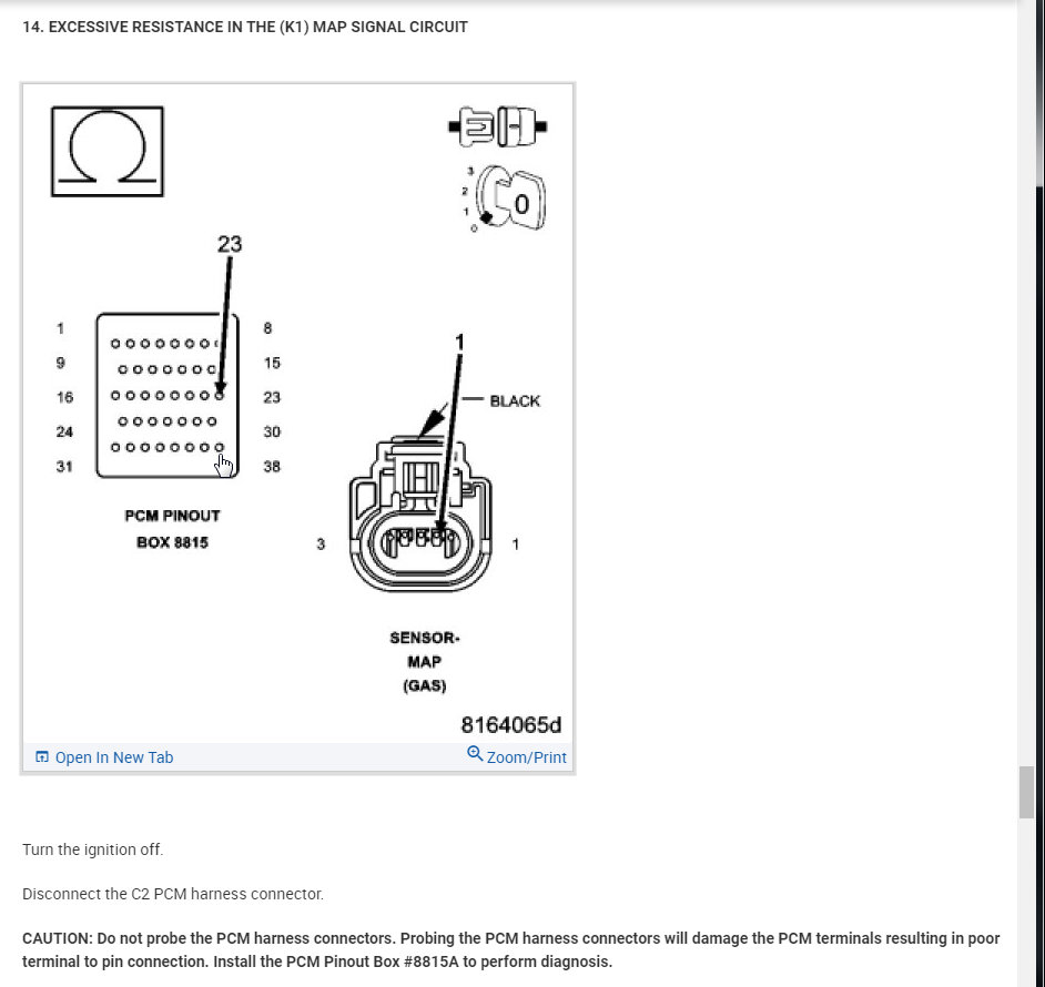

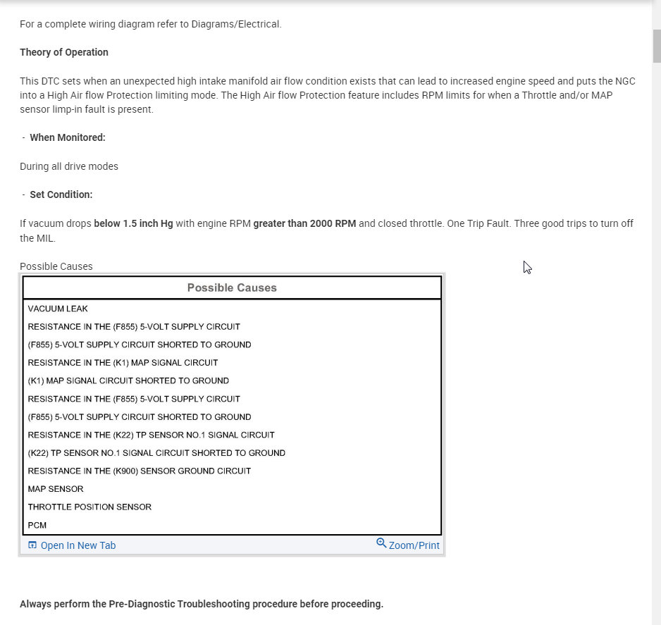

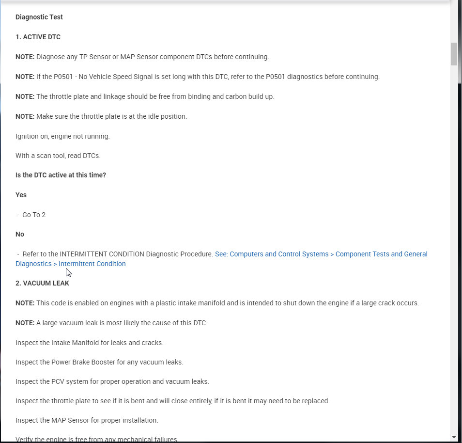

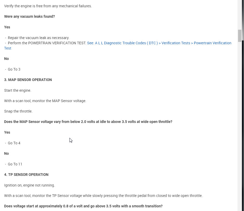

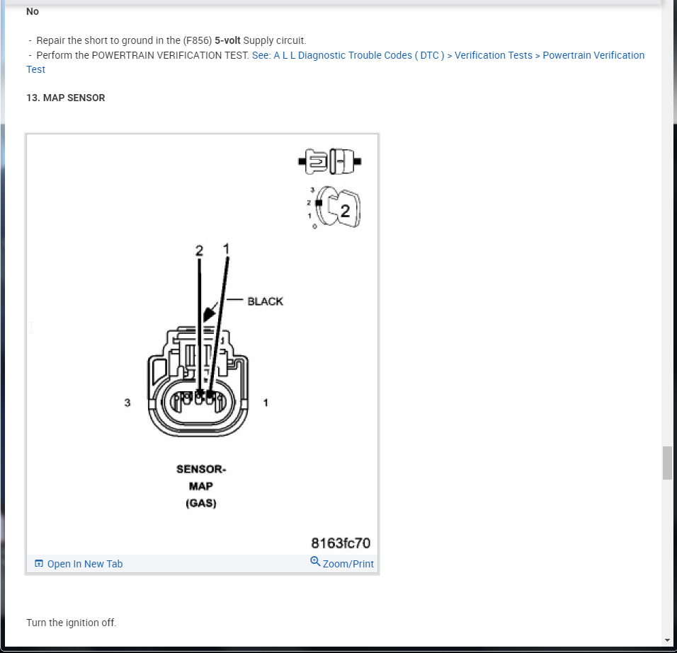

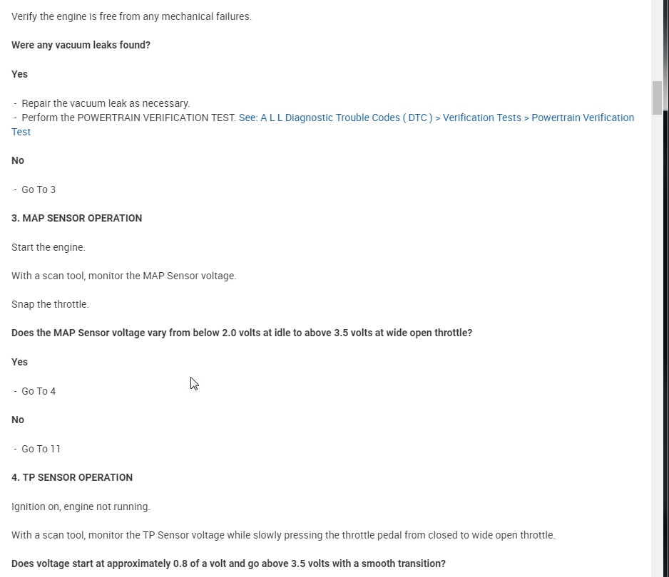

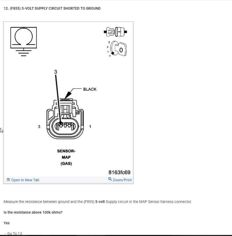

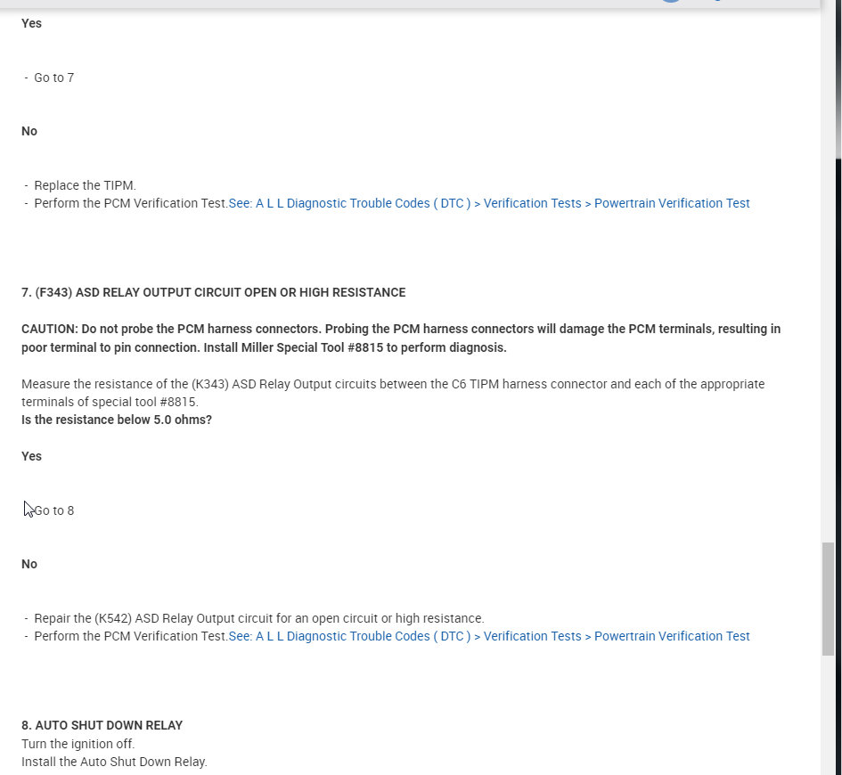

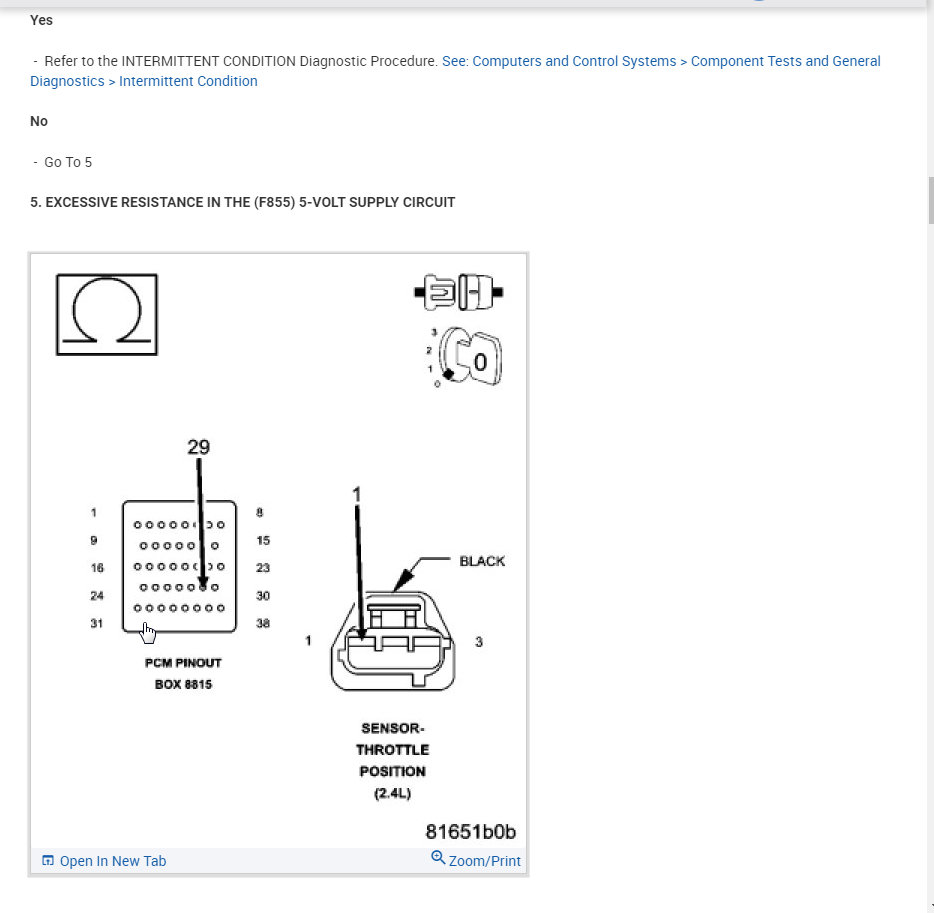

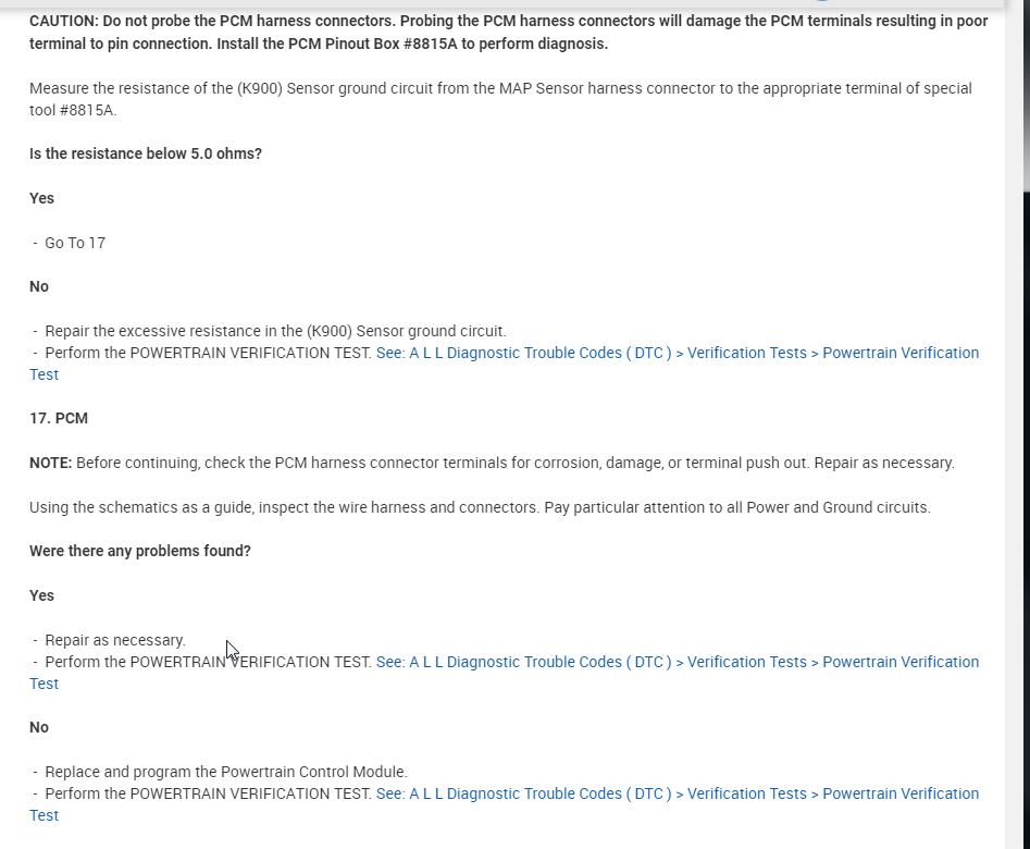

When driven above 3,000 rpm's for a little while the dings and goes into limp mode where shifting is changed and car won't go over 4k rpm's.
Nov 19, 2019 at 2:53 PM

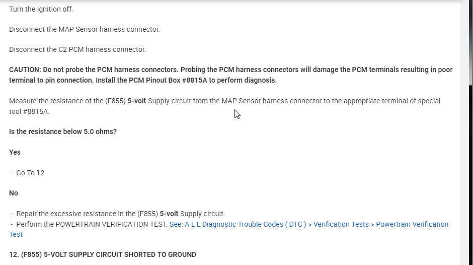

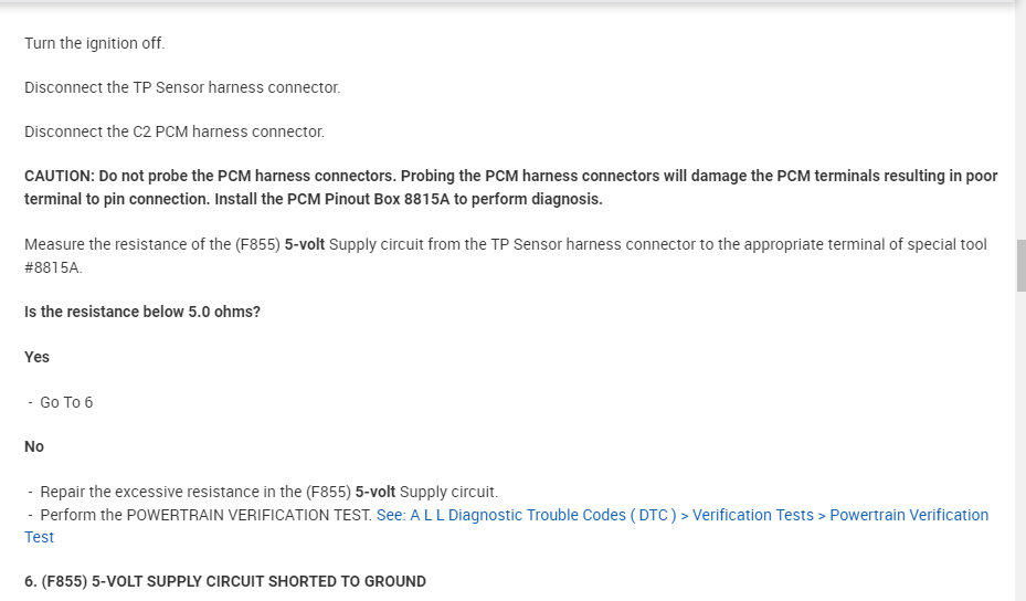

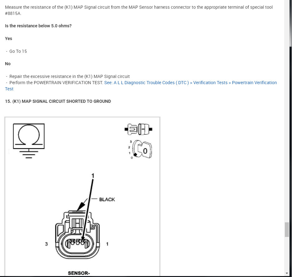

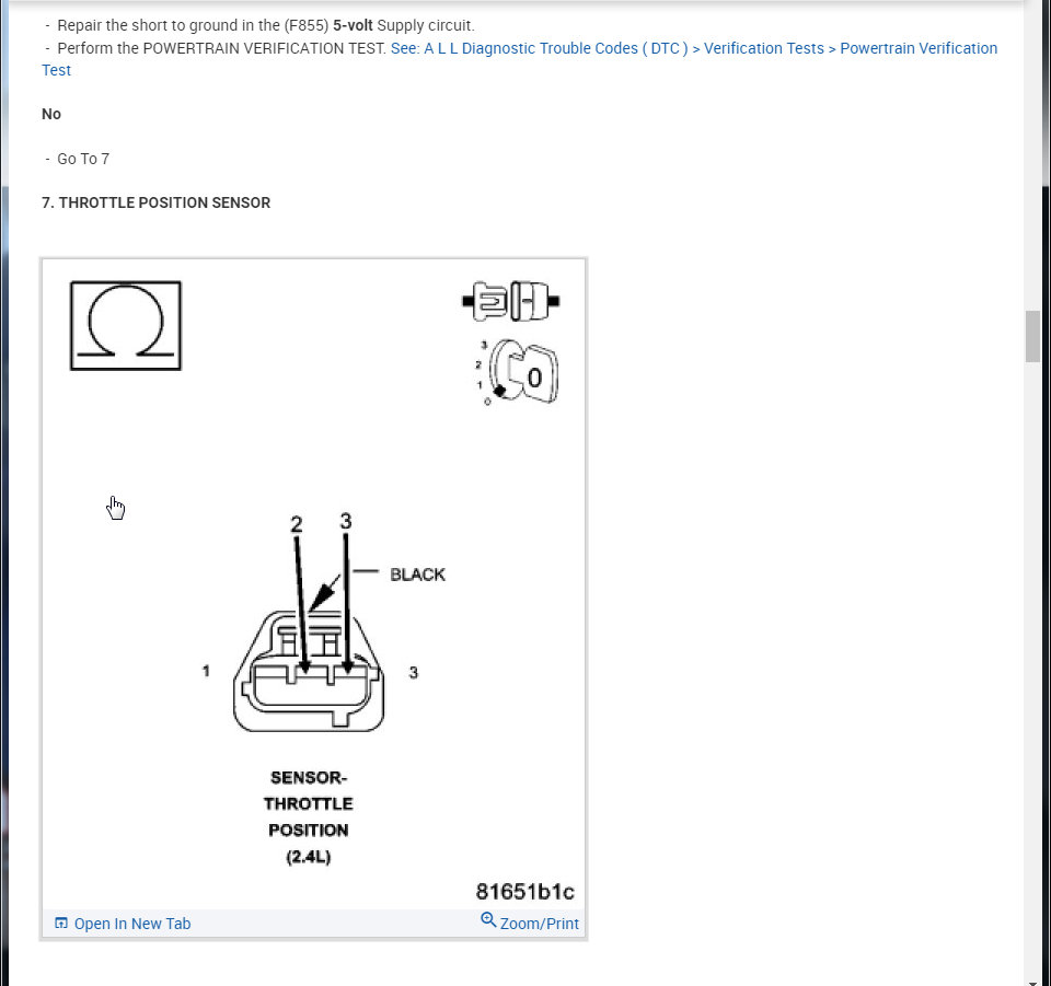

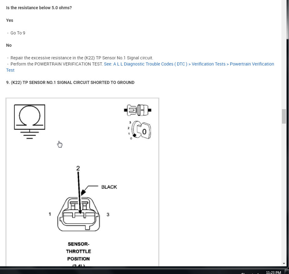

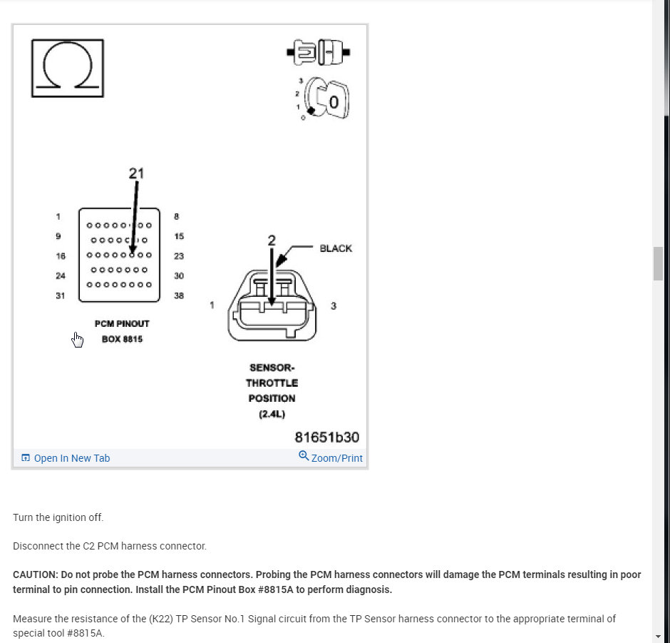

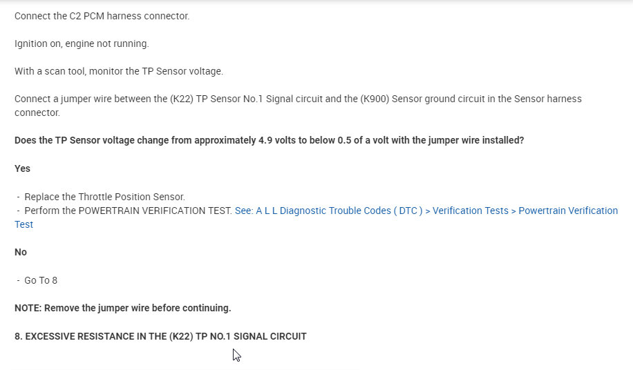

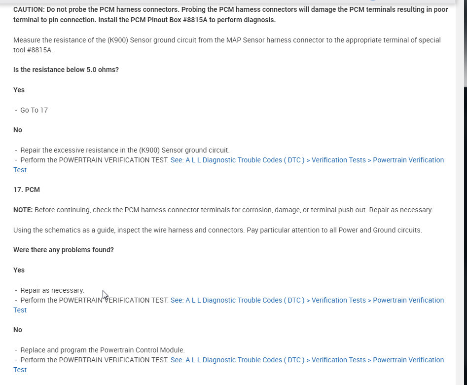

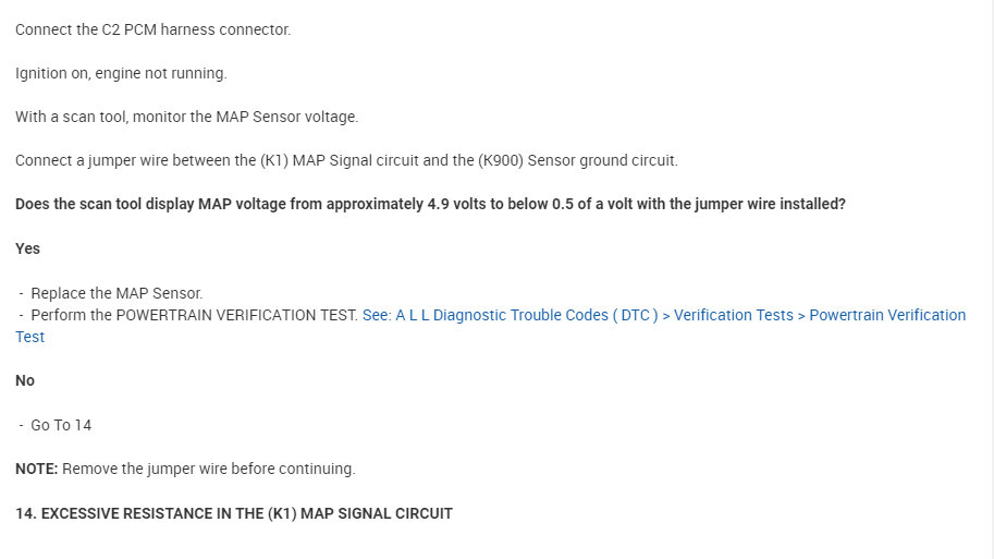

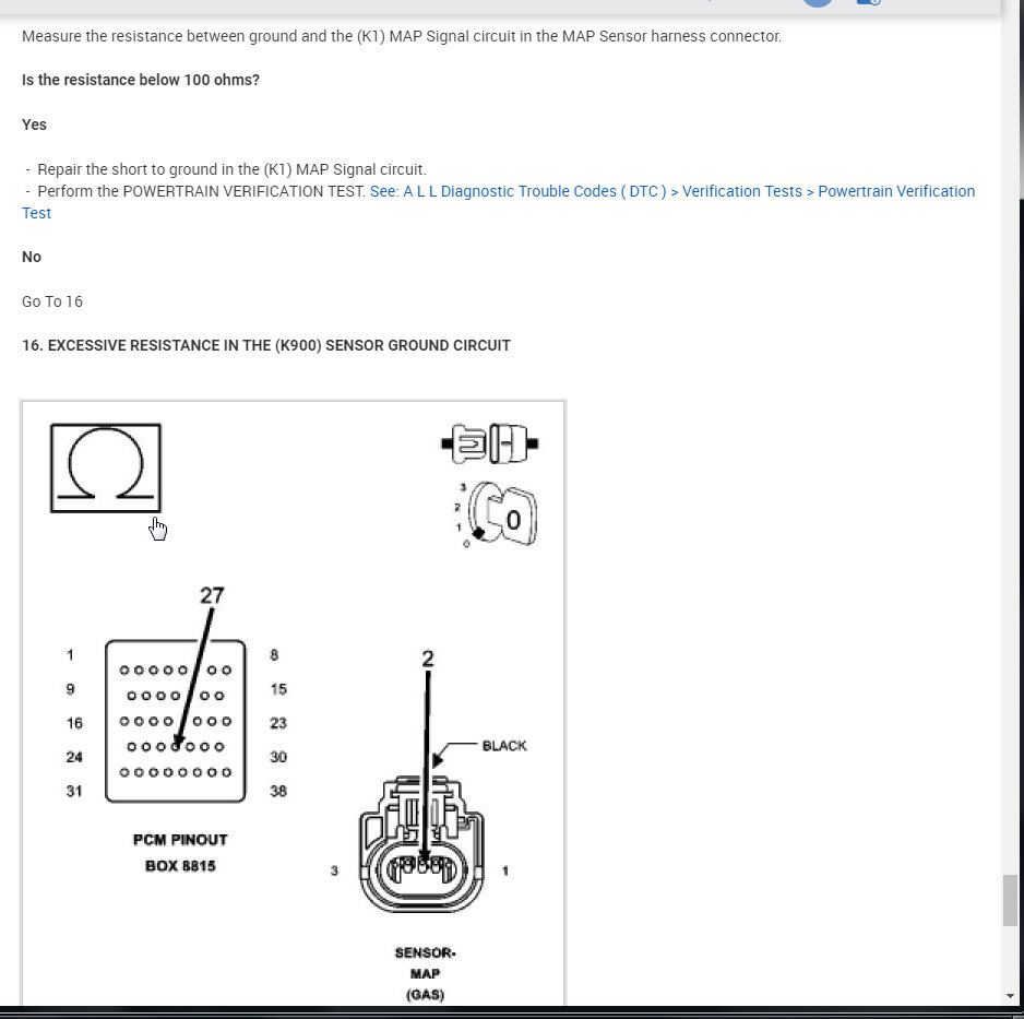

I attached the testing for this code. It is lengthy because this could be a number of things so the only way to figure this out is to run through this test and find out what the issue is. Unfortunately, this is not one of those issues that is only caused by one thing.
Let me know if you have questions and we can go from there. Thanks
