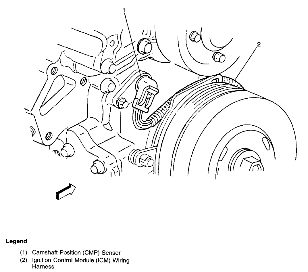

So this problem just started after we basically combined two of the same cars into one, lol. No problems upon starting and runs fine right off the get go but after it is nice and warmed up and cruising along, it will randomly start surging and decelerating slowly to the point of only allowing you to drive around thirty to forty mph's and still with the occasional surge. we discovered that while It is doing this if we shift it into neutral and shut off the engine (while still driving) and then start it again quickly, the problem stops and u are able to accelerate to normal speed with no problem. It sometimes does it repeatedly and sometimes can run for hours without doing It all. We checked all the normal things that would cause this, fuel system is fine, catalytic converter is okay, vacuum lines are fine etc., all we can think is maybe it is the ECM causing it. Any help?

Yes exactly identical. And what does closed loop mean? The check engine light is on and we put it on the code reader and it is throwing these three codes n/a p0341. P0135p

When the car is first started the computer only uses a couple of the sensors to actually run the engine (open loop). Once it has run long enough that the oxygen sensors and converter are active the computer switches to using feedback from all of the various sensors to operate the engine (closed loop).
P0341 - Camshaft Position Sensor Circuit Range/Performance.
P0135 - Oxygen O2 Sensor Heater Circuit Malfunction (Bank 1, Sensor 1).
Both are circuit codes, which could mean a failed part but most of the time it turns out to actually be a bad wire or connection causing the problem. In your case the cam sensor code would be the one causing the surge. The fact that you can shut it off and on restart says the sensor works but it's having a problem.
I would start at the sensor connector and follow the harness, look for pinched or damaged wires.
