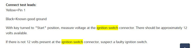

SCGRANTURISMO
  • 4,897 POSTS

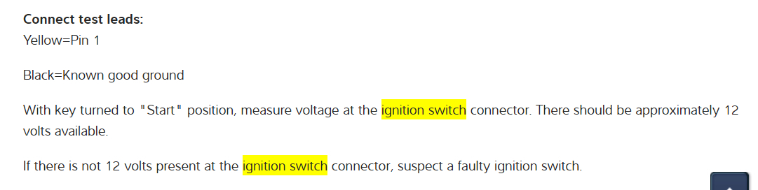

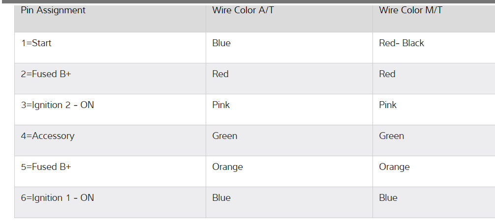

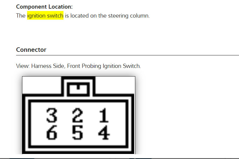

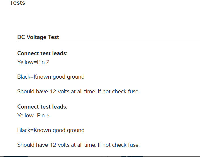

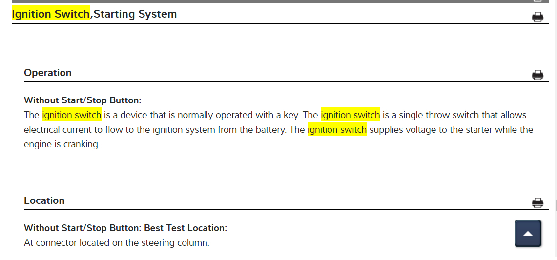

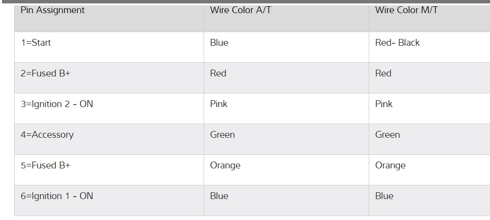

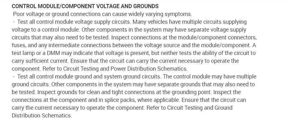

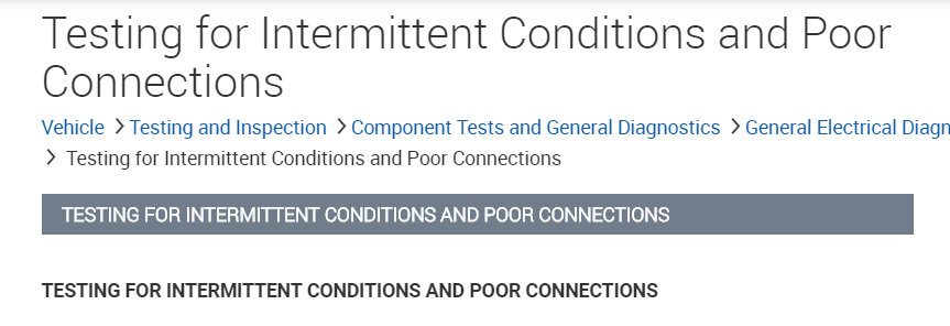

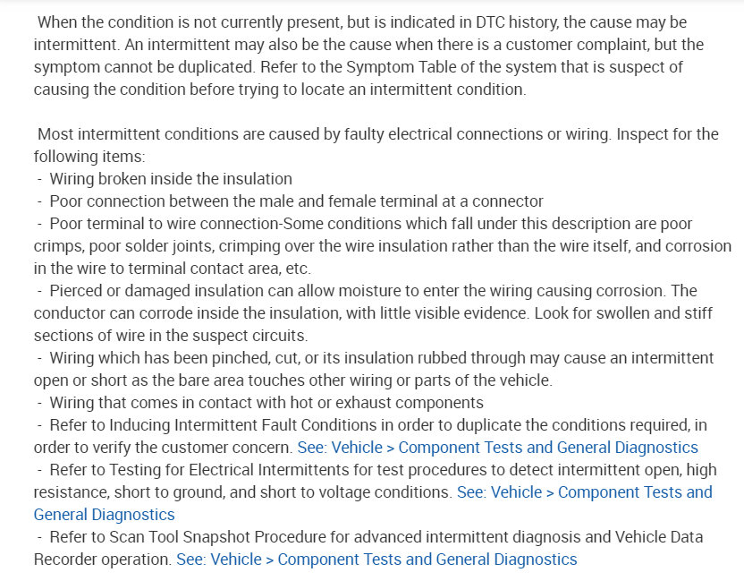

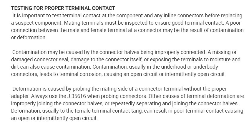

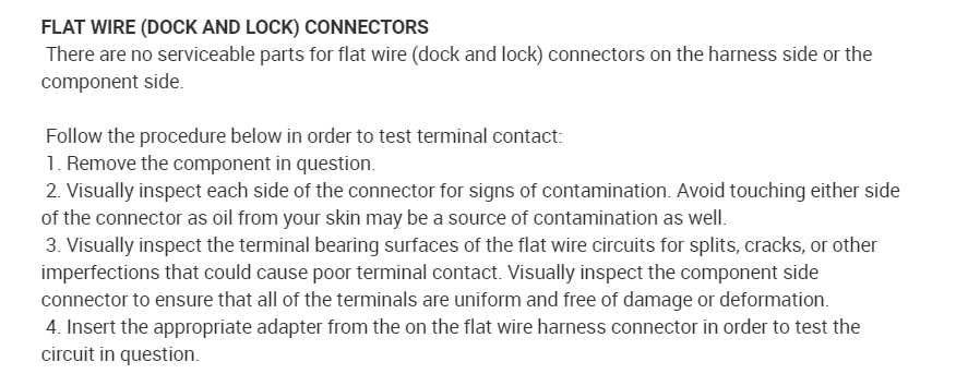

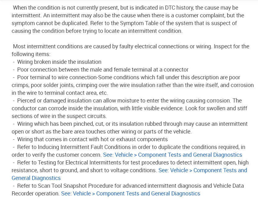

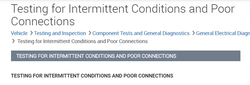

This could be a problem with a loose or corroded electrical connector on the ignition switch. In the diagrams down below I have included the guide on how to check the ignition switch in your vehicle from the vehicle manufacturer. I have also included a guide on how to track down intermittent and loose electrical connectors in a vehicle for you as well. Please go through these guides and get back to us with what you are able to find out.

PETAR LJ
  • 32 POSTS
Thank you for your answer. I checked out the ignition switch wiring all good and no loose plugs and wires. so in back to square one. would there be a problem with the ECU relay? I have checked most of the wiring and plugs under the bonnet this one has me stumped. it just started out of the blue. any other ideas? thank you again

Okay, this sounds like a loose connection at the battery to me. Can you please verify that the connections at the battery terminals are clean and tight. Also could you follow the wires coming from the negative battery terminal and inspect the grounds to make sure that they are clean, tight, corrosion free, and making good metal to metal contact as well. Please get back to us with what you find out.

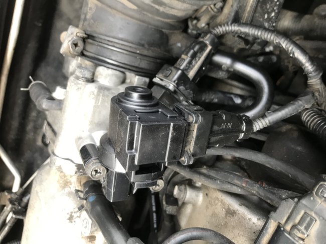

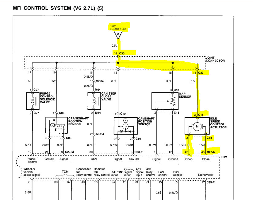

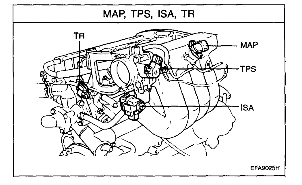

Hello again Alex, I have cleaned the battery terminals and pulled out the battery and cleaned the earth strap all clean there was no corrosion on the terminals. I started the car with in minutes the rpm jumped up to 3000 and racing. I disconnected the idle solenoid the revs dropped back to normal. when I plugged the sensor back in it was racing again. I did fit a new idle sensor
with the motor racing if you rev the motor it hesitated due to the idle sensor, before the motor cuts out driving I noticed most times the rpm was up around 3,000 then it starts mucking up and stopping. it has got a mind of its own. what now? thank you again for all your help.
Oct 12, 2019 at 2:56 PM

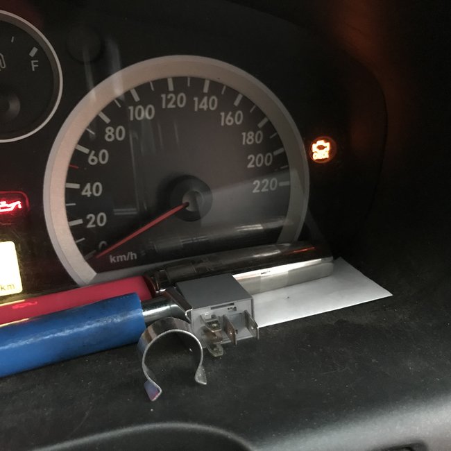

PETAR LJ
  • 32 POSTS
Sending you a photo of the sensor I replaced last week. thank you again.

Hi there Alex , I have just checked my car to work again , when I started it the idle was very high , I pulled the plug on the idle air control valve and the idle went back to normal, something is telling the idle control air valve to open up more than normal and you can really hear the air rushing into the inlet manifold then it goes back to normal idle when it feels like it , and at no time has the engine warning light come on , hope this helps you , thank you again

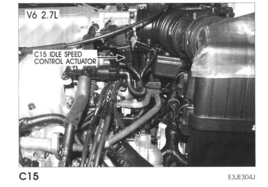

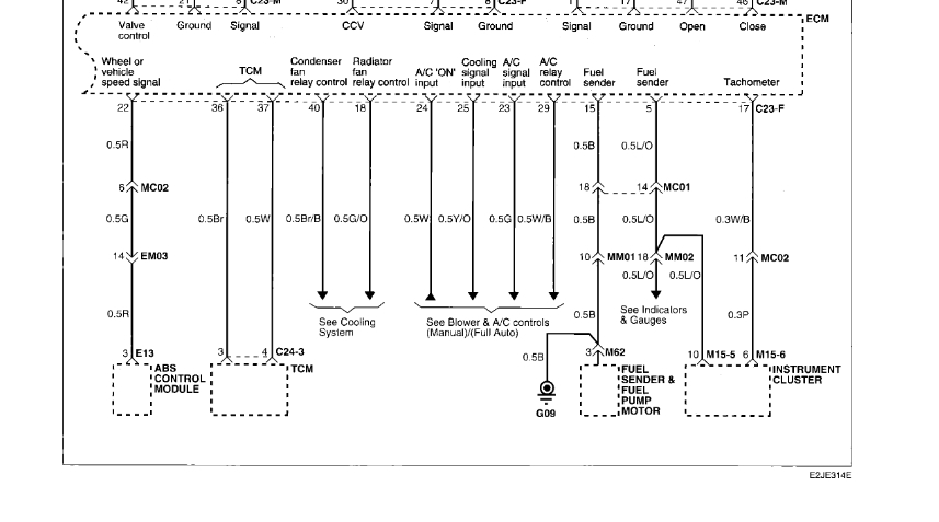

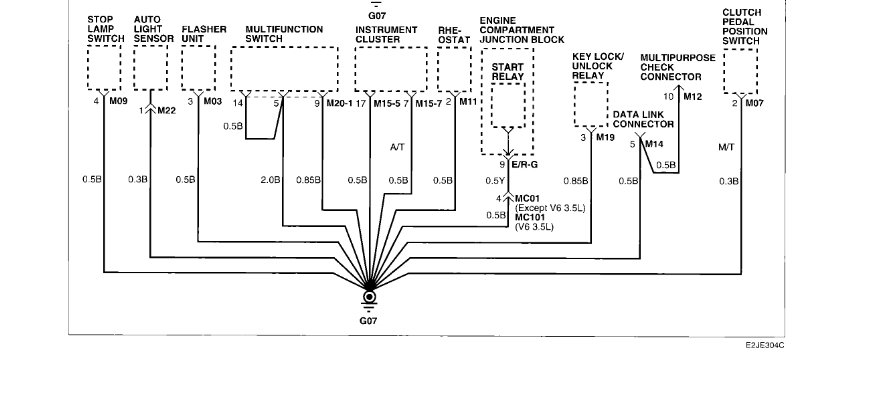

Okay, so the MIL proves out at bulb check. That's good, there are no DTC's set. This might be a problem with the electrical connectors that go to the Idle Speed Control Actuator[ISC]. In the diagrams down below i have included a diagram of the ISC, ISC connector, and a wiring diagram of your vehicle's ISC circuit[highlighted]. I have also included a guide for poor electrical connectors as well. Please go through these guides and check the electrical connectors going to the ISC and the associated wiring and get back to us with what you find out.

Yes it could. I was taught in tech school by Honda that 75% of all electrical problems are bad grounds. For some reason every one concentrates on the power side of an electrical circuit and forget about the other half, the ground side. Please keep us informed and good job.

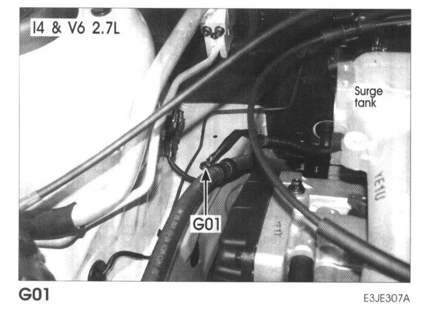

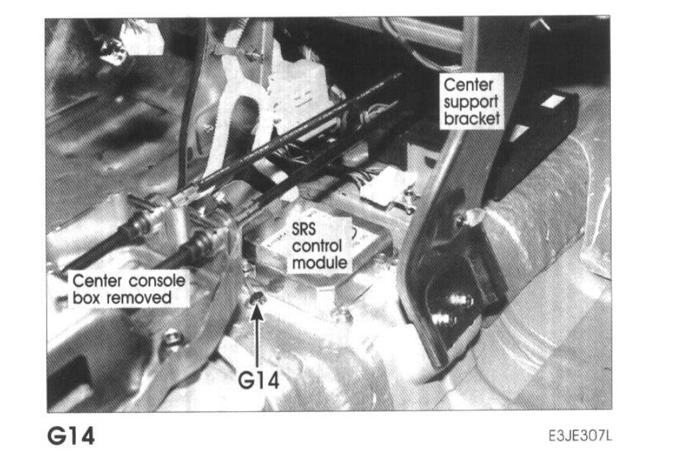

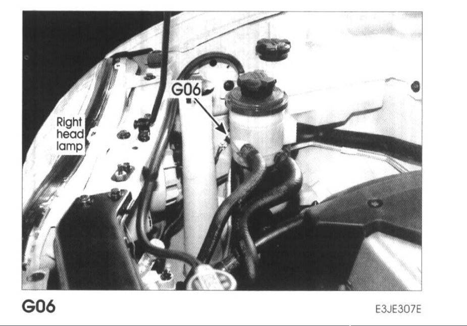

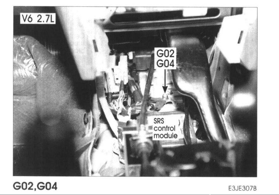

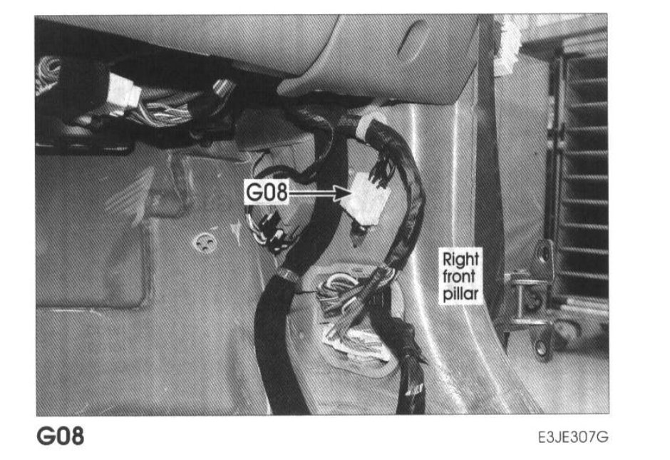

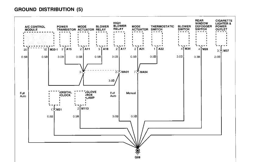

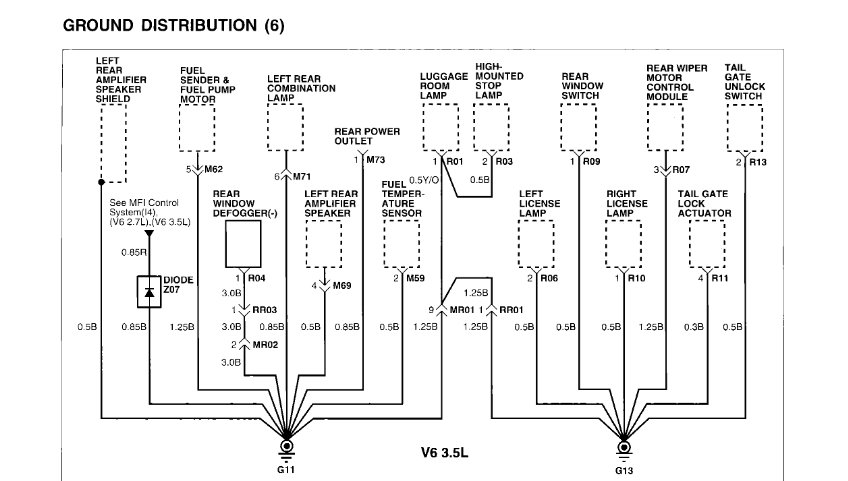

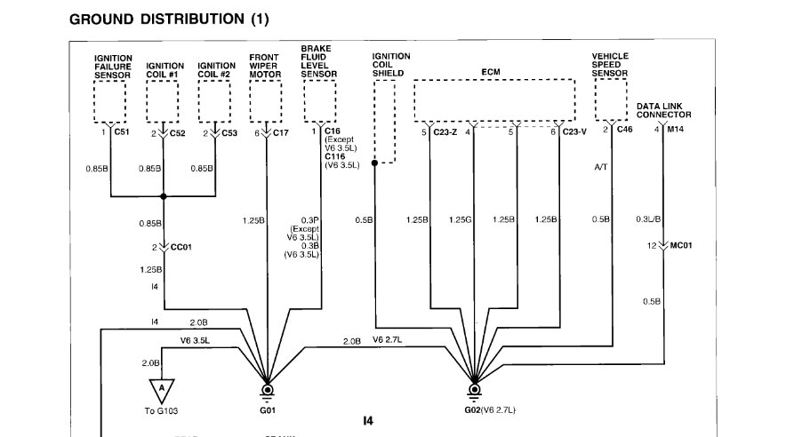

PETAR LJ
  • 32 POSTS

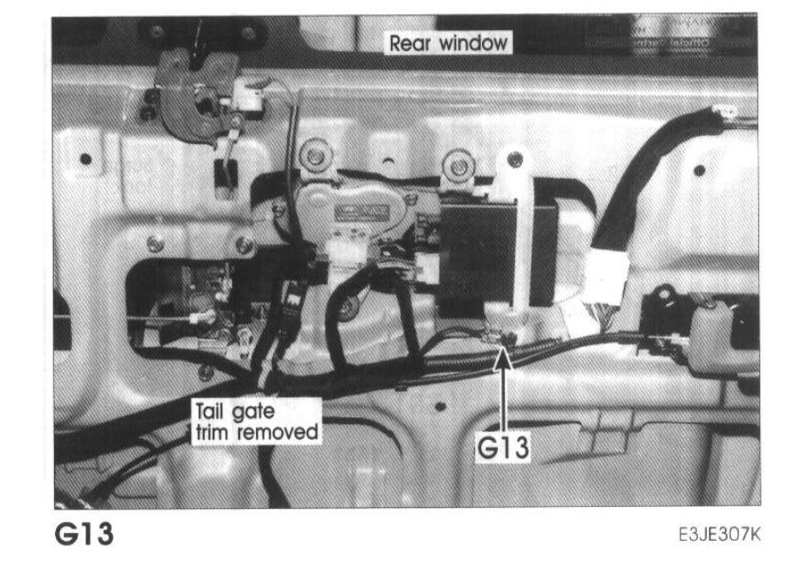

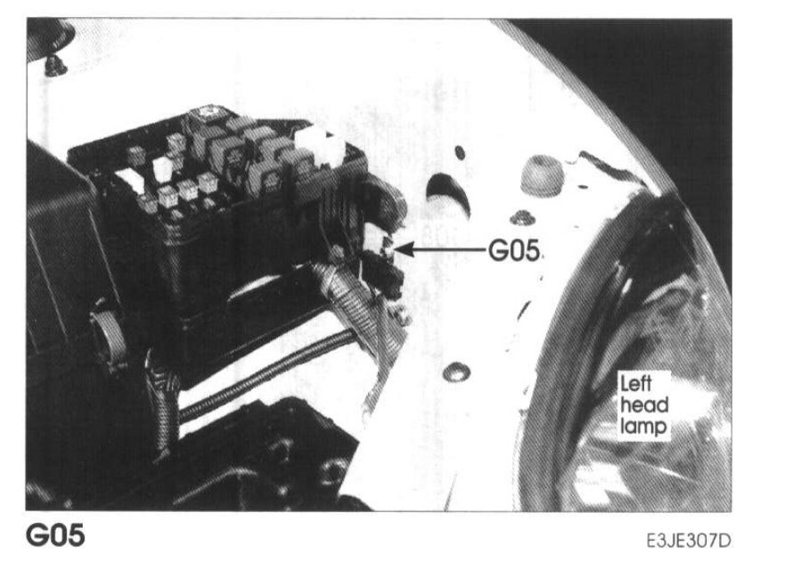

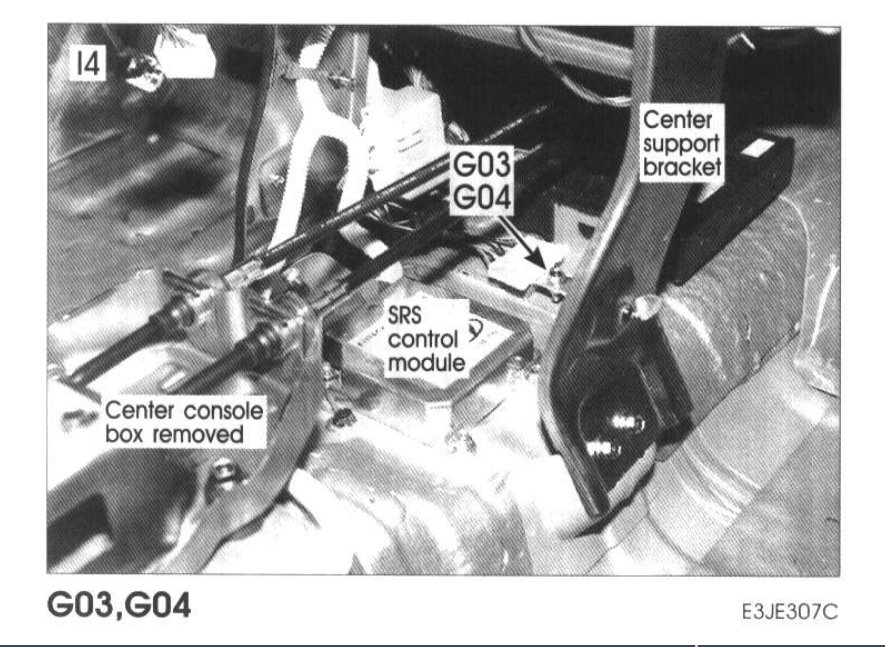

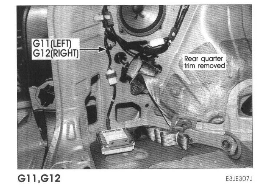

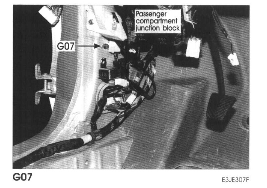

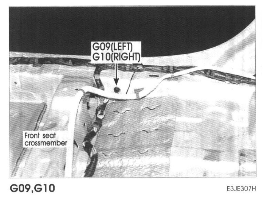

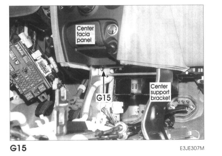

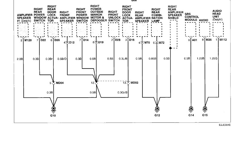

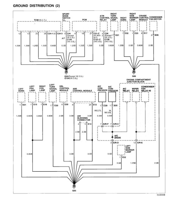

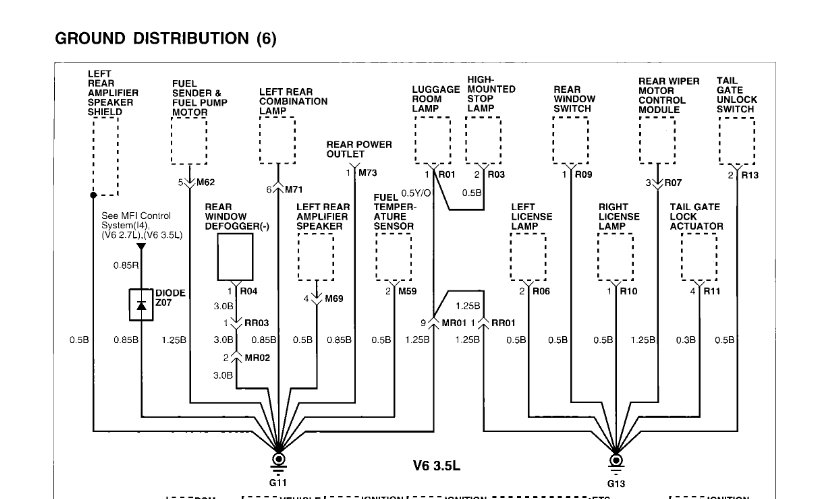

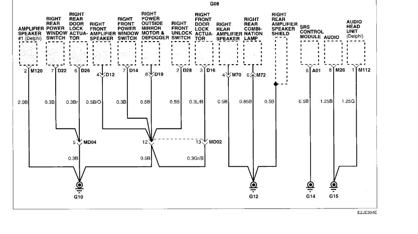

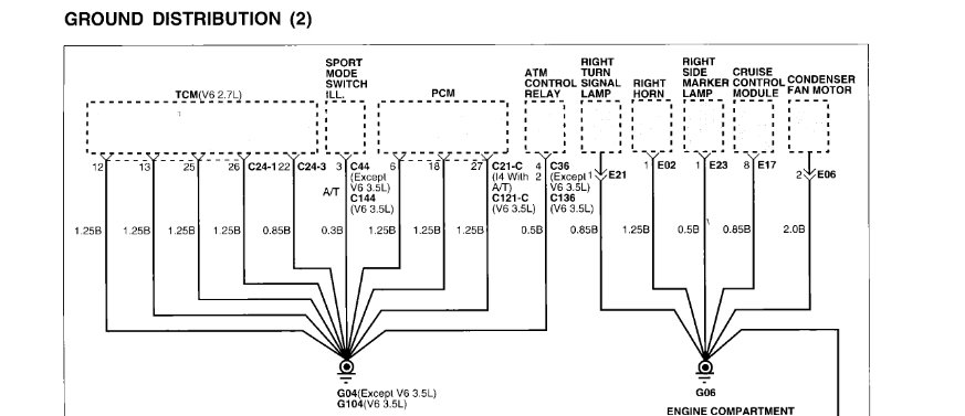

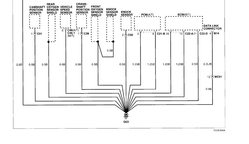

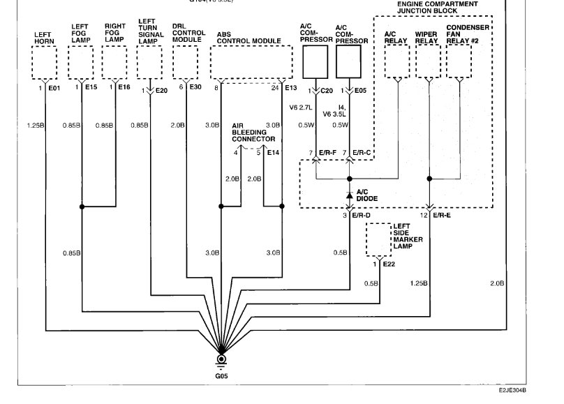

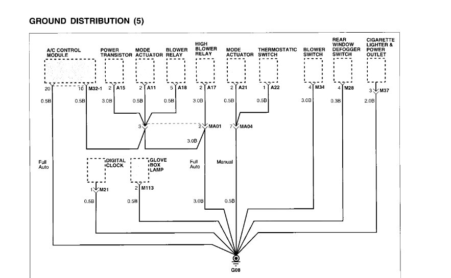

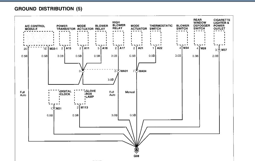

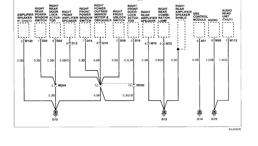

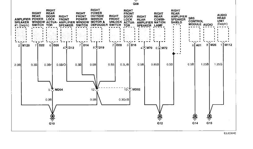

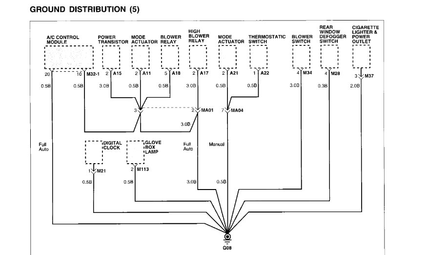

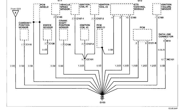

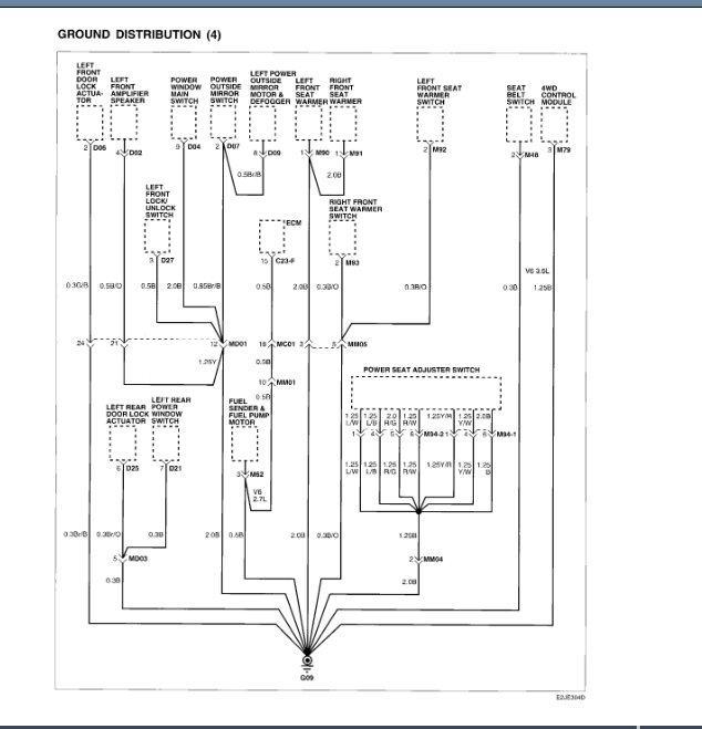

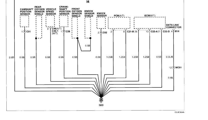

Hi there Alex, would you have a wiring diagrams of at earth straps in the engine bay? thank you
Oct 15, 2019 at 7:19 AM
SCGRANTURISMO
  • 4,897 POSTS
Hello again,
In the diagrams down below I have included all the ground locations in your vehicle. Please get back to us with what you find out.
Thanks,
Alex
2CarPros
Oct 15, 2019 at 8:17 AM

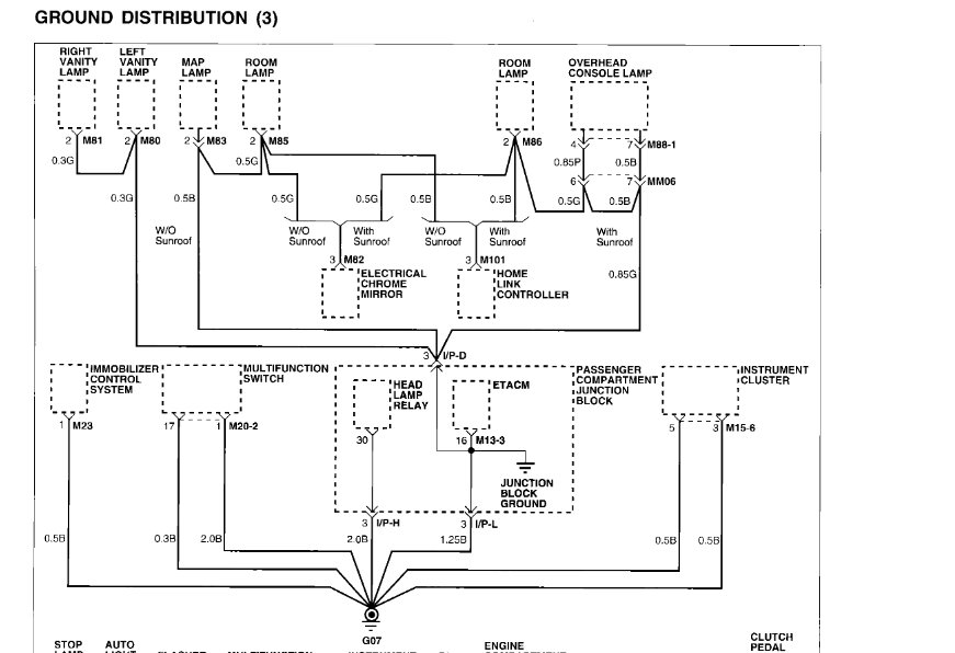

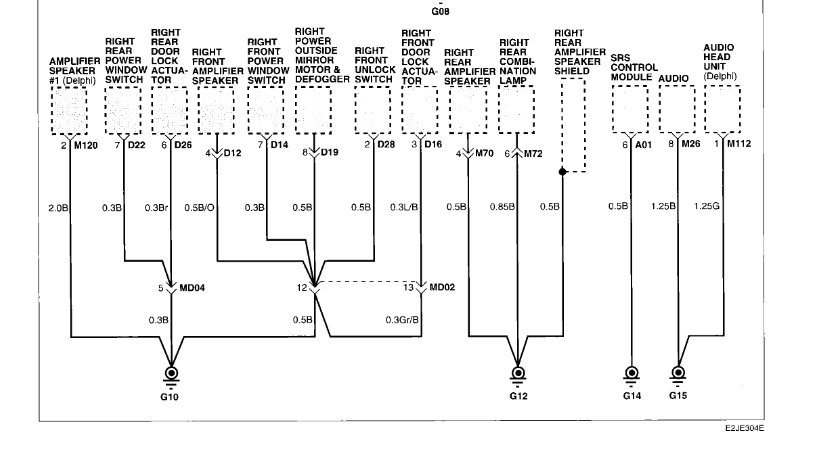

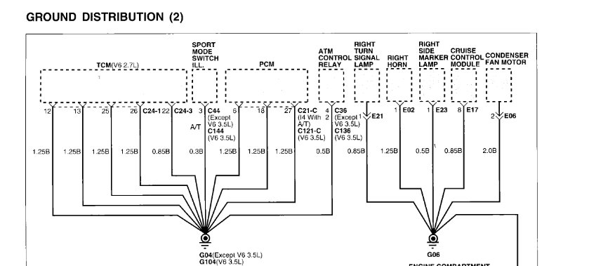

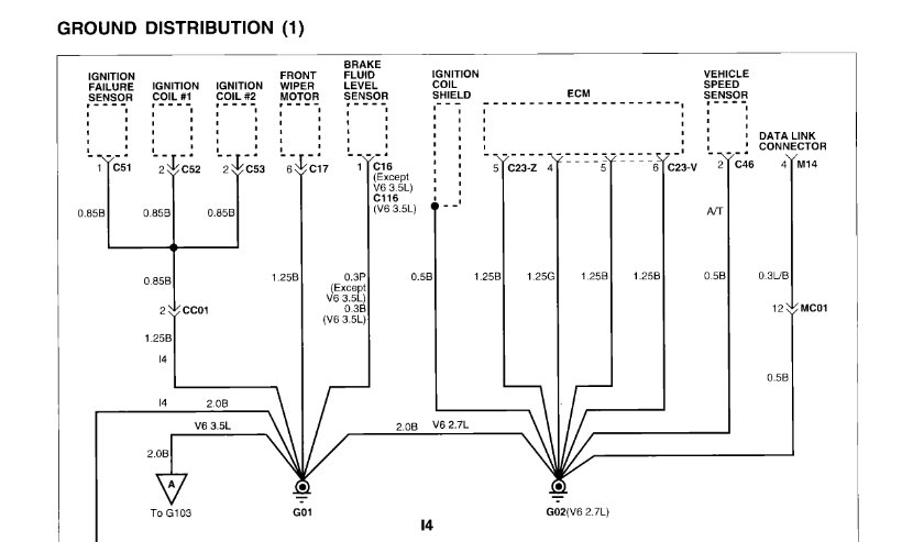

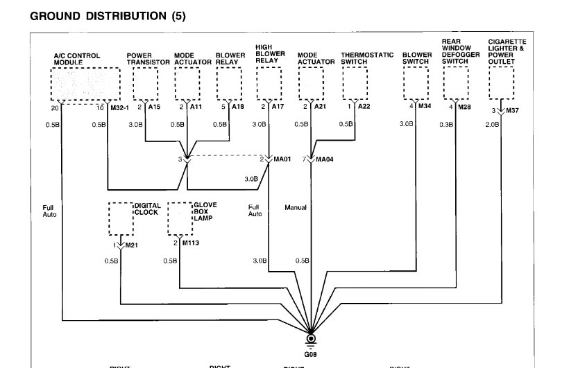

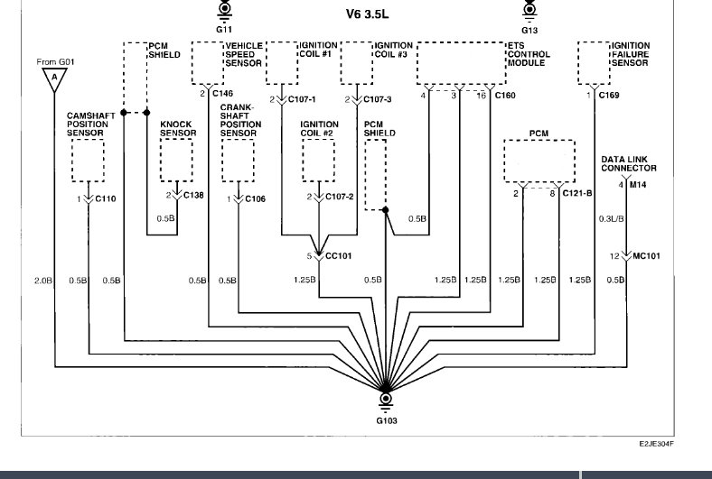

PETAR LJ
  • 32 POSTS
Hi Alex just a quick update.

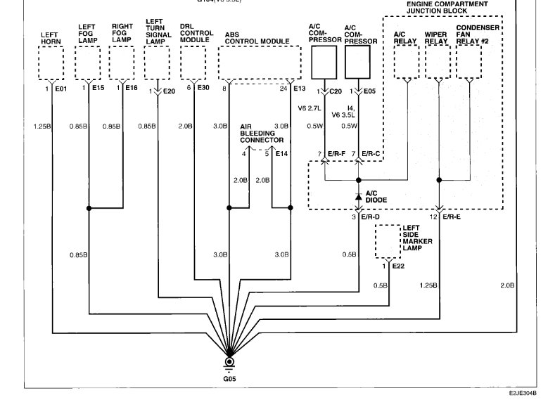

I have now found out my AC, cruse control, AC thermo fan and not sure what else is not working now. I checked my thermo fan this afternoon and found there was no earth to in the wiring connected a new earth lead and the fan works now.are all these items tied together somehow? the motor has not stopped working fine but still seems to be a earth problem under the bonnet. I have not got to the other items that are not working yet. will try running direct earths the them and see it it gets them working. any ideas from your end about this problem now? thank you again for all your help with my problems.
Oct 15, 2019 at 10:22 PM
SCGRANTURISMO
  • 4,897 POSTS
Hello again,
Have you checked the Grounds that I sent earlier? They are all of the ground locations for your entire vehicle. In the diagrams down below I have also included the ground distribution wiring diagrams for you that show where all the vehicle components are grounded to. Please get back to us with what you are able to find out.
Thanks,
Alex
2CarPros
