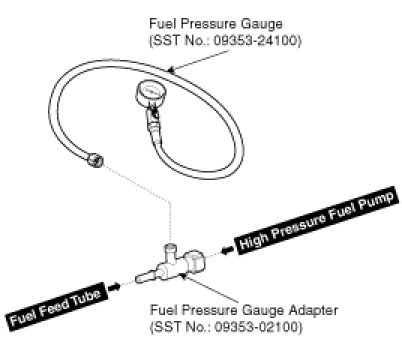

Here are the directions and diagnostics specific to your vehicle for testing fuel pressure. The attached pics correlate with the directions.

2. Install the Special Service Tool (SST).
(1)Disconnect the fuel feed tube from the high pressure fuel pump.
CAUTION:
There may be some residual pressure even after "Release Residual Pressure in Fuel Line" work, so cover the hose connection with a shop towel to prevent residual fuel from spilling out before disconnecting any fuel connection.
(2)Install the special service tool for measuring the fuel pressure in between the fuel feed tube and the high pressure fuel pump .
pic 1

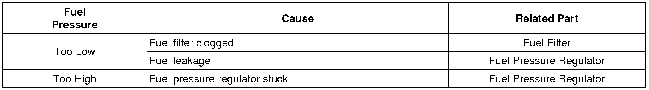

4. Measure Fuel Pressure.
(1)Start the engine and measure the fuel pressure at idle.
Fuel Pressure:445 - 455 kPa (4.5 - 4.6 kgf/cm2, 64.5 - 66.0 psi)
NOTE:
If the fuel pressure differs from the standard value, repair or replace the related part .

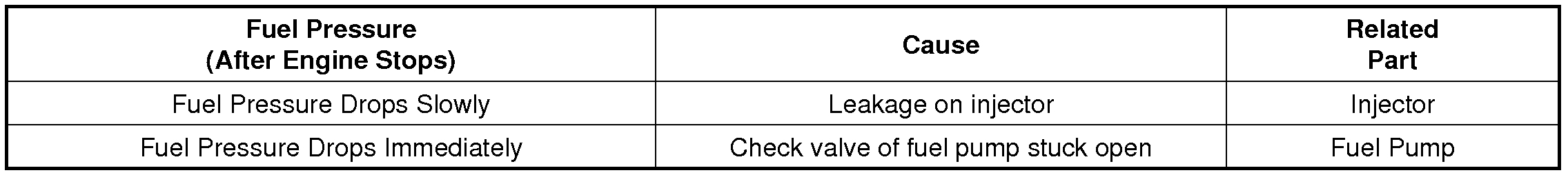

(2)Stop the engine, and then check for the change in the fuel pressure gauge reading.
Standard Value:The gauge reading should hold for about 5 minutes after the engine stops
NOTE:
If the gauge reading should not be held, repair or replace the related part .
pic 3

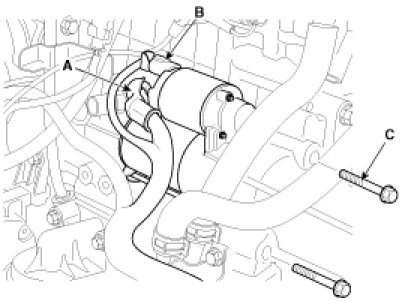

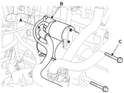

Yes, that is very possible and is good news. Here is a link that explains in general how to replace a starter:
Here are the directions specific to your vehicle. The attached pics correlate with the directions.
_________________________________________________
2012 Hyundai Sonata L4-2.4L
Repair Procedures
Vehicle Starting and Charging Starting System Starter Motor Service and Repair Removal and Replacement Repair Procedures
REPAIR PROCEDURES
Removal and Installation

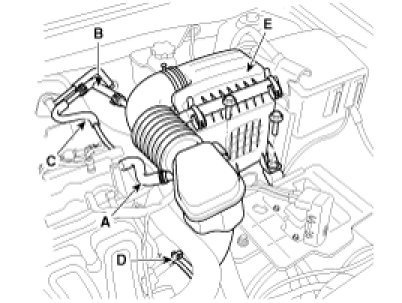

1. Remove the engine cover.
2. Disconnect the battery negative terminal (A).
Tightening torque :
4.0 - 6.0N.m (0.4 - 0.6kgf.m, 3.0 - 4.4lb-ft)

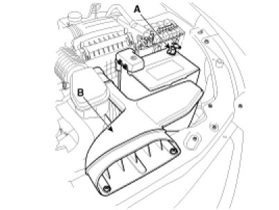

3. Remove the air duct (B).
pic 1
4. Remove the air cleaner assembly.
(1)Disconnect the breather hose (A), the intensifier hose (B) and brake booster vacuum hose (C).
(2)Disconnect the air intake hose (D) and then remove the air cleaner assembly (E).
Tightening torque
Hose clamp bolt:
2.9 - 4.9N.m (0.3 - 0.5kgf.m, 2.2 - 3.6lb-ft)
Air cleaner assembly bolts:
7.8 - 9.8N.m (0.8 - 1.0kgf.m, 5.8 - 7.2lb-ft)
pic 2

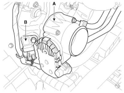

5. Remove the ETC (Electronic throttle control) module (A) and MAPS (Manifold absolute pressure sensor & IATS (Intake air temperature sensor) (B).
Tightening torque:
9.8 - 11.8 N.m (1.0 - 1.2 kgf.m, 7.2 - 8.7 lb-ft)
pic 3

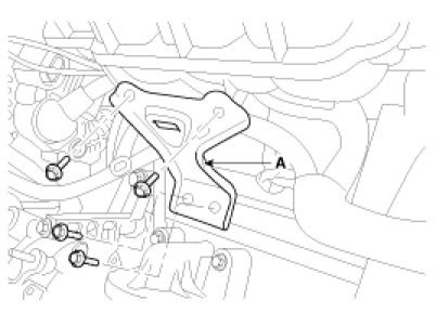

6. Remove the intake manifold stay (A).
Tightening torque:
18.6 - 23.5 N.m (1.9 - 2.4 kgf.m, 13.7 - 17.4 lb-ft)
pic 4

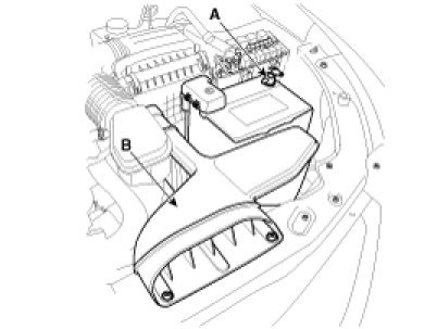

7. Disconnect the starter cable (A) from the B terminal on the solenoid, then disconnect the connector (B) from the S terminal.
8. Remove the 2 bolts (C) holding the starter, then remove the starter.
Tightening torque :
42.2 - 53.9N.m (4.3 - 5.5kgf.m, 31.1 - 39.8lb-ft)
pic 5
9. Installation is the reverse of removal.
