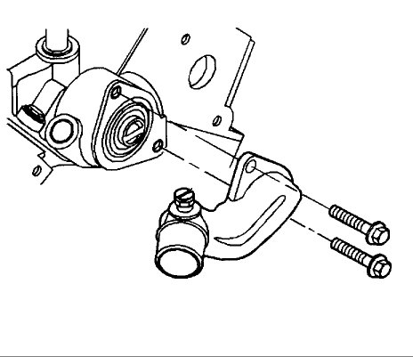

Had the water pump replaced, thermostat, just had the entire head gaskets replace, and the car is still over heating within five minutes of having it run you can see the coolant at the bottom of the radiator and there is a steam pocket on the right side by the radiator, I have even went and bought radiator stop leak or fix leak and that seem to work with the car leaking, but it is still smoking and there is still a steam pocket. would you know what else it could possibly be? the radiator looks brand new.

Also make sure you have bled out the system properly. There should be a bleed valve on top of thermostat housing. Attached image. Usually the way I bleed is by using a coolant pressure leak tester. I fill the cooling system and attach tester to radiator fill. Open bleed valve and pump pressure until coolant comes out. Refill system and do it again until coolant just comes out. Refill and run vehicle and verify it is not overheating. Also make sure fans come on as well.
