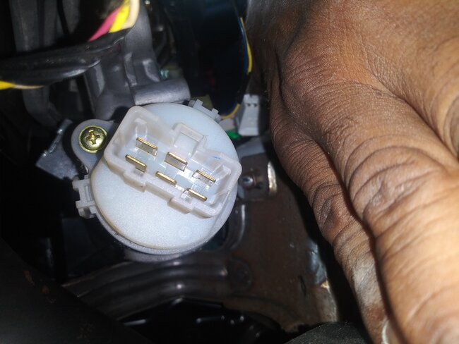

Just took the start fuse out and checked and it didn't do it, so what's next?
Jul 10, 2024 at 10:22 AM
CWEBSTER#1
  • 16 POSTS

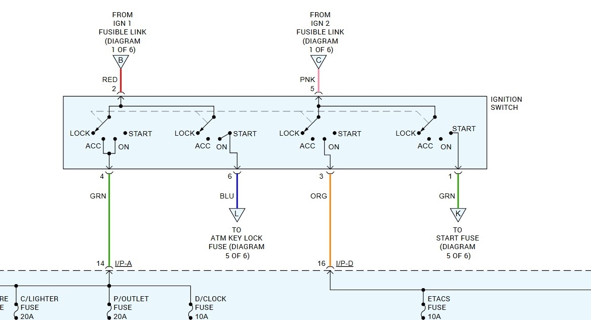

Images of connector on the switch.
Jul 10, 2024 at 10:44 AM
STEVE W.
  • 15,345 POSTS
Okay, so you pulled the fuse, and it stopped trying to start in ACC? In that case take a test light connected to ground and go to the start fuse again. Turn the key to ACC and then touch both of the contacts where the fuse was. Watch the light, now turn the key to start and hold it and probe again. If the light comes on in ACC there is a problem in the switch or its wiring. It should only come on in start. You said the switch was replaced? Was that for this same issue and is the switch OEM of aftermarket?

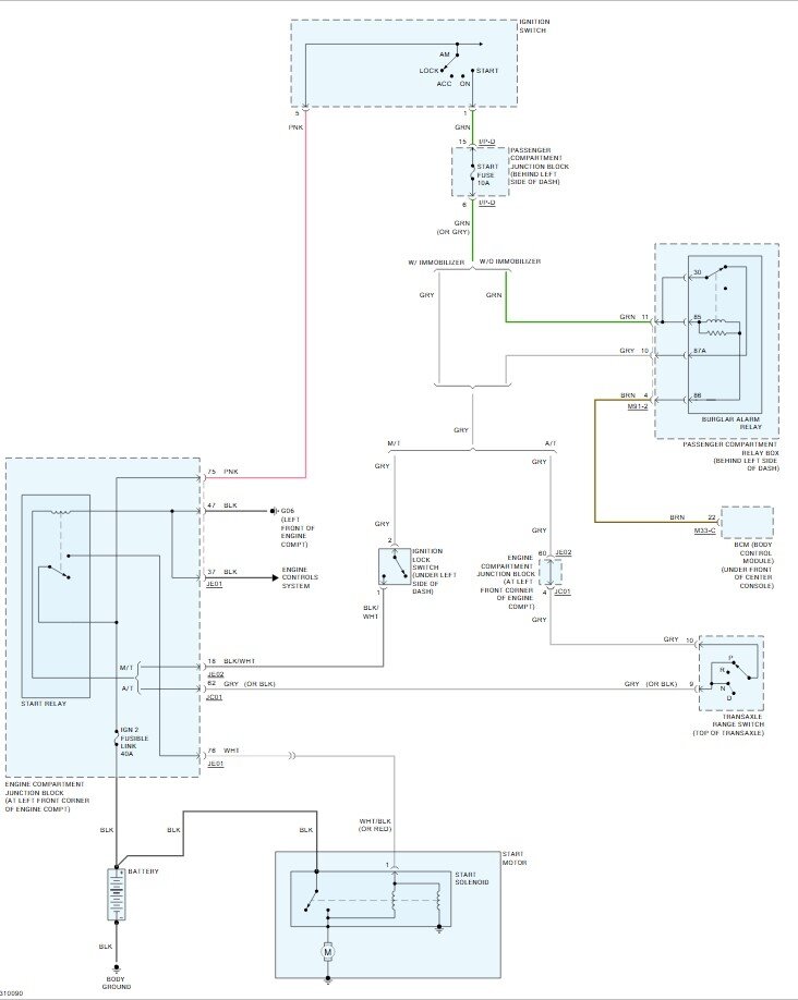

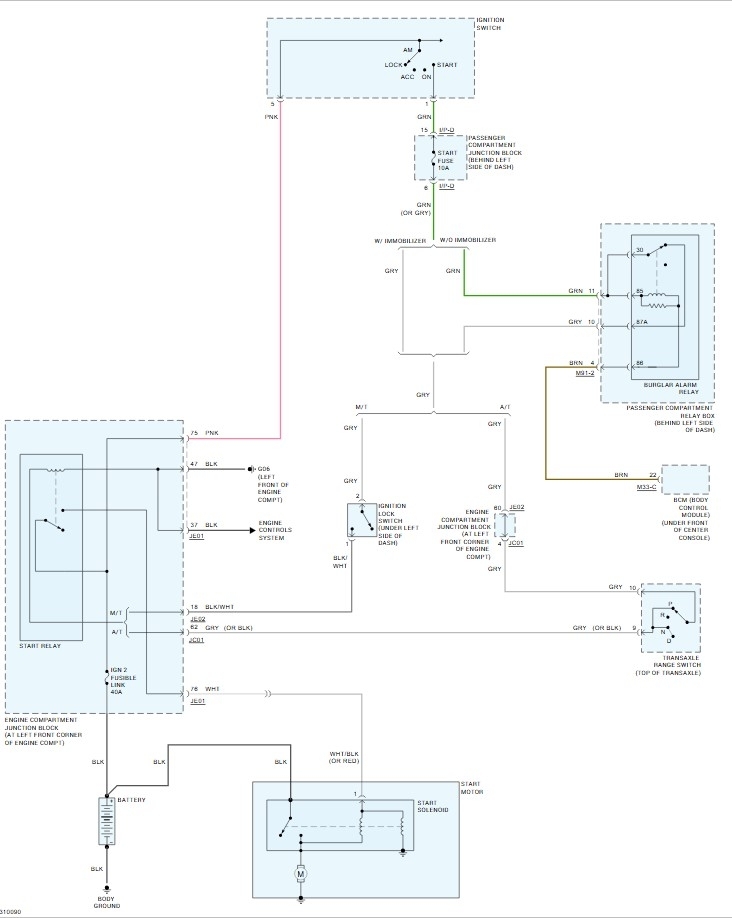

Okay, you replaced the key cylinder and the ignition switch and after sometime this issue developed. Was anything else done? Like an aftermarket alarm or stereo? The reason I ask is that based on pulling the start fuse stopping this, there has to be some spot where the power from the accessory circuit is bridging to the starter circuit. It could even be two wires rubbed together in the harness but only through testing will we track it down.

Okay, based on everything so far, the issue isn't in the starter or the starting circuit itself. It has to be in the switch or the wiring harness. The fact that it stopped doing it but then it came back also suggests it's in the wiring. What it sounds like is that power is jumping from the acc/run circuit side of the switch to the start circuit. The problem could be right in the harness near the switch. Another question, when you turn the key and the starter turns the engine over, does the starter stop turning if you move the key to the run position? If you cannot tell, you could remove the SNSR fuse 3 in the fuse box under the hood, that would disable the fuel injectors so that the engine won't start. If you turn the key to ACC and it keeps trying to start in the ACC and ON then it's a short in the wiring.

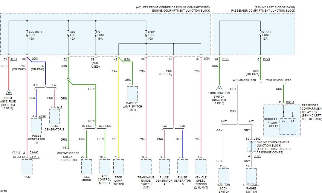

Okay, that might make it easier as it sounds like the issue is voltage feeding back through the switch. Take a test light and see if there is voltage on the green wire at terminal 1 when the key is in the on position. Disable the injectors as I had you do above (remove SNSR fuse 3) Use a pin or needle to probe into the back of the connector with it connected to test that. The green with in pin 1 should only have power with the key in start. If it has power when the key moves into the run position, then there is a problem in the wiring that feeds the switch. To verify it isn't the switch use a multimeter to check between the same two terminals with the switch unplugged. While rare it could be that the switches are made poorly and causing the problem, although I think it's more likely in the wiring harness itself.

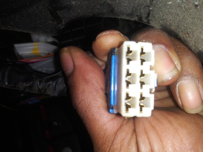

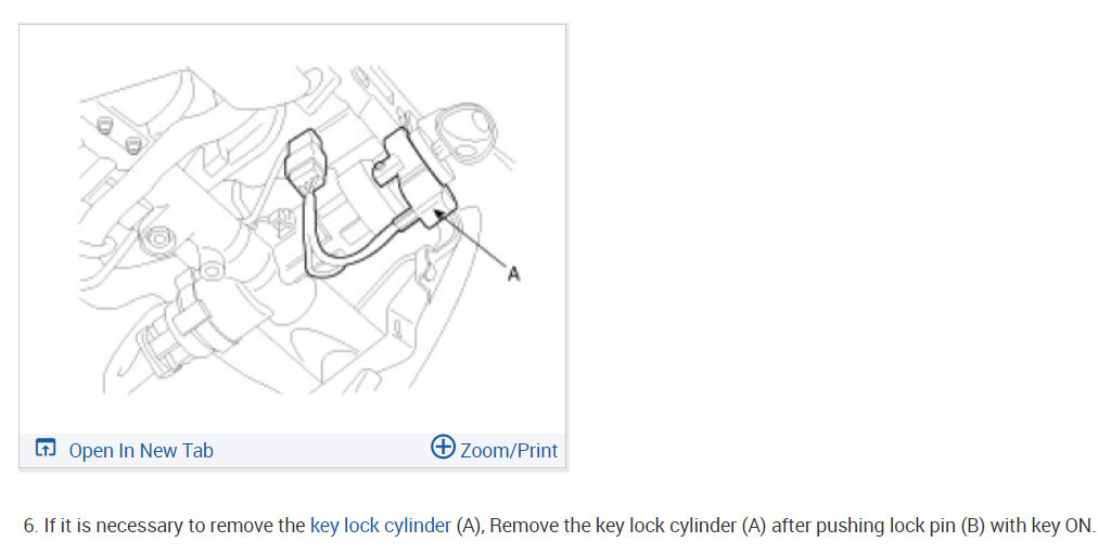

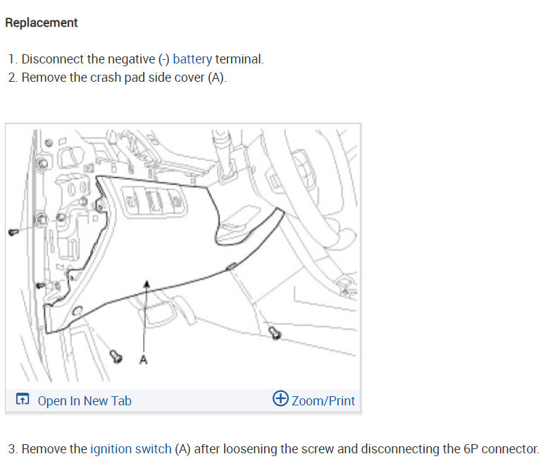

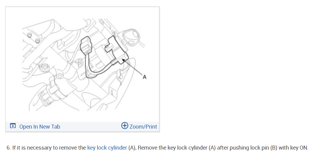

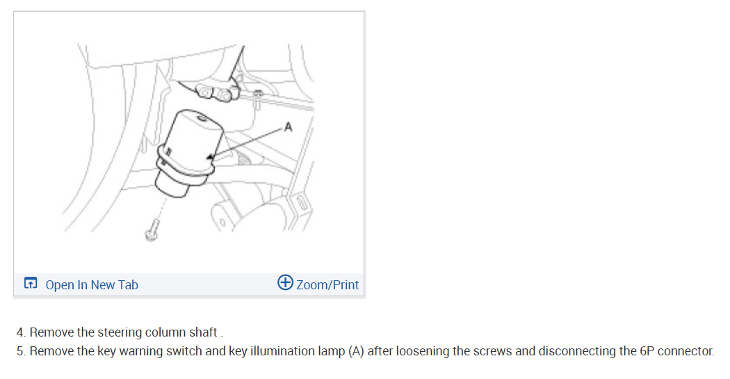

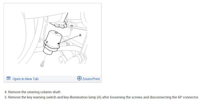

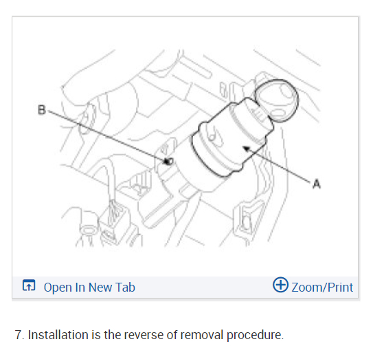

Hey Steve, before I check the wiring could it be in the electrical part of the switch not the lock and key part?
Aug 14, 2024 at 7:39 AM
  • 55,402 POSTS

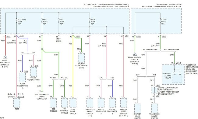

Yes, it could I thought you said you replaces that. I would replace the "switch" apart of the ignition switch. Let us know what happens. Here is how to change the switch out, also if this is not the problem I have seen the junction box on the passenger's side go out and can cause strange issues like this one. Check out the images (below). Please let us know what happens.
