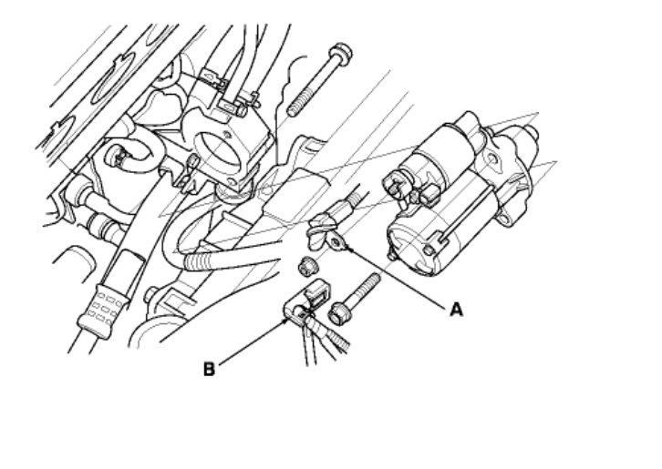

It does sound like the starter is going bad, but to be sure use a test light and check the trigger wire at the starter when someone it cranking it over. If there is power then the starter is bad.
and check the test near the bottom of the guide.

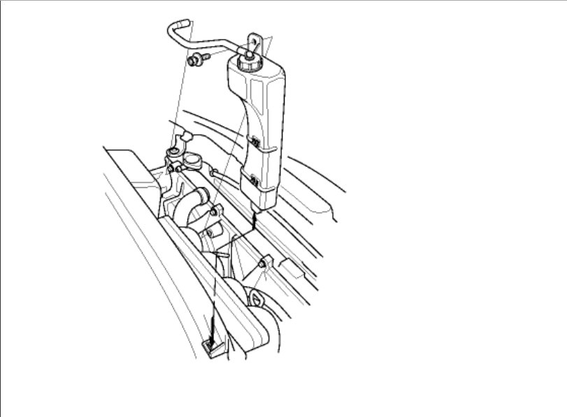

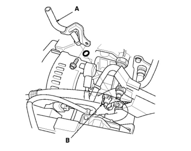

and if bad this guide gives you an idea of what you are in for when doing the job.
Below is what it will be like on your car.
